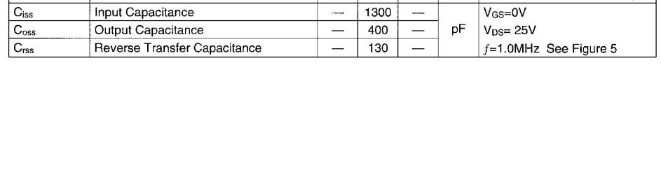

I've recently ordered 10pc of MTW32N20E (32A, 200V), along with some other stuff, to possibly replace the IRFP260N in the mini-Aleph J i'm putting together as a headphone amp. The specs look nearly identical.
Any reasons they might not sound properly / good?
Khron said:
Ciss for the OnSemi is specced as 3600 (typ) / 5000 (max) pF, as opposed to the 4057 (typ) for the IRFP260N. Comparable, i'd say :smash:
Perhaps, but it's the IRFP240 you should compare with, as it is what Pass specs.
Excactly.
The most usefull Onsemi fets (for Pass projects) are the TO220's MTP10N and MTP12P. They are very nice for a BosoZ type PSU. (Drop in replacement) Ofcourse, they carry the J310 also, which gained some popularity lately🙂

Depends on what you want to build. The MTW32's might be worth a shot if used for the cascode devices in a ZenV9. I wouldnt recommend them for the usual Zen's and Aleph.

In this application, I would bet money that you couldn't tell the difference, even if you used some real big capacitance fets, but as Steen says, for the Zen amps, I'd too say they're a no-go. For the aleph amps, you could just run fewer devices a bit harder, and end up with the same result.
