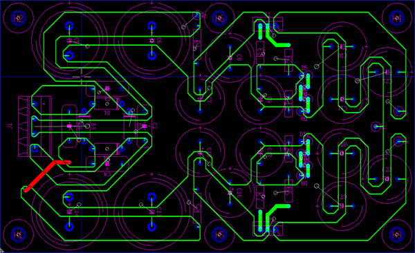

These are not the final pcb's but the designs that I made working a few days ago. My pcb designs were shaped in such a way, that everything, including connectors and transformers can fit in a single standard audio-size enclosure.
The Power supply displayed below can hold up to 44.000 uF capacitance which should be far more than suficcient. Modifications pending are: 1) removal of one or two caps to make place for a two small heatsinks, since the fets turned out a bit hot. 2) my name put somewhere and 3) finish off the silkscreen layer.

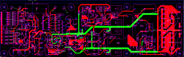

Second, there is the main board.
The baby took me more than a month total to design, spread out over an entire year. I still deeply feel sorry to all those people I had to dissapoint in the bulk order I was supposed to organise that time. It was a perfect example of selling the skin before shooting the bear. In fact, I sold that skin without even knowing what a bear is 😉
The second layout is a lot better, and indeed, it works 😉 It features plenty of space for those big 10 uF caps needed for decoupling. A wima MKS cap fits perfectly. Q1 and Q2 can be thermally coupled. Maybe it reduces noise even further. I don't know. If desired, Q21 and Q21 can be coupled as well. The main board can hold up to 10.000 uF of additional high-speed caps in the power supply line. And for my own special feature: I have placed jumpers in the supply rails to the MC stage and the unity gain inverter. If not used, you can cut the power to these stages, and reduce noise levels on the rails even more.
Modifications pending: 1) add holes for the fets to secure them on the board (I forgot the holes!) 2) Fix errors in the silkscreen layer 3) put m name on it 4) enlage the solder pads for the fets, to make soldering easier.

xsnailx said:
Bakmeel,
great but i have a few questions: are you able to provide gerber files for this group buy.
Yes. Or perhaps if someone else can convert ultiboard into gerber, I have no objection to that either.
what is the board size
The PSU: 85mm x 140mm (3.35" x 5.51")
Main Board: 80 mm x 270 mm (3.15" x 10.63")
note: you need at least 2 main boards. The layout is mono. 2 PSU boards is optional, but 1 will work too.

Bouke,
Did you make provisioins for eliminating the output coupling capacitor? I believe that Peter Daniels had added a variable pot in parallel to one of the resistors to balance out the DC. It would be great to be able to eliminate that large capacitor, if it's not to late to add it.
Ron
p.s. have you tested the boards?
Ron,
Good point. I know what you're talking about but no, I haven't made those provisions. I'll investigate. It's not too late to alter the design a bit.

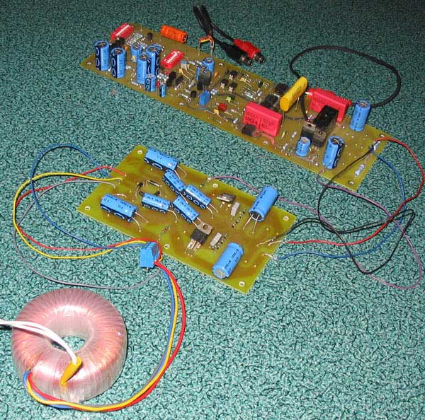

The current boards are playing. (mono that is). Even with inferior ceramic caps, non-matched transistors, less than half the supply caps, the design works fine and it even sounds good 😀
Bouke
*** edit ***
I've looked up the posts on that trimmer. I can't add it without making a lot of changes. It's too crowded on that section of the pcb 🙁
