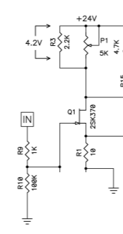

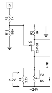

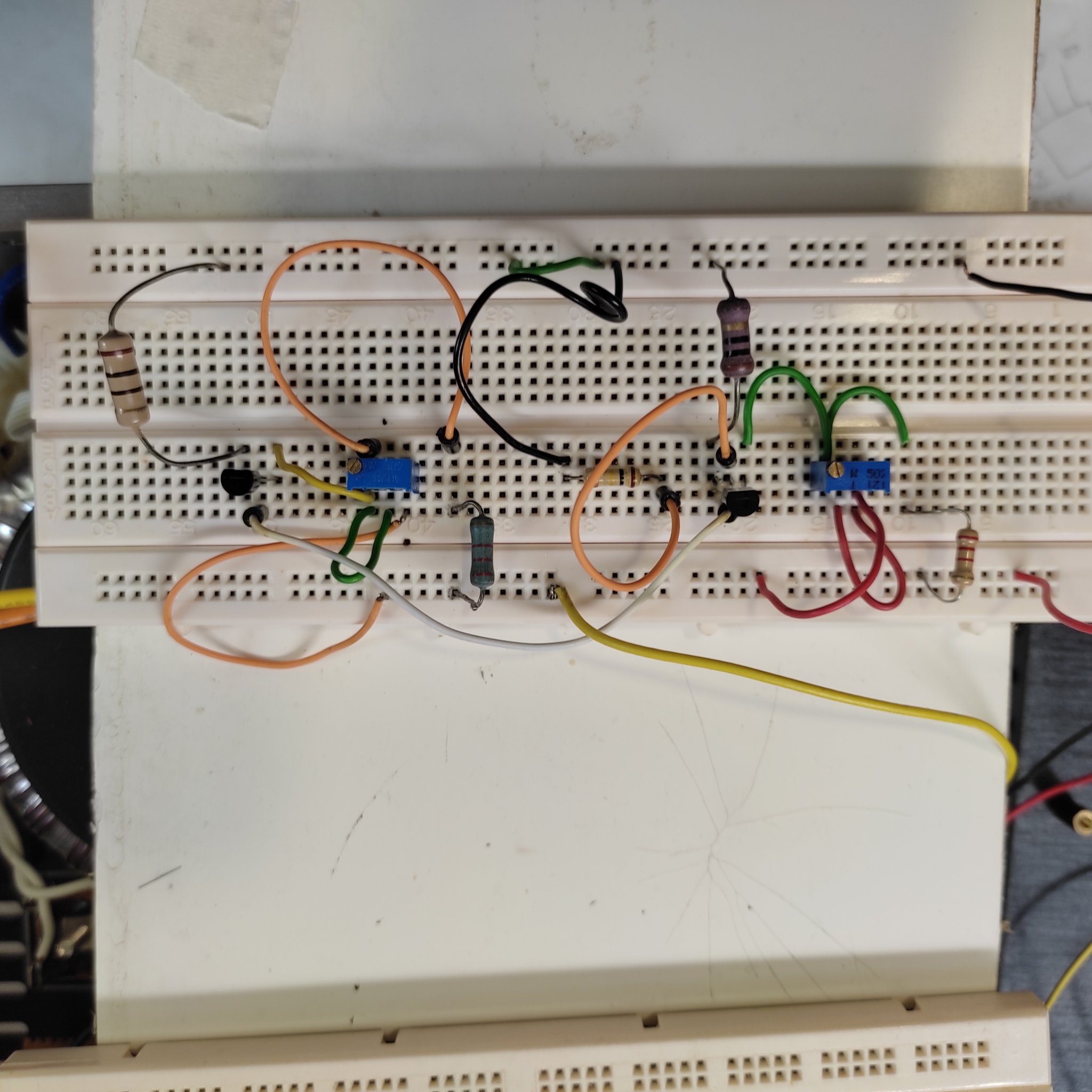

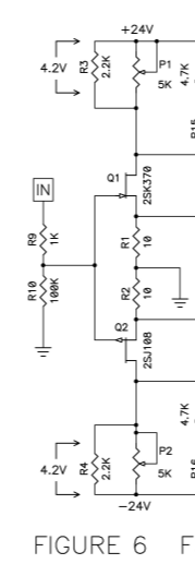

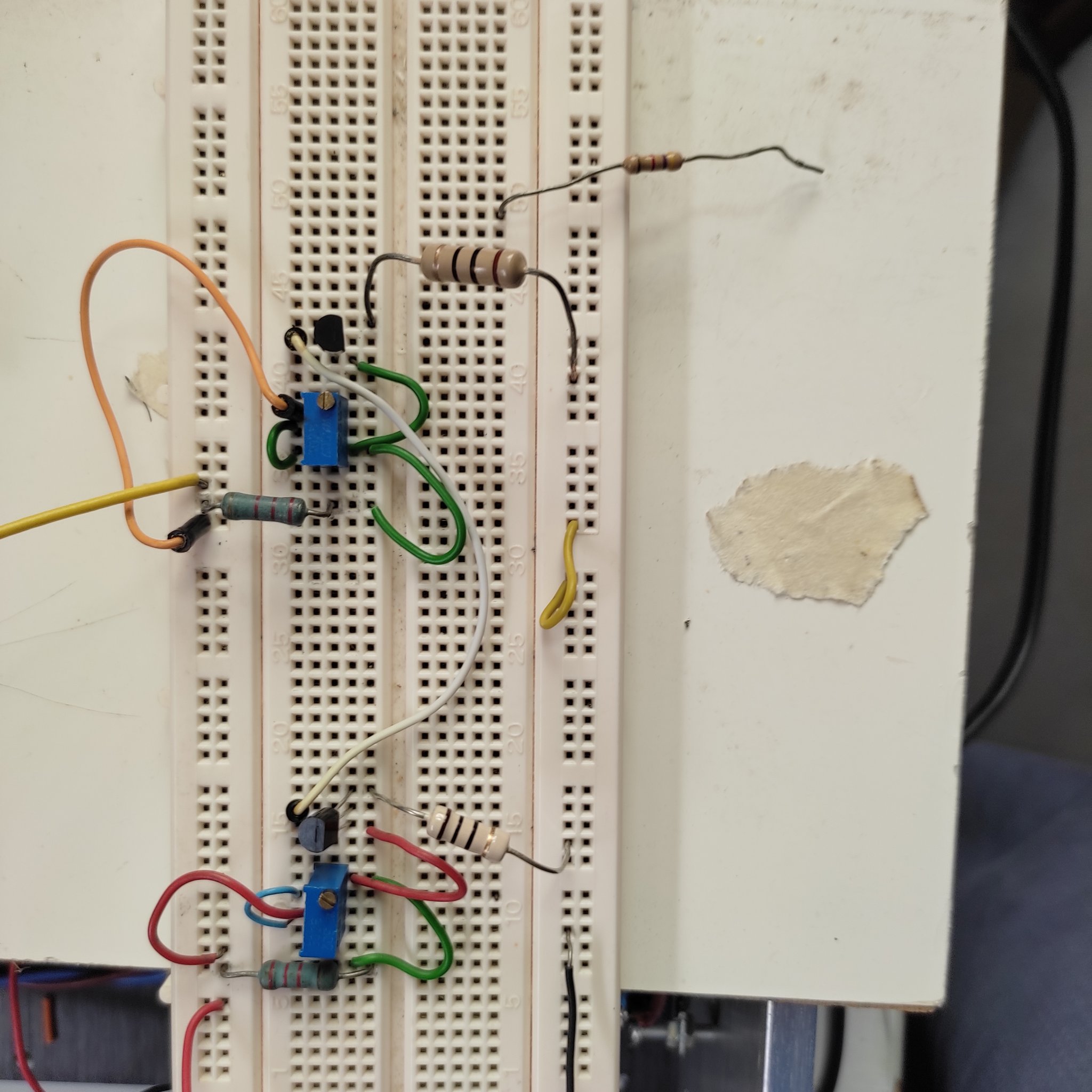

Only One Matched Jfets Conducts When Connected in Complementary
Breadboarding as shown in schematic. Only N channel conducts when in Complementary. P channel only conducts when N channel is disconnected from supply.

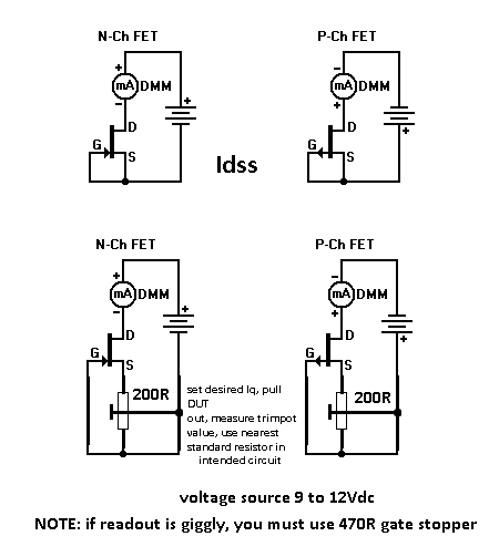

I make errors in breadboarding all the time, plus breadboard connections are not very reliable...
yes, exactly
as is , that circuit can be, both mentally and functionally, cut in upper half and lower half, and they're totally independent

But when I replace both jfets with those that measured 12mA ldss the circuit works. That is, I am able to adjust voltages across R3 and R4.
7.8mA would not work.
Yes ground connection for both 10R, yellow jumper on breadboard.

if you're using JFets confirmed by simple matching jig, they're good for amp
upper row figures are for Idss

And what voltage do you see across the 10R resistors R1 and R2?
R1 0.2V R2 0.00V
With limited knowledge in electronics, I think current must flow from V+ to grd then to V-
for R3 and R4 to have voltages. P channel Jfet not pulling?
the gates of the jfets are connected to each other (via white wire) and nothing else? If so, try grounding that and see what happens
Yes, gates connected to each other only. If you grd the gate, then signal will be gone.
without a ground reference for the gates, the circuit cannot possibly work.
Good point. So for jfets to work there must be ground reference? Maybe that is my my mistake. Will connect gates to ground by 100K resistor and see how.l
Yes great.
With the 100K added both jfets conduct now.
