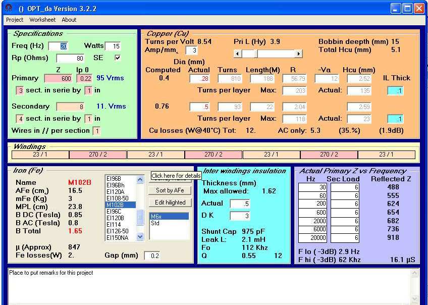

You can find equations anywhere.
For the most part they are used inside that :
http://www.dissident-audio.com/OPT_da/Page.html
Just a tool that helps putting pieces together.
Yves.
lt cdr data said:Bonjour Yves.
I can't seem to install that program, any ideas?
Damned ! That is the worst that could occur
Where does it stop ? wich message ? if any !
Of course, you browsed the readmefirst file 😀
Try to tell me more.
Yves.

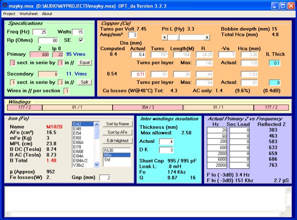

Hi mayky,
If you allow me to make some remarks !
I beleive your design can be improved largely.
I assumed that th gap is fixed by construction as usual with this kind of laminations.
For this first reason, you must accept to increase the lowest frequency to 25Hz for the same power to keep induction at reasonable value.
The major drawbackis the AC losses which should not be higher than, says, 10%.
So, I've increased the primary wire diameter to 0,4mm.
I've adjusted the primary L (in fact, global turns) to balance AC and DC induction.
Similary, the secondaries are far from optimized: You could put 118 turns per layer with the wire you choosen, but you only use 23 !
Prefer paralleled secondaries and search a combinaison of wire diameter wich use more efficiently the available copper space.
Now, you need 81 turns per section while you have room for 84. Well filled and fits in a single layer.
This also reduces leak L because it is somewhat proportional to the total thickness of the full winding.
Looking to interleaving, much better results are obtainable using "split" extreme sections.
And less sections means an easier to wind unit.
See attached suggestion but you may have other limitations not know by me !
Yves.

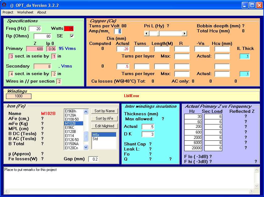

hi yves, still can't get it to install.
I get to the part, after I run setup.exe,
where I try to install by pressing the button, and it says l'installation....et reussi.
I seem to have the decimals with a dot.
any ideas? merci beaucoup

lt cdr data said:hi yves, still can't get it to install.
So, installation prog says "succesfully installed" ! !
May be the .exe file is somewhere ?
Check with "install / remove" Windows utility.
Somewhere in installation process, you can specify where you want put it.
It must be in the folder where files where decompacted.
If it is, what happens when launching ?
Yves.
aha, yes its there!!
merci beaucoup,
what happened is that it wasn't listed on my windows menu for programs,
but it is in C drive, program files.
strange
I left it as the default name and install location.
anyway, thanks and will have a play over the next few days🙂
