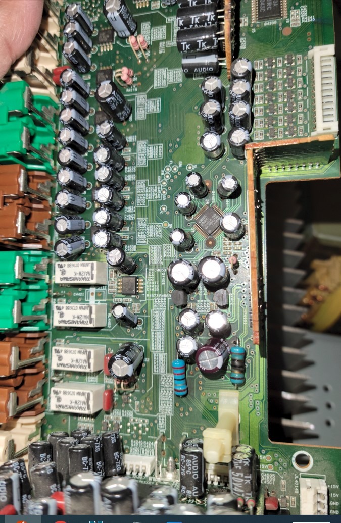

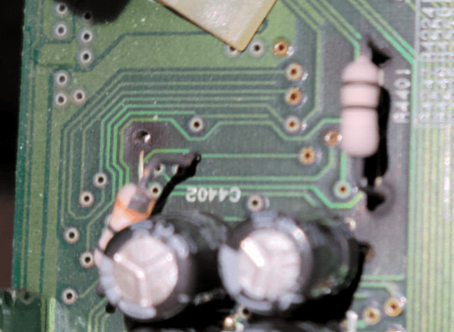

I have a Onkyo tx-sr805 that is powering on but the audio output is low regardless of the volume.
Upon inspection, I found some bulging caps, and 2 burnt resistors on pre-amp board that had melted and no longer soldered on the board.
Given the amount of heat these amps generate, i figured that the over years these voltage rails resistors were damaged by heat.
Replaced the capacitors and the resistors, matched the resistance for R4001/R4002 22ohm but increased wattage to better handle the heat.
Reassembled the unit and turned the power on, only to witness the resistors smoke and burn out right away.
so, i would imagine, this means, there is a short somewhere. Hoping the experts can suggest which parts could be suspect since nothing else looks visually bad.
The pre-amp board takes power from the speaker output board, i checked the input voltage reaching the pre-amp board and confirmed that i am getting +-15V so appears that the input voltage is good.

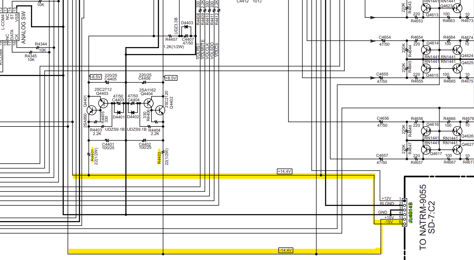

R4401/4402 are fuseable resistors designed to fail when a problem arrises. Never fit the wrong type of component in these places or you are asking for trouble.
Find your fault and fit the correct resistors, (22R 1/2W MO).

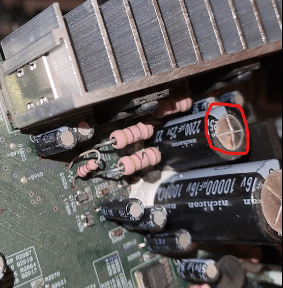

Check any capacitors have bee fitted the correct way around!
That 2k2uF cap looks very over worked. Component numbers may help engineers from guessing.

Without R4401 and R4402 in place, are the +/- 14.4 rails ok?
If yes, it's the +/-8.5V regulator circuit or something on those rails.
22 ohm 1/2W can handle 150mA.
If you hav a dual power supply, have the R4401/4402 resistors removed and connect it to the C4401/4402 nodes.
Slowly turn up the (tandem) voltage and notice the current. Stop if it starts to exceed that 150mA.

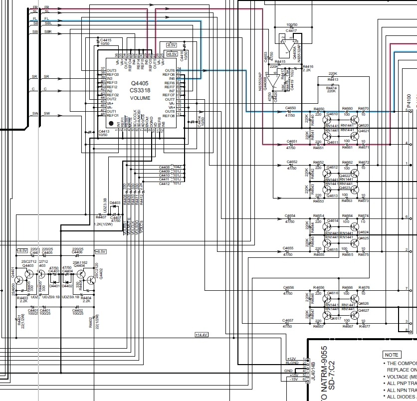

Measure the voltage over the 22 ohm resistors (as timing permits). It is the regulator for the volume control.What would i need to do to test the +-8.5v regulator circuit?
Inspect the board for shortings / contaminations.
If the 15 regulators are ok, leave it as is.

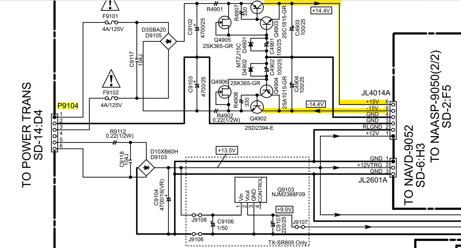

I did attempt to check the current on the +15v and -15v JL4014A output, which is received on the pre-amp board via JL4014B, while the voltage reading are still ok, on the amperage my multimeter has 10A and then 200ma settings. when set to 10A i get nothing and setting to 200ma, shows that the current is exceeding that amount, unplugging AC power, i do see numbers start from 200ma and slowly decrease as the capacitors discharge.
You had mentioned that the 22ohm 1/2 watt resistors can handle 150ma, makes me wonder if the current is exceeding. Unfortunately, the multi meter does not have too many options so track down the exact current.
The 10A setting on your mm has a separate bus to connect your lead to (I guess).
200mA is to much. I suspect a short at that volume board.

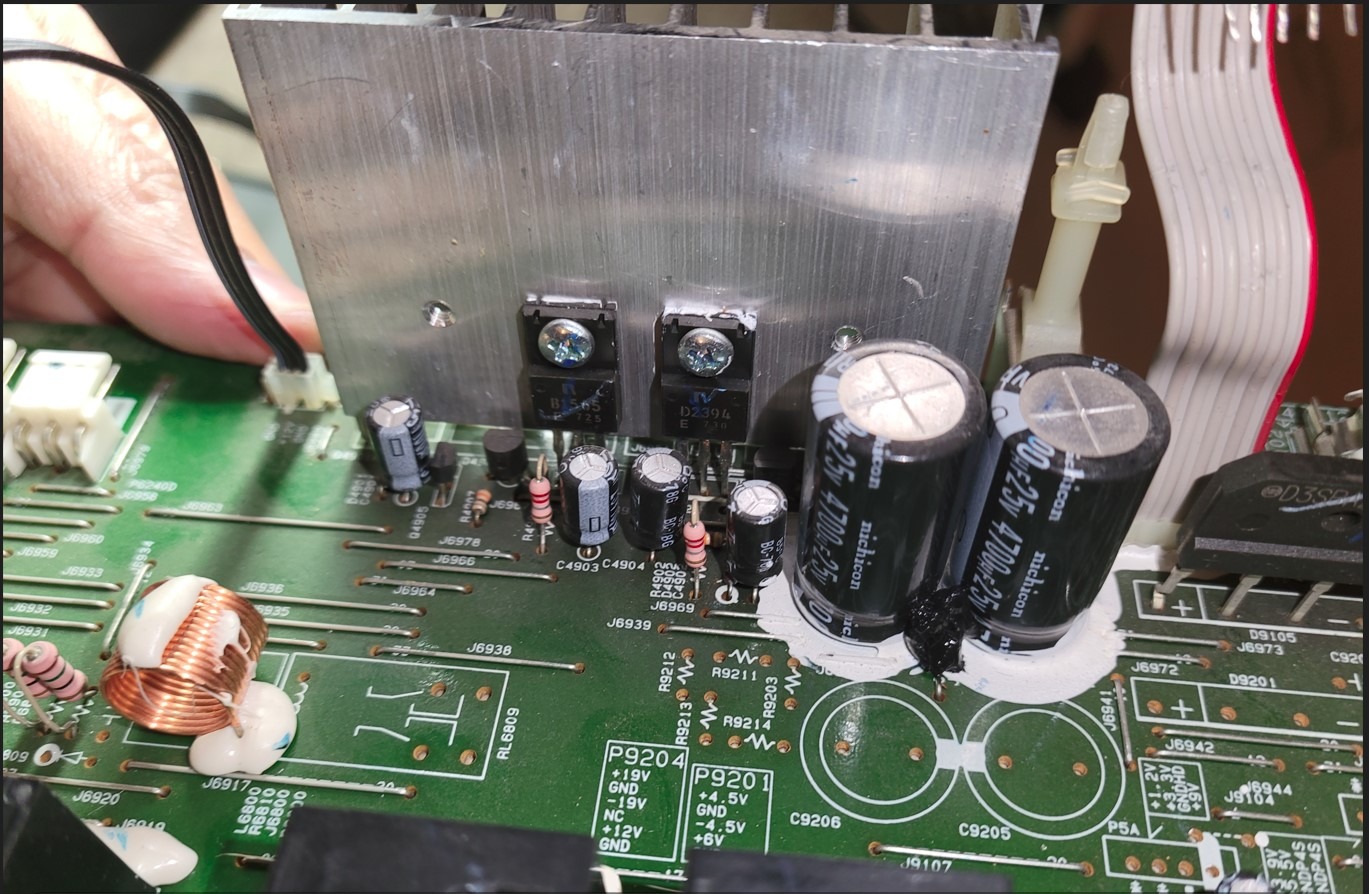

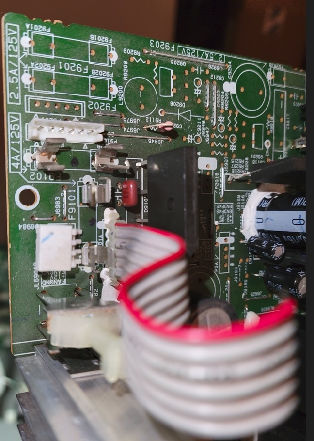

See pictures attached for illustration. You will see the higher wattage resistors that i had installed with the R4401 burnt which is on the +15V rail. That leads me to further suspect that a component pr more along the +15v rail are having issues.
I can remove all the transistors, resistors and capacitors and test each one, though not sure how much testing can happen with a basic multimeter.

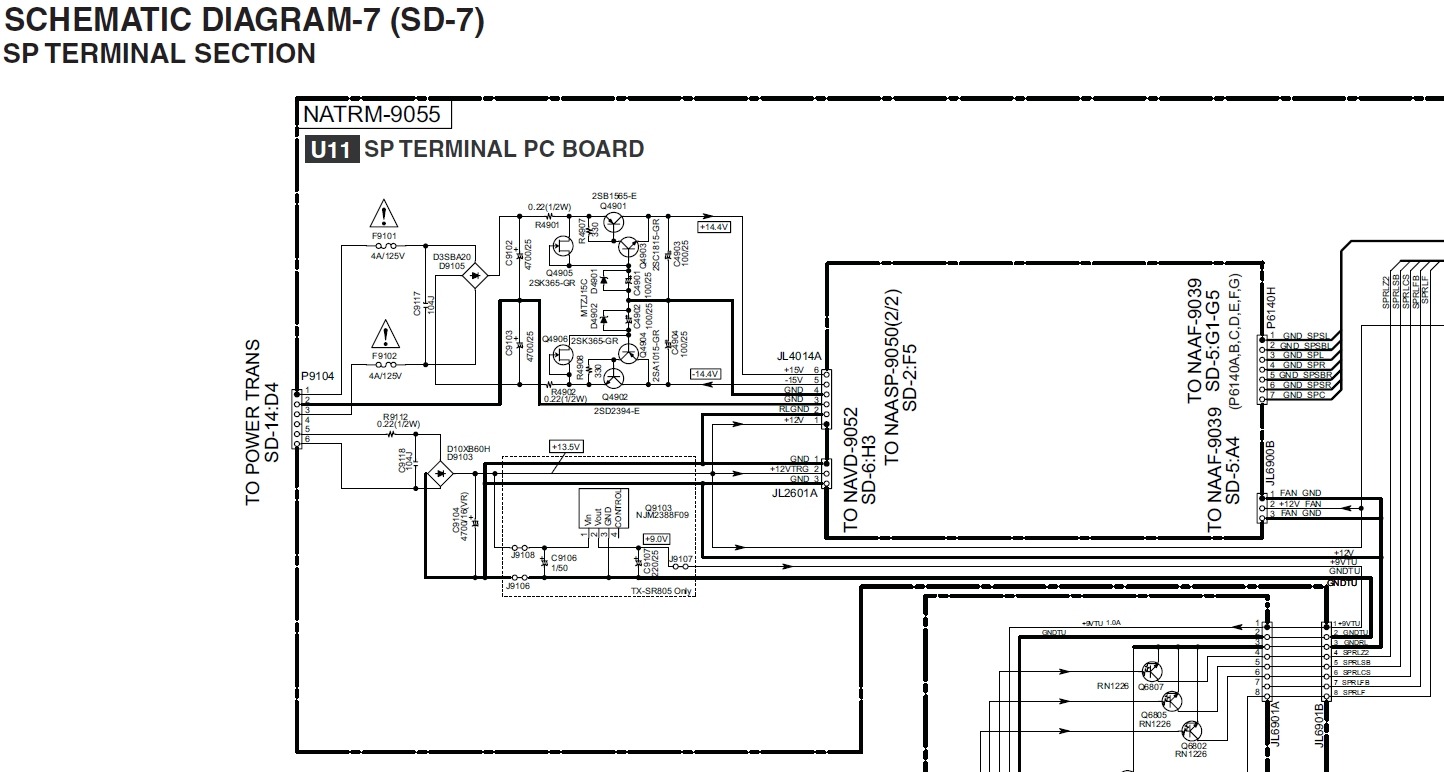

it helps if you refer to the schematic page in the service manual where the fault is happening, in this case it's p17/308, and you expect someone to go through 308 pages to find the place and help you troubleshoot? 🙂 really now
The +/-8.5V regulators only power the Q4405 (CS3318) so there is your idea to work with. You need to figure out what's drawing too much I and burning the resistors R4401,4402, helps if you get them right too
