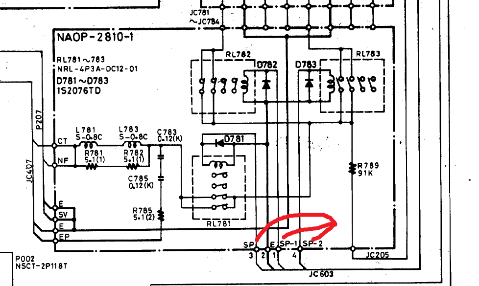

I am the end of my rope...I ordered the c1625, it arrived today and I installed it...the meters remained full left...so I measured the voltages...they were totally incorrect across the board...not only the new c1625 but also the new sa815....removed both from the circuit...now I have nothing at the base and collector holes of both and a ridiculous 6.49 volts at the emitter...wtf??
With those two transistors removed you should:
1/ Check that both 750 ohm resistors that feed the collector are intact. Measure them.
2/ With the amp on you should see +22 volts across D421 and -22 volts across D452.
I worry over how genuine any 2SC and 2SA parts actually are (unless bought from authorised suppliers) and wouldn't (myself) even think of sourcing the original type numbers for a repair.
So check the above carefully and lets see where it is at.
after my blood pressure returned to normal and the blood drained from my eyes, I reasoned that the events I described to you made no sense...I turned the amp over and measured for any power in that section of the main board...there was none except for 13 volts across 4 diodes...there is a gaggle of wiring on that board that comes from the rectifier board...red, blue and yellow...directed to each channel, left and right...they are the old style wire wrapped around a post...i checked each one...wiggled them a bit...and like magic the voltage reappeared in the transistor holes...as well as from the various resistors on that board...somewhere a connection is spurious and evil...question...if not the original numbers, then what...and where can I find viable substitutes? Yeah...I know it's a PITA...I wil repay the favor some way...maybe write you an ad...or a book..or give you a flying lesson...I am almost as good at piloting as I am at electronics...ha..
well, after wiggling and diddling with the wires, and resoldering the 'new' sc1625, all is well...meters are rocking like they should...but now your comments about the old sc's and sa's have me concerned...there are a dozen substitutes listed for each of those transistors...so how do I choose the best? Thank you once again...it's been a long trip...
