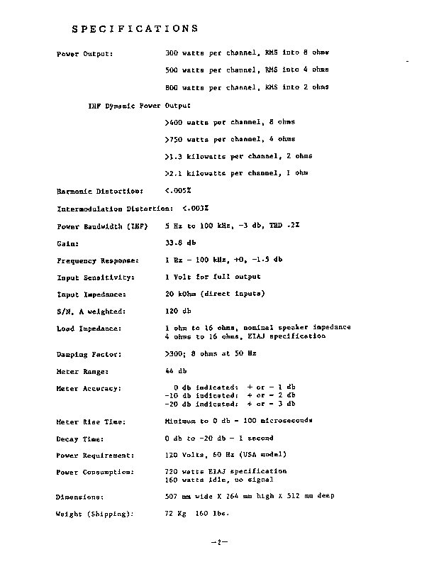

The service manual for the Onkyo M510 is available for download here:
http://www.hifiengine.com/manuals/onkyo/m-510-grand-integra.shtml
You must register to download. I have downloaded several manuals on 2 different computers without issue. Good stuff there.
