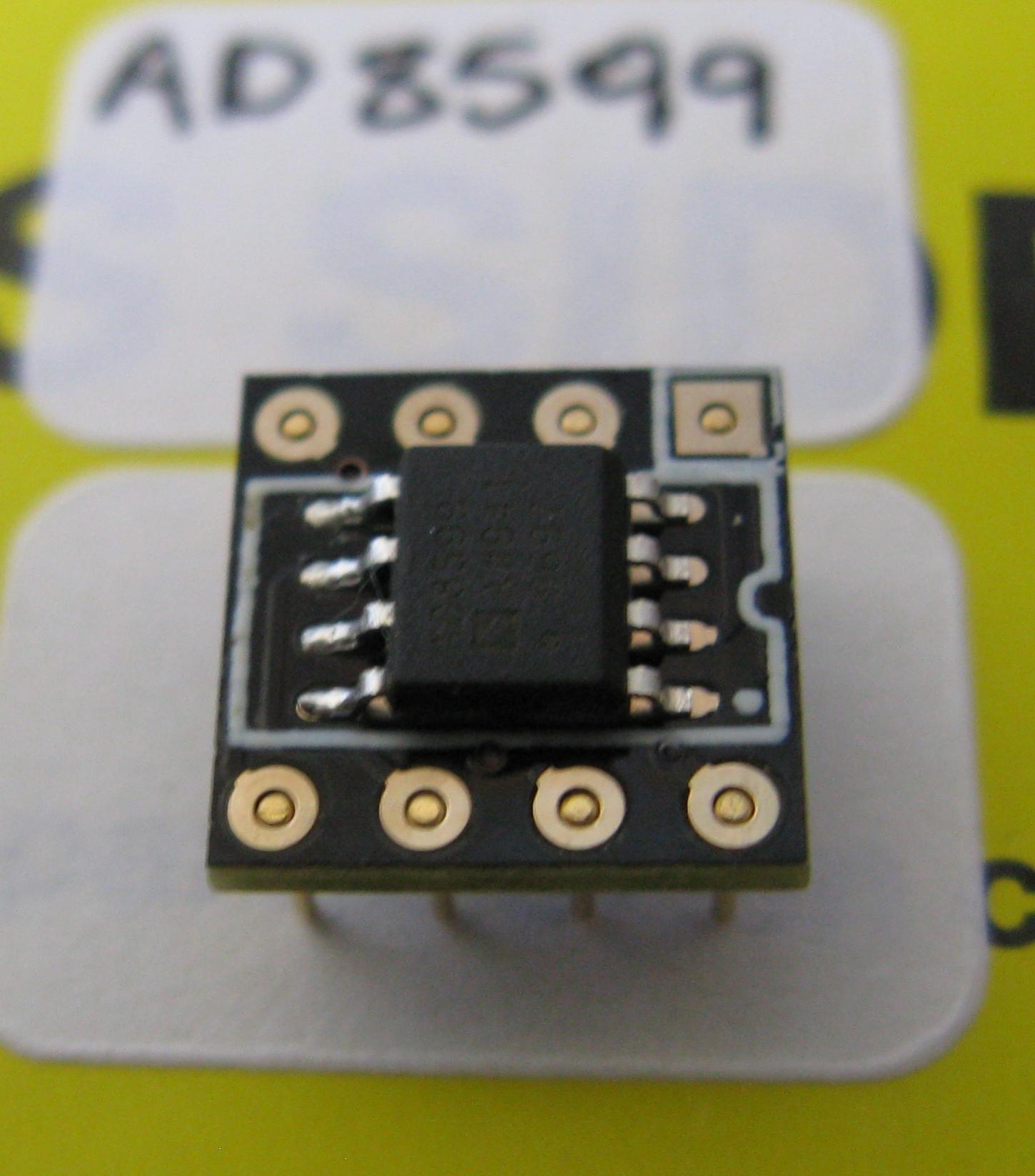

I have tested all 4 opamps with my ESP p06 phono preamo and it's 1 of them
which is giving trouble.
I have located the "bad" opamp and further troubleshooting has began.
Well, for starters...
...I should have soldered all of the 8 pins of the opamp to the browndog adapter, right? 😱
see photo for your own amusement...
If one channel worked and one did not then I would suspect something went amiss somewhere rather than the opamp not being suitable.
You're totally right Mooly!

SOIC to DIP is what I thought was meant.
https://cpc.farnell.com/proto-advan...o-dip-8-smt-adaptor/dp/PC02477?st=soic to dip
https://cpc.farnell.com/aries/lcqt-soic8-8/prototyping-adaptor-8-soic-to/dp/PC02100?st=soic to dip

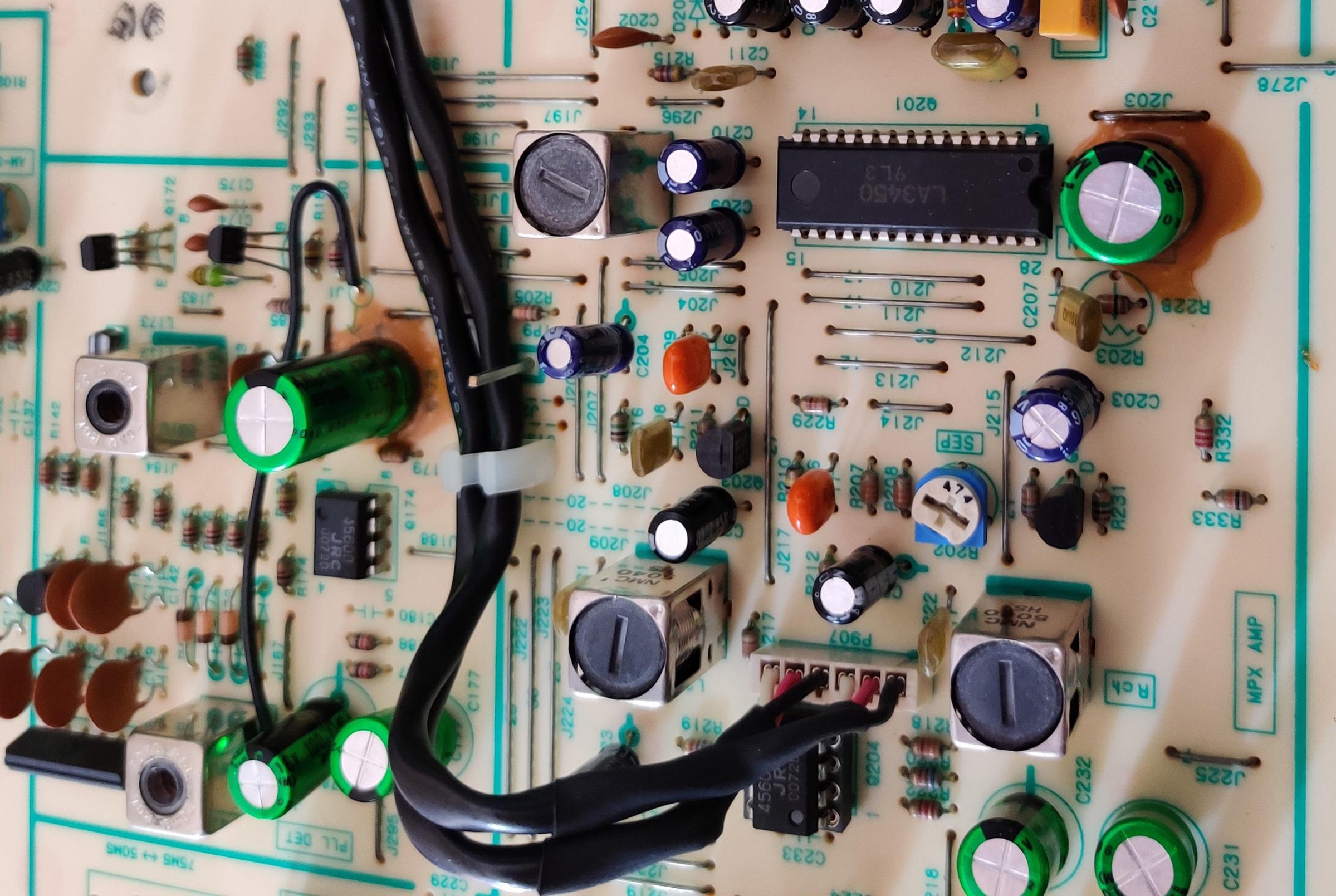

I had very recently swapped the discussed NJM4560 at the output stage of an Onkyo tuner in search of a possibly better subjective result. Stands after the PLL FM MPX Stereo Demodulator IC with low pass filters in cans and a wired 3.3K volume pot in between. There are Sanyo coupling caps before each channel's filter and at the audio outputs. As well as Nichicon BP local area rail reservoirs/decouplers in the vicinity.
I tried many types, NE5532 and OPA1656 included. The NJM4580D reminded the original sound of NJM4560D but with some treble oddity. The Texas NE5532 was more alive in the mids but without equally strong and detailed bass or depth. The original showed a dry midrange though. The NJM2068DD was on a par with the NE5532. Interestingly better than both was the uPC4570C. Cleaner and more dynamic. OPA2604 was nice but bit dark without enough top and bottom extremes. AD823 was nicer. OPA1656 was a clear cut above all those until the LM4562 went in. This one suited the tuner best for classical with bigger stage dimensions while keeping the original signature details and depth but fleshing out the lower midrange. Surprisingly the unrelated OPA2134 came second best while friendlier to more genres. The LM833 finished last having a problem sounding like broken. Probably RFI escaping from the low pass filters or some pilot tone remain upset it. OPA2156 came second last sounding lean and wiry. Maybe too fast for this layout.
As a conclusion, we can never generally tell. Each application has a favorite.

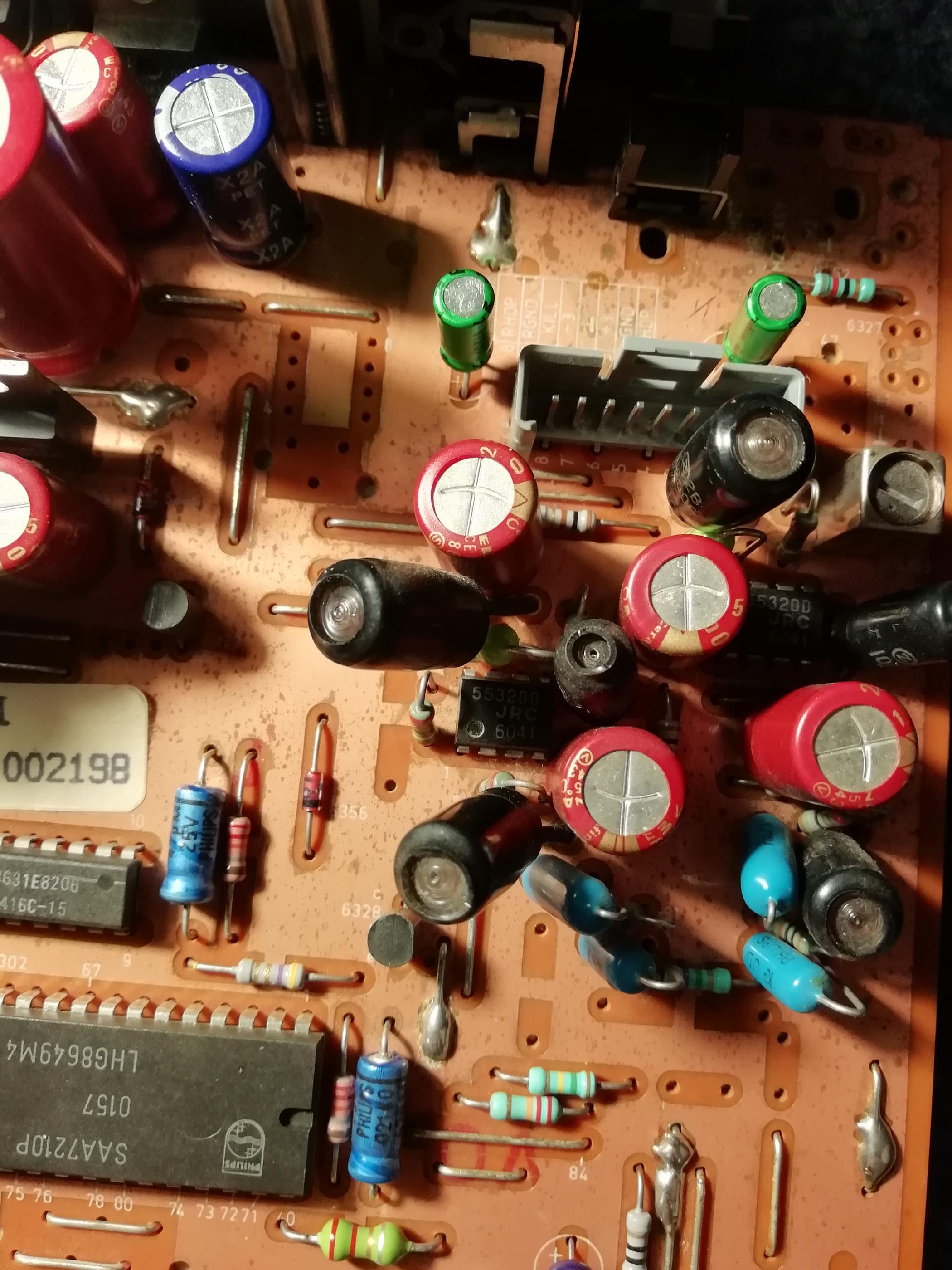

Are you planning on replacing those old Nichicon Muse caps?
I've always found them to be very leaky nowadays.
I'd also get rid of that glue on the board, probably my paranoia on it becoming conductive though

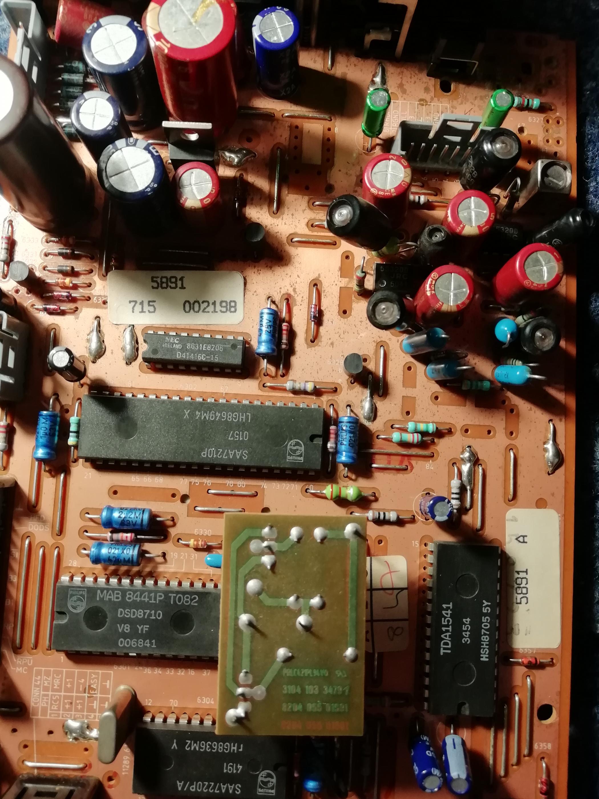

Tried them all with onboard capable ESR meters and they hold greatly in this unit. The glue can be toxic to wire jumpers but not in all cases. I have seen it eating away wires in Yamaha and Luxman. Different glues it seems.
That's good to hear they're all good. To be fair I usually find those in amps so a warmer environment.
I take note of the glue in Yamaha and Luxman. Still never seen a Luxman yet as they're not so popular here.
NAD and Cambridge Audio are terrible for lead corroding glue FME
Rotel also I think
