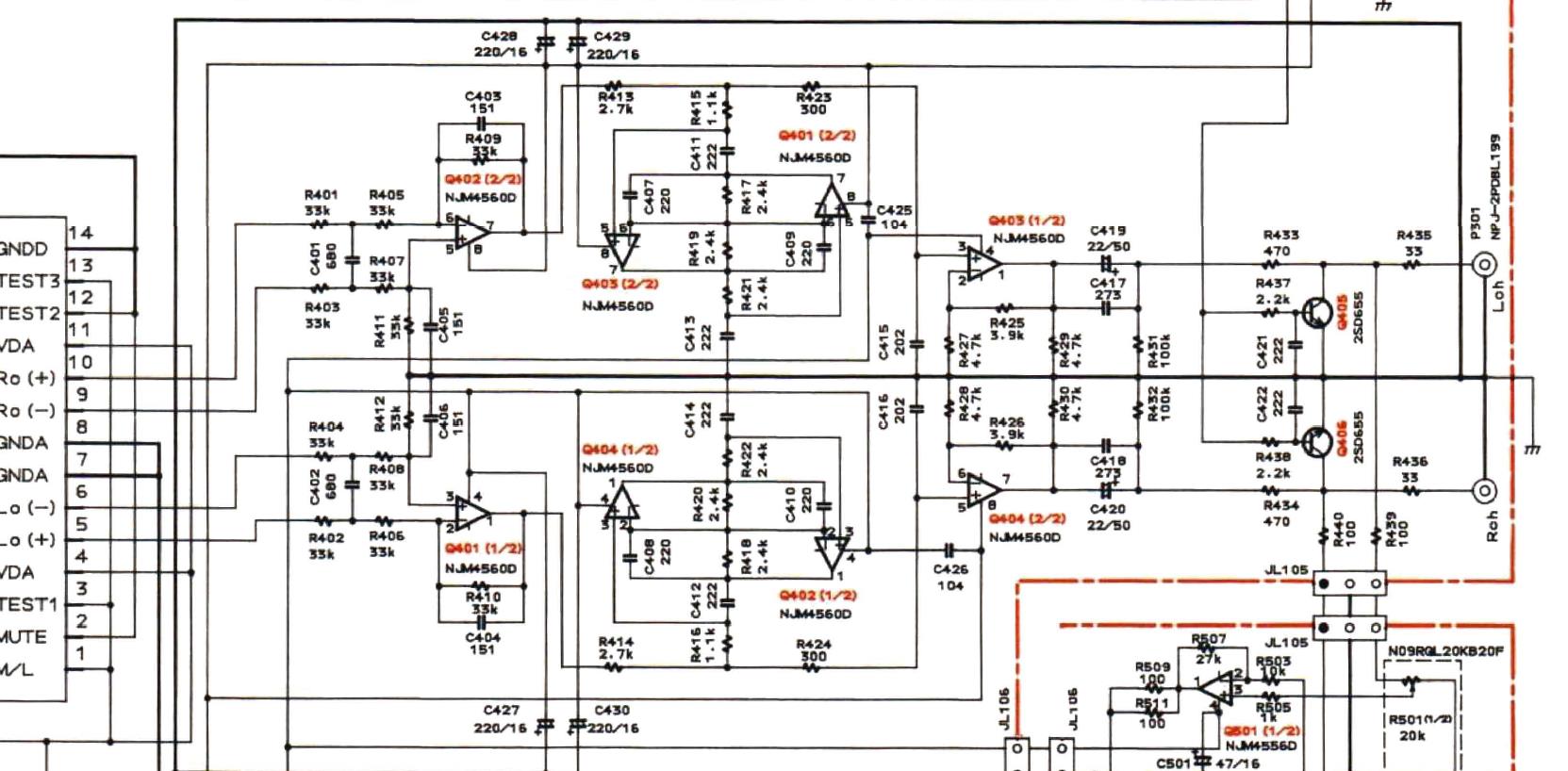

Hi guys,
I recently purchased a used Onkyo DX-710 (1993) CD player. It's a decent unit but i think its sound is a bit shrill, strident and steely at times (especially with female vocals) which makes it often unpleasant listening.
I would like to ask for advice whether I could get something better out of this CD player by some Op Amps rolling there...
I opened up the unit and I see a bunch of transistors laying around as well as four (!) NJM4560DX op amps (DIP-8) near the RCA outputs.
However I don't have the technical expertise to decide whether those 4 Op Amps are related to the analog signal processing at all (i guess they are but that's just my guess) or there may be other components doing that, or both.

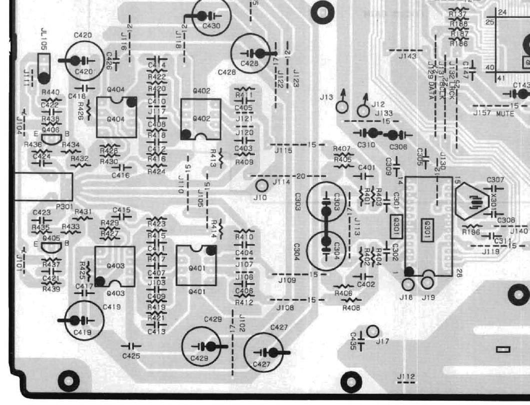

I thought to upload here the schematics, block diagrams and Printed Circuit Board drawing plus the parts values, maybe someone could identify and advise the best route on this for me.
The 4 NJM4560DX op amps are marked as Q401, Q402, Q403 and Q404 in the service manual.
I also found close to them the capacitors C425, C426 which are 0.1μF and appear to be bypass caps maybe (i found continuity of those caps with pins 4 and 8 of all those 4 Op Amps), maybe there are more ...
If any of those Op Amps worth to replace, I'd wanted to kindly ask whether modern Op Amps would fit the circuit (NJMs have quite low slew rate and frequency compared to newer Op Amp designs as far as I can see..)
I'd appreciate any help, if you need more information from my side I'd be happy to provide it.
OK, attached are photos of the output stage schematics and circuit board (for easier view by forum readers).
Yes, the four opamps are related t the analogue output stage.

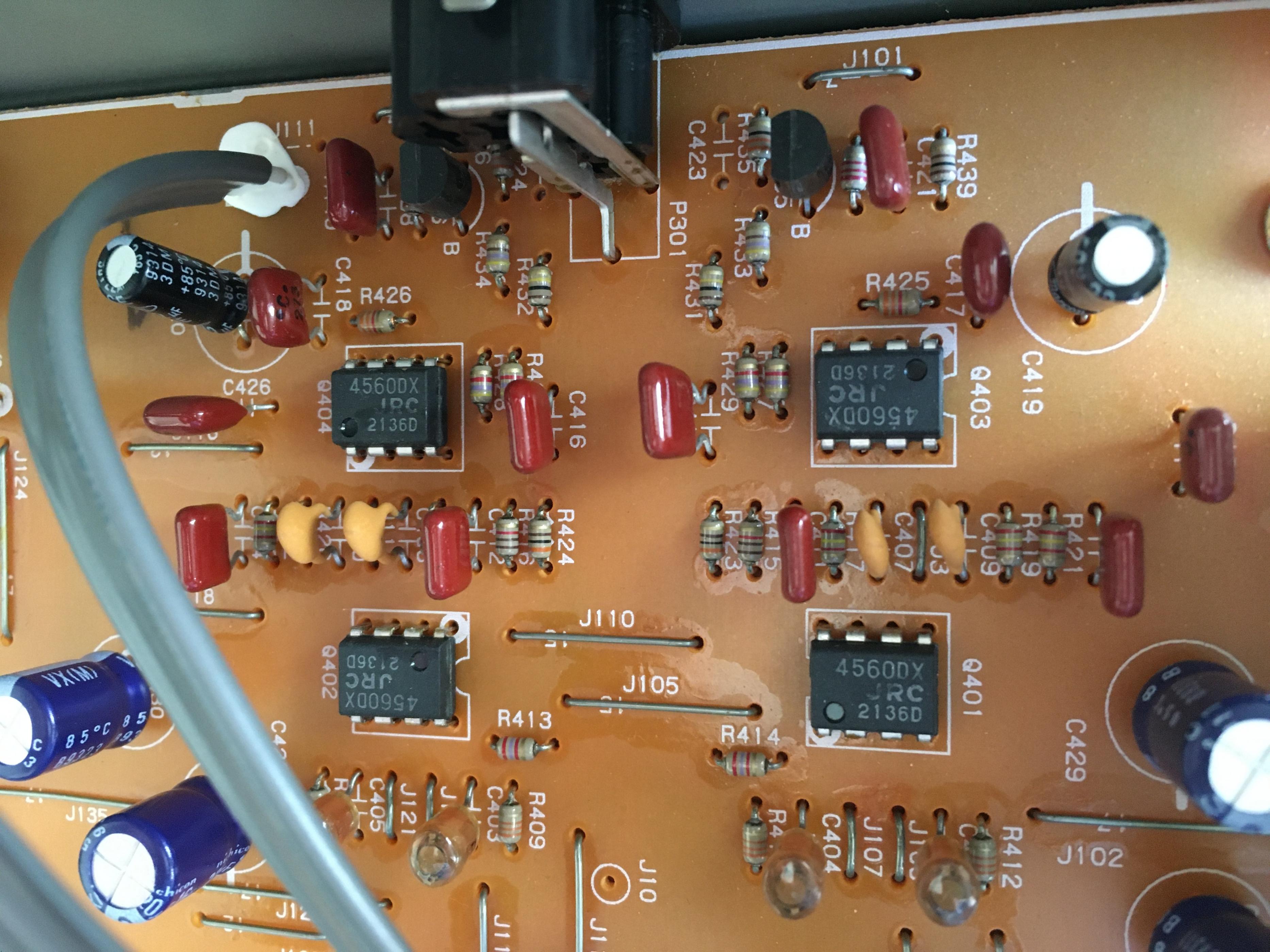

I have no issues working with soldering (recently built 3 phono preamps and soldered opa1656 SOIC-8 chips onto browndog adapters 🙂 ), neither with player disassembly (actually I'm preparing to replace the laser pickup unit on this cd player later today).
I just have difficulty to read complicated schematics like these ones and understand what each component does and why...
My reference player is a Marantz CD6000 OSE but i would not be fair to compare this Onkyo with the Marantz.
I do compare it with another budget 5-disk CD player I found at the local goodwill (Sony CDP-C345) , and that Sony sound is much more balanced than this Onkyo.
Simply I would like to keep this Onkyo as my everyday player.
(The Marantz is still in my possession but far far away.)

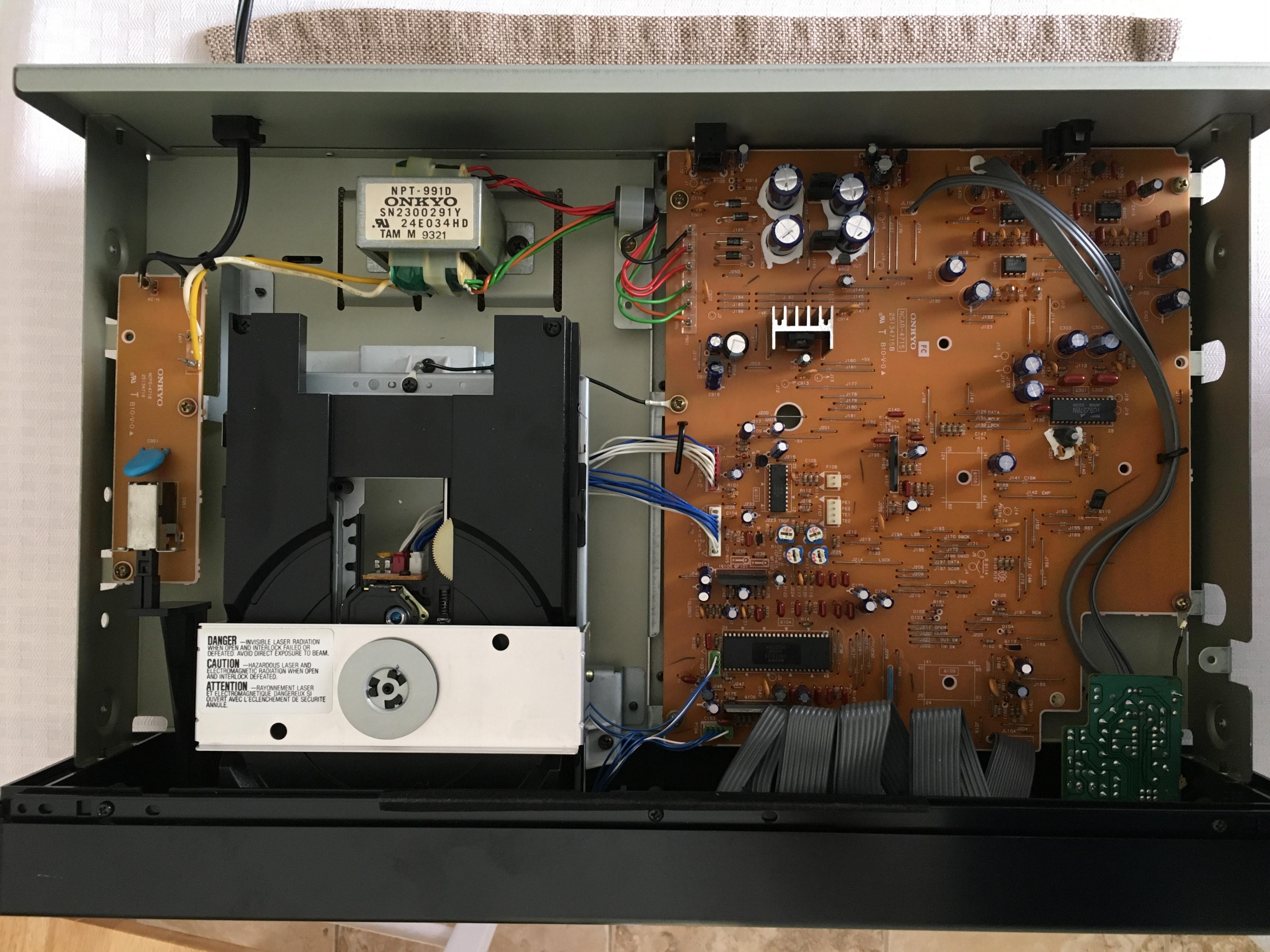

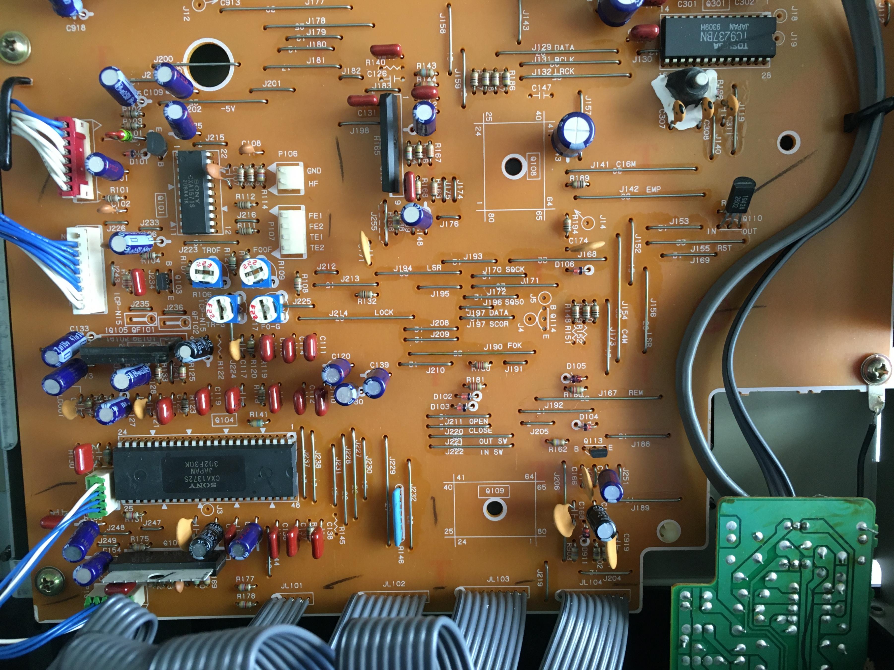

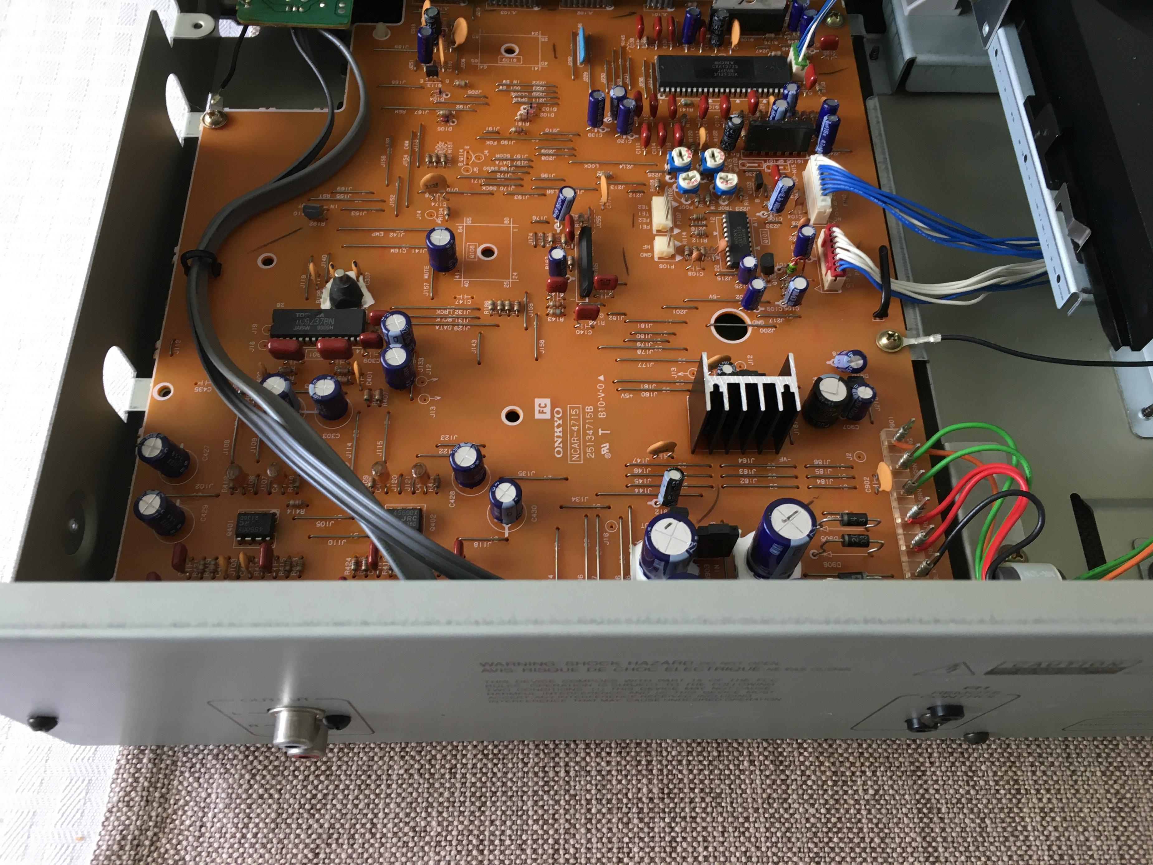

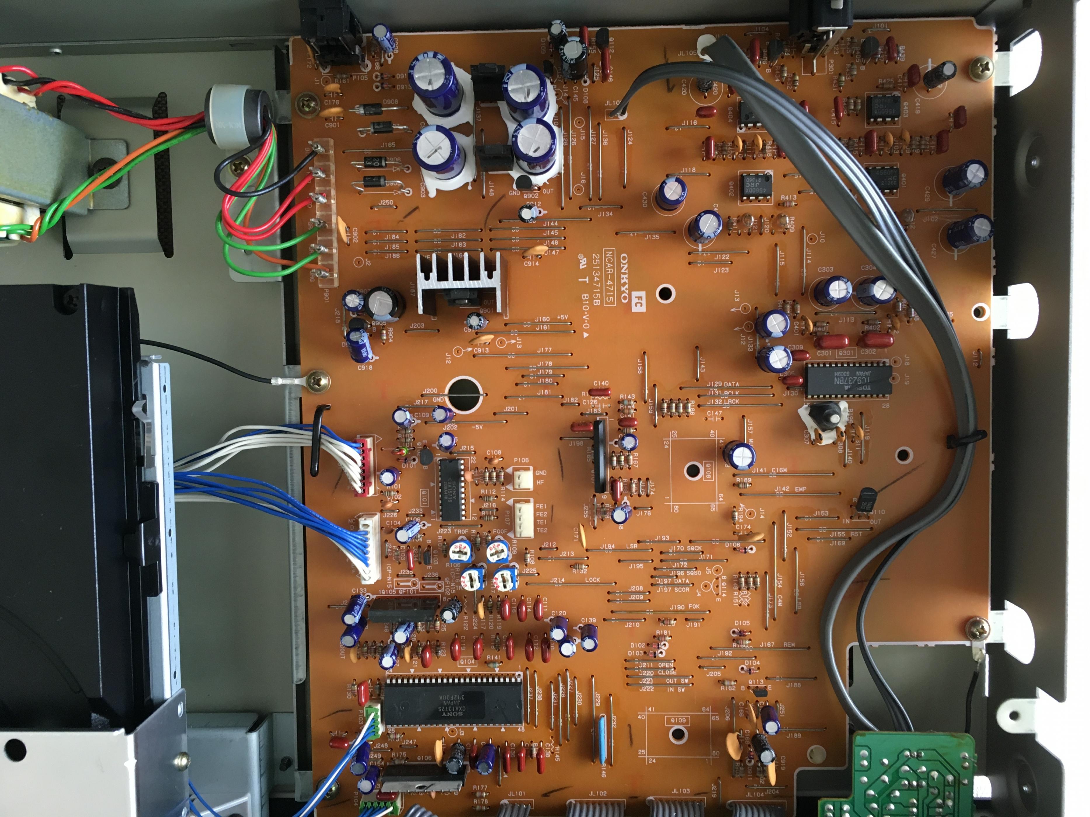

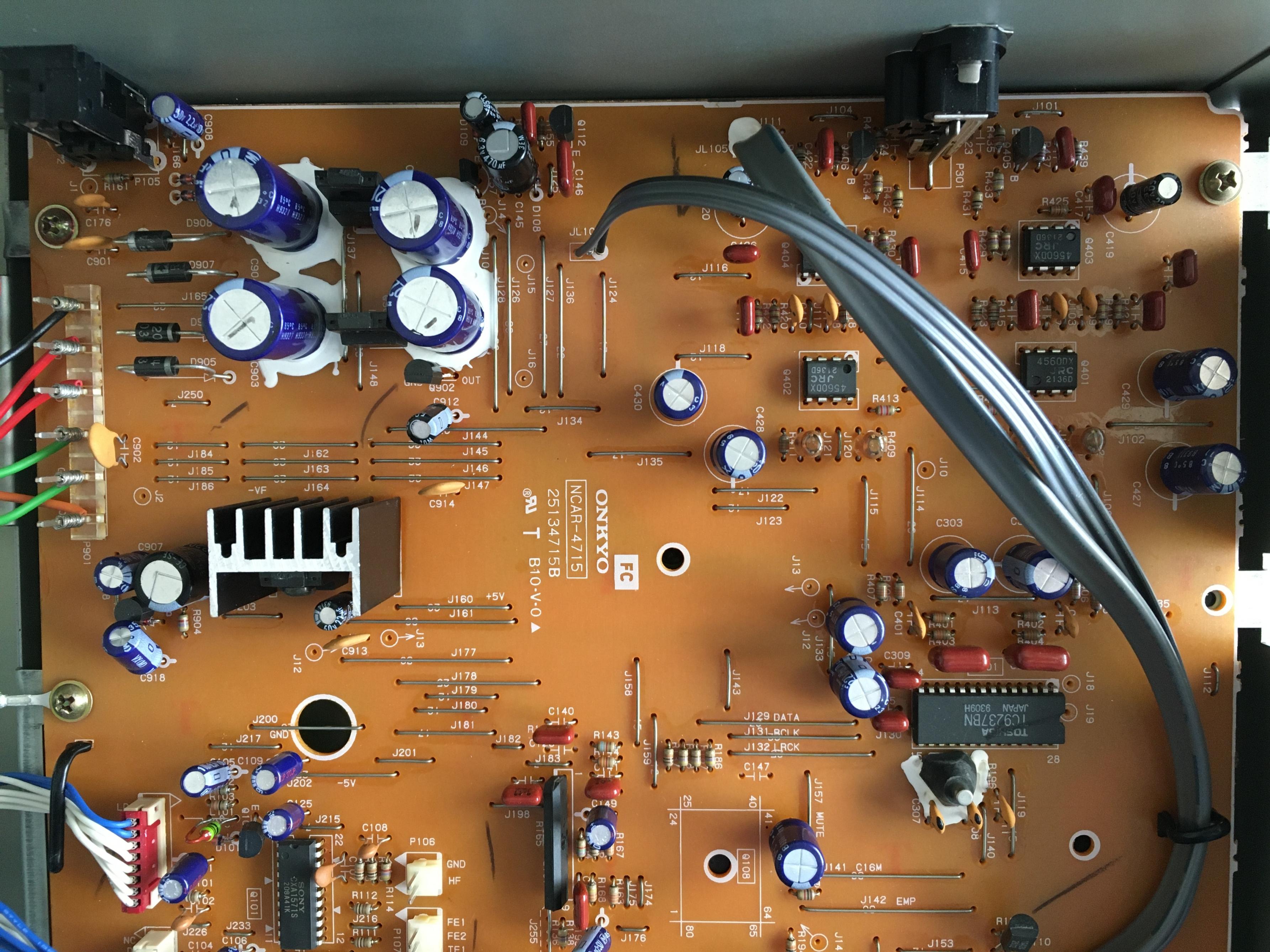

Uploaded the photos of the player internals...please let me know if everything else needed from my side and thank you so much for helping out!
EDIT: Please right-click and open the photos in a new tab to view the actual full size of it.
OK, two next questions:
- how important for you is the "blackness of digital silence"? Background of the question is that the DOS output stage increases probably the general noise floor a bit, the question is - can you hear it and is it that important for you.
- have you ever tested listening to different opamps in some simple (one chip) test device? I.e. do you have any preference among the opamps.
Why not fit some sockets and then you can try some different opamps. I'm going to suggest you try the old TL072 FET opamp. Although old these devices offer excellent audio performance and were the device of choice many moons ago.
If anything is going to take an edge of things and offer a more rounded performance then I think it would be something like these.
These device are often criticised for poor drive ability but I would argue that you should put some numbers into that first... the CD player will put out at most around 3 volts peak and so given an output current of say 10 milliamps that means you can drive 300 ohm load. So no problem at all there.
Others to try would be the OPA2134 series and there are countless others as well.
About a year ago I had a free afternoon and did a listening test of a (roughly) dozen opamps from my "drawers" (using a Marantz CD-67 as a test rig) - TL072 sounded surprisingly in the top ranks but TL082 sounded just a tiny bit better.
Edit: I forgot to mention that before swapping the opamps I would fix their power rails, remove the muting transistors from the signal path and replace the output capacitors with film capacitors (Wima MKS being the cheapest option probably).

I took a look to schemes.
NJM4560D (Q401, 402, 403 404) are dual OPAMP. Seems you are used with browndog adapters. OK. Just try different ones and trust your ears.
Begin with 5532!
Their power supply is +/-5V (Q903/Q904 - 78M05L/79M05L). Which seems low (IMHO). Their typical voltage is +/- 15 V (from datasheet). I may suggest you to replace them with 78M15L/79M15L or 78M12L/79M12L.
DC blocking caps are C419/417 and C420/418 (22µ/27n). You can replace them with "better" ones as Elna, Muse, MKT, MKP,...
But, IMHO, the more important is to replace Q901 (78M05L), regulator with heatsink.
Its output currant is up to 0.5A. You can replace it with LT3045.
There is insufficient raw DC available to use 12 volt regulators for the analogue stages even if you wanted to, in any case the +5 volt rail analogue supply rail also operates the mute circuitry which would not take kindly to running on higher voltage (it has 6.3v caps)
