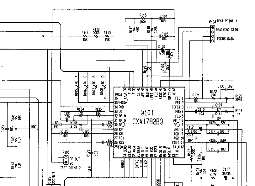

I have a Onkyo DX-7333 CD player, which sometimes doesn't recognize CDs.
I don't think it's a laser pickup (KSS-213C) problem, because when it recognizes the CD, it plays it without a problem, even very scratched ones.
The next thing is, it should play CD-RWs, but it doesn't even recognize them.
I think it needs adjustment
There are two pots on the main PCB - Focus Gain R123 and Focus Offset R112.
Also there are two test points:
TP1 4 pins, first pair labelled Tracking Gain, second pair Focus Gain
TP2 2 pins labelled RF Out and VC
But in the service manual is no description, what should be measured on the test points and how to set Focus Gain and Focus Offset.
In the attachment is a cut out from the schematic, where the test points and adjustment pots are.
Please if someone knows, how to?

I've downloaded a bunch of SMs for other Onkyo CD players, fortunately the procedure is (mostly) described there.
The CD player now recognizes only the Test CD and one music CD (not always), no other CDs, no CD-Rs.
The "eye pattern" on the RF test point is only 0,6-0,7V. According to other SMs it should be 1,2V+-0,3V.

If the lens is clean then most probably yes.
The next step would be to check the laser current. Usually there is a low value resistor where the volt drop can measured and current calculated. KSS pickups often have the current for that pickup (that it was calibrated too) as the last three digits of the serial number on the pickup. eg 123456529 would be 52.9 milliamps. If its increased by more than a few percent then suspect the laser.
That figure is a guide that the laser diode itself is drawing the correct current and that the optical output power is correct.
There can still be many other causes of low recovered RF. Is the lens clean ?
Have to ask.
The focus bias (offset) pot can be tweaked when playing to get the highest amplitude RF.
You may just have a faulty pickup (photodiode array problem or internal contamination etc).
I have cleaned the lens, in fact it was the first thing I've done.
I have tweaked the Focus Offset to get the mentioned 0,6-0,7V, it was off about 15-20° on the pot.
So the next logical step is to buy a new laser pickup?

A new pickup has to be the next step.
This goes against a lot of advice but having made the diagnosis... why not try tweaking the laser power to see if the level comes up and what the new current is.
Final thought on the scope measurements. Are you using a divider probe (you should) to minimise loading on the signal. At these frequencies the capacitance of the scope/leads is a major factor.
No need for a cable if the old one is undamaged.

There isn't much else really. A problem with the RF amp but I've never ever heard of that or come across anything like that... small signal electronics are supremely reliable as a rule. A problem with the focus bias... but you were able to adjust that "normally" in that I assume the best level was achievable without the pot being one-ended.
You have to go with the pickup being faulty.
