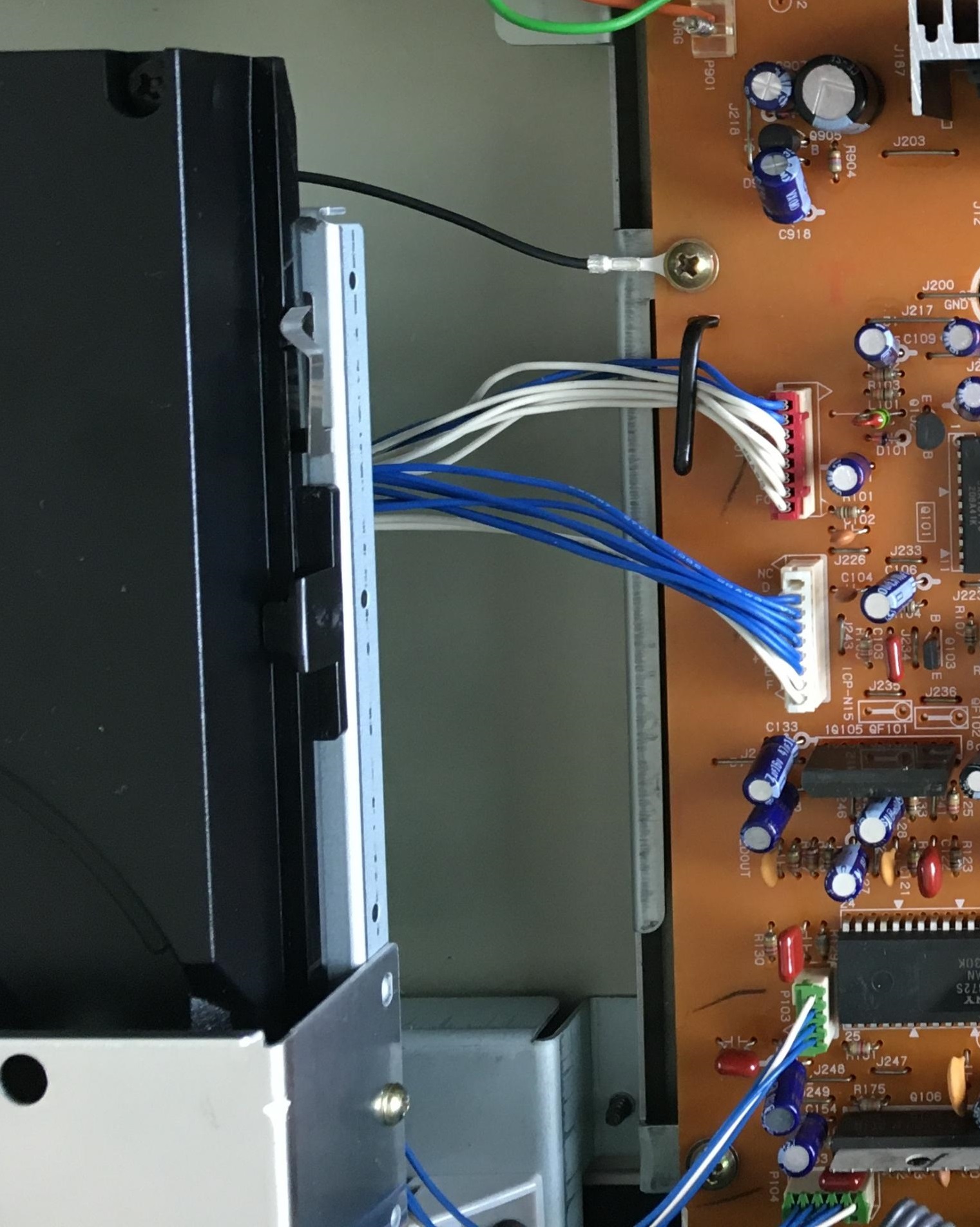

I'm trying to mod the DX-710 that my father left me, i would like to change the power transformer and the old cd reader(player/lens) that is giving me some problems while reading the discs (skipping, rewinding).
I have so many questions.
Which characteristics do i need to look for the correct power transformer?
Can i replace the cd reader(player) to any other model or do i need to replace it from the same model? Should i be careful about which lens i'm going to buy for it?

There is some rust inside the power transformer and even inside the bobine/cable
If it's custom probably i can't replace it...

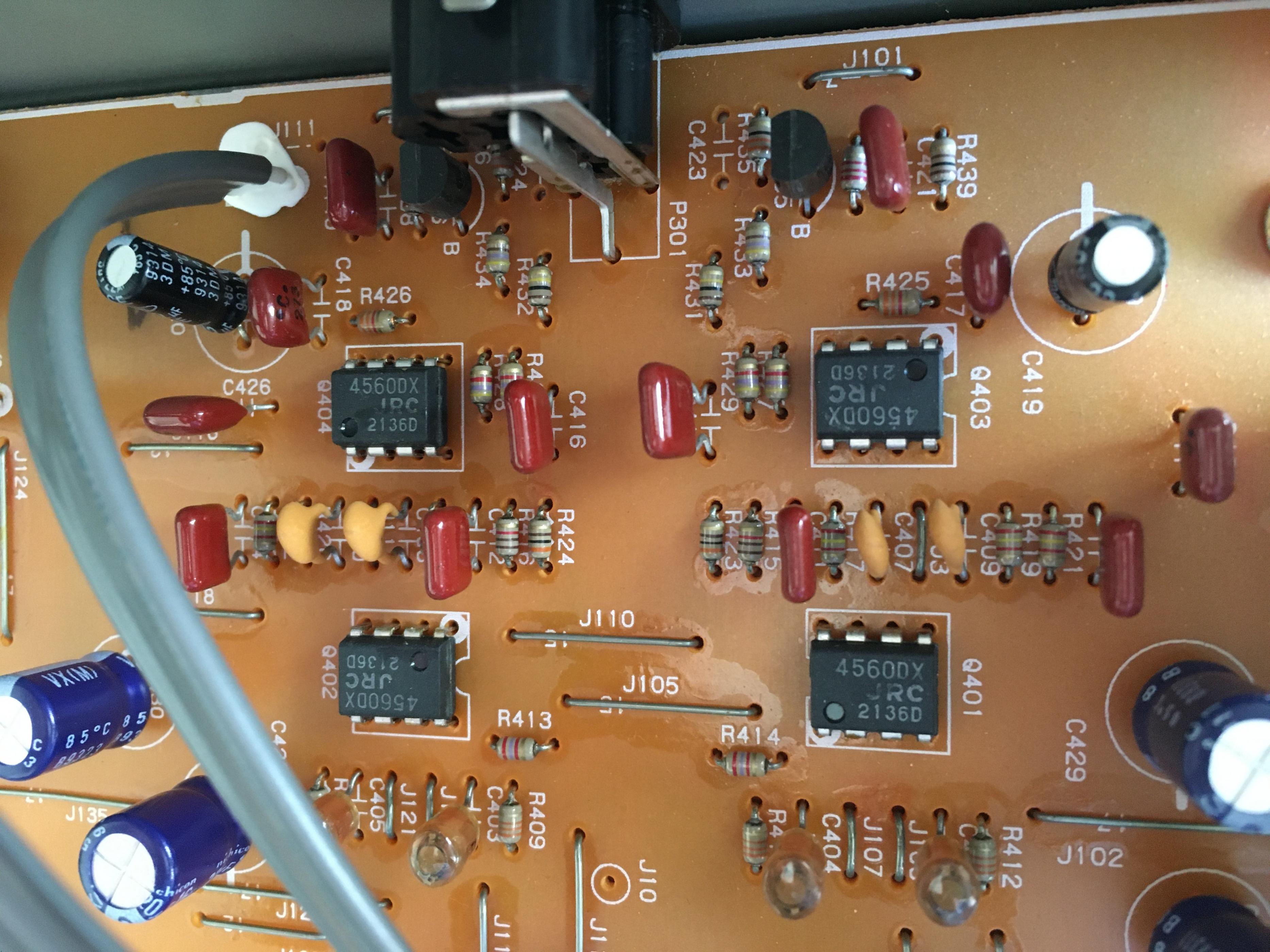

I was looking in this other thread and safe1 did a superb job with soldering and trying new opamps.
I've already 2x burson vivid 6 dual to try on this Onkyo, are they compatible?
I was reading in the safe1's thread that every opamp have different voltage, are the burson compatible or should i go with the ones that he mentioned?

For something you can replace for $20, you are taking a lot of trouble.
Clean the CD lens, clean off the rust, put varnish where the rust is removed.
Tell us which op amps are there already, may be good enough, no need to replace.
And also let us know how experienced you are, this is not a basic job.

The opamps are the JRC4560DX (the image is from safe1)
I've no problems with soldering/desoldering, i already tried to clean the lens in the past and it didn't fix the skipping/rewinding
It's possible to mod the isolation transformer or is it a no go?
The cd player should be replaced aswell (or the lens)

Change the entire mechanism?
Or buy another complete set for less money.

He meant replace the whole mech (like for like), but the problem still remains , the "new" mech needs setup with the aid of a scope.
You can't replace the mech with some other random mech, it has to be a 210 based mech (with the exact same chassis - there a few different variants)
Japanese sets used Sony and Philips mechanisms a lot, Toshiba also made them.
They were a bought out part, so many Japanese makers made CD players, but the mechanisms were pretty nearly purchased as a bought out item, as it allowed economies of scale.
So you can start with the hint that it was a 210 based mechanism.
