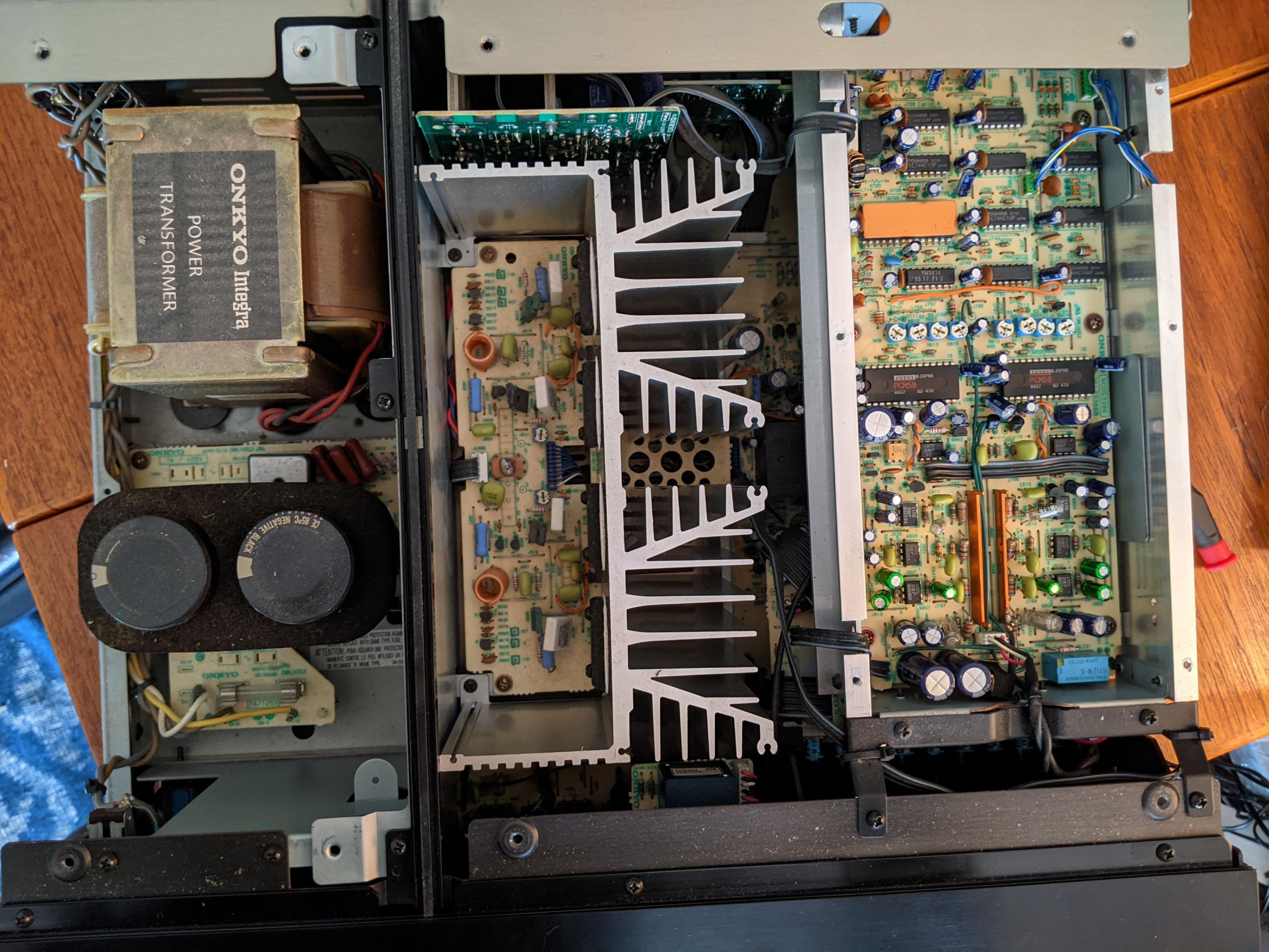

I recently picked up an Onkyo A-8800 from someone who said the "digital filters" were broken. I thought he meant there was something up in the DAC board but it turns out the real issue is when the selector dial is turned from "direct" to "tone" the left speaker channel cuts out except for very high frequencies, and when turned to "tone + processor" both channels get very distorted. I'm decent with electronics but have never taken apart an amplifier before -- where should I start?

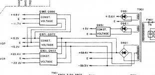

So now you need a power supply check/confirmation
Get the service manual and check/confirm them all are present and correct.
That’s all the supplies listed on attached pic

So I have some updates on this and some new questions. I received some fun things in the mail today, namely deoxit, a multimeter and a SP/DIF cord. First the results of the digital section: it works! But it does not sound great. Not static or distortion, just not great sound. I think this is most likely because I sent it digital audio via my laptop’s mini-DisplayPort -> HDMI adapter -> HDMI to crappy 2013 Samsung TV -> TV SPDIF out. I am receiving a marginally more expensive USB -> Sp/DIF adapter tomorrow so I can report how that sounds. The digital section DOES exhibit the same symptoms with the tone controls as the analog section.
Onto the DeOxit. I pulled off the knob for direct/tone and tried to get a little deoxit down the shaft. I don’t know how much I succeeded but whatever I did it didn’t change anything. I also removed a considerable amount of corrosion from the speaker terminals and the inputs. This had a noticeable effect on sound quality, and resolved some distortion I had been hearing in the phono section.
I also measured DC offset at the speaker terminals and got a remarkable .6 and .4 mV. I haven’t gotten a chance to measure voltage at the power supply yet but I really do think it will be in spec.
This all does leave me at a bit of a crossroads, though. I want to try more de-oxiting of the front panel but to access the rear of it I think I have to do a bit of disassembly. There’s a post on Audiokarma of someone who had this exact problem with the European model number for this receiver (A-8069 I believe). He disassembled everything and tried taking apart the switch, and when he put the amp back together he had a lot of trouble with the ribbon cables and had to solder on new sockets for them. I have no interest in a complicated solder job like that, especially since the section of the amp I care about seems to be working perfectly. I have a separate Yamaha CX630 preamp with tone controls and a phono preamp in it that I can use instead of the internal one here. Currently, it sounds better than the one built into this Onkyo, though I don’t know if that’s because there might be something wrong with the Onkyo or if the Yamaha is just better. But in the end, it’s looking like the only practical reason to fix these tone controls are because I like things to work (true) and for the digital section, which I don’t even know if it can sound as good as the analog section. And I don’t want to go any farther into the amp and break the part that is working right now. So if this is going to be a very difficult task I’m not sure I want to do it.
