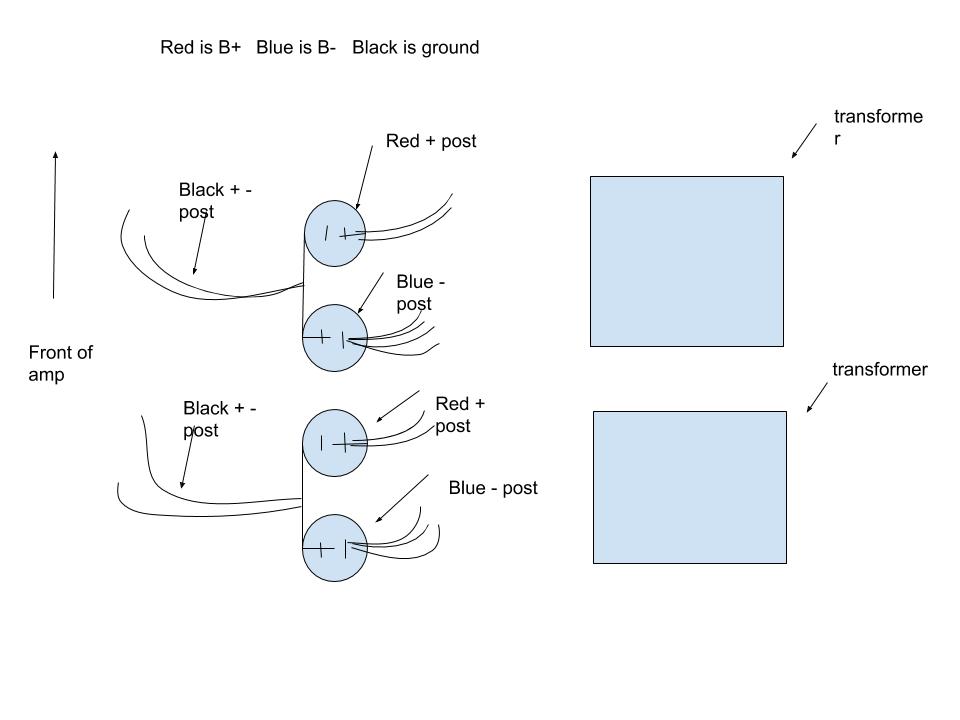

What Im gather it should be? Not what it is now.

If your colours are correct, the red lead goes to the anode of the rectifier (+).
The black wires go to the cathode of the rectifier (-)
The blue wires go to the transformer. The other blue wire probably goes to the chassis. The other red and black wires go to the amplifier sections.
Does that make it easier Bob?

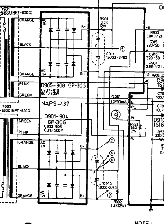

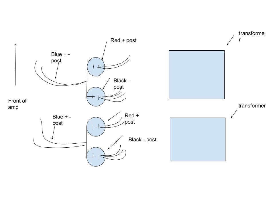

Okay, I see. I have redrawn it hopefully its right this time. Still, confused about the original cap set up. I have confirmed that the Blue is B- and Red is B+ Black is ground.
On the original filter cap, I can confirm that Black wires were on E post, Red wires were on + post and Blue wires were on - post.
Thanks for all the help guys! Id be lost without this site.

I did yes and sold it. I didn't care for the sound of the A10. Well to start out with, I'm an idiot and just had the caps wrong. IDK which filter caps I used but to me it doesn't really matter as long as the voltage meets or exceeds the original cap. Also the value (uf) should meet exceed to a certain point. For my projects I usually stick to Panasonic caps just because there good and cheap and I don't believe in audio voodoo, wizard, magic, cult, trash. I'm an idiot but I'm also a genius in most ways so I don't mess around. A lot of people here think certain caps will bless their lives and bring them a vigorous glory.
