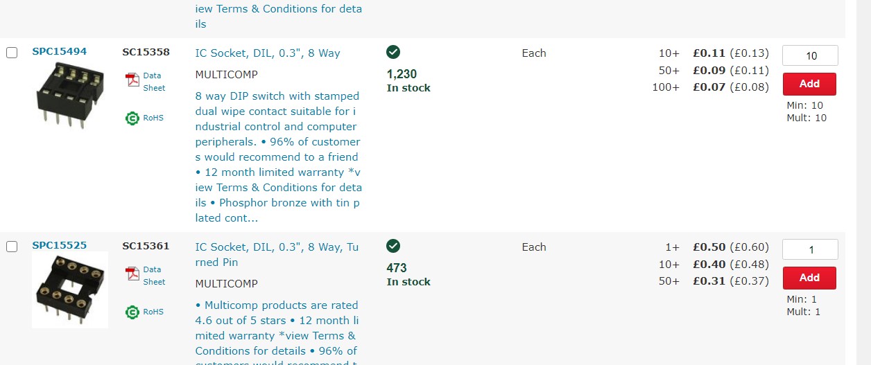

I think the 4580D now in the 7030 shows "thru hole" at Mouser. Does this mean desoldering - and then putting in the socket you mention?
Any links to how to desolder these tiny items and the socket required are appreciated. I will research myself though - I'm retired so have "some" time on my hands.
I have some desolderong braid, if that's the right term (from doing the aforementioned capacitors)- but doing so is a bit scary. The 7030 is budget end so any loss is not the end of the world, I might just have to research replacements 🙂
My soldering iron may be too bulky for the task as well - it's a basic Radio Shack.
Thanks again.
Through hole parts (DIP8 package, they are the big ones 😀) are easily desoldered from single sided boards using braid. Practice if you can on something of no value like an old remote etc.
Use a hot iron and a big tip that holds the heat. If you apply a little fresh solder to the braid/and/or iron tip and then just firmly press it and the braid against one leg at a time the solder should come off instantly.
All 8 legs of a DIP8 can be unsoldered in around 10 seconds once you have the knack.
If the board is double sided then you are probably best snipping each leg of the IC with close cropping cutters and then removing each bit of lead left in the board using heat from the iron and a gentle pull with pointy pliers. Then clean the hole using heat to melt the solder in there and poking a bit of stainless wire (solder won't adhere to that) through at the same time. Then use braid to remove the excess solder the wire has pushed out.
Then fit your sockets. There will be a little identifying mark for pin 1. Although it doesn't matter electrically for the socket, it most certainly does for the chip and so its good to have sockets fitted with the correct orientation.
And a tip... when you remove an IC from a socket gently lever one end and then the other alternately a mm at a time until it is free. Lever it out in one go and it will suddenly release bending half the legs at 90 degrees leaving the other half painfully embedded in your finger 🙁
