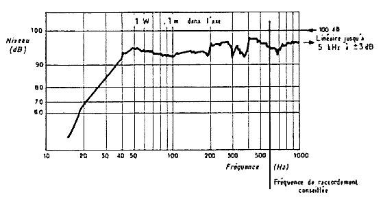

You need look no further than the peaking Fb and lumpy measured response above it in the French magazine's article.
This is the only one I've found. It's from 1977. Is that the one you mean, or have you seen another?
That's the one and it's much better looking than some I've seen designed for other drivers. IIRC, Bill Woods (RCA fan) posted some along time ago on the HE forum. Not having the kind of measuring capability ya'll take for granted these days and no known/imagined need at the time to record for posterity anything I did beyond converting as much of my collected knowledge base into Lotus 1-2-3 spreadsheets as practical/possible, I can only 'prove' my assertions through the efforts of others.

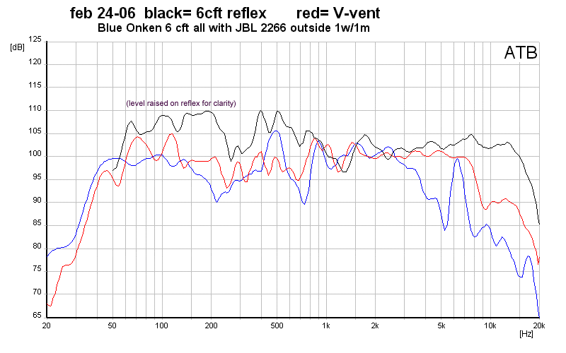

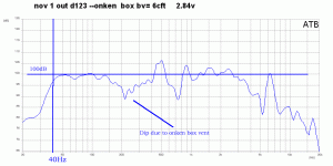

On the subject of other peoples efforts - maybe we can get an Onken owner to measure for us. I'd love to see the harmonics in question. Kevin has one and I think he is set up to measure. Should we ask?
1 meter on axis OK? Ports open then ports blocked, maybe?
Cool, thanks for the graphs! In Bill's graphs only the V-Vent looks really good. 🙂
Maybe we can get someone to do a distortion plot with HOLM or ARTA/Steps. Some single tone FFTs would be nice, too.
Onken W? Nothing special that I ever saw - except those funny little vents of different sizes.

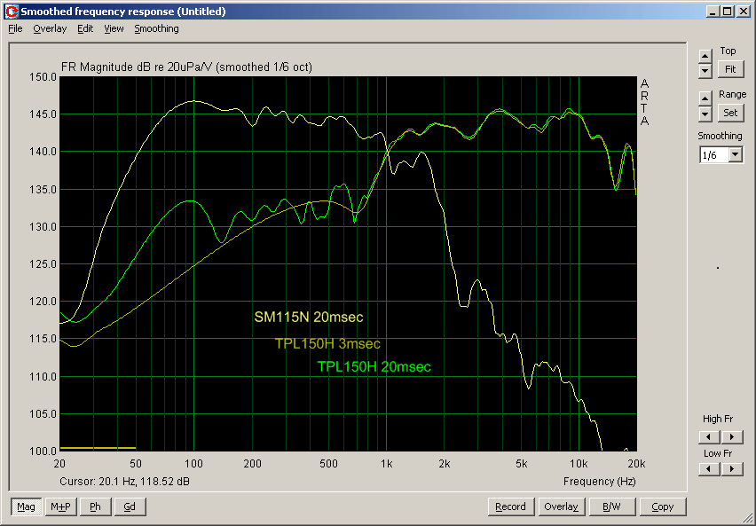

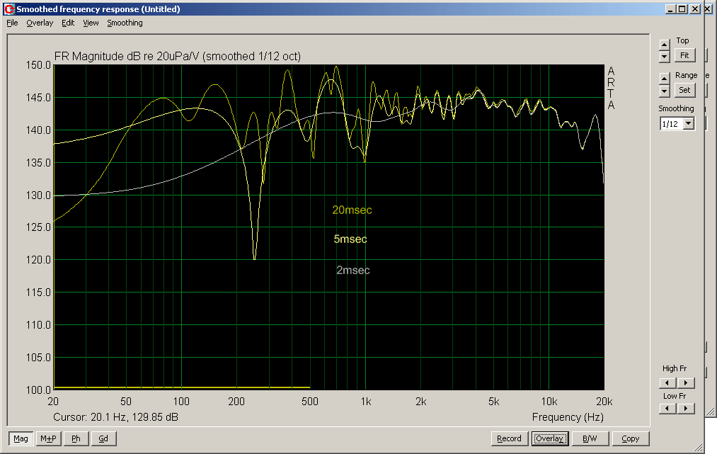

This is very interesting. It's like a decomposition of bass wave movement😀
Take 40Hz, it needs about 2 meter or 6 msec. to reach the maximum amplitude (1/4 wavelength). This reflects the measurements at 2ms and 5ms, but what happened at 20ms? Room reflection? Port-cone cancellation?
Andrea measured at 1.5mtr when i am right. so when you see 2-5-20msec it is easy to predict where reflections are coming from considering the wave length. placement driver to baffle and floor and br-port (phase) with onkenport at front baffle a bit dipole like.
2msec = 68cm 500hz
5msec = 172cm 200hz
20msec= 688cm 50hz
