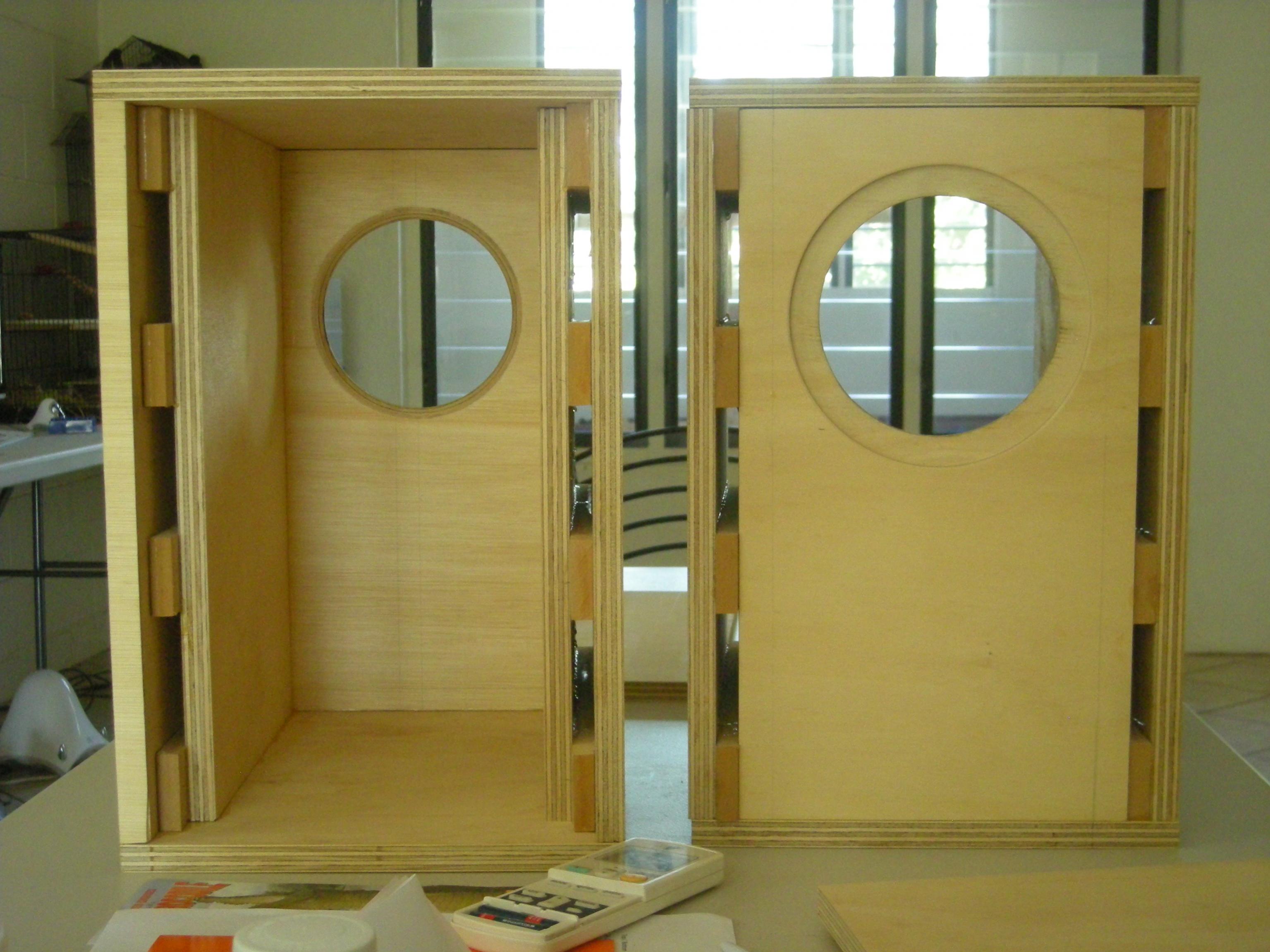

Hi all - so built a mock up of the 20ltr onken type thing, supplied by Jeff. (see attached images). and hooked it up to a daytona T100a and an iphone.
Bear in mind....it's cardboard + I have no testing equipment save a mulitmeter (is that usefull?)
Would be hoping for more bass response + "punch" with wood.

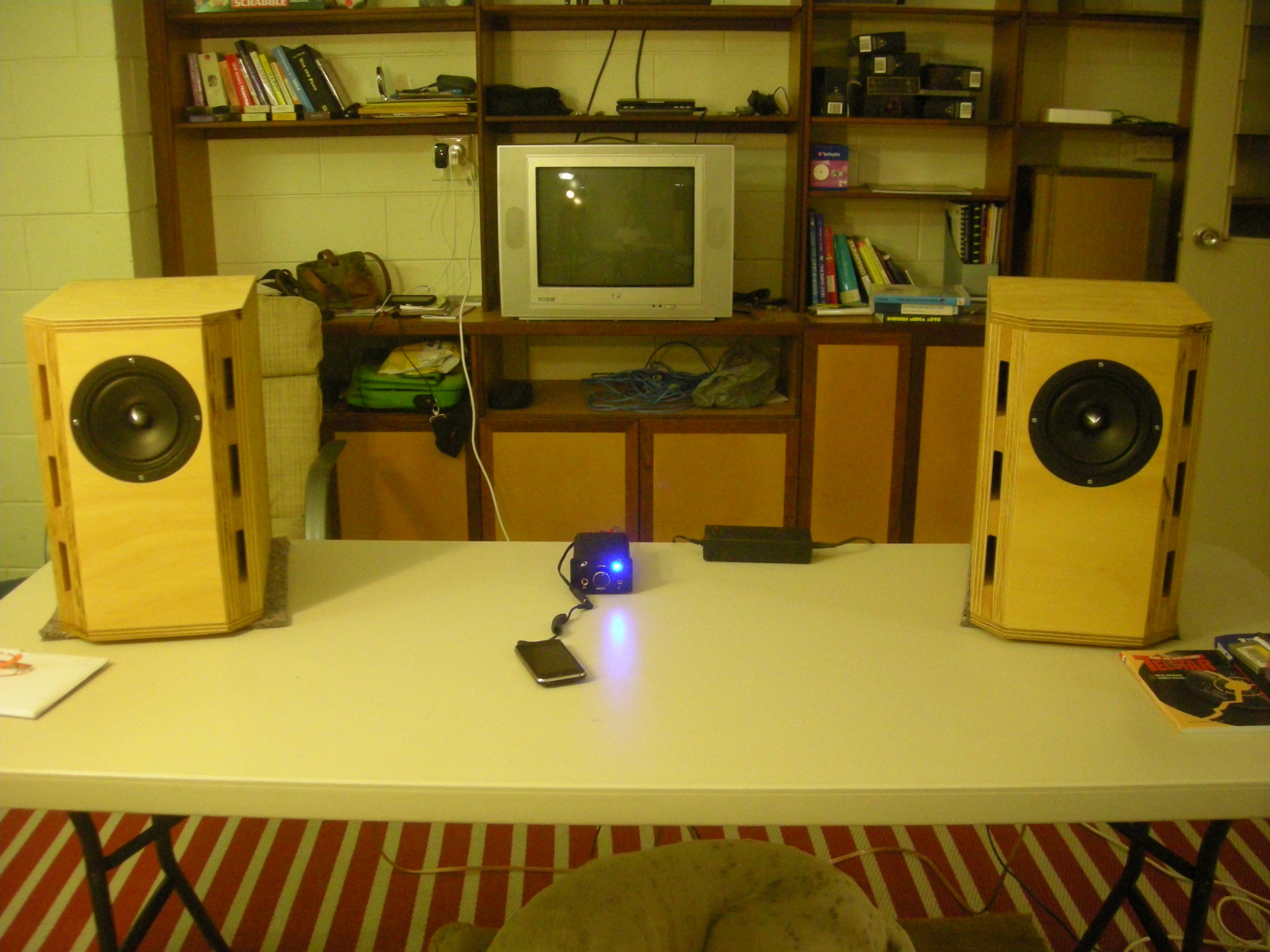

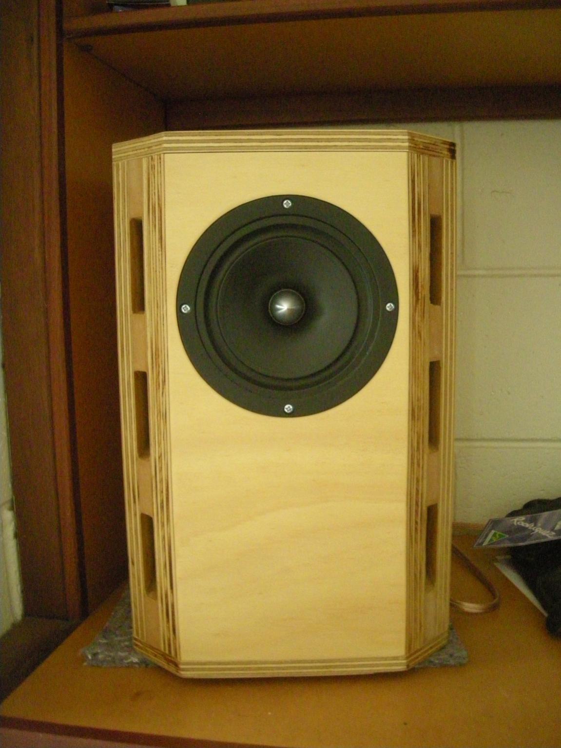

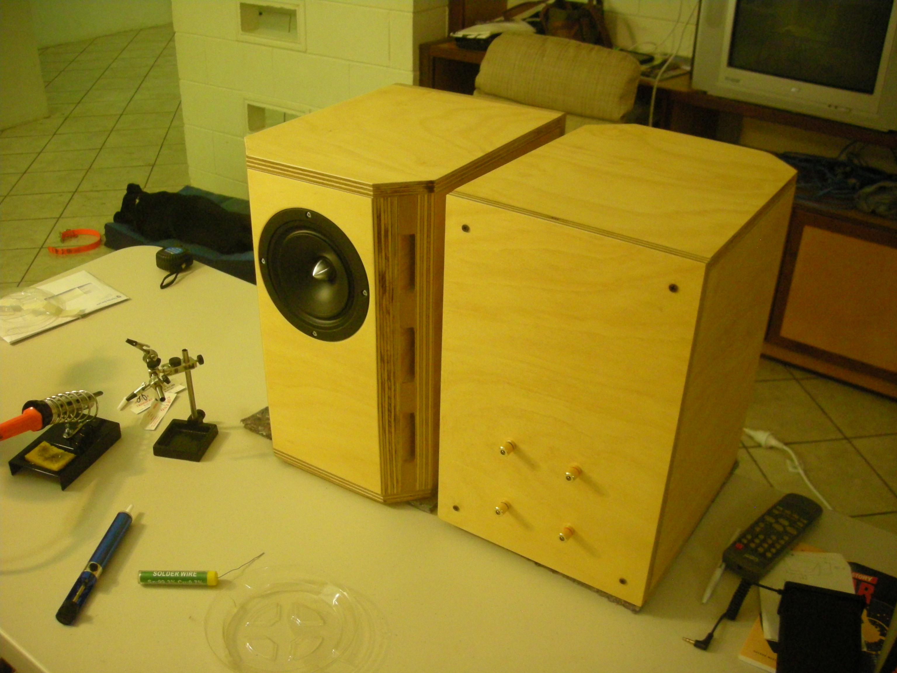

Well, here they are: the fOnken inspired speakers using the Tangband W5-1611SA. It took a while to get the (near) equivalent materials.
They are constructed with a high grade Hoop Pine Ply which will be softer than BBirch, and less laminations. All panels are 15mm, Baffle is 20. Spacers for the vents are MDF. Box constructed then cutting the 45 degrees after assembly.
Dual Posts on the back are in case I decide to be a girl and put a x-over in them with a tweeter on top of the cab. screws in back panel are temporary.

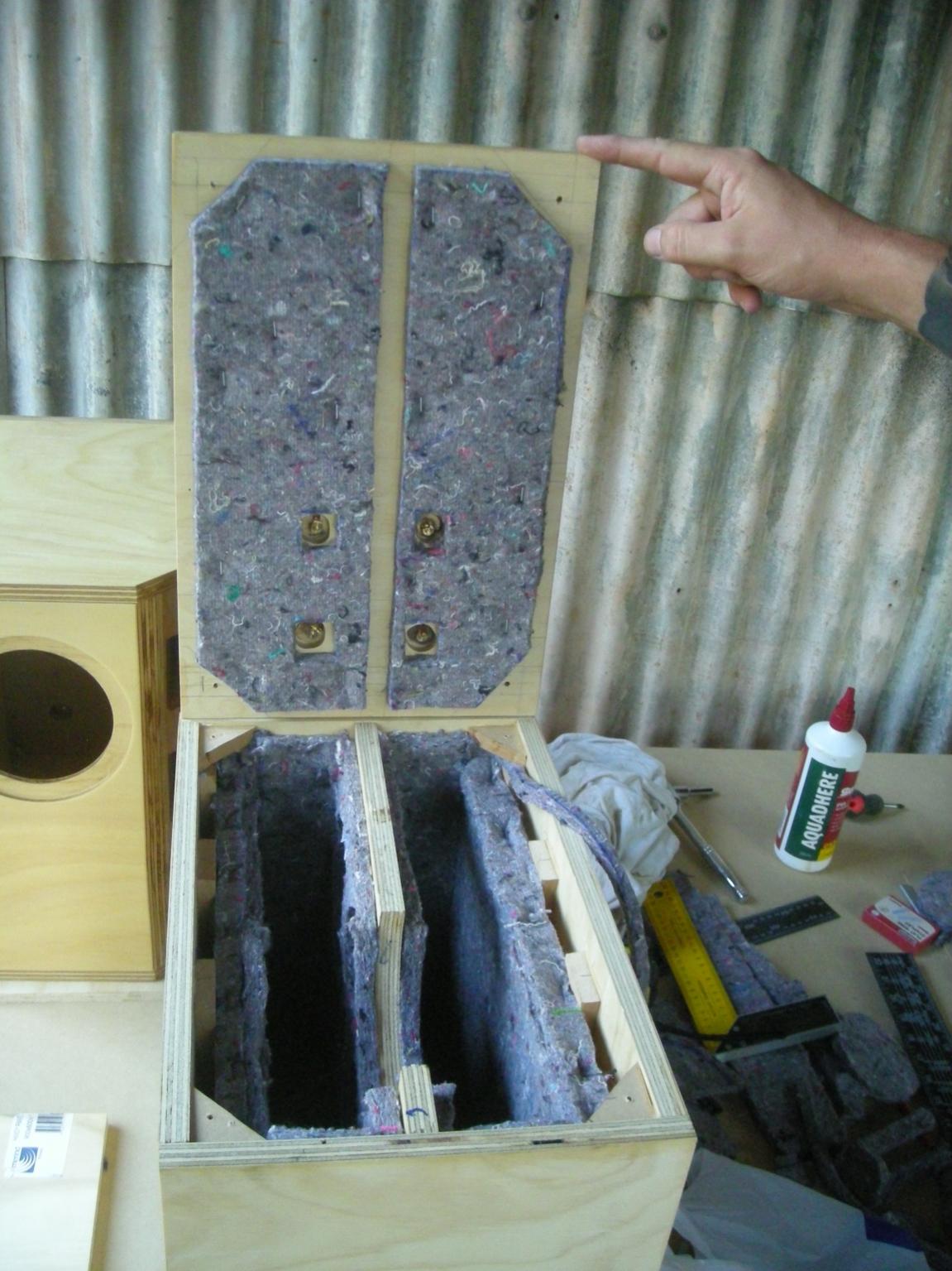

Damping is a wool mix 12mm underlay.
How do they sound?
Pretty good so far. The listening env is crap - (look at the wall in the images).
They are a (v.small) bit shouty - but they are not run in at all, so Ill wait it out.
....Actually they sound bloody great! nice separation, responding well to all manner of music thus far, clear, ballanced and suprisingly good wide frequency response. 😀
Internal wiring is some thick auto wire I had .... I only have that, some "braided" speaker cable and some cat 5.
Should I leave the auto cable in?

I find the (F)Onken good for near field monitoring, the ports exit close to the driver so integration of LF output with the output of the driver happens over relatively short distances. In my case I restricted the ports (slots) to being right next to the driver so I used only 2 slots per side instead of 3. (find my thread on Moon Onken for details).
Nice work - if it's easy to do, I'd suggest trying some thinner gauge solid wire, and it never hurts to give the drivers several hundred hours of playing time before assessing any requirements for filters, tweeters etc.
