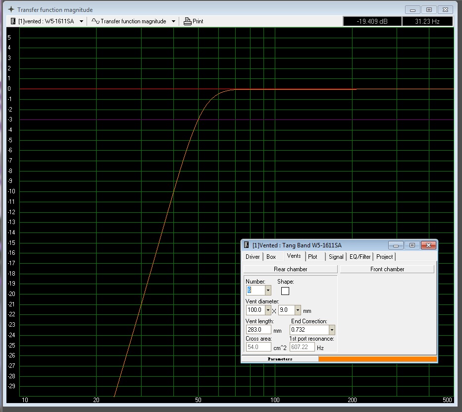

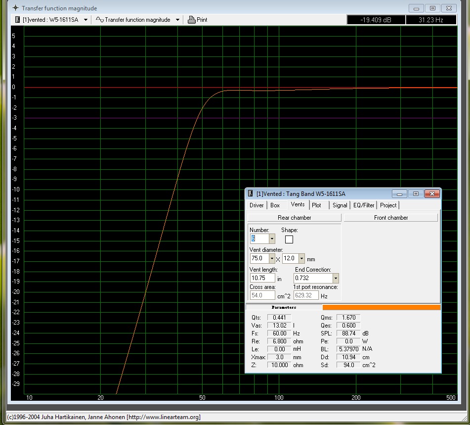

Using WinISD, the W5 looks pretty good in an 18 liter box, F3 at 50Hz. With 6 vents, each one would measure 100mm x 9.0mm x 283mm long.
BTW, this is Q3B tuning, not real Onken tuning.

Using WinISD, the W5 looks pretty good in an 18 liter box, F3 at 50Hz. With 6 vents, each one would measure 100mm x 9.0mm x 283mm long. BTW, this is Q3B tuning, not real Onken tuning.
jeff

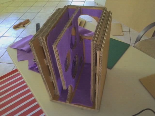

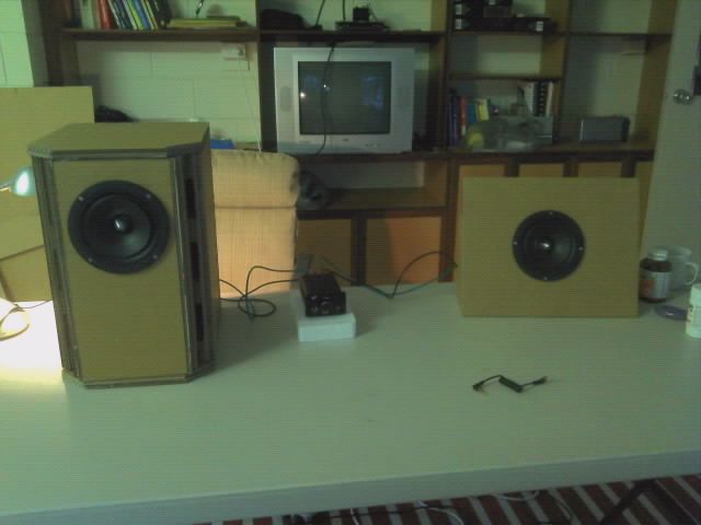

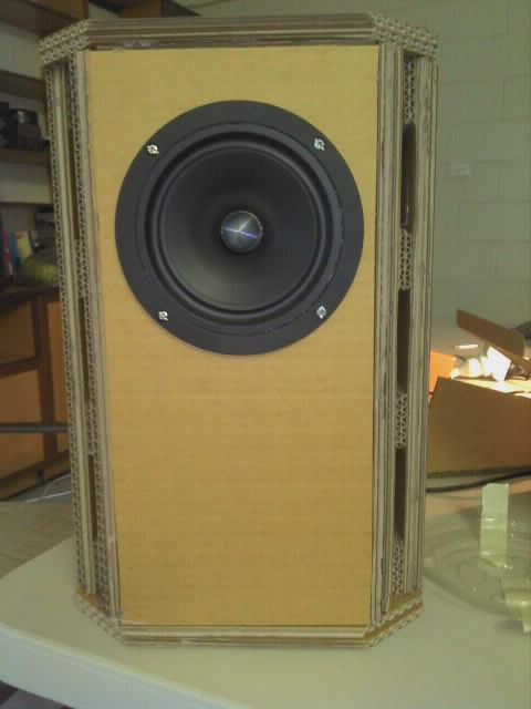

Hi all - so built a mock up of the 20ltr onken type thing, supplied by Jeff. (see attached images). and hooked it up to a daytona T100a and an iphone.
Bear in mind....it's cardboard + I have no testing equipment save a mulitmeter (is that usefull?)
There is promise here. Although the speakers are so new - and do sound a little " 1 dimensional" (run them in?)
Maybe I am too used to multi ways with their discreet fequencies.
Definitely some "shout" in theses, especially when listening to Joni Mitchell (shout scream wai!l).
good for ennio morricone.
great for the stranglers.
good for zappa.
Would be hoping for more bass response + "punch" with wood.
er...now what?
Togril.
Nice work. I'm sure the speaker would bloom with a stiff wood enclosure, lifting the lows and mids in relation to the highs. If the highs are still an issue there are simple ways to attenuate those. Aesthetically, those Onken style enclosures are tops. Love to hear one sometime.
