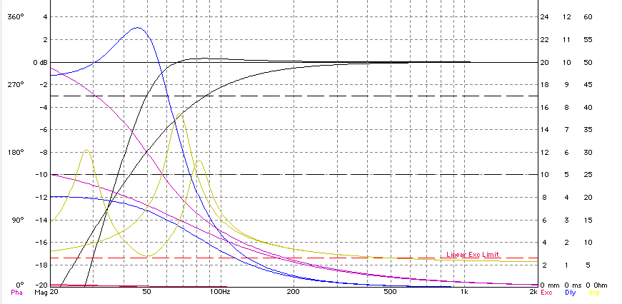

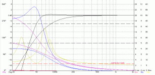

Interesting idea. When i do these i look for a specific curve shape and then estimate response by interpolating with the sealed response at the same volume.
Going back to the drawing, actual volume is 826 in^3 less whatever the driver takes up. 14 litre is the gross volume before braces & drivers, target was 13 litre net (just under 800 in^3)
Sim is 13 litre 50 hz tuning.
dave

Hi GM,
FWIW, I tried to duplicate Dave's Fonken in the XLS calculator ages ago when I built my boxes. I got an n = 5.3, but that was with Rg=0.6 ohms and the factory TS numbers. Vb Total was approx. 13.6 litres.
