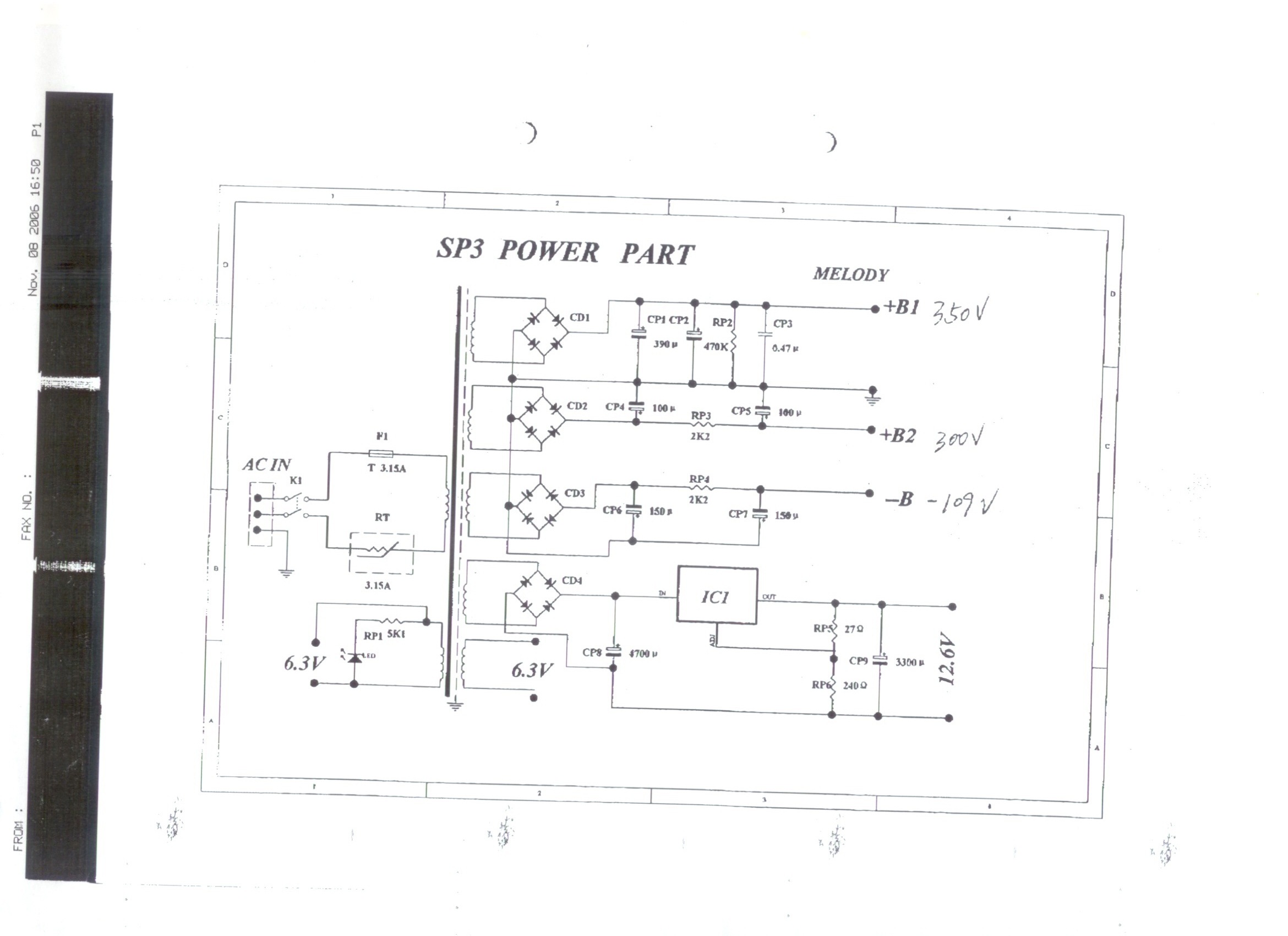

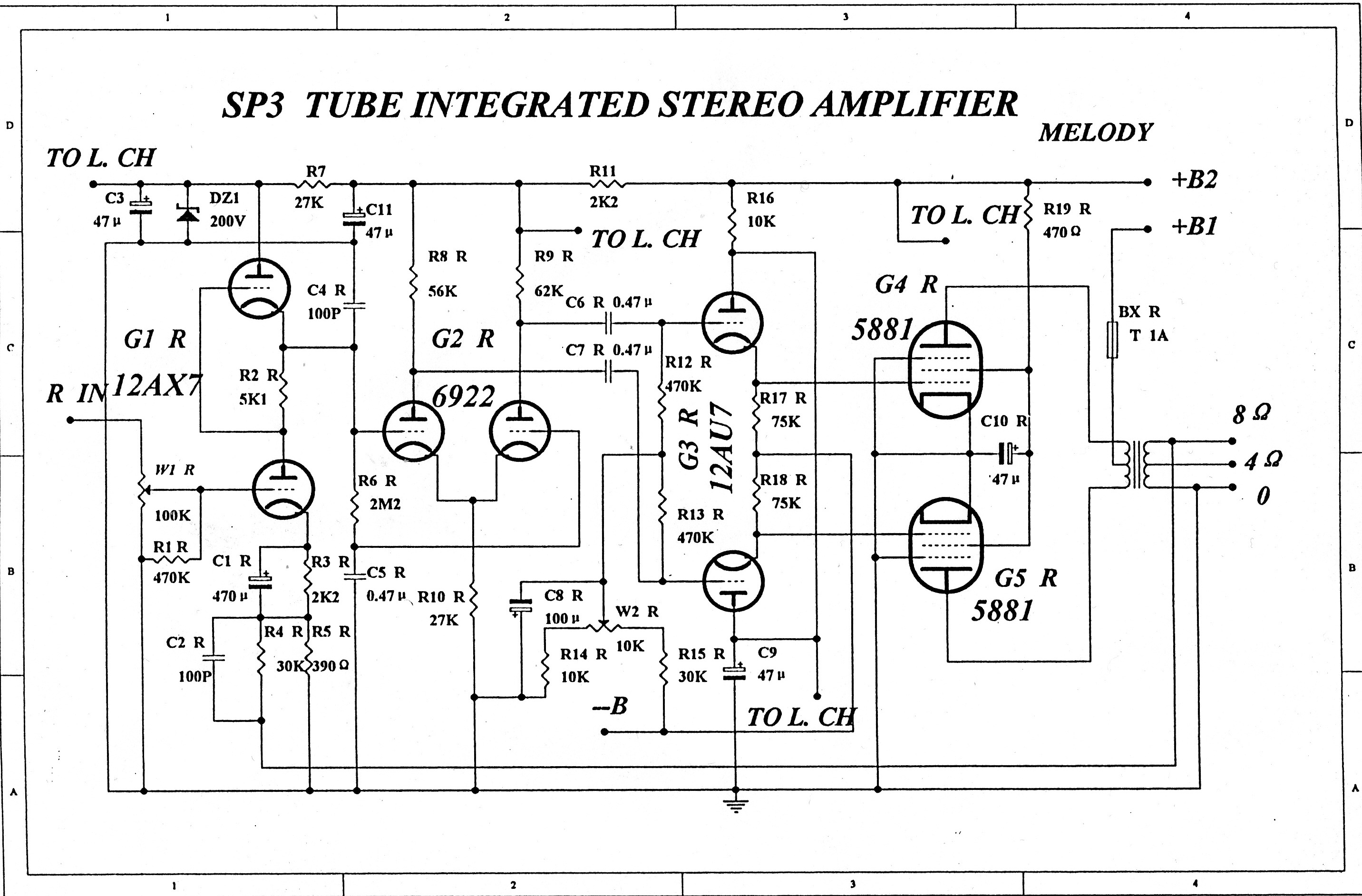

I have an Onix SP3 vacuum tube integrated amplifier that I purchased from AV123.com a few years ago. I like this amplifier and I believe it has potential to be a lot better. It has been characterized to have a "solid state sound" and I have to agree with that description. What can be done to the circuit to expand its soundstage and "warm it up" a bit? I've rolled tubes, and some people have installed new coupling caps (I think C6R and C7R: 0.47uF) or bypassed them with 0.1uF Teflon film caps.
I've included some recently posted schematics from a WIKI for this amplifier, Onix SP3 WIKI:
Onix/Melody SP3 Amplifier Schematic
Onix/Melody SP3 Power Supply Schematic

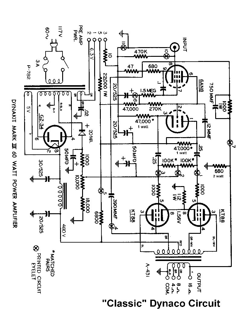

Yes i ran in to this in the 90s what i came up with an the one thing,not wire not caps,not new tubes,
Look at the 5881,6l6 cathiodes thay can not move with the sound! run them togather an put 10-15ohm 5watt to earth the tube bias well be diff. but the amp well putout more power an sound like a Tubeamp,look at the Dynaco MK3 ,best Mod i have ever done to a TubeAmp Goodluck

I'm disappointed more folks haven't commented, as I love this little amp. I think the price might be worth it for just the iron and chassis! I wouldn't spend too much $$ on coupling caps. Whether you are bypassing or replacing, look into Russian military surplus. The FT-3 Teflon's would be something entirely different, though not necessarily tube-y-er. The russian stuff is a much better deal than boutique names. That isn't much of a B+ supply. I'd think that some quieter diodes could make a real difference.

It seems to me the main culprit for the "solid state sound" (be it known that I do think these amps sound really nice for the $$), is probably excessive gain and feedback. It looks like you've got too many tubes! The problem is that modifying the circuit of a PCB based amp is tough. I don't know how sturdy that board is, but you'd have easier options were the amp point to point. I am certain that some circuit mods would make a bigger difference than parts swapping. Maybe someone will speak up and suggest something easy.

Looks like a nice little amp. Certainly very cheap for $500. As for the absence of "tube sound" i have never heard a tube amp with solid state rectification that i really liked. And there seems to be quite a lot of NFB. Getting it to sound more tubey won't be easy but it can certainly be improved in other ways. I would try to fit at least a regulator for the screen voltage and get the best possible parts for the bias circuit - improvements in both are very audible to me. What are the current coupling caps? Chinese? Russian? I really like the cheap K40Y9 pio caps but hardly any of the other Russian caps.
Is there a way to reducing the NFB? As I understand, the coupling caps are the little Silver-colored caps on the top and bottom of the photo I posted and the 4 greenish colored Russian PIO caps bolted to the PCB.
