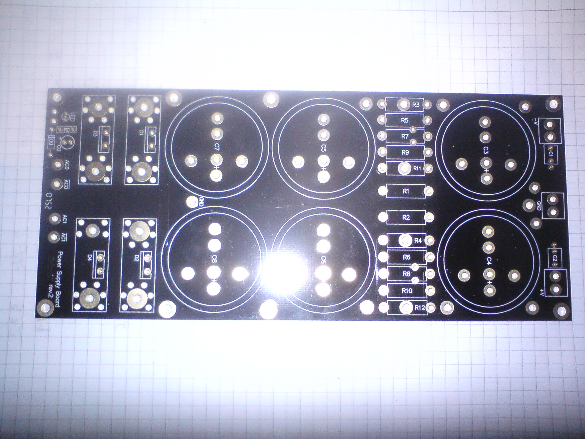

By the way, were did you get the pcbs? ebay?
Yes... the details do certainly add up in a build of this size. Just the stupid silpads alone are going to be a good chunk of change. Would the hifi chassis offer enough heat sinking?
Yes, the boards were ebay. The build quality is nice. And I made my obligatory donation (penance) to diyaudio as well. =)

Quick question again.
PSU pcbs? again from ebay? Unfortunately the store ones cannot cannot fit so big caps in sixes. Maybe only four. Unless I use 2 of them, one normally and one as a cap bank for a CCCRC configuration... We ll see when the time comes 🙂

yes it looks like e-bay PCB's. same PCB's are also sold by chipamp.com for 9$pc.
