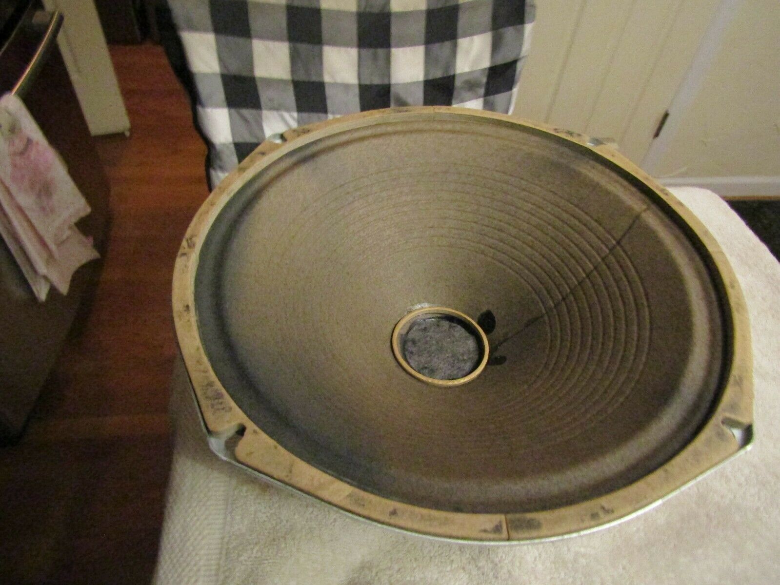

Is the Zenith driver in the attached image the "radial seam" type to which you refer?
(The seller describes the cone as having "no cuts or tears".)
