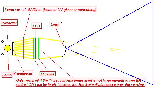

I have seen various designs posted on the net - some with 2 fresnels sandwiching the lcd and then some with only one fresnel between the light source and the lcd.
Does anyone have a decent explanation or opinion on which is better?
What is the relationship between the focal length of the fresnel and the projection lense at the front of the projector? do they have to be the same?

The projection lens focusses on the LCD.
The field frensel focusses just beyond the projection lens, such that the beam is entirely captured by the lens.
so this means you can use a lens that would normally only work with a 12" LCD (without front fresnall) with a 15" with the front fresnall? is this correct?
