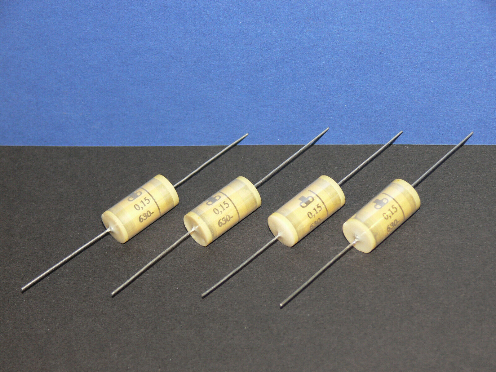

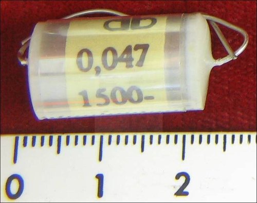

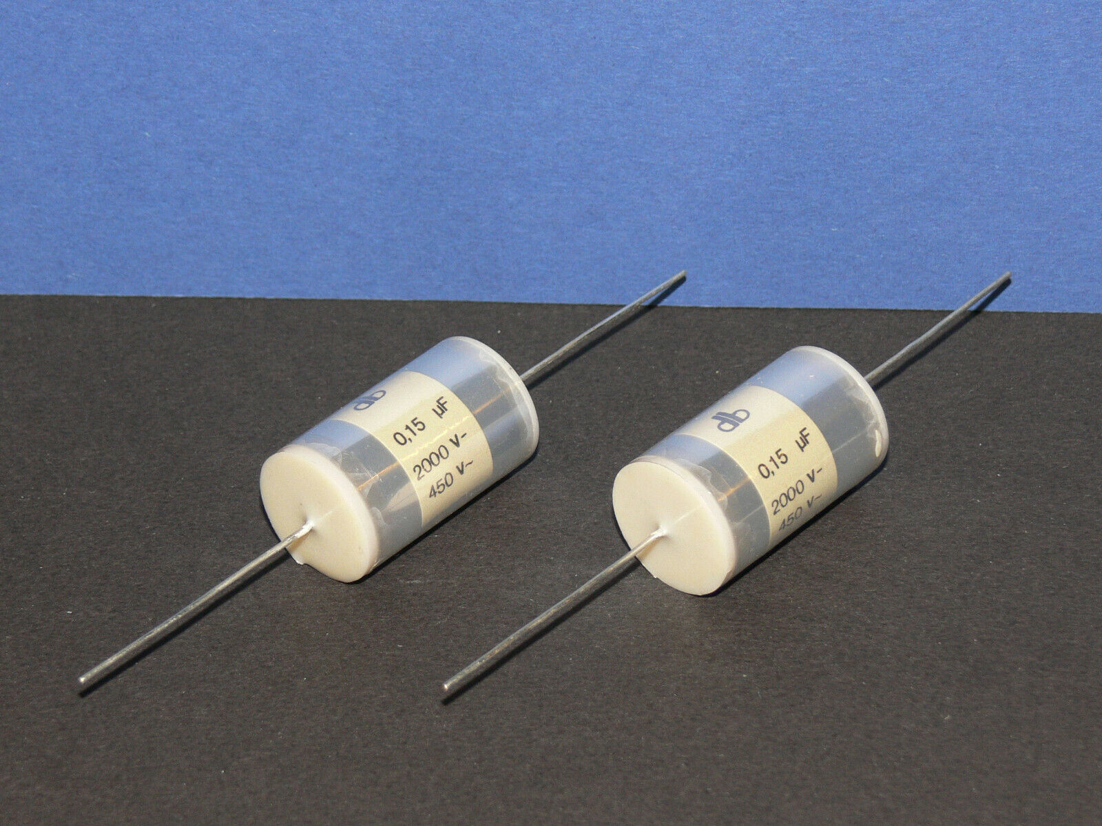

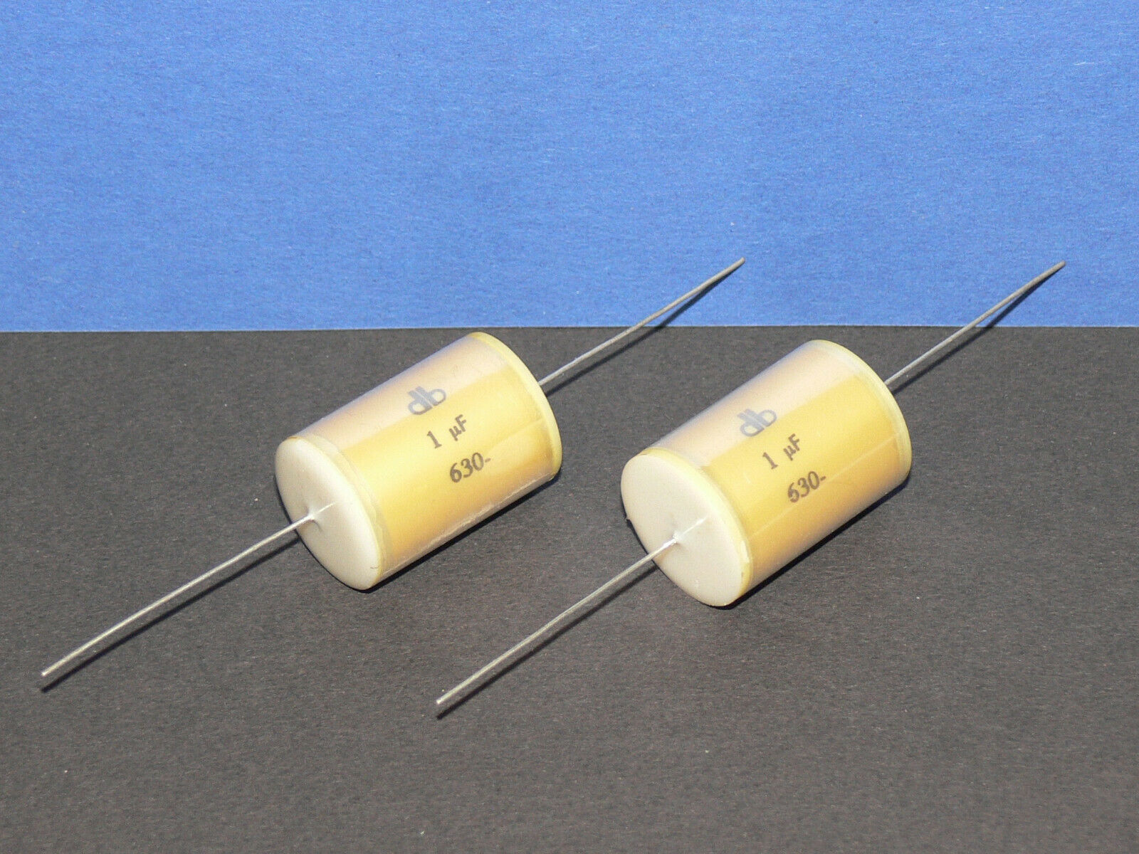

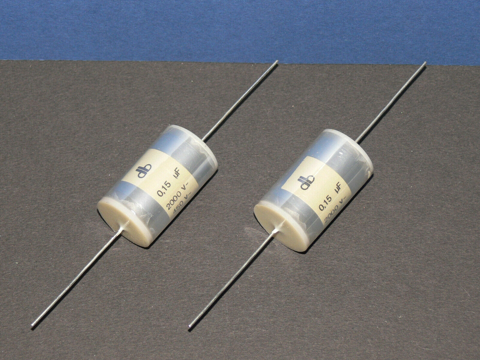

I talked a bit by phone and have heard follow:
The logo "db" is an abbreviation.
The associated brand name was the German surname (family name) "DörrBeck" - a small German manufacturer of high quality capacitors, mainly for the use in horizontal fly back stages (arround the "BU" transistors in televisions).
A picture you will find in post #1.
This brand wasn't purchased or overtaken by a new company.
This means, that the background knowledge of this company isn't available for others.
There are no broshures, folders, datasheets, publications or other printed material on the web.
This means, only the released reports (news) and advertisements in vintage electronic magazines from those days is available.
Perhaps one of the members can look for this (1970s and 1980s).

The high quality appearance suggests that it is German made, polypropylene rather than polystyrene.
yes, but only concerning the outline, but not concerning the sound character in listening tests.Kinda looks like an ERO MKP/KP without the colored outer layer.

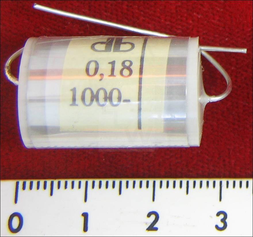

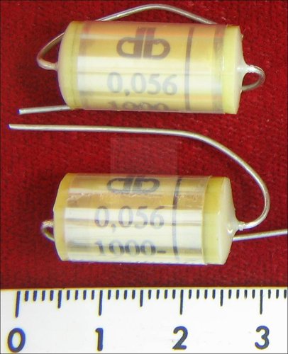

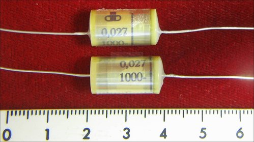

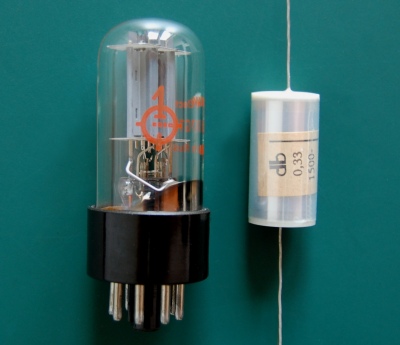

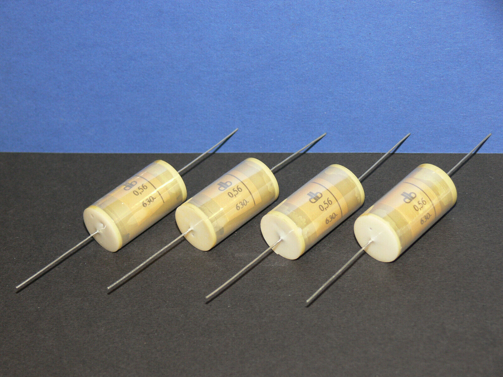

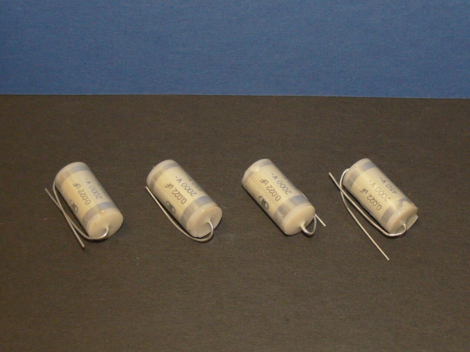

who know about genuine datasheets and advertisements of this vintage HV booster capacitor (check out post #8) ?
