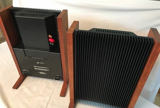

My brother now has a pair of the other ones, which don't push out the same amount of air, but have most of the tonality and sound he spent 35 years hearing, so I am really happy he was able to find those. They are now powered by those same vertical mono block Class A amps - Noble 1 - but they aren't quite 3' tall.
The relationship between my brother and Julius was one where someone with a finely tuned sense of sound quality and music appreciation could communicate those things to a person with huge technical prowess and imagination, despite a complete lack of technical understanding by my brother. Julius used him to help with auditioning a number of his products for his input. Really wish I had known him, because I would be able to connect more on the technical level.
Here's a photo of his current amps. Only 75 WPC but they seem to power the Audires well. I'll post the brochure next week.

I remember this style amp he made but I believe the pair I saw was a prototype with ridiculous class A power. I would like to say he mentioned it wasn’t practical and a prototype only. I remember it leaning more than the ones shown and very hot
to boot
I recall it was way more than 75 class A though. There is such a thing as false memory’s and maybe I fall into this trying to recapture the long ago moment..,
but that lean and heat trigger my recollection , so I leave it to maybe being wrong in the way back time machine..
