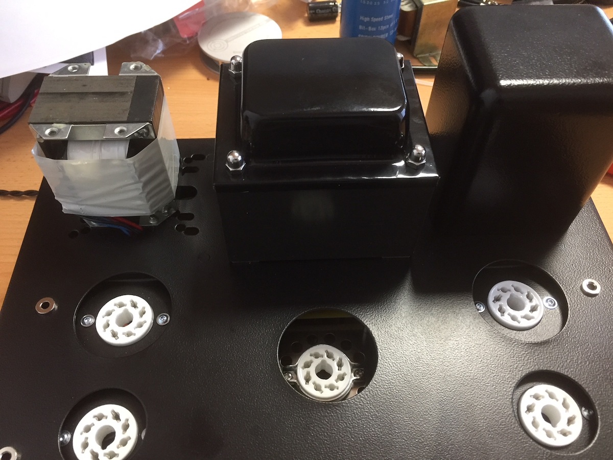

I almost gave up, when I got the idea to switch the amp on with all tubes being pulled. The hum was still there! The next step was to completely unsolder the primary coil of one output transformer. I switched the amp on - the hum was still there! Finally I remembered the advice of an old, experienced radio- tv- engineer: check the location / orientation of the components before you start building! This is easy said, but the most critical components (OTs, mains transformer, tube sockets) are pre-installed!
originally mounting of OT:

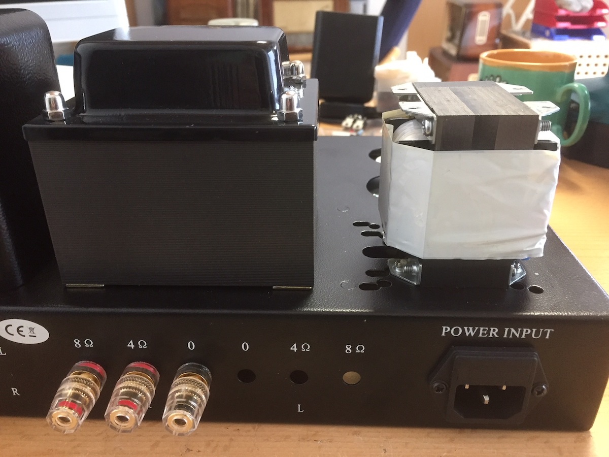

I unscrewed the OT and moved it slightly away from the mains transformer. I switched the amp on - the hum was still there - but with a lower volume! Now I rotated the OT by 90 degrees - the hum was almost noiseless. Shifting the OT further away from the mains transformer lowered the hum even more! The bad news is that the amp's case is too small to completely get rid of the hum..... I marked the new position, drilled new holes and mounted the OTs (rotated 90°, 12mm shifted from the original position). The result was an almost hum-free amp.....
modified mounting of OT:
But almost isn't perfect..... the last modification (until today) was to elevate the preamp tube's heating. Now the sound is close to perfect to me. If you crawl with your ear into a speaker you'll probably ‘guess' hum - that's fine to me.

Good work. There are so many reasons why an amp can hum.
The original Dyna Stereo ST70 amp has the same problem. Pull all tubes, and you still hear hum. The power and output transformers are very close to each other.
No angular orientation can completely fix that, and moving the output transformers to where the EL34s were, and moving the EL34s to to where the output transformers were will not fix it either. The additional problem is the fact that the chassis is magnetic steel. Use a steel chassis, and spread the power supply magnetic emanations to everywhere on the chassis.
Global negative feedback reduces the hum once the tubes are warmed up. But if you modify the amp (take out the negative feedback), you will get more hum.

Why am I not surprised? No more steel chassis for me. Besides the magnetic problems, they are harder to drill, etc.
When I was faced (forced) to use a steel chassis, at least I stood all transformers and chokes off the chassis with 1/4 inch non-magnetic spacers (it can only help a little bit).

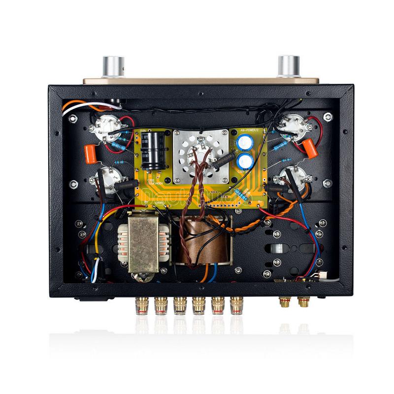

I am currently in the process of building this amp. I've had the kit for 3 months but got delayed. I also encountered the problem others have had of working solely with a schematic. Along the way I discovered what the chinese symbols are for red,blue, brown and black.
The reason I came here is because I wanted clarification after discovering that the photo I obtained on ebay of the completed amp shows the connections to the rectifier valve made wrongly.
