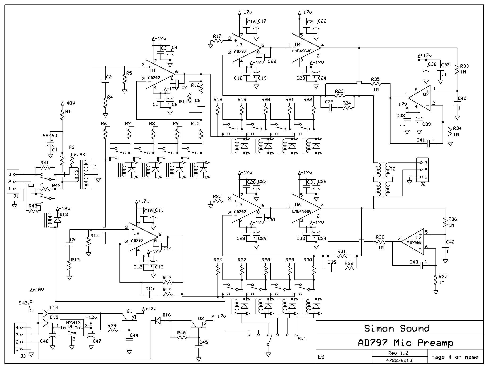

Attach is a design for a microphone preamplifier. It is transformer in and out. The input is a 2/1 step up the output can be also but will most likely stay as a 1/1.
The gain is adjustable from 10 db to 60 db.
Relays are used for gain switching to reduce stray capacitance.
It is a two stage design with each stage having the same gain so that the second inverting stage will help to cancel the first stage distortion.
It is also a balanced design. That allows greater headroom and more distortion cancellation.
The use of two stage also allows greater PSSR.
The power supply is not shown.
Open for questions or comments.
