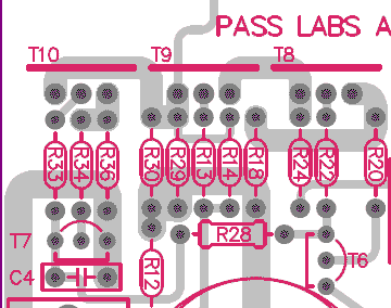

HBarske said:
Taking a brief look at the pcb artwork, I got a little confused:
IRF610/9610's pinout is "GDS" (correct me if I am wrong), but here the gate resistors seem to be connected to the center pin.
Someone seems to have mixed up gate and drain - is it me or the board's designer...?
Everything is OK with the layout - my version of AP was tested by several people 😉 I draw transistors footprints above to show mounting holes and dimensions. Take a look at PCB from bottom:
So yor actual layout isn't identical with the one posted on the first page of the thread?
I attached a screenshot of that (early?) version, and that definintely has errors. R33, R13, R22 don't connect the FET's gate pins, as they should, following your schematic.
