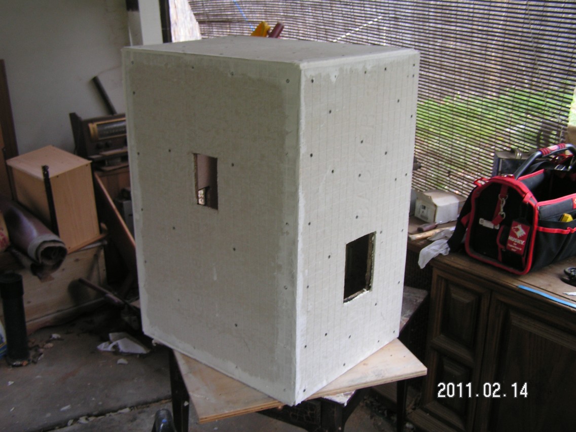

The Maggie looks nice, but it is too boomey; I build some sandwiches for this amp. 😀
Memory Foam, Linoleum, MDF, concrete, and oak veneer layers, and still the same Maggie drivers, plus a pair of naked piezos additionally.
Wow! Looks good, bet those cabinets will be nice and rigid, and non-resonant. How are you joining and sealing the corners?

I took MDF boxes from disco speakers and glued concrete layers on top of their carpet. Corners are sealed by tile glue. On top of concrete layers I glue oak veneer, corners will be covered by oak angle profile from Home Depot, glued by epoxy. I did that already before, it looks well:
