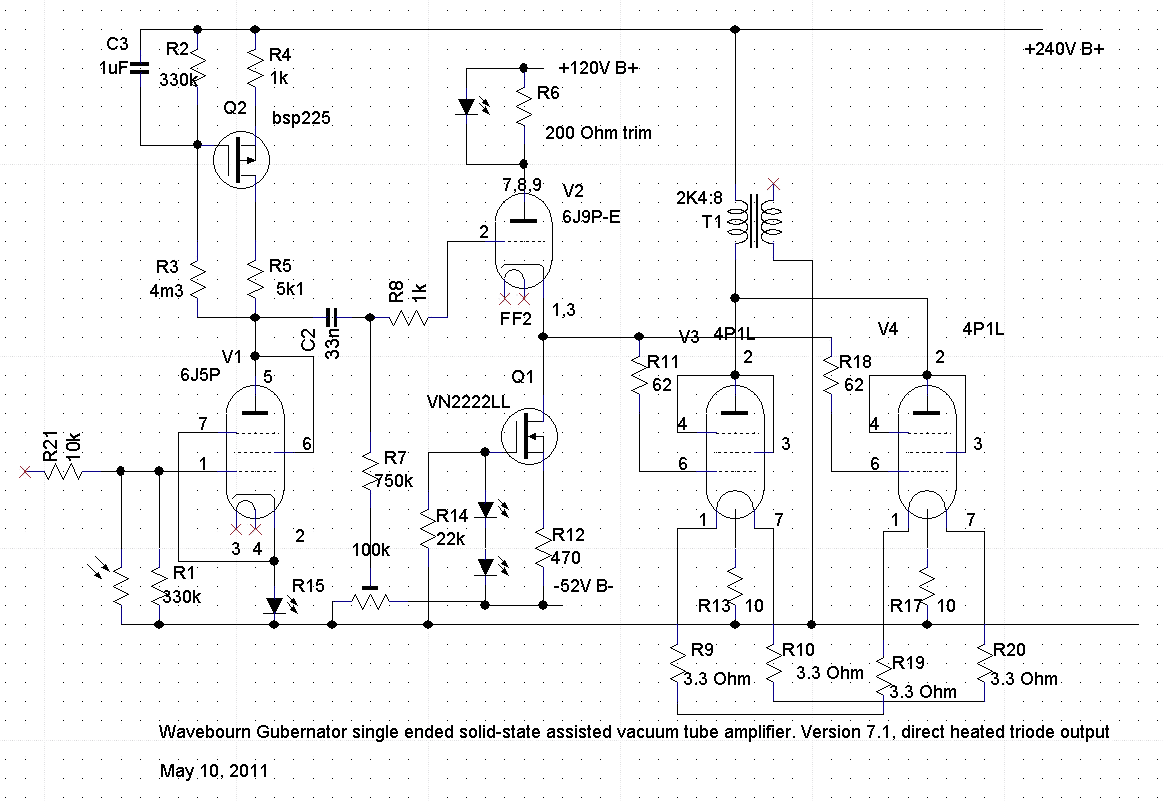

One more 4P1L SE
Hi!

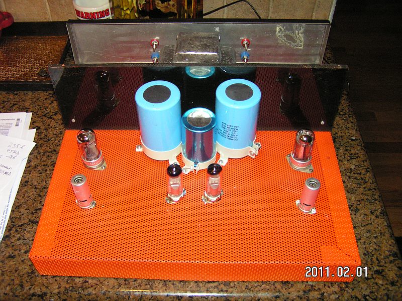

I am listening now to stereo amp with... 2.5W per channel! 😱
Sounds very clean. Stereo imaging is perfect. Even depth is heard well.
Output stage uses 4P1L DH tube, triode connected. Input stage uses triode connected 6J5P tube, loaded on gyrator for minimum tube distortions, green LED in cathode. It is coupled to 4P1L grid through cathode follower made on 6N16B with paralleled triodes, dynamically loaded on current source. It is not a "power drive", it is the way to minimize distortions caused by non-linear grid current, especially when interstage capacitor is used.

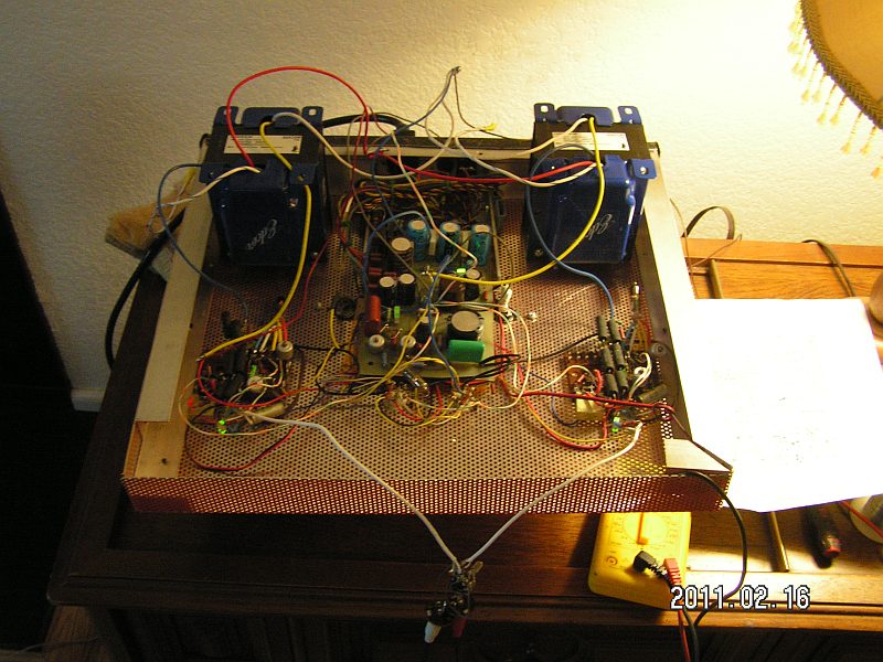

The whole thingy is powered from oversized PS with stabilized voltages for -56, +120, +240 and floating 6.3V.
Enjoy!

Congratulations to the scheme!
I would like to ask, how is the tension on the resistor R13 / 10 Ohm /
Thanks.
They are shorted out. I remove 4P1L in one channel and unshort resistor in another channel to measure and set 230 milivolt on it.
Looks very nice!
But I don't see the paralelled triodes in the schematic? (Probably because it's still early over here..)
You can draw it, if you want. 😉

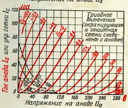

Yes, also better stability on transients. The purpose of this toy was to explore all that is possible to get from this wonderful 4P1L tube.
Also, it would be theoretically better to power filament from 2.1V stabilizer connecting halves of filament in parallel.
Kind of a similar question - could the front end of this be simplified somewhat to run a single b+ ?
Yes, you can use an interstage transformer and more powerful driver, like one more 4P1L. But such simplification would be more expensive.
Interesting looking little creature. But why the Gyrator on the first stages anode? Wouldn't a simple CCS have sufficed? What are the benefits of this?
Gyrator is actually a CCS with servo. In reality exact stable current is less significant than high dynamic resistance and stable anode voltage. When swapping tubes, and when they age, no need to adjust current supplied by CCS: Gyrator adjusts it for you.
