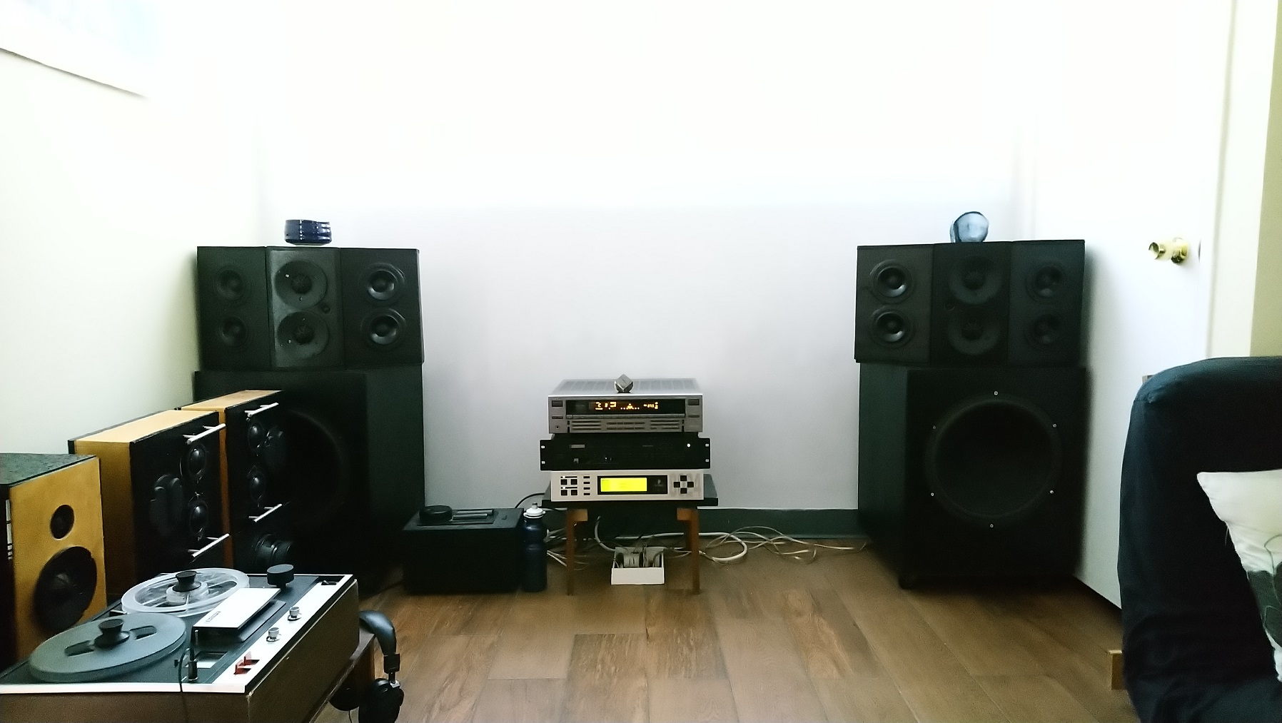

I have recently finished 4way speaker using tiny dayton dome, two dome upper midrangers, four cone based mid basses, and that will be on top of 15" woofer
There is thread, just for fun, called 'viral projects...'
You may find it interesting. Ask questions, if you like. Crossover is still in progress, but speakers are in use and sound great already. I use 160, 900 and 6000 Hz crossover points.
