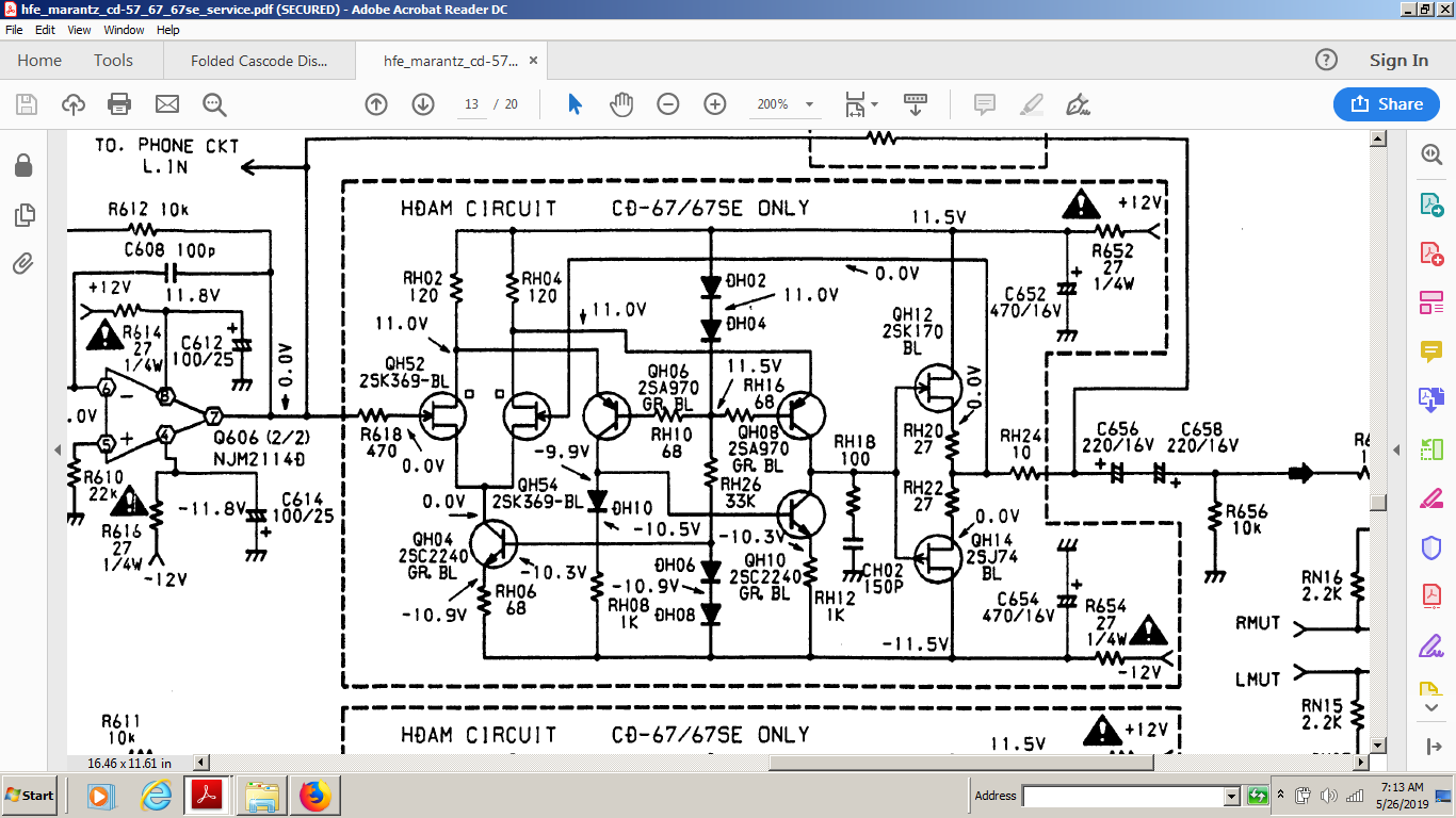

The one you posted is from the so-called HDAM, which is not unity gain stable.

It was just a joke, but just looking at HDAM schematic...i wonder what's that thing that makes me believe it's unity gain stable....Is it because it runs at unity gain?

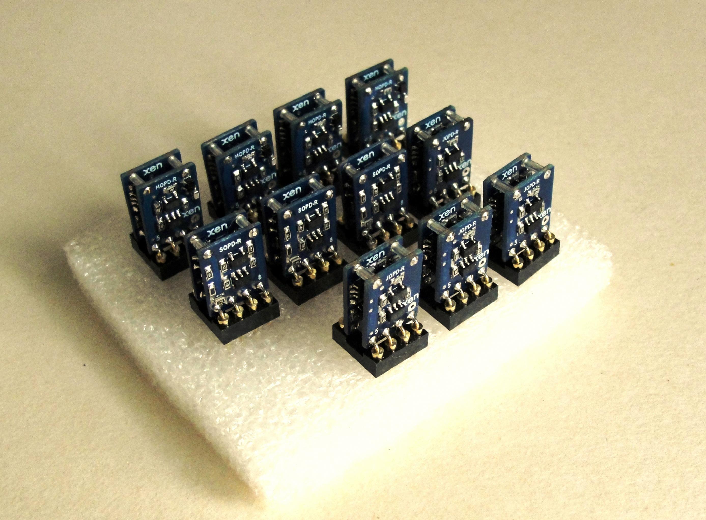

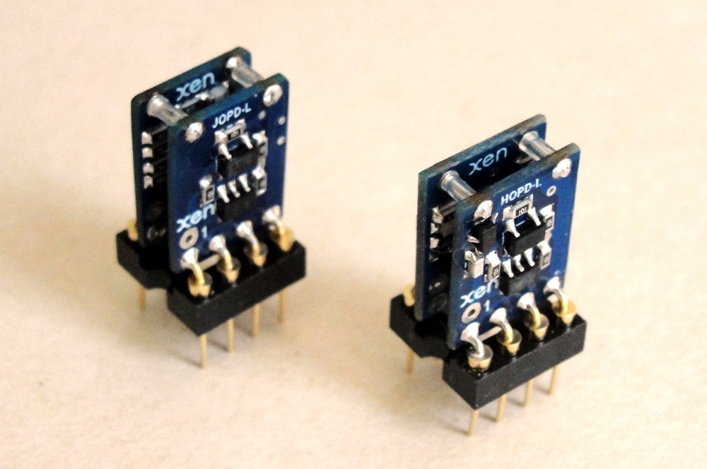

For the PCBs, or fully finished or tested ?
For the PCB, you need to :
1) be able to solder 0603 and SOT363
2) be prepared to match SOT23-5 and SOT363 dual transistors
3) have a collection of susumu 0603 resistors for DC trimming
And of course you need a reasonable size to match from.
So you should be doing it for love of DIY.
Patrick

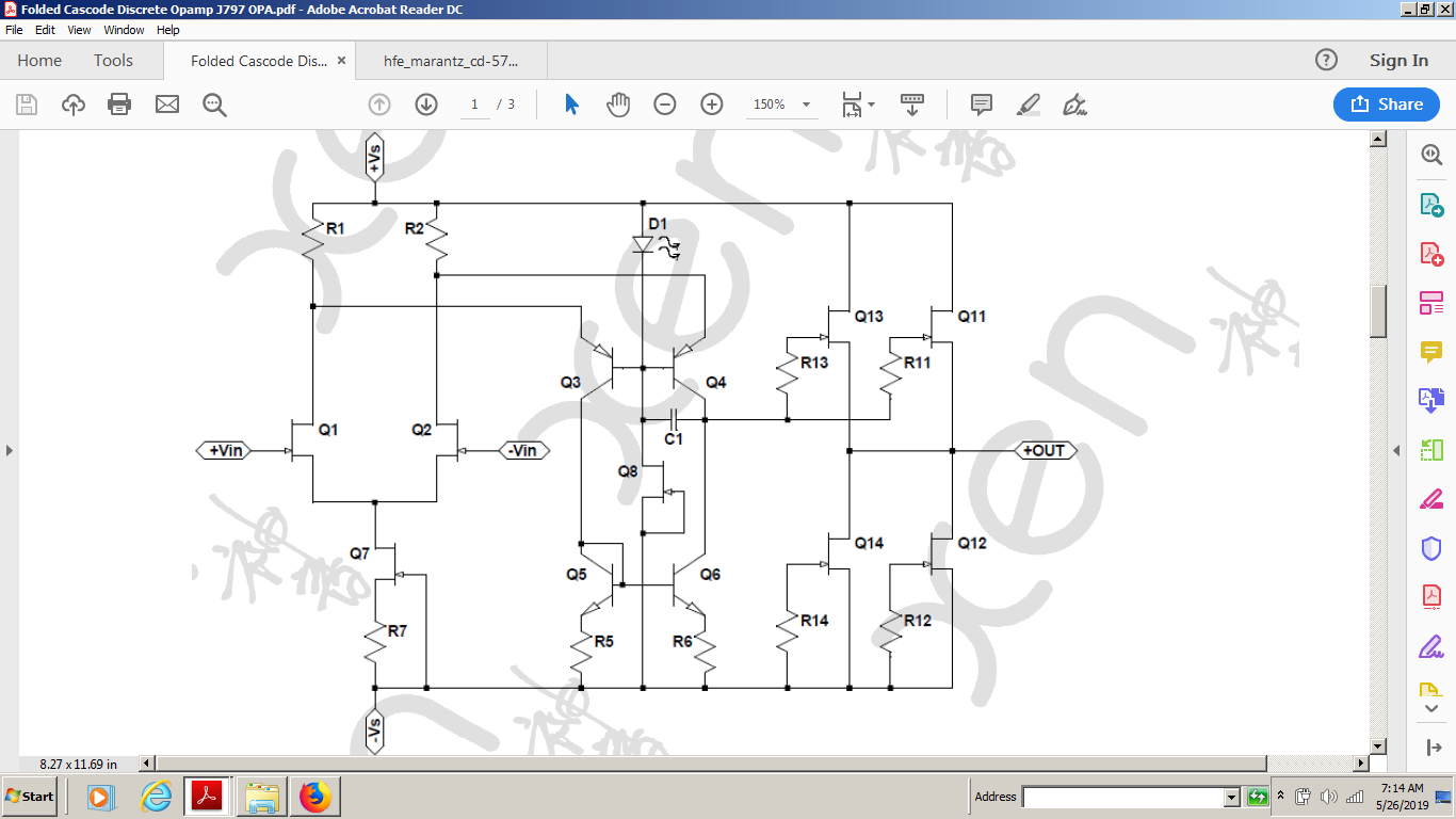

Patrick, 797 has bootstrapped Q5Q6 mirror, does your implementation has the same?But I have different components and component values to suit the SMD design.
No. No Q12.
But it is a good point. I shall investigate advantage.
Thanks Dimitri,
P.
No. No Q12.
Thanks Dimitri,
P.
Tried it in Spice.
Distortion (mainly H2) reduces by a factor of ~10.
But trimming of DC offset is very sensitive.
So I think I would stay put for now.
Patrick
Tried it in Spice.
Patrick

I'd like PCB's, I can solder those parts no problem.
Matching will be a challenge, but hey, that's part of the fun with diy, right?
> Matching will be a challenge.
Designing PCBs is also part of the fun. 🙂
I posted enough photos that you can use as reference.
Patrick
Patrick
