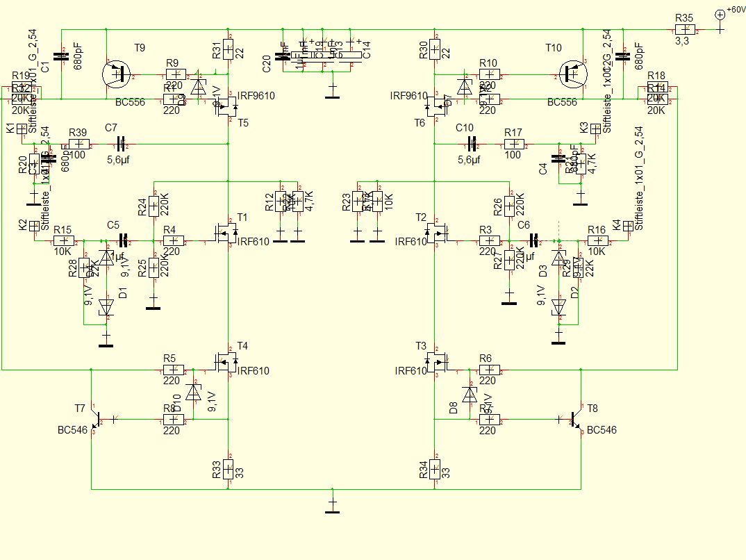

Hey Folks,
My first post in this forum. excuse me english. I'm not used to write...
So the actual question is:
I want to use the Aleph P as a Bride of Zen with CCS. But where to go with the Bridge at the Sources of the gain-devices?
I build a normal Aleph P and it was just delicious to hear with a F4. To build a "whole" Aleph P and waste one half by short-cutting the output to ground, is uneconomical in my opinion. I didn't found a solution in the web, if there is one, i would be happy to read about it...
A schematic of the plan is attached(which is not working!)
Best regards
Miep
