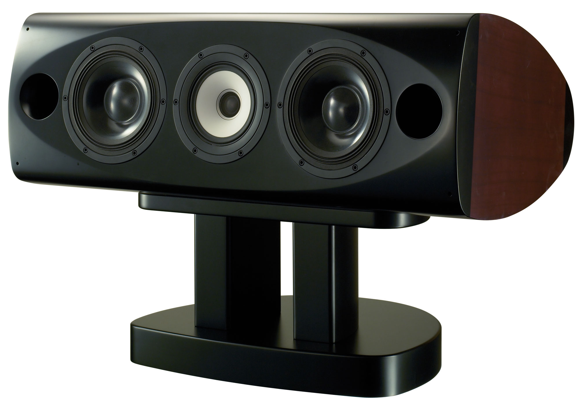

Goldorak - whether you decide on multiple fullrange or 2/3 way systems, be wary of horizontal configuration for center channel speaker; i.e. specifically MTM.

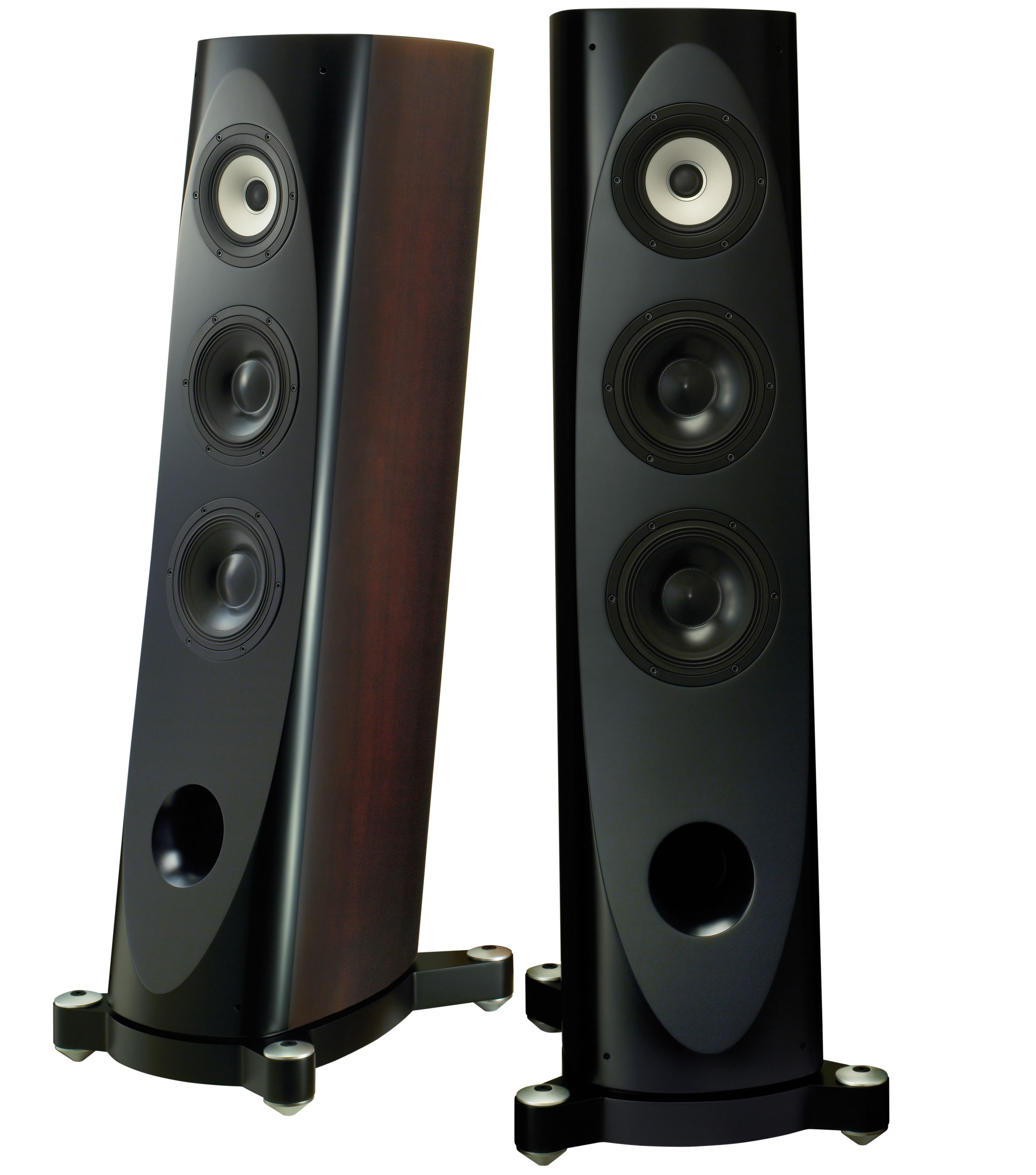

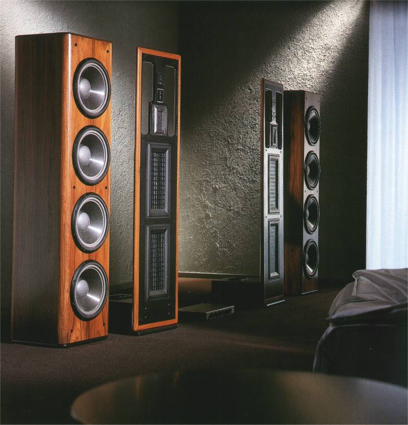

Getting back to the MTM and horizontal speakers subject. I was on the pioneer website and was looking at their "high end" towers and centers just for information not to buy anything, they are expensive. The center has an MSRP of 3800 USD i think, it is MTM, it is not good!!!? I will attach the photo, it is nice and the beautiful is the tower 😀
I mean getting inspired by designs around is not a bad idea.
Just a second, it might not be an MTM, but it looks like, on the pioneer site they say 3 way system! the middle driver is a concentric driver, but still it is horizontal.

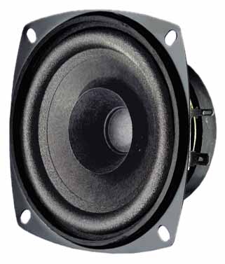

I went today to a local store to try to get a visaton FR10 in order to build a tower with it so that i can at least immagine the possible better sound from the CHR70 for example but unfortunately it was out of stock, the only remaining driver is the visaton F8SC8, which is very poor to try with. I attached the pics of the drivers here.

Understand that in the absence of opportunity to hear any of the numerous models of drivers from either maker that have formed the prime candidates so far, you're relying on subjective evaluations of folks whose tastes and biases you've not been able to reconcile to your own.
Does that make sense?
Setting aside the price and sensitivity differences between the Fostex and Mark Audio drivers discussed so far (which are "objective" factors upon which undue significance may be placed), there are subjective differences in the presentation of a musical performance that may not be related to specifications or quantifiable measurements. Trust me, that's another of those questions upon which terrabytes of bandwidth have, and will continue to be spent debating, and I don't expect a consensus in my lifetime 😉
At the end of the day, there will be differences of "personal taste", and the willingness to submit to compromise, ( based on years or decades of experience ) that are also beyond the scope of conventional metrics. In other words, if I were to design a multichannel home theatre system for my own use, there are lots of reasons for which it could be quite different from what I might suggest for someone else.

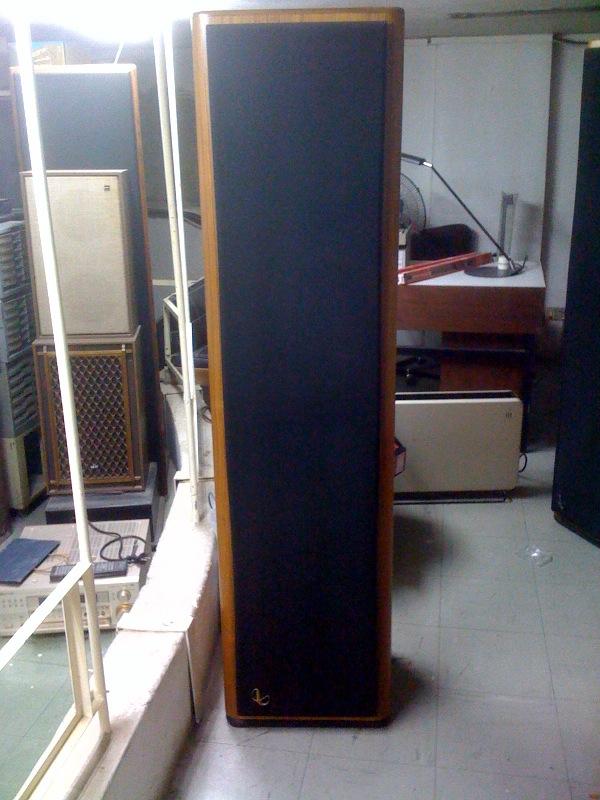

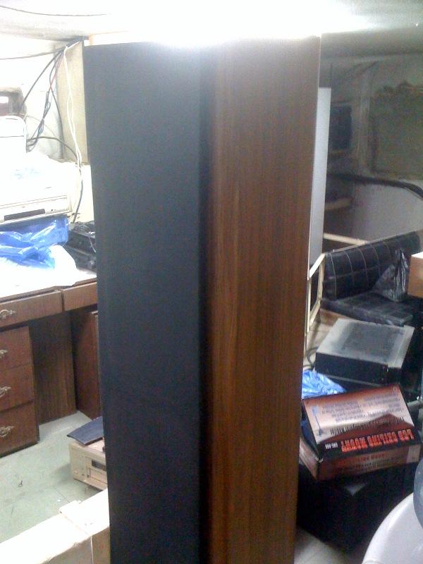

Found Infinity IRS Beta speakers!??
Hi guys.
I got a little detained from my DIY project because of work and bought as well a new SUV for the Wife & family.
Meanwhile, i found a used speakers shop near my area on the internet, he was posting the Infinity IRS Beta speakers. At first i didn't know the model but called him to get information, he said that the speakers are missing half their woofers it seems, i.e. each box has two woofers instead of 4. To be honest the info on the net seems in favor of these speakers, but i doubt they are in good condition and moreover, i feel they are missing the "external box" crossover!! DO they need BI-Amping? many questions came to my mind, and they need space.
Howeover, being a speaker and techno enthusiast, i decided to go see them (didnt go yet, possibly in weekend if they are still there). ANy idea? how to test them and check them up? are they worth to be bought with this "used" condition? do they really need biamping? i heard the woofers need more then my amp can give.
So, any ideas or thoughts regarding this? is there a possibility of renovation (worth it)? can they operate on one amplifier?

Unless you plan to buy the drivers that actually go in those boxes, they are a waste of time and money. Those boxes would be designed for the drivers that are missing.
jleaman, i wouldnt have even thought about them but the price seemed "good". it is between 350 and 400 USD for the 4 towers, but i want to see if he has the control unit as well. I have posted the pics of the salesperson ( i beleive these are for the bass units), and the original pics of the infinity IRS beta.
On one site i have seen that the weight is 1500 lbs for the 4 units,is that correct?

DUde, you are allllllllllllllllllllllllllllllllllllllllllllllllllllll OVER the place with this.
Pic a set of drivers, get some help on here for box designs, then design the crossover.
Be done with it,
If you buy those boxes, it will be a complete waste of money if you don't put the original drivers in them.
By the looks of them, they are bi-amp able speakers. and probably require a HUGE room and a wide one to boot.!
I remember the IRS V as the ultimate reference speaker. I only saw pictures and read the mags. They were beautiful speakers made with rosewood (I suppose rosewood was still legal then). iirc they had 12 X 12 inch woofers, servo controlled in 2 enclosures per channel and then other enclosures for the mids and tweets which were set up as line sources. Weighing in at 1500lbs and priced in the range of US$50,000.00.
I believe they came with built in amps.
Each crossover held just short of a kazillion components.
I am sure an internet search would turn up a lot of info.
Without a complete system I am afraid you really don't have very much although you could probably use the Rosewood for another project😀
