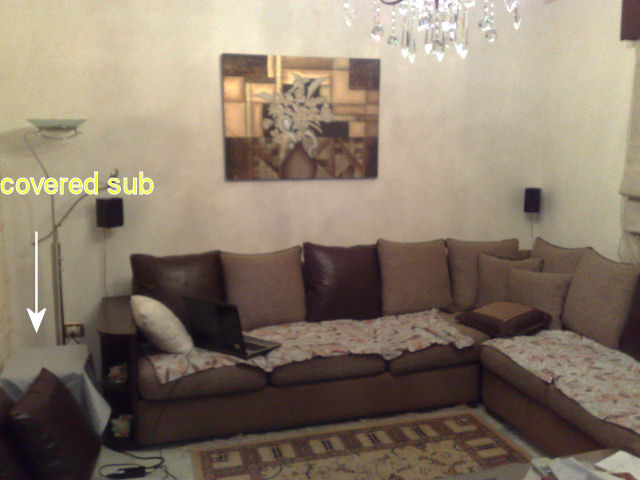

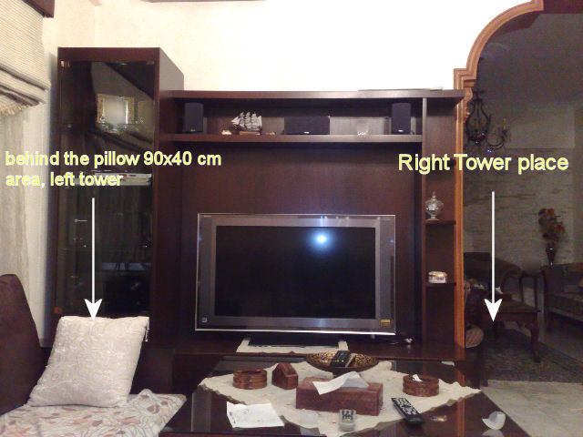

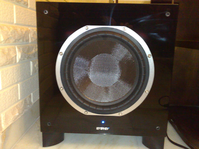

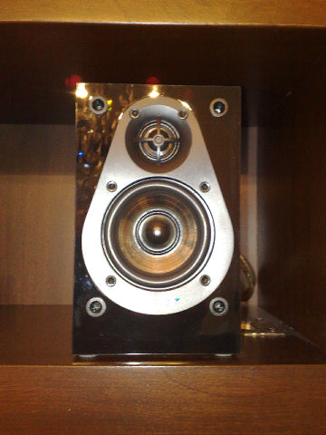

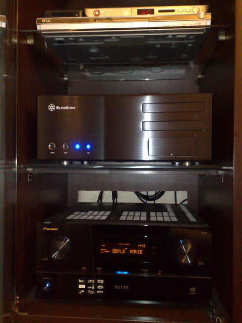

My current none DIY setup except HTPC
Well to better describe my home theatre area and current (sorry to say) 😱 non DIY equipment (except for HTPC, i build it piece by piece).
I will show now the home theatre room and open space next to it and equipment. the corresponding images are for current front lcd tv and satellites and place for the new DIY towers, open space area next to the 14 m2 room, the surround satellites place, the amplifier (up to 192Khz sampling, HD format audio, ultra thx), htpc(everything full high definition capable with blue ray and audio HDMI out), dvd, cable tv, and DVB-S2 PC receiver,
I have carefully done the setup, i really need to make nice looking towers, anyhow i am using help of the carpenter who made the TV stand that you are going to see, i designed it with him myself and chosen the colors, spacing, etc.
This definitely looks like a room where less (smaller drivers/enclosure type) could give you more (flexible placement options, and better overall balance)
Regardless of the driver/ enclosure designs you finally settle on, the room has what would appear to be rather schizophrenic acoustic properties, that may need treatment to resolve, or resignation and adaption. (the brain is very capable in that regard - witness marriages that last as long as mine 🙄)
The primary listening position on the forward facing couch will be very much in the near field, and as much as I am fan of several of the Fostex drivers discussed so far in this thread, it's not been my experience that they ameliorate the sonic signature of solid state electronics, and you might well be served by considering other types.
The first that come to mind are the Mark Audio CHR70 or (CSS) EL70 for the surrounds, and the Alpair12 for front row. These have excellent tonal balance, can work well in fairly small enclosures, particularly when assisted by subwoofer(s), and exhibit a more laid back presentation than the Fostex - a trait which could benefit your case. The only issue might be the ability of your amp(s) to comfortably handle multiple channels of 4 ohm impedance - the only HT receiver I've personally used (mid range Denon) was rated at 6 ohms or higher when all 5 channels driven. (mind you, I never could get domestic acceptance for location of surrounds, so it was never tested to it's limits)
chrisb,
Regarding my receiver (which is rated at 140 watts into 8 ohm, i had mistakengly said 150) has on its back a rating from 6ohm to 16ohm, and from reviews, i concluded that it can run 4 ohms and even lower especially that it is thx ultra certified. now of course it is better with 6 ohm and higher.
I didnt get if it is good that i have such shape room or not good, but i got the impression that it is good and nice sound from your words.
my best setup would be smaller then 8 inch speakers for front towers but more then one driver in the tower although most dont approve of mutliple drivers for comb effect.

but what about my current satellites, why do they say 20 to 100 watts, what is the real wattage they are giving? my amp volume goes from -80dB to +12dB, and when at 0dB i feel the satellites are at their highest and saturated, if the song is a little higher i might feel they are overdriven, their best powered sound is at -3dB volume almost to 0dB.
The rated power should be more than adequate for whatever speaker solution you arrive at, but don't assume that a "THX certification" means the amp can safely be operated outside of the manufacturer's rated operating range of impedance loads
I'll repeat again, that the effective listening area of the room is probably not suited to multiples of drivers larger than 6", or even dual drivers of those sizes in the front row.
If the rears are already too near to the main listening area, how would replacing/upgrading them resolve that issue?

Let's keep it simple and say that speakers don't "give wattage" - that type of rating for any speaker doesn't mean much at all, except that with less power than the lower number they'll likely not sound particularly dynamic or full bodied, and at high SP levels can in fact be more easily damaged than with a higher powered amp.but what about my current satellites, why do they say 20 to 100 watts, what is the real wattage they are giving? my amp volume goes from -80dB to +12dB, and when at 0dB i feel the satellites are at their highest and saturated, if the song is a little higher i might feel they are overdriven, their best powered sound is at -3dB volume almost to 0dB.
