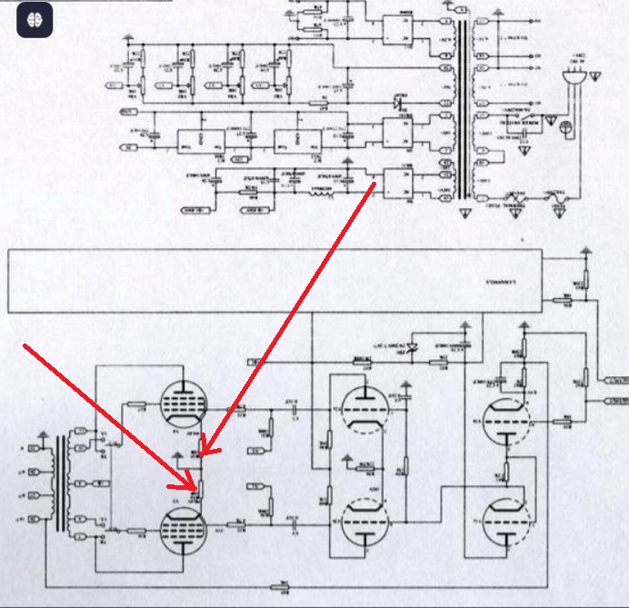

I have a Cayin A88-T Mk 2, that's been doing it's job quite well for a while. After transporting it to a friend, I noticed that the higher frequency had left in the right channel, it all sounded very muted. A quick frequency sweep confirmed this. I noticed that the power tubes in one channel stayed quite cold, although the heaters are glowing normally.
I first suspected the tubes, and swapped them with the other channel. The problem persisted with the tubes plugged into the right channel. I then suspected a bias problem. The tubes in fact refuse to be biased, the meter just goes completely to the right and doesn't react to adjustments. However, when I pulled the tubes and measured the bias voltage at the socket, it was identical to the left channel and also regulated identically when I turned the potentiometers. All the other voltages, especially anode voltage, was equally identical to the left channel. I haven't opened the amp up, because I had to leave my friend's place that day. I'm a little stumped though: It's not the tubes, not the bias, not the B+ - do you have any good propositions where I should propably look first when I go there next to open the amp up?

resistors in cathode of kt88...... Maybe two resistors are burnt out.Check the voltage of G2.
