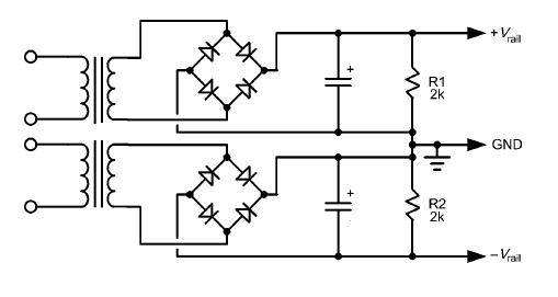

I have two big toroid trafos (1000VA 2x65V). I would like to use both of them to power one amplifier, but I want them to share the same capacitor bank.
There's different ways doing this. What's the pros and cons of each?
What I had in mind:
1, Connect all four secondary windings to their own bridge rectifier and parallel it afterwards. A total of four rectifier bridges.
2, Connect the secondary windings of each trafo in parallel and use one rectifier bridge for each trafo. A total of two rectifier bridges.
To clarify, two transformers, each with double secondary windings. One shared capacitor bank. One amplifier. Dual power supply.

If you are certain that the two transformers are completely identical then you might get away with paralleling their secondaries. If not, you will have to use ballast resistors to encourage current sharing. Using separate bridges means you will need to ensure identical bridges and maintain identical temperatures (not easy) as the hotter bridge will take more current and heat up even more, or use even bigger ballast resistors.
If the transformers are not identical then ever bigger still resistors are needed.

He is right- the two transformers will end up fighting over current!
hmm, fighting over the current...
Is that the case even if its the same transformer, only paralleling the windings. Each side of the amplifier driven by one transformer each?
The trafos are exacly the same, custom hand made transformers.
Plans are using Hypex UcD2k driving a couple of sealed subwoofers based on CSS Trio12
I think your #2 is fine. I sketched this out in the attached schematic. It's two separate power supplies, one for the + rail and one for the - rail, that are connected together at the caps with the earth ground to set potential.

Indeed, two trafos, each trafo have two secondary windings 65-0, 65-0
As long as I keep the two windings "in phase" I shouldnt have any problem connecting it to a normal diode bridge right? Will there be currents flowing and trafos buzzing?

Once you connect the secondaries in parallel, they act like a single secondary. My diagram shows how to connect these to a diode bridge, caps, and the earth ground.

Yes, the best way to do it is to parallel the secondaries on one transformer for the + rail, and the other one for the - rail. I should have thought of that. Like most bright ideas it seems obvious once someone has suggested it.
If they are really 'hand-made' then check the secondary voltages before you parallel them, just in case one accidentally got an extra turn round the core.
Looks okey?
I suggest that you don't connect the two banks of caps together until the end farthest from the transformer, and then connect them together at one point, where you will also connect the earth ground. This will reduce hum and provide a star ground point.
Instead, do it like this (the part of the circuit to the right of the two diode bridges):
The rest of your sketch looks fine... you might want to include some snubbers on primaries and/or secondaries...
