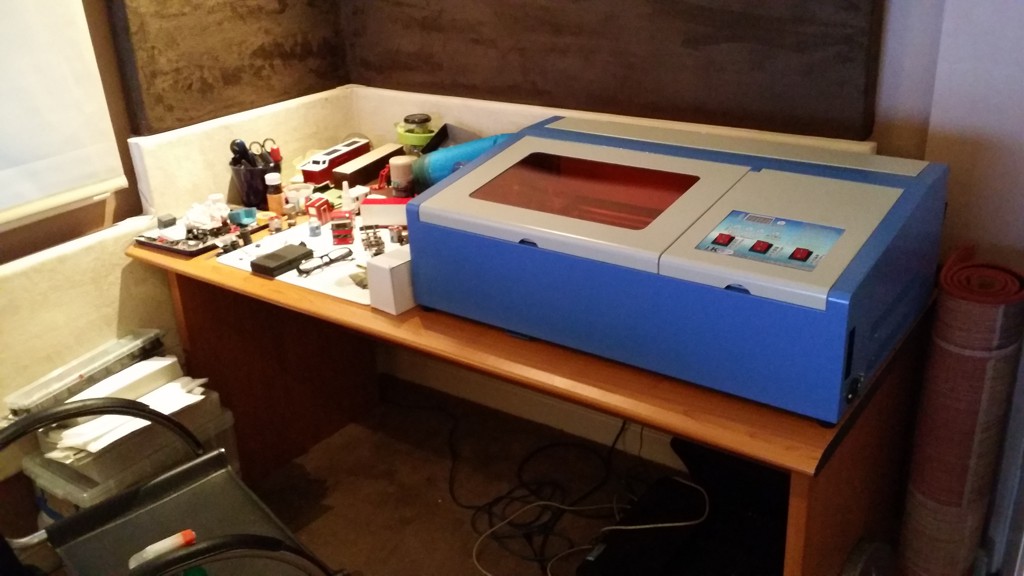

New toys
40w laser engraver. Planning to put this to use etching the text on the aluminium rear plates. Its nowhere near powerful enough to engrave aluminium but will etch though a layer of paint or anodised alu. Has other uses too such as cutting foam gaskets for drivers and cabinet parts.

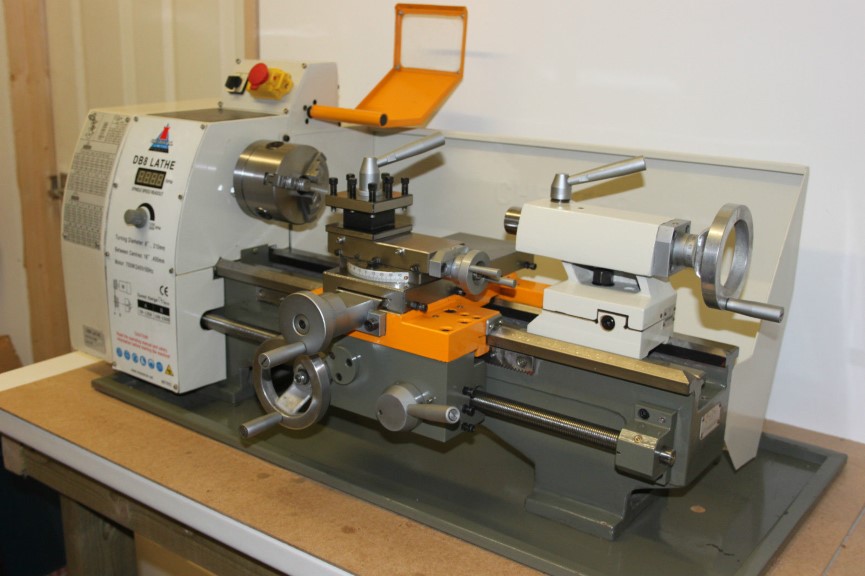

And a compact lathe. Its a manual affair at the moment but I'll be converting it to cnc in the near future. Primarily to be used for turning aluminium feet and bass ports.

I have come close to purchasing that laser CNC on many occasions. I end up changing my mind and build the larger one from "buildlog.net", but alas the few parts that are not DIY are are rarely available.
Yep I've been eyeing them up for a while now before pulling the trigger. Main complaint is the frankly rubbish software. There's a few different offerings such as moshidraw, laserdrw and winsealxp. Moshidraw is the one to avoid but none are really much good for drawing and designing. What most people do is use decent software such as coreldraw or solidworks etc and then import. The laser software is then pretty much just an control interface to the laser hardware then. This is the price you pay for a comparatively cheap machine.
I'm mostly happy with mine but some Diy is required to make the most of it. The bed was absolutely junk and I've removed mine and replaced it with aluminium honeycomb. There's also no air assist which great improves the edge finish in plastics. I bought a small airbrush compressor for this, you don't need a ton of air just enough to cool as the cut is being made and clear the smoke so this is more than fine.
Oooh, more toys!
Nice chunky little lathe as well. Very cool that the UK still makes good small lathe's at a reasonable price. In the US it's pretty much large machines at high prices (..or substandard low-cost imports from China).
..hmm, what's next on the list? Your own plating and anodizing station?
Awe, man.. that's a Chinese-made lathe as well (..though it still looks nice). I guess they all are now.

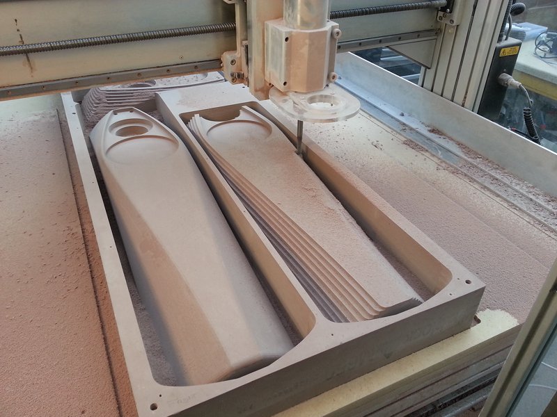

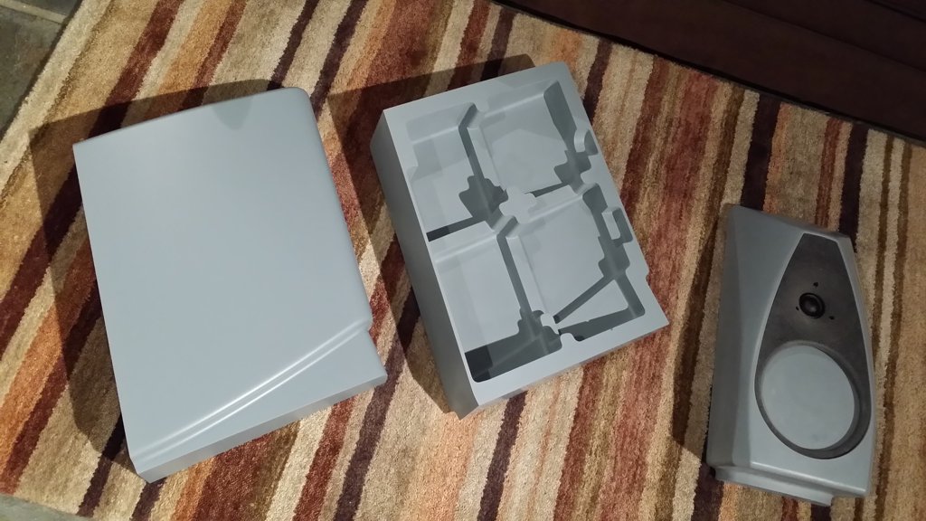

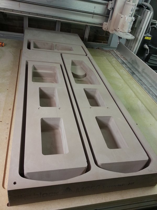

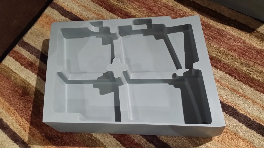

Hey folks, hope your all keeping well.
Its been awhile since I've updated this thread but I've got a bit of time and some worthwhile progress has been made. All the patterns for the One.10 are now complete and you can see them below in the images. Next step is making the moulds.
Video on utube: Machining One.10 Cabinet Patterns - YouTube
