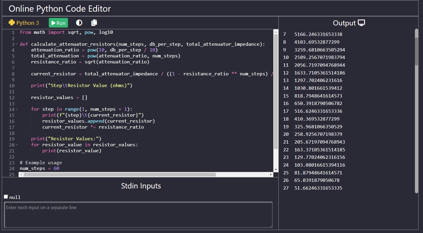

For a series stepped attenuator, you can use: https://pynative.com/online-python-code-editor-to-execute-python-code/
And run the following code (input your desired values where it says #example usage):

After clearing the instruction on line one , I tried to run a direct copy and paste of your code from above but got errors of unexpected indent and expected indent. On following the prompts eventually got to 'attenuation_ratio' is not defined. Haven't tried past that. Does a direct copy and paste work on your machine?
The forum keeps removing the indenting from the code. You need to indent the lines like the image shows below (click the start of the line and hit the tab key on your keyboard):
