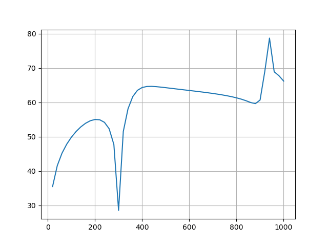

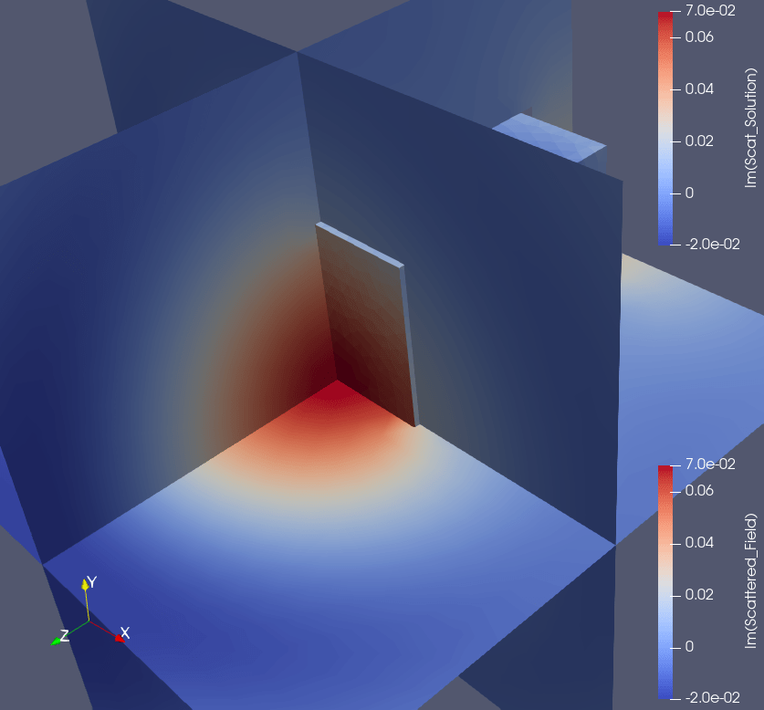

Attached are a couple of plots from an initial set of BEM simulations from years ago using python, gmsh, acousto, paraview and matplotlib which are all freely available. The test case was a rectangular box with a circular driver and the dimensions of the speaker used in the measurements in the previous post. The frequency of the dip indicated the speaker was actually mounted a fair distance from the wall presumably to accommodate cables and/or mounting brackets (or the speaker dimensions were not what I found and used!). I spent about a day on it with an initial coarse grid before concluding I would likely need to improve acousto to use for my purposes. The authors didn't respond when approached so I didn't make any modifications to the software and dropped the project. Nonetheless acousto is likely to be fine for a basic analysis of on wall cabinet shapes (but without testing it would be unwise to state with certainty). Akabak seems to be a more popular choice on these forum but it is fairly expensive commercial windows software with a free restricted version. A chap in the software forum is currently considering using bempp as an alternative.
I can't recall the details of what I did (or even what the plots relate to) because it was just an initial quick look and I decided not to proceed. The spike at 900 Hz will be a numerical artefact possibly a resonance of the box or exceeding what the coarse grid can resolve. The point being that if you are comfortable with software it is not a major exercise to quantify the acoustic processes involved in placing a speaker on/near a wall.

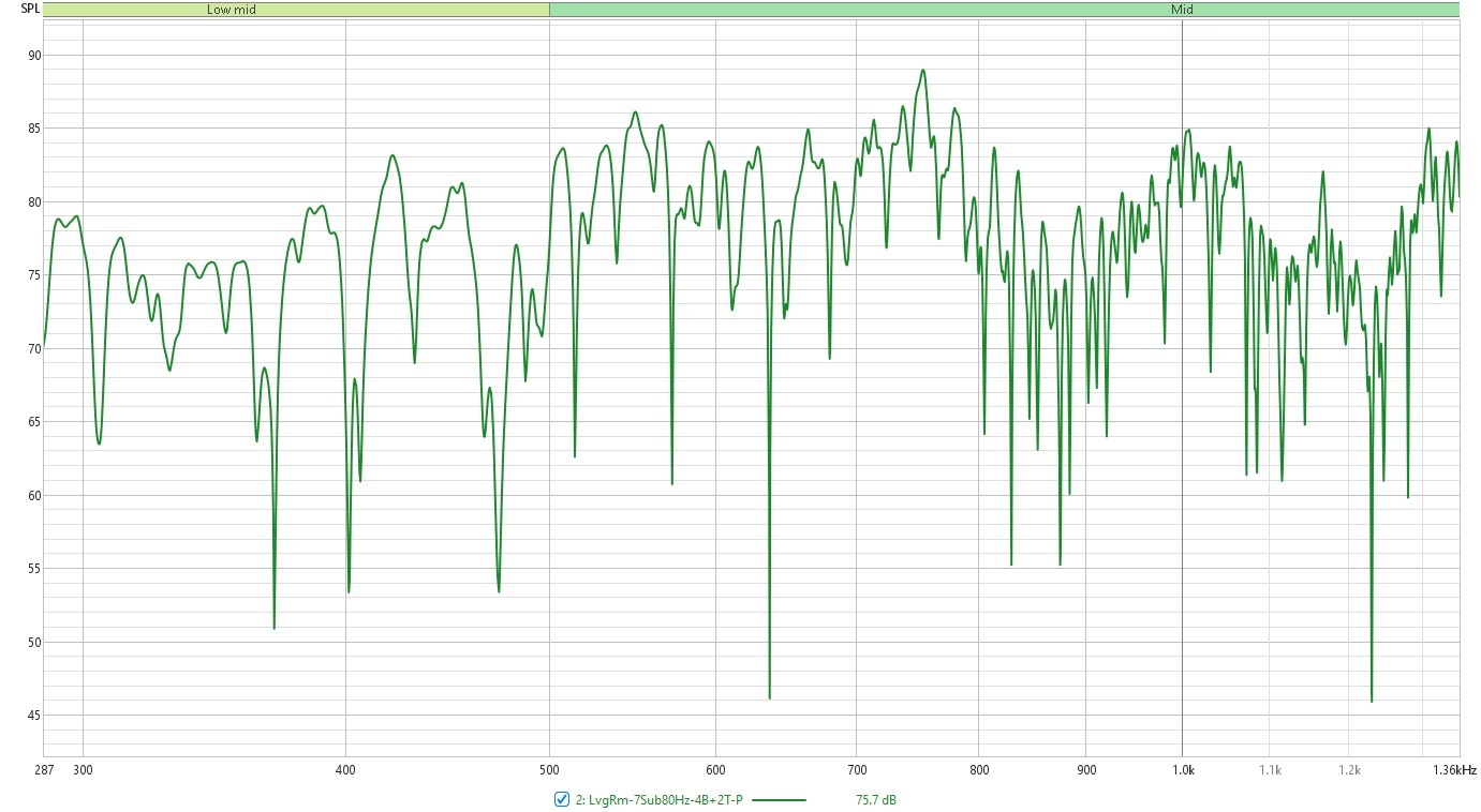

Here is an in room measurements of my Dali Ikon OW speakers with no gate or smoothing. The center of the woofer is about 135 mm from the wall and there should be and is a cancelation at ~640 Hz. It is much more dramatic than my calculations full of assumptions suggests, but it is also very narrow. I suppose part of this is the effect of the parallel walls of the room. I don't think I've ever looked at these measurements without smoothing and I have always assumed that these narrow cancelations are not audible. I will sit down with some sweeps and test tones and try to test that assumption.
Despite the way it appears, you can't tell much unless you don't include later reflections.

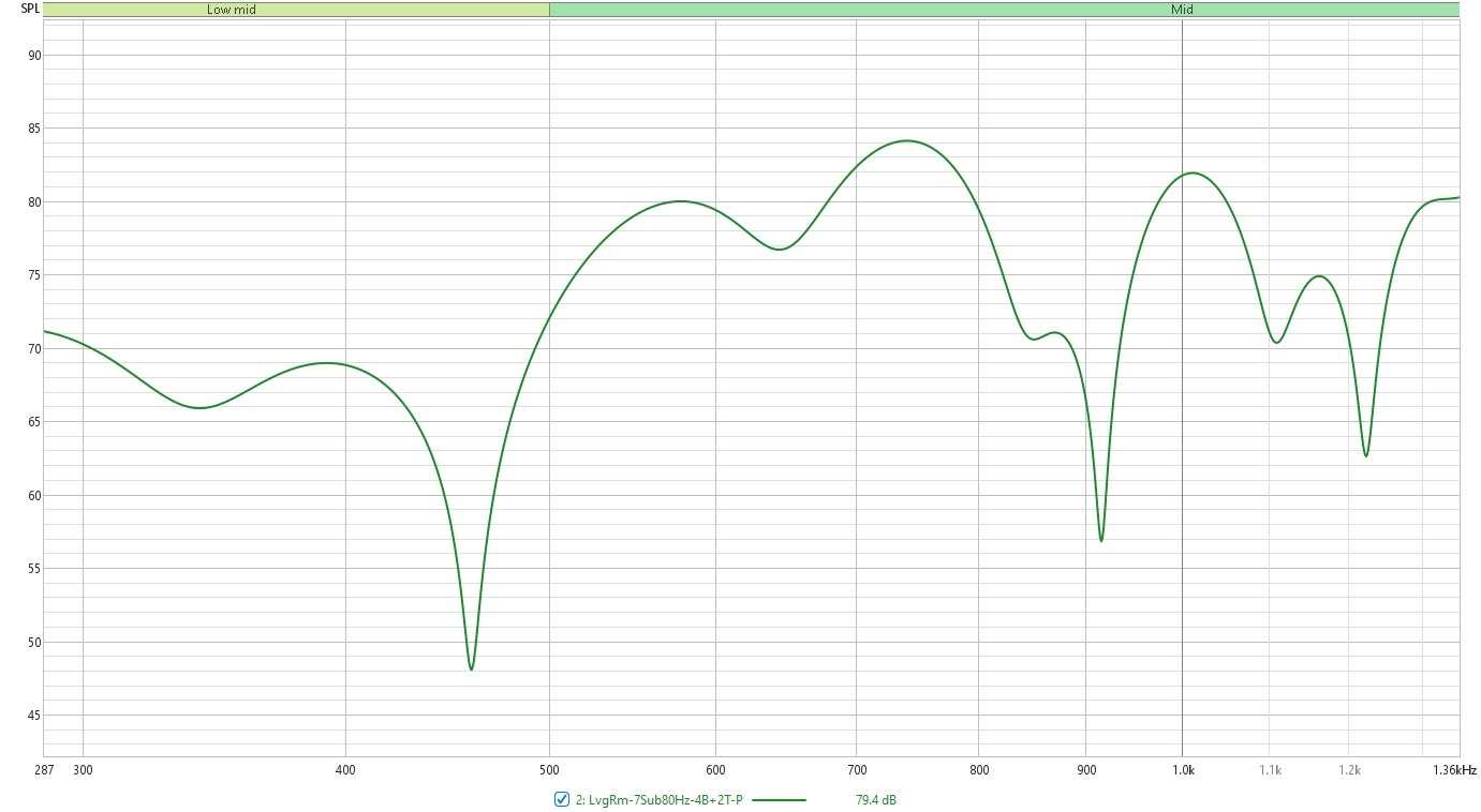

I've gated the measurement to limit it to the front wall's first reflection. There still appears to be the expected baffle distance cancelation ~640 Hz, but now the magnitude is closer to what I expected. I suppose it is important to remember that the first reflections are the most important as they are perceived as part of the original signal in a normal sized room.
