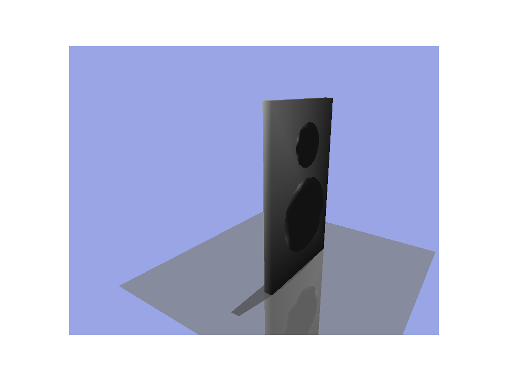

I have connected my open baffle speakers to my micro amp and it all sounds OK. Whatever sound is produced is clear, there is a lack of resonance of any sort. I can hear the bass but it is not very prominent, with the speakers against the wall, this is to be expected.
I know from experiment that moving the speakers towards the wall collapse the sound and also that if the open baffle speakers are about 30 cm from the rear wall the bass effect is substatially enhanced.

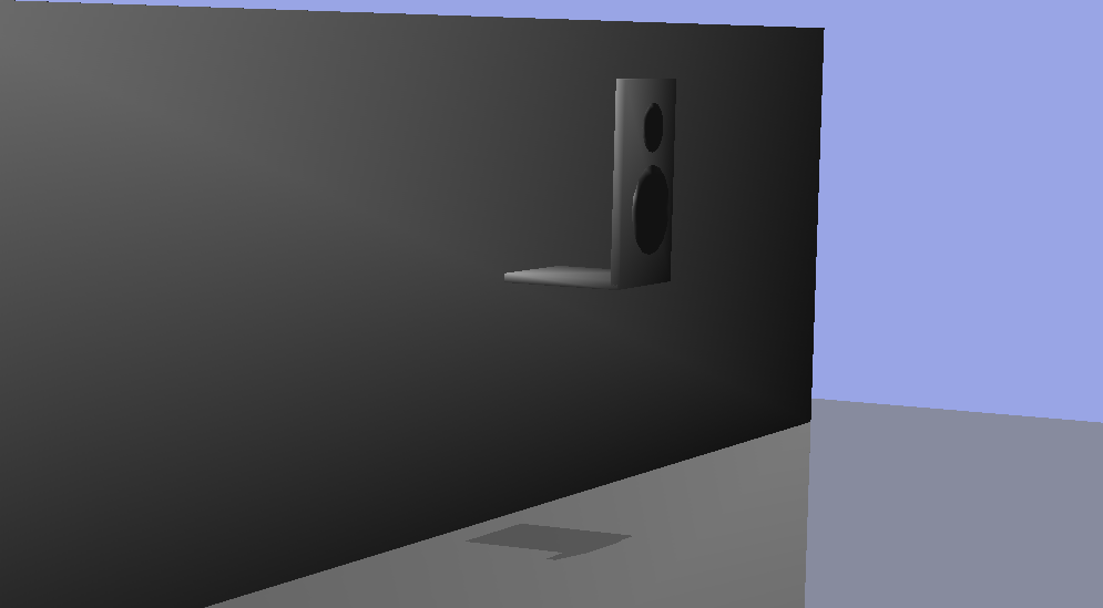

I want to mount the speakers at ear level on the walls, what is the best way to do this? I was thinking of either using the bottom support or top support as shown, which will be better for sound reproduction?

What you are showing is a linear quadrupole which has a steep roll-off at low frequencies and nulls at higher frequencies. What are you trying to achieve with this arrangement which doesn't seem to have any obvious advantages?

Baffle orientation regarding the wall is wrong. For best bass, baffle should be almost perpendicular to the wall on which is mounted (left and right, not back!), touching the wall. Mount left speaker baffle to the left wall, right baffle to the right wall, at about 1 meter (or 1 yard) from the back wall. Angle baffles a little bit to your listening position. You don't need horizontal support, mount baffle on the wall along the vertical frame.
Andy, are you not familiar with Open Baffle speakers?
To some extent which is why I can see disadvantages in an arrangement like that. It forms a linear quadrupole which doubles the loss of bass with falling frequency compared to a dipole and inserts a sequence of nulls in the upper frequency range of the midwoofer. Whatever benefits might be had from the directivity such as driving some of the room modes less strongly don't seem to much of an advantage in comparison.

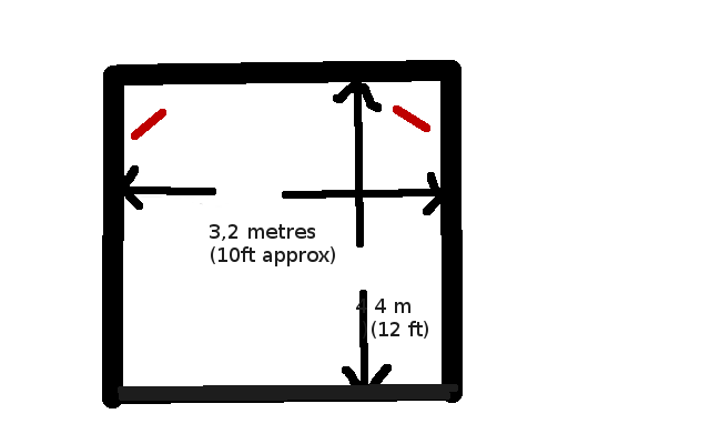

With lots of space behind them: out in the room or on the sidewalls would be a better arrangement.
If you want to place a speaker on the front wall then designing it to handle the strong reflection off the front wall would be prudent. A cardioid can work well with attention to the cancellation dips. 3 way monopoles can also work well. A dipole orientated to point at the side walls or floor/ceiling would not have reflections off the front wall but would, of course, radiate little sound at the listener and that would vary strongly with small movements in the listening position. For the midwoofer of a 2 way "dipole" I can see no obvious reasonable orientation but I am happy to be shown otherwise.

Agreed, ........all the benefits (which are few) of an OB are lost.
Thanks. I think I will try the sidewall mounted arrangement it's simpler and can be done with hinges to adjust the angle of the speakers. I must admit I am a little lost on this dipole quadrapole concept and more so on how it interacts with the walls - nothing that cannot be remedied with a little reading or online vidoes, I guess.
