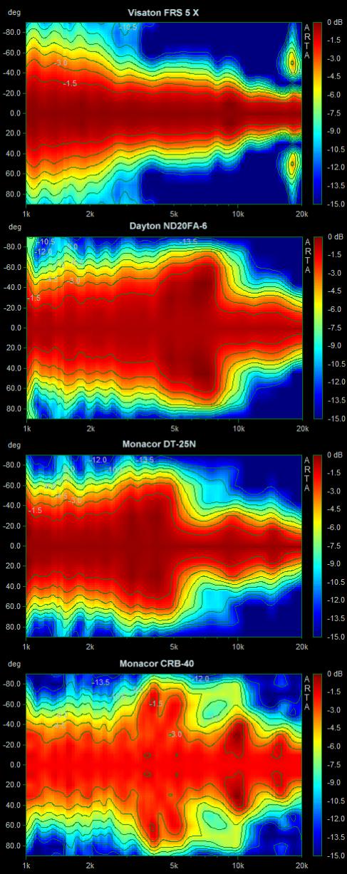

The lower three drivers are back-to-back tweeters with the Monacor being the largest and the Dayton the smallest package. Note how a "bulging" region moves upward in frequency with diminishing dipole length. The upmost driver is a small cone driver Visaton FRS5X, which does not feature such a bulging region. It is a strong argument for the one-diaphragm-dipole tweeter.
Obviously the Neo 3 is the best dipole tweeter solution available apart from some very expensive AMT tweeters.

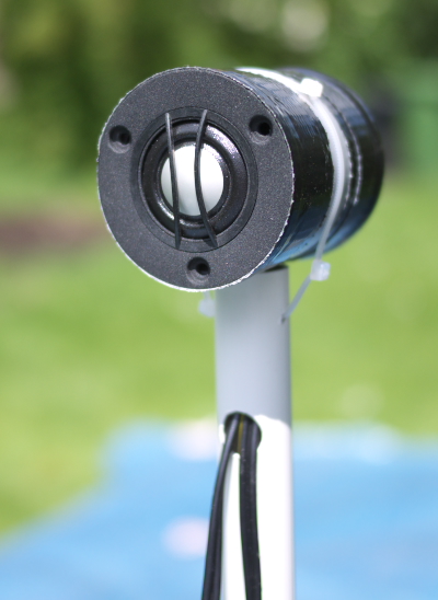

I add one for the gallery.

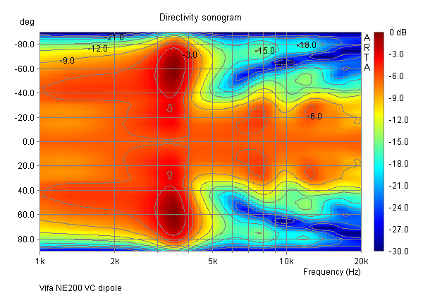

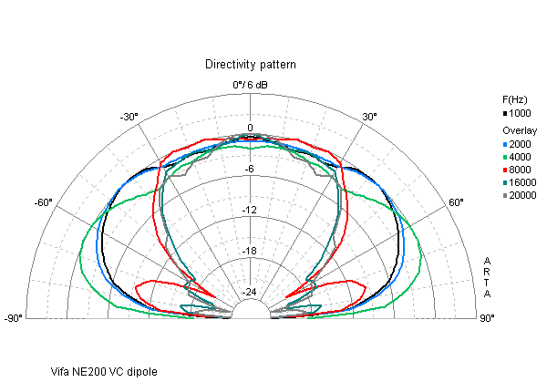

This is a double-pack of Peerless Platinum NE19VTC-04, for DIYers aka NE 200 VC, a 0,75" (measured at 1m).
The dipole length is more or less the same as Rudolf's Monachor setup. But the polar response is just...not good. The Klingon Bird of Prey seen from the top with a nice first null at 3.5KHz.
Even if one could have a double-dome-dipole (ddd 😀 ) with a nice polar response, it would still be difficult to integrate it into the x-over to the mid driver. Not to mention SPL capability.
I think this is a dead end.

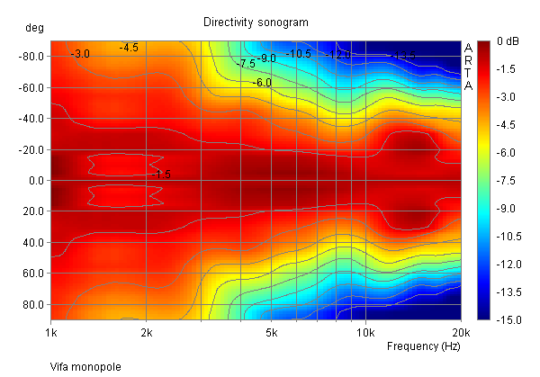

Oh, BTW, the Vifa is mono not bad at all for that money (measured in the same jig).

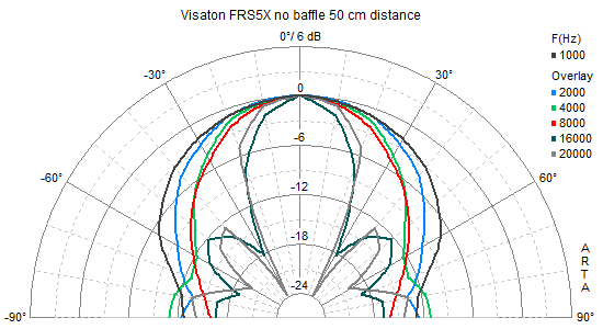

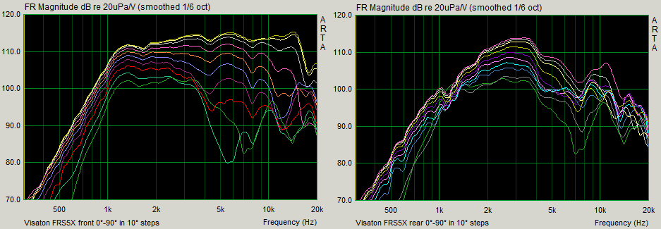

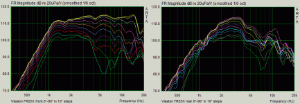

Agreed. Rudolf do you have the data from the backside of the FRS5x ?The balance of front and rear is more important.
You made up your mind, hu ? 😉I'd choose back to back domes over forward-firing only waveguide.
Also agreed.Seriously though they are not as bad as they look.
If I equalize the front response to somewhat linear, both look like this:Rudolf do you have the data from the backside of the FRS5x ?
What I still like about the response:
I have tried to keep the colors and the division according to your VIFA diagram. Does the VIFA have some kind of diffusor in front of the dome?
Even if the backside response of the FRS5X rolls off above 4 kHz, the response to the side will stay inside a nice dipole 8 for the front radiation. If I think about it: To me the balance between front and rear is less important than the well reduced radiation to the side.

While "directivity" is another category than "decline": Try to keep as much HF in the reverberant field as possible, compared to the direct field. Think "diffusity" instead of "directivity". But I can't tell you, if this will "improve" your sound. I have no idea, what you understand as "improved". 😉a) would close to ideal directivity towards HF improve sound compared to typical "decline";
Aren't "waveguide" and "dipole" contradictive?b) positive effects of baffle width/size in dipole configuration for HF (i.e. drivers with waveguides "hanged" vs waveguides suspended in baffle);
I'm not sure where the problem should be. But if it is part of the stereo illusion or the hearing mechanism, I don't see how omni or dipole would make a difference.c) omni vs figure-8 in 0.3-1kHz range - should we bother about (human-specific perception factor as having difficulty to locate source point in this range) ?
I need to see the polar pattern of that device. WGs should roll off continuously (for the most part) to the side, dipoles progressively. If it is just two waveguides mounted back-to-back, it would not matter if they are 0° or 180° in phase.
Yes, I do need to take some more efforts around measurement to be sure of the exact mode of operation. But the key part is that I have a wide bandwidth (everything over 250) operating as dipole (by the definition that front and rear lobes are 180 degrees out of phase), with significant (and reasonably consistent) directivity in forward and rearward lobes.
