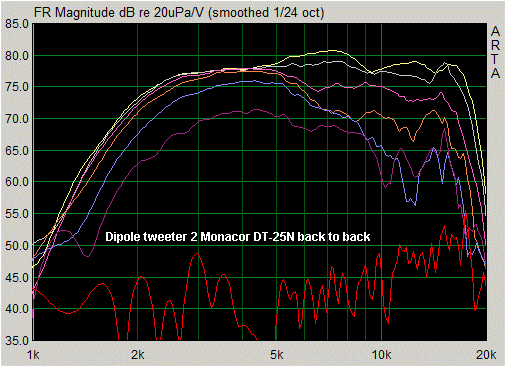

I have built two dome tweeter dipoles in the back-to-back fashion:
The bigger one is two Monacor DT-25N back to back in a tube of 3.3 cm radius and 4.4 cm depth (including the front plates of the tweeters). This adds up to a dipole distance of 7.7 cm, which would correspond as wavelength to a frequency of 4450 Hz. Let’s look at some measurements from 0 deg to 90 deg horizontal with a high pass filter at 2.5 kHz to protect the drivers. Shown are 0, 15, 30, 45, 60, 75 and 90 deg:
attachment.php
We see nice constant directivity from 1 kHz to almost 4 kHz. At 4.5 kHz - the wavelength of the dipole distance - the wave from the rear tweeter will need just a wavelength to reach around to the front - so no phase difference (or 360 deg) on axis to the wave from the front tweeter. Since both waves are 180 deg out of phase at the source, they will reduce each other. Hence we see a dip in the on axis frequency response. Above that dip the dipole CD gets lost and beaming takes over. You see that in the spreading of the off-axis-SPLs with rising frequency above 4.5 kHz.

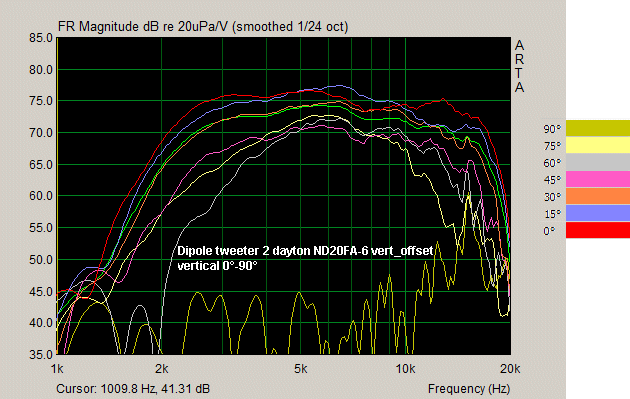

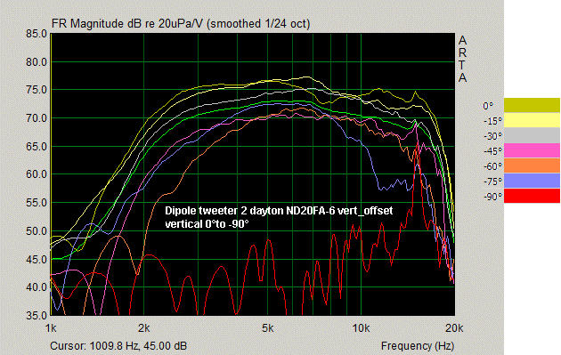

I have asked myself if it would be possible to undercut the dipole length of 4.1 cm. Voila:
I placed two Dayton ND20FA-6 back to back, but vertically offset, on a small baffle (8 x 4.4 x 1.4 cm). This results in a dipole distance of 3.6 cm at minimum (9527 Hz). See the horizontal response (0, 15, 30, 45, 60, 75, 90 deg), measured at 45 cm distance:
Not too shabby, either, with that dip at 8 kHz.
You may think that the vertical response will be very bad, concerning the vertical offset of 3.4 cm between the driver centers. That’s what I did too. But measurements along the vertical axis show a benign response. Green line is the power response:
attachment.php
attachment.php

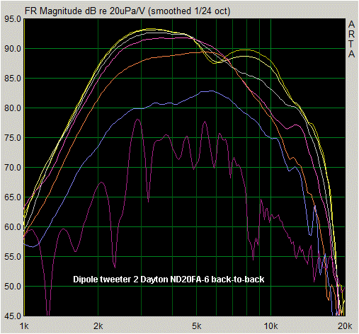

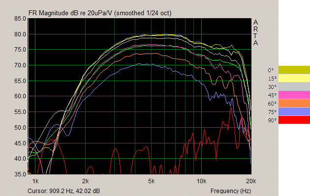

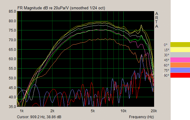

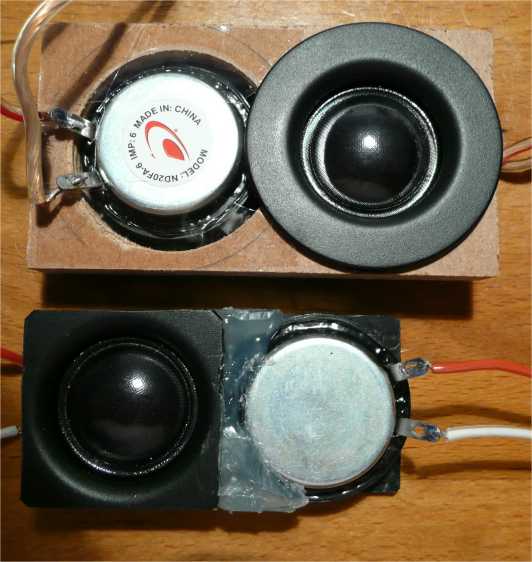

Am I completely nuts?
attachment.php
I cut the front plates of two Dayton ND20FA to the minimum and glued them roughly together without any baffle. You can compare the size to the previous baffle above. Dipole length now is 3.1 cm.
Then the same horizontal measurement procedure as before:
attachment.php
Since I could not believe what I saw, I did the same for the backside of the dipole tweeter and moved to the other 90deg side:
attachment.php
Green lines are for power response. Don't know why the 75deg response for the first diagram did not come up like that for the second series.
Tell me that this can't be true. Both drivers together are under 19 Euro. One BG Neo3 is 79 Euro in Germany.

Can you remove the front plate from the ND20 to cut it down or do you just mask off the dome and cut it?
attachment.php
No removable front plate. But you can easily saw or cut around the magnet housing from the backside. Quite soft plastic, no danger of anything chipping away. I did mask off the dome, yes.
Instead of simply glueing the drivers together - as I did - it could be a good idea to make a pair of mounting flanges like this:
attachment.php
