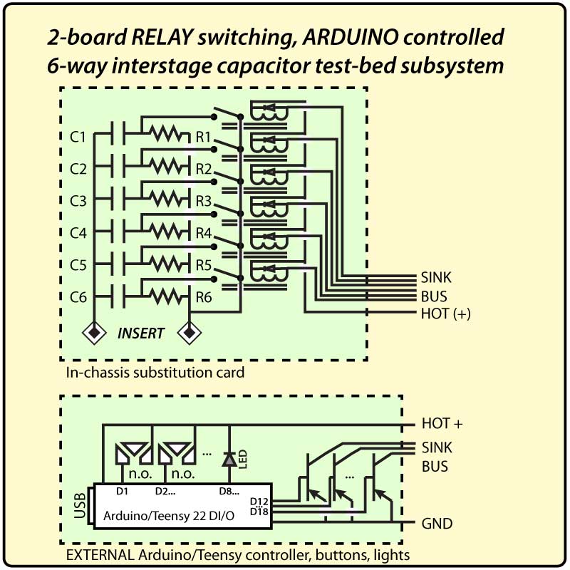

Just do it. I've already a quick RCA - rotary switch - RCA wooden panel board. You can connect the capacitors behind the panel, that way you won't see which capacitor is which. You can type down each rotary switch position and if you can hear a difference, listen to long term differences, and write down observations. Give it a few days of playing around, switching positions, then look over and discover which capacitors you liked the most.
Exactly. A make before break rotary switch would never let anything float. The goal being to separate what you imagine you hear from things you can pinpoint and repeat consistently with a fast switch. I know myself listening to the same song an hour apart who could remember what is different? He'll i could convince myself the same cap sounds different tomorrow on the same song!

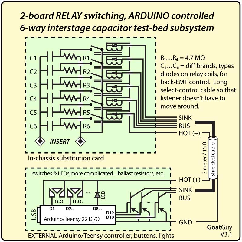

Since… I've invested a bit of time in drawing up things… here's the 'version 3', which incorporates 3 V miniature relays, and an Arduino / Teensy style stand-alone microcontroller (USB powered).
Beauty is, could also be computer controlled, or at least, the attached tablet/computer could also be observing the results, tallying them for later statistical analysis.
The possibilities are almost endless.
Just Saying,
GoatGuy ✓

Yah, all that, but also too
№ 3 - double blind random selection
№ 4 - recording of findings
№ 5 - many-subject (listener) breadth
№ 6 - nefarious-listener 'confirmation bias' thwarting
That last one is a big one: people who have built and burnish a reputation of having Golden Ears, and especially ones that can hear-and-extol-the-virtues of platinum plated ground unicorn horn $1,000-a-pop capacitors, very often (and quite subtly) go far, far out of their way to determine in advance what is being tested, and when parts are substituted in, which they are listening to at the moment.
The above box-and-relay card, which I'm buying parts to build, rather completely undermines the Nefarious Agent Looking for Confirmation Bias Clues.
Which is good.
Makes 'em mad, but who cares.
Just don't rub noses in it, that's all.
Just Saying,
GoatGuy ✓
