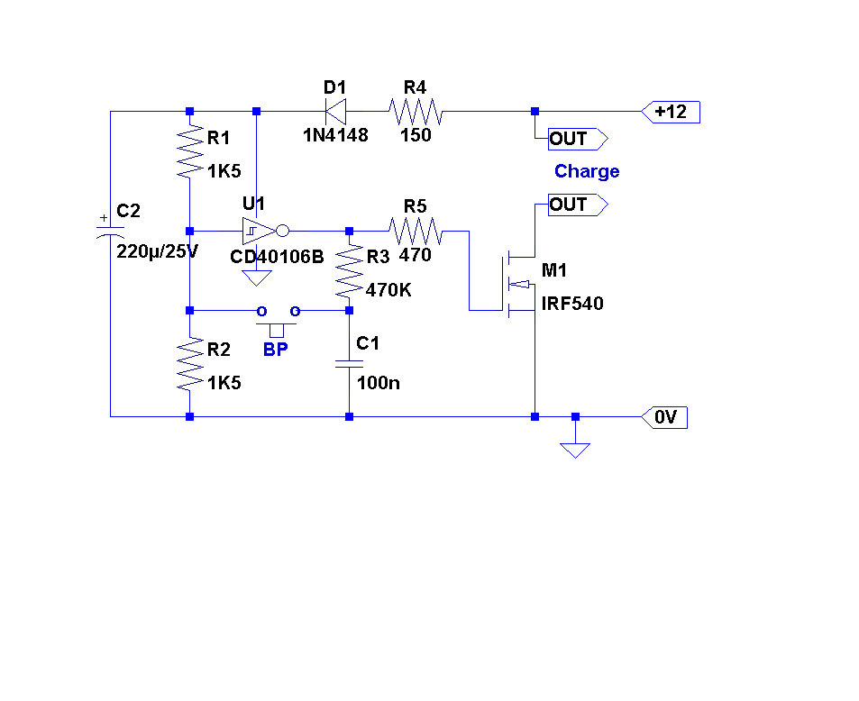

Along with the flip flop you need to be sure it is de-bounce or you have to add a small cap across the switch. A one shot can be an advantage. But then you have more complexity. But then it is easier to interface protection detection circuits for auto shut-down.:scratch2:
This circuit includes the debouncing, and you can make make six of them out of a single IC.
It was made for automotive applications, but can work from 3 to 15V if you remove the supply filter.
You can use a smaller MOS or a bjt to drive a relay.

Perhaps you're looking for something like this (using D Flip-Flop)
