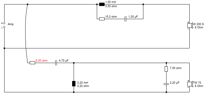

10 or 12" bass and tweeter will take you out of your depth because phase alignment is tricky, but 8" bass plus tweeter is doable. I like this combination myself. 😀
Here's the WLM La Scala, a highly respected speaker that uses the Visaton W200S-8 and Visaton TW 70 Cone tweeter.
30 Litres of 39Hz reflex tuning and it all models well for the smaller monitor version. We could privately discuss a better crossover later, but this will sound very good with rock or any other music I guarantee. 😎
Here's a simple crossover that will work well enough:
