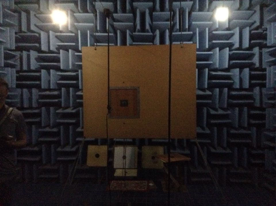

Does exist a standard how to measure SPL (to compare comparable)? If I understood well measurements are based on 2Pi radiation. How they technically make commercial measurements that excludes baffle step?
Yes. Here is an example. It isn't perfect but it is useful.
