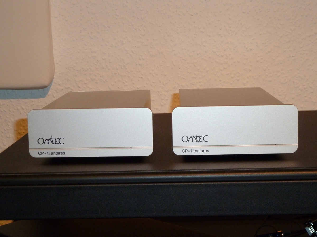

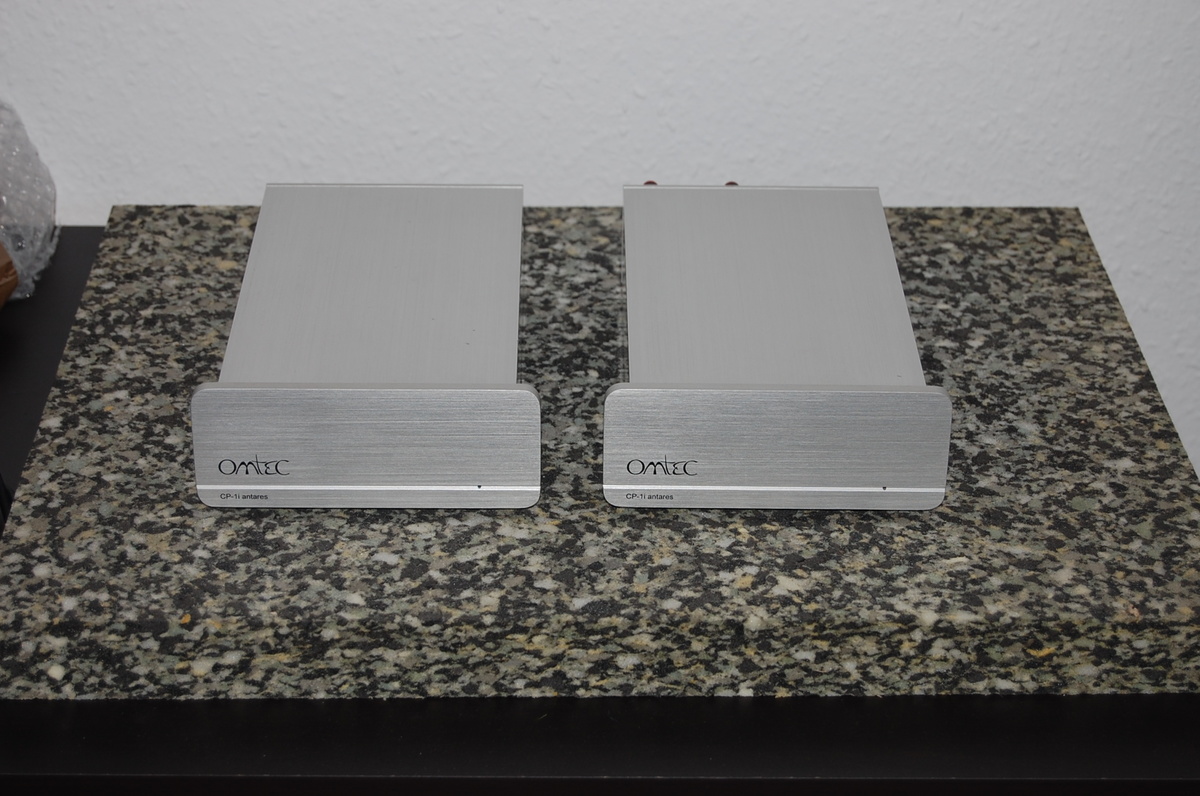

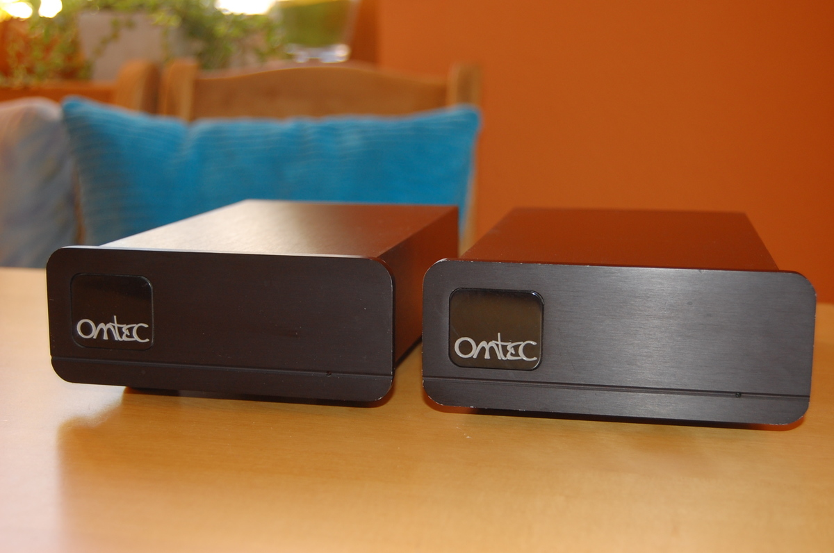

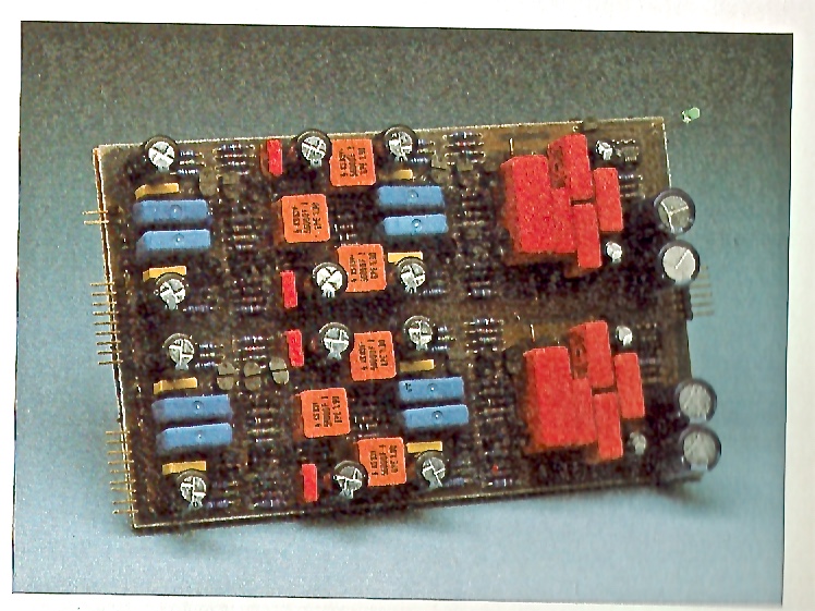

and an image from German magazine "STEREO" - top view of PC-board:
Omtec Antares Version 1 bis 4 Infos - Phonovorstufen und Ubertrager - Analogue Audio Association
Betriebsart Omtec Antares - Phono - allgemein - Analogue Audio Association
Omtec Antares Bedienungsanleitung - Phono - allgemein - Analogue Audio Association
Omtec Antares CP1i V4 - Phono - allgemein - Analogue Audio Association
various versions

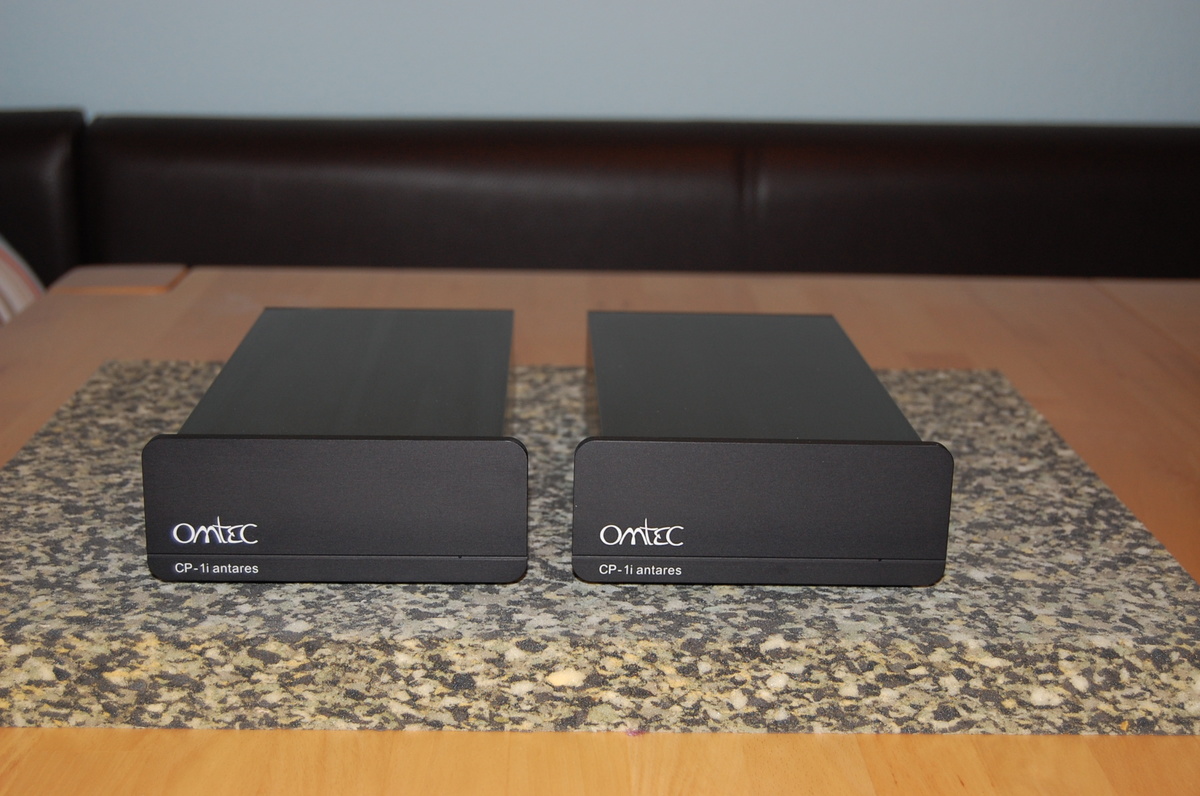

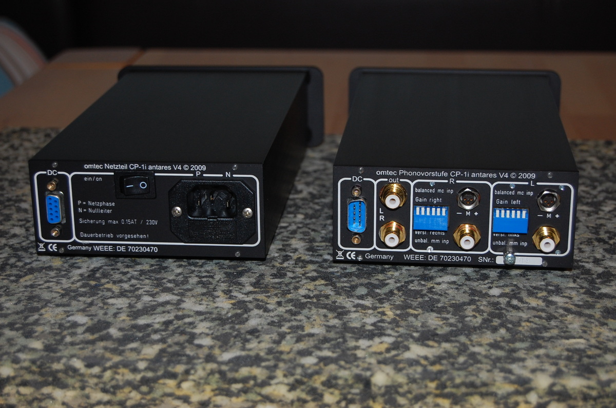

The review and your pictures suggest it is full of glue, as if they did not want anybody to see inside.

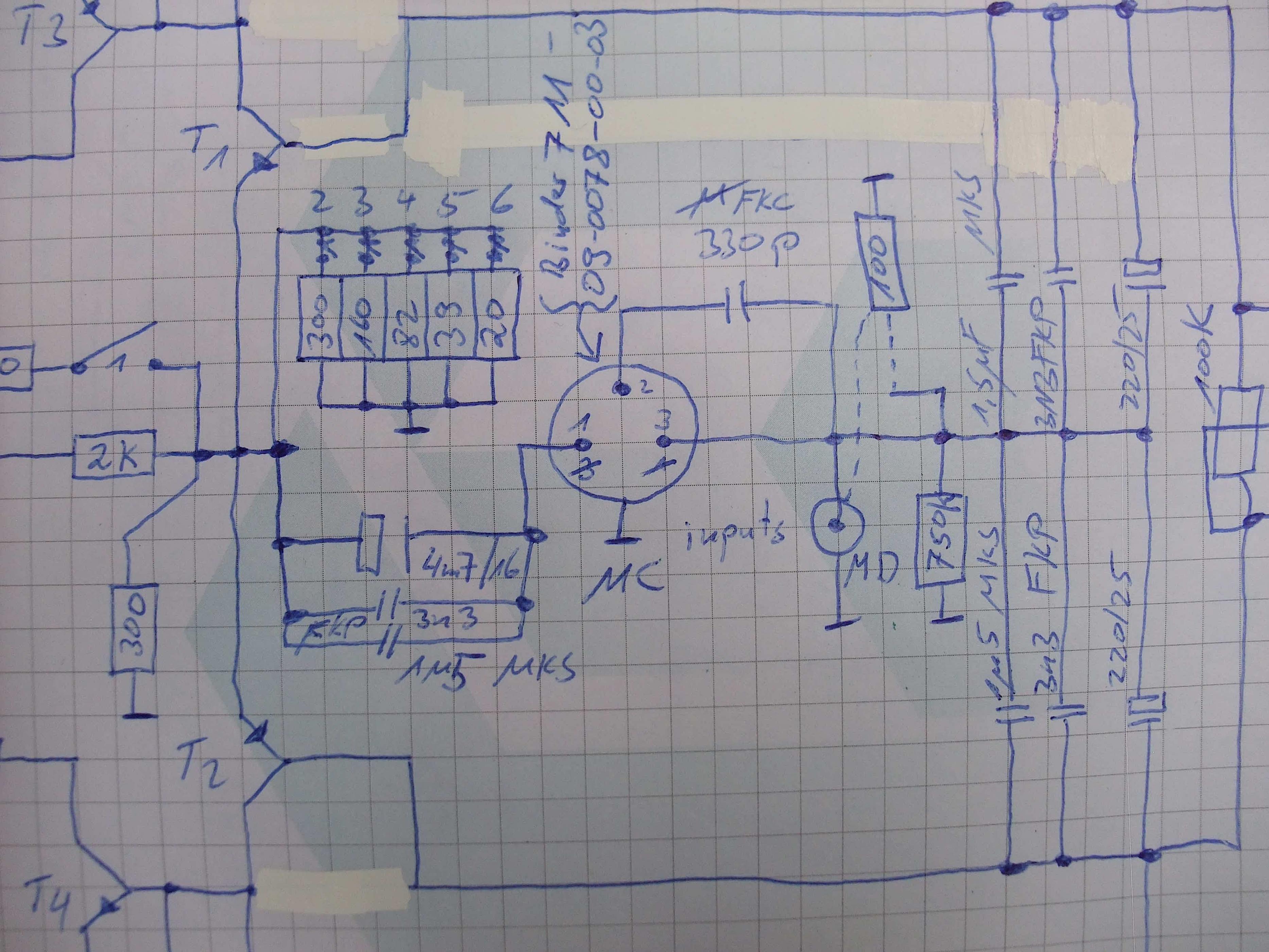

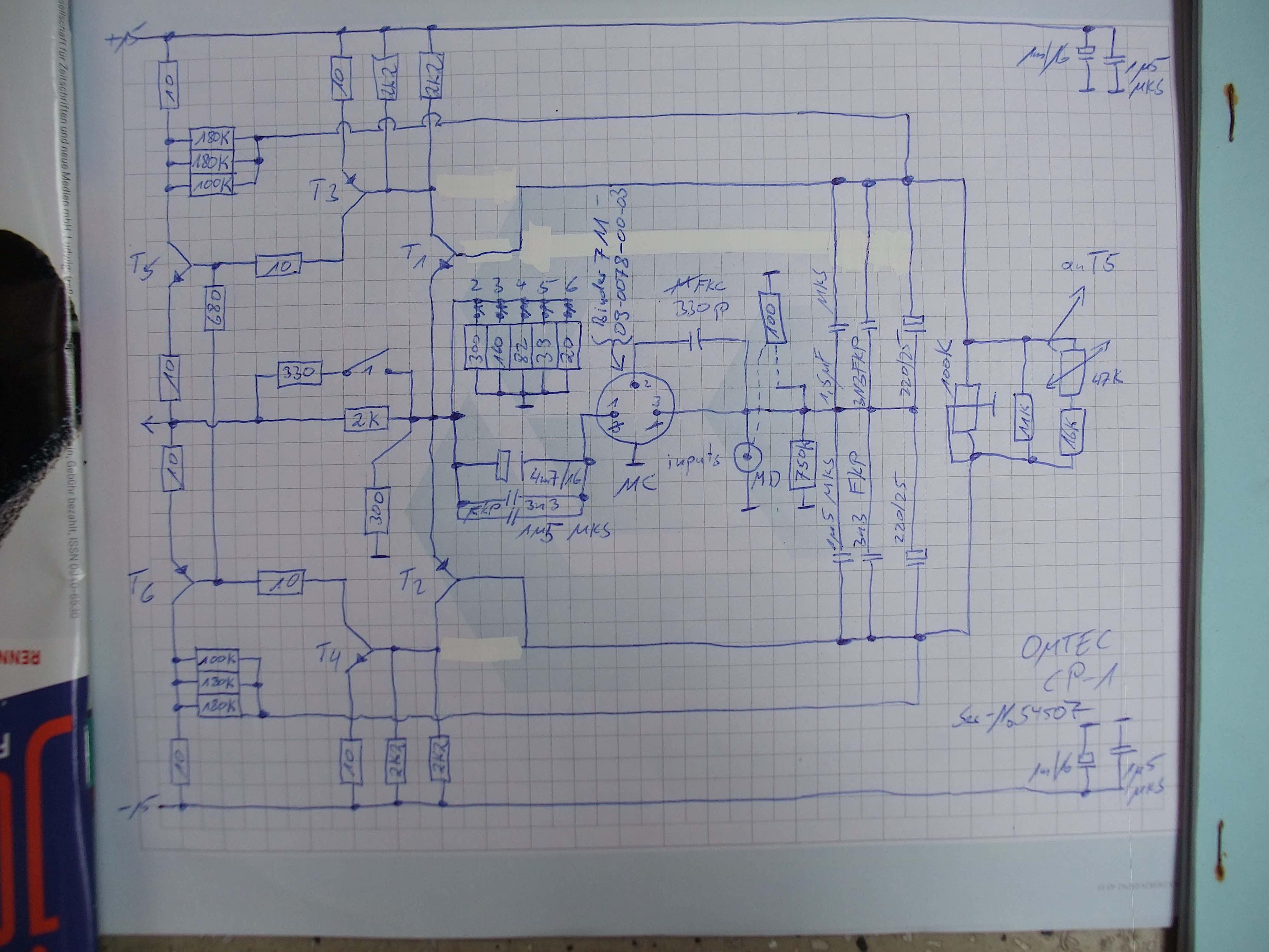

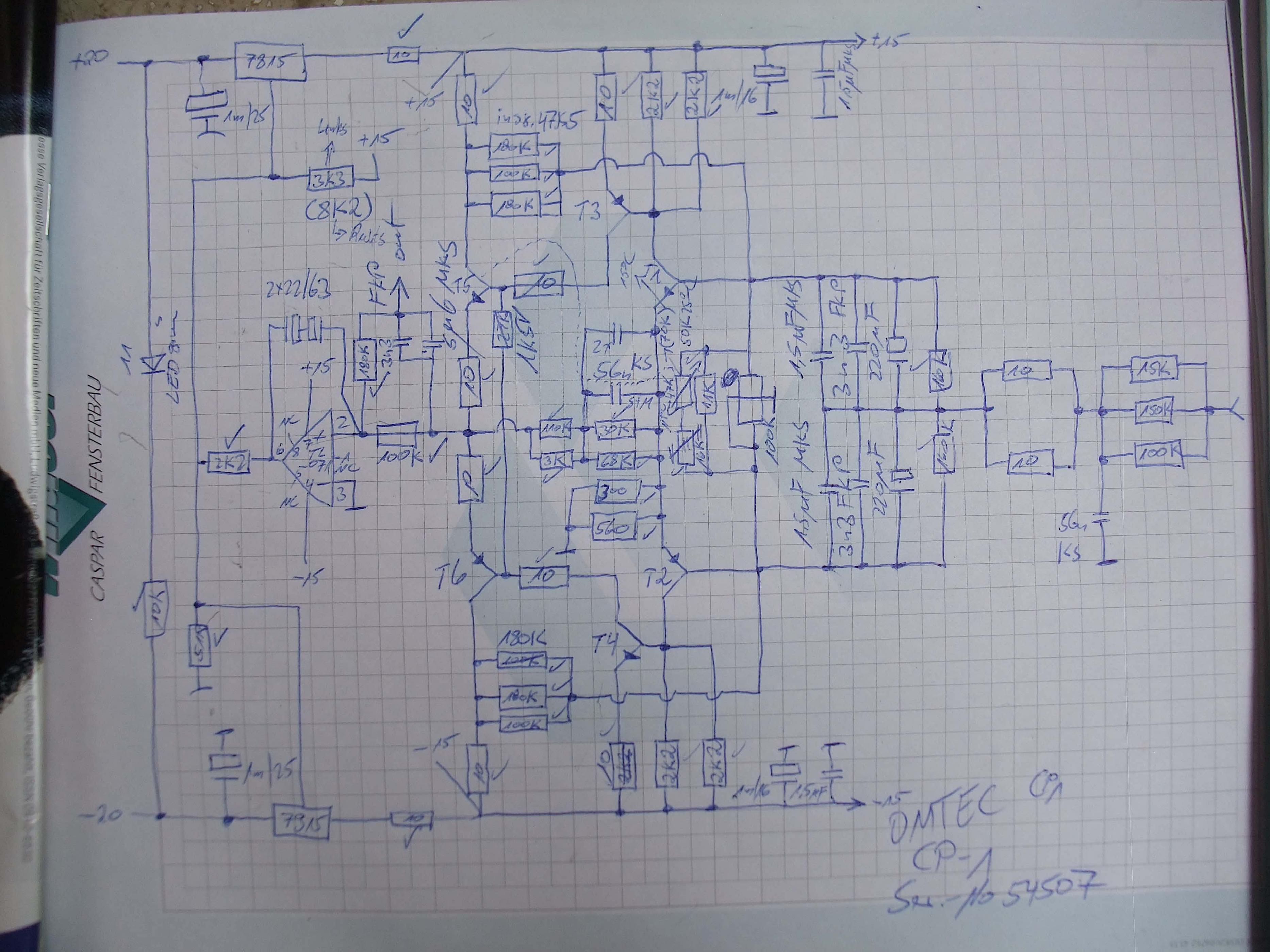

Balanced Mode at Input with different input impedance
Schematic (from serial-No 54507) and instruction manual here:
Actually it is a discrete version of an AD846 - go to page 8 under
http://www.analog.com/media/en/technical-documentation/obsolete-data-sheets/270284AD846.pdf
There are three different input modes possible for moving coil cartridges:
1) unbalanced mode with high impedance input (non inverted input)
2) unbalanced with low impedance input (inverted input)
3) balanced mode with different input impedance on each half
The main question for me is, how is to connect the input resistor in the balanced mode ?
I have find out, that the mentioned version under
https://www.diyaudio.com/community/...-ser-no-04058-how-old-and-which-model.396097/
is also the version from this topic.
Again the question: How is connect the input load resistor in bal. mode (schematic go to previous post) ?
