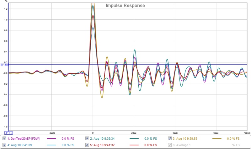

Good work looks like you are closing in 🙂 For your correction have you used minimum phase EQ and then removed the excess phase, I think from memory that was the way swiss bear went?
From doing a similar thing recently I would say to look how closely the IR peaks are aligned before you average them. For me REW did not do a great job of doing it with the time align function. Your's might be different but it does have an effect on the high frequencies if the impulses aren't within a certain tolerance when they are averaged. Make sure the averages are run on raw data too just to be sure, leave any windows or smoothing for after.
The impulse averaging weights the dips more than the peaks, have a look in the all spl window with all of the individual measurements open to see if there are any areas where the average is not representative of the majority of positions. EQ'ing those up could result in peaks which might be more objectionable than a dip.
Have a look at the frequency response through a Frequency dependant window too, if there are any areas where there are a number of dips close together they will show up quite clearly, those are the trouble spots.
The spectrogram is a good way of looking at the time data too.
Impulses are tricky to interpret sometimes, there is some unusual pre-ringing in yours. That could be the result of phase correction or something funky in your chain. Take a loopback measurement of your soundcard to see and set the processing to flat to see if there is a change there. Some DAC's have some quite strange impulse responses due to their filtering.

That's correct, it was min phase and remove excess. My amplitude corrections were manual in RePhase only, I prefer to match the filter [fc, G, Q] to the response defect. I have only corrected (so far) using the standard EQ PK forms

Good suggestion. I have not paid much attention to alignment. I just let REW generate min phase and remove offsets. The FR data was raw before averaging.
Looks like you want to remove the "outliers". None of them looked weirder than the others. Maybe I'll try some subset combinations.

It is possible that my manual corrections, actually corrected things that were not there 😉 There was no FDW performed before averaging. I'll see if any weirdness remained via FWD on the avg.
Lookback may be a problem. My output chain is [PC]->S/PDIF->RVX659->speaker. My input chain is [Mic]->[PC] . I might be able to take a line out from the amp to line in on the PC for loopback.

Not quite what I meant, it might be that in the area you measured and with your speakers being omni you didn't get anything that was not representative in the average.Looks like you want to remove the "outliers". None of them looked weirder than the others. Maybe I'll try some subset combinations.
Because the dips are weighted more heavily it is possible when impulse averaging for a dip to appear in the average which is worse than reality if that makes sense. Correcting that might be an overcorrection in reality.
You can check afterwards in the same positions to make sure you didn't overdo anything.It is possible that my manual corrections, actually corrected things that were not there 😉 There was no FDW performed before averaging. I'll see if any weirdness remained via FWD on the avg.
Only use the FDW to view the average afterwards don't use FDW before averaging that will give weird results I would think.
It is very hard to get a good impulse when the input and output cards are run on different clocks. For measurement it is much better to use the same soundcard as input and output device if possible.Lookback may be a problem. My output chain is [PC]->S/PDIF->RVX659->speaker. My input chain is [Mic]->[PC] . I might be able to take a line out from the amp to line in on the PC for loopback.

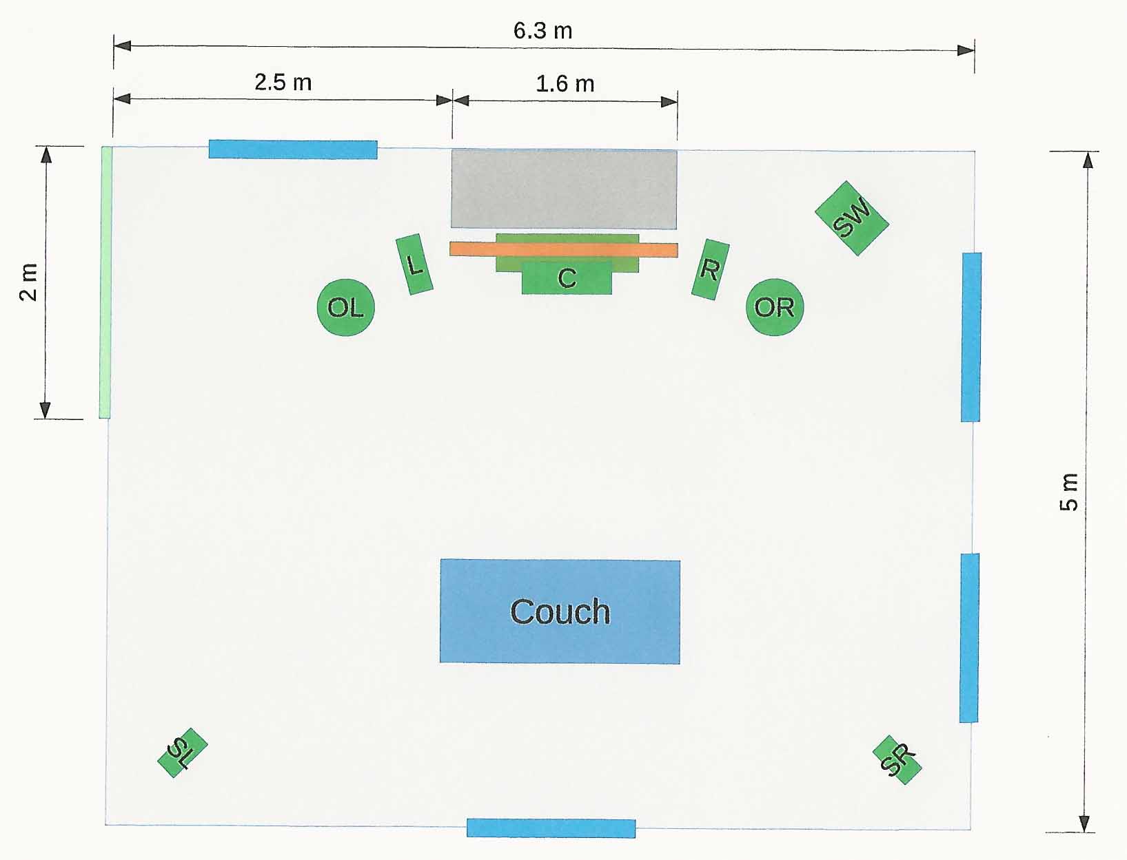

.... These are all measured at my listening position 2.4m from the speakers with no room treatment and no subwoofer.

There may be a misunderstanding in what is being attempted here.
My earlier measurements have been near field (1m) as you've suggested, and they were used to correct speaker issues. I have a preferred location for these near field measurements that has minimal room reflections.
This latest set of measurements treats the speaker and room as a system and takes multiple measurements around the listening area. In my case its a smallish sweet spot around my listening couch. It's an attempt to get corrected sound to the ears. It excludes LF (<100Hz) as these are room modes. Overall this system correction sounds better than the speaker specific near field corrections.

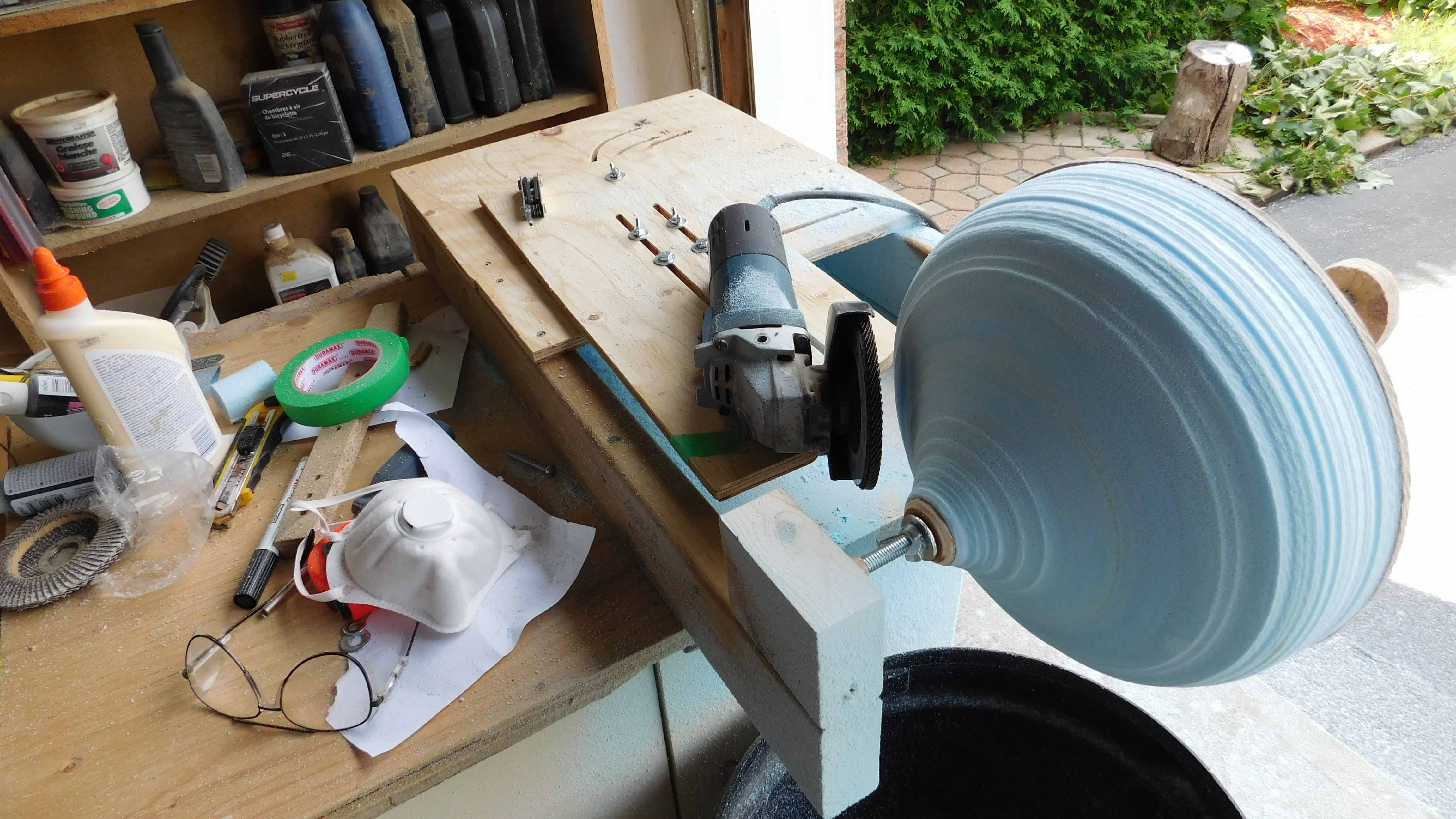

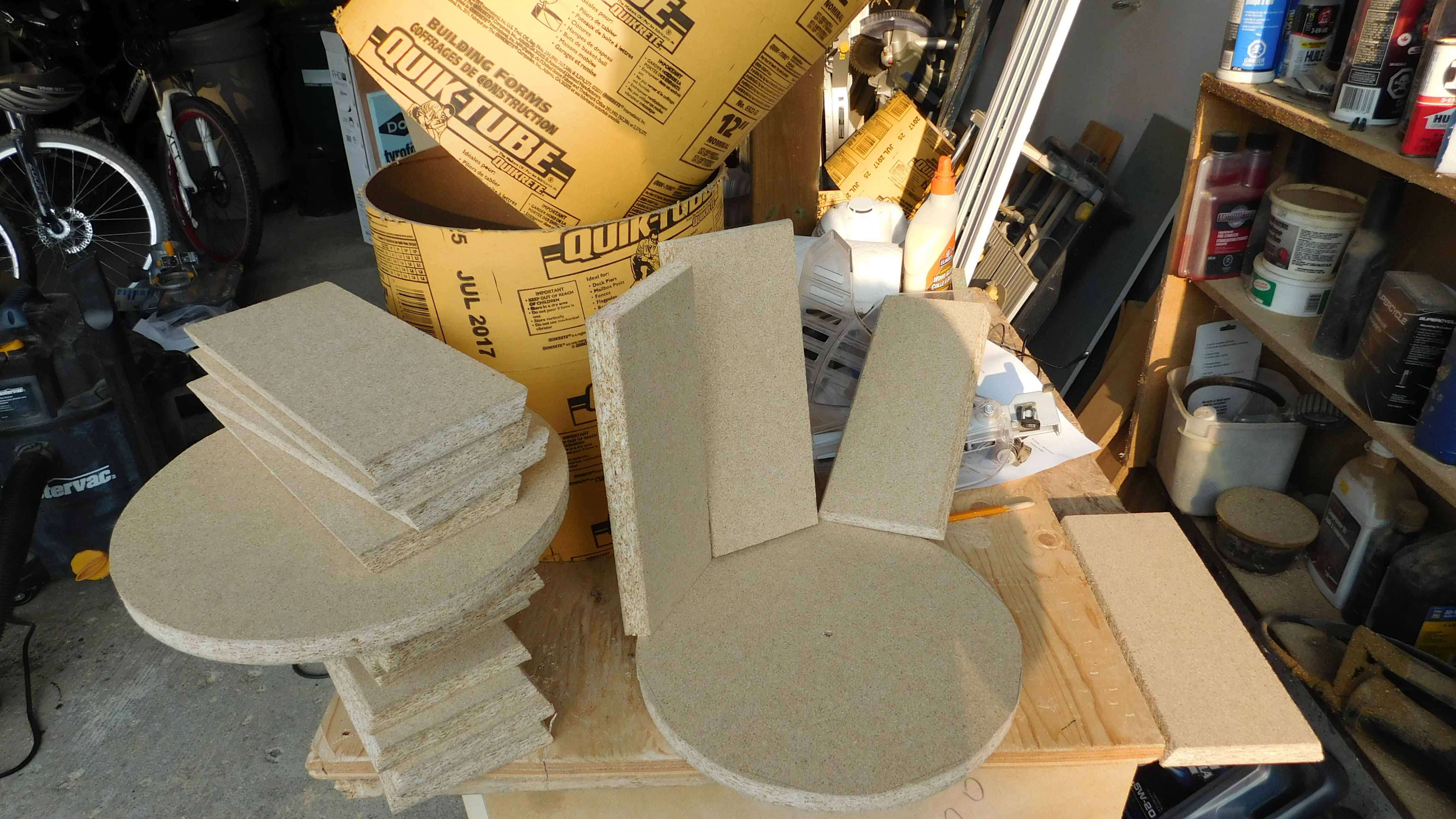

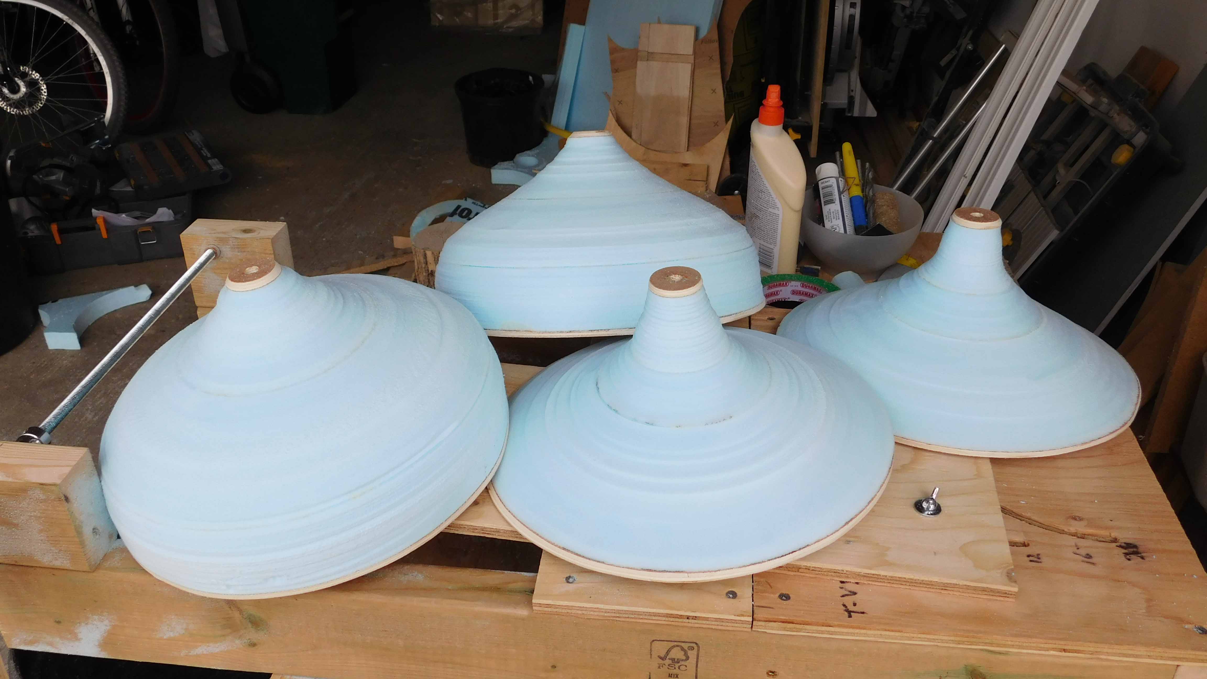

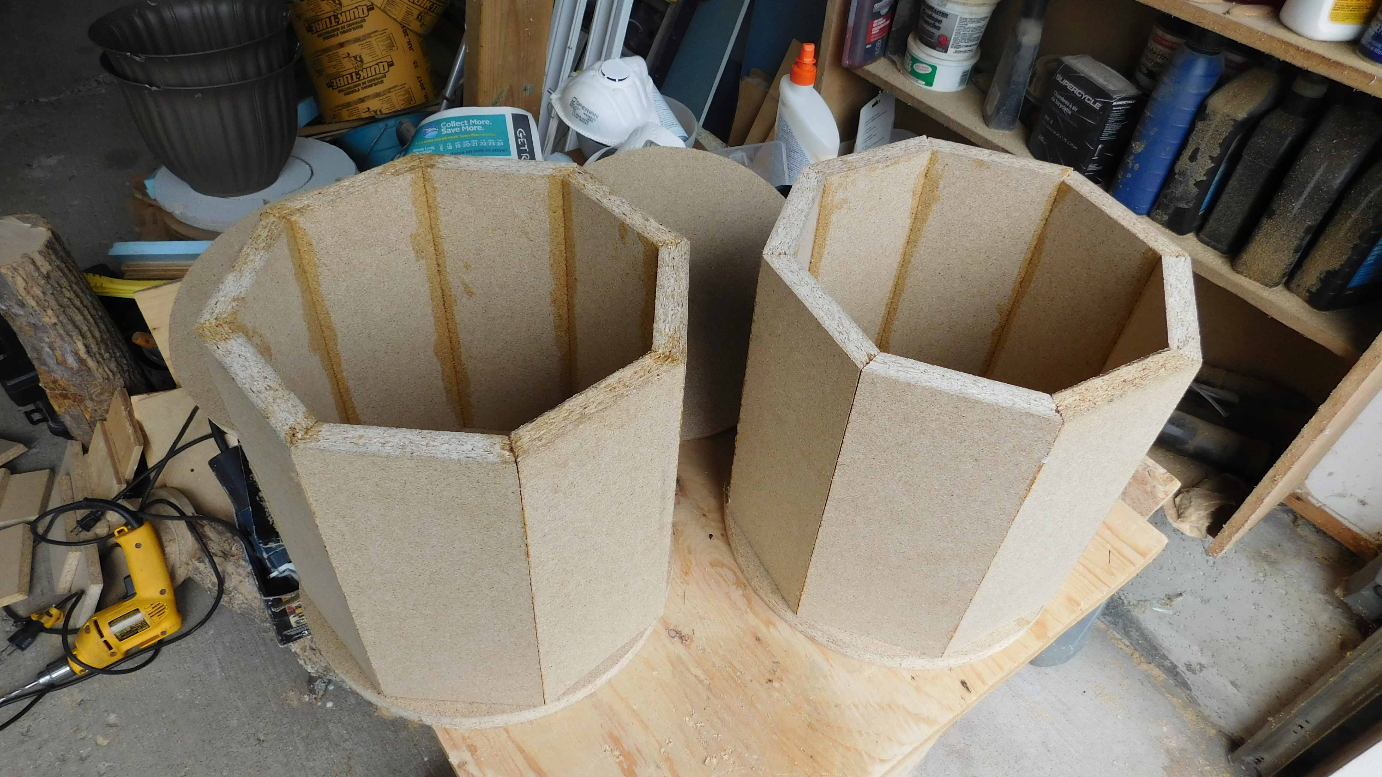

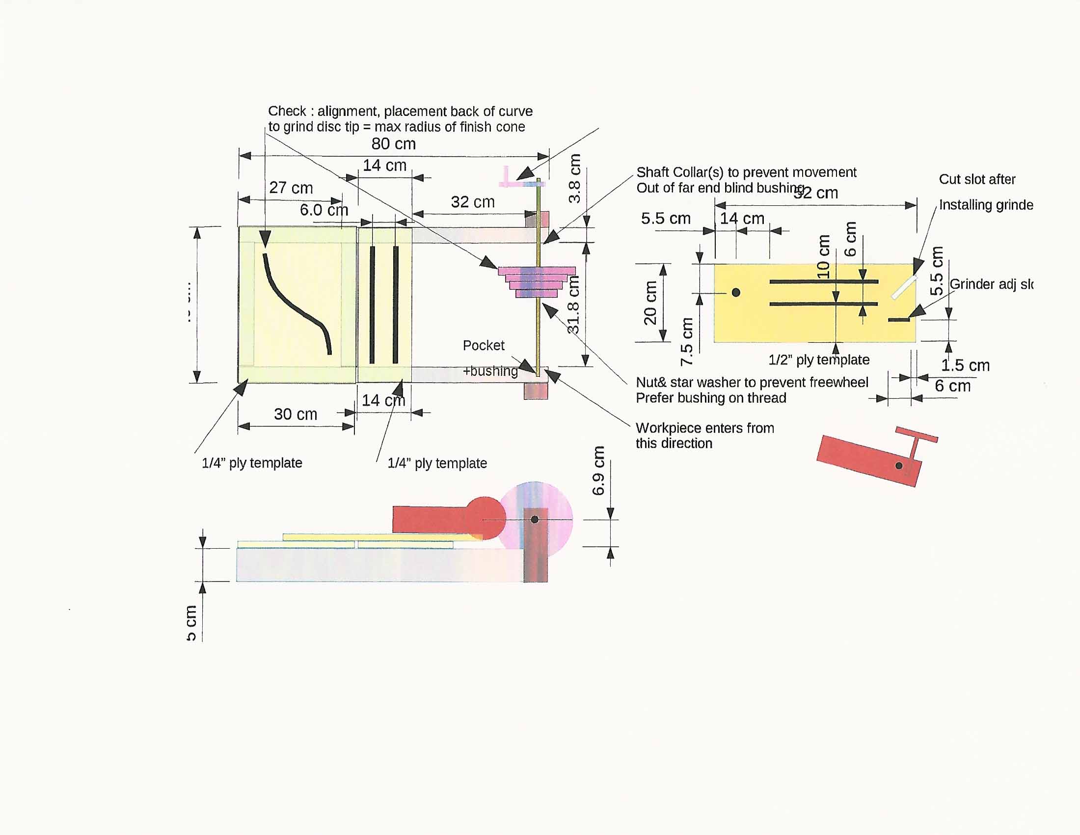

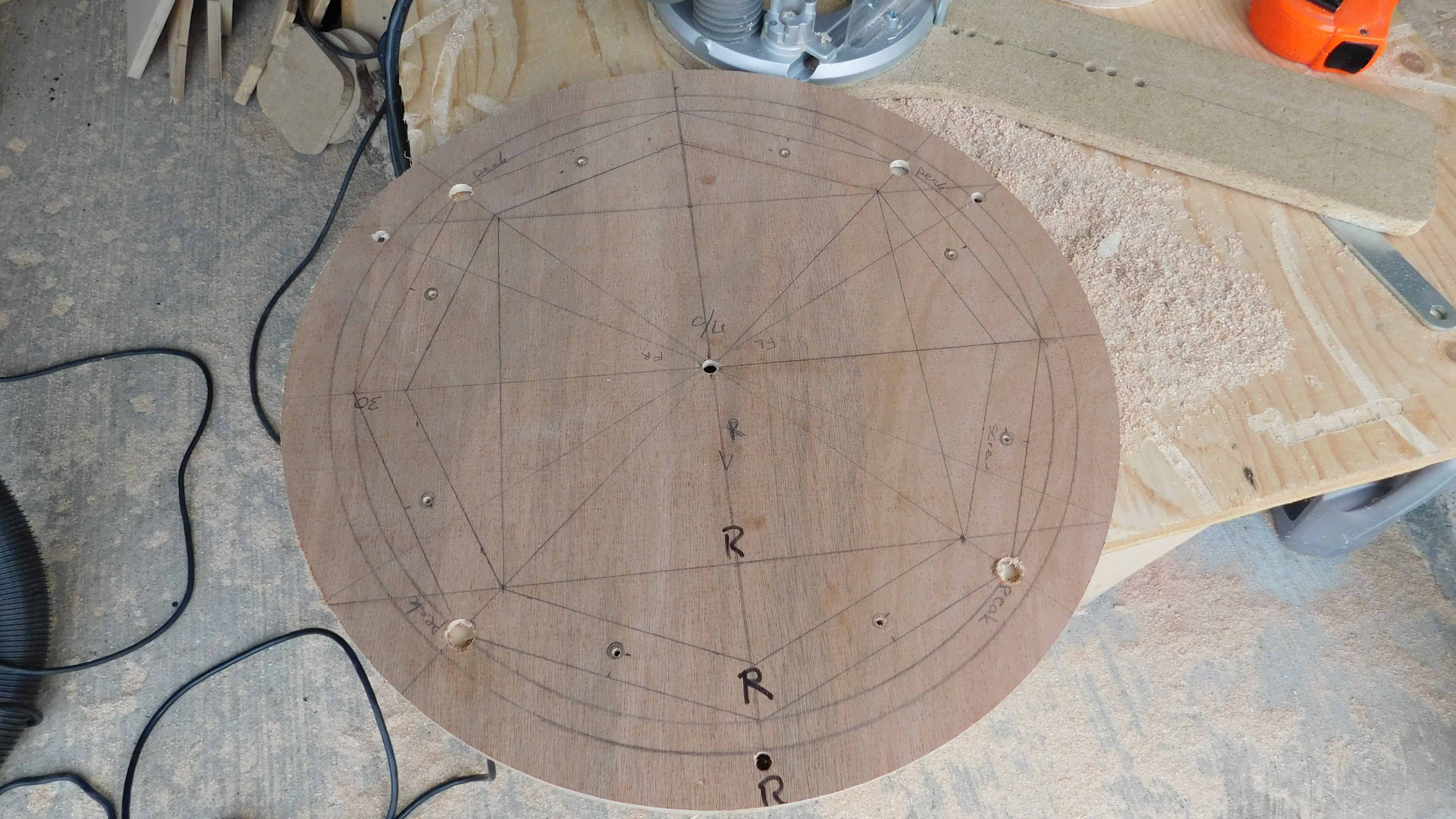

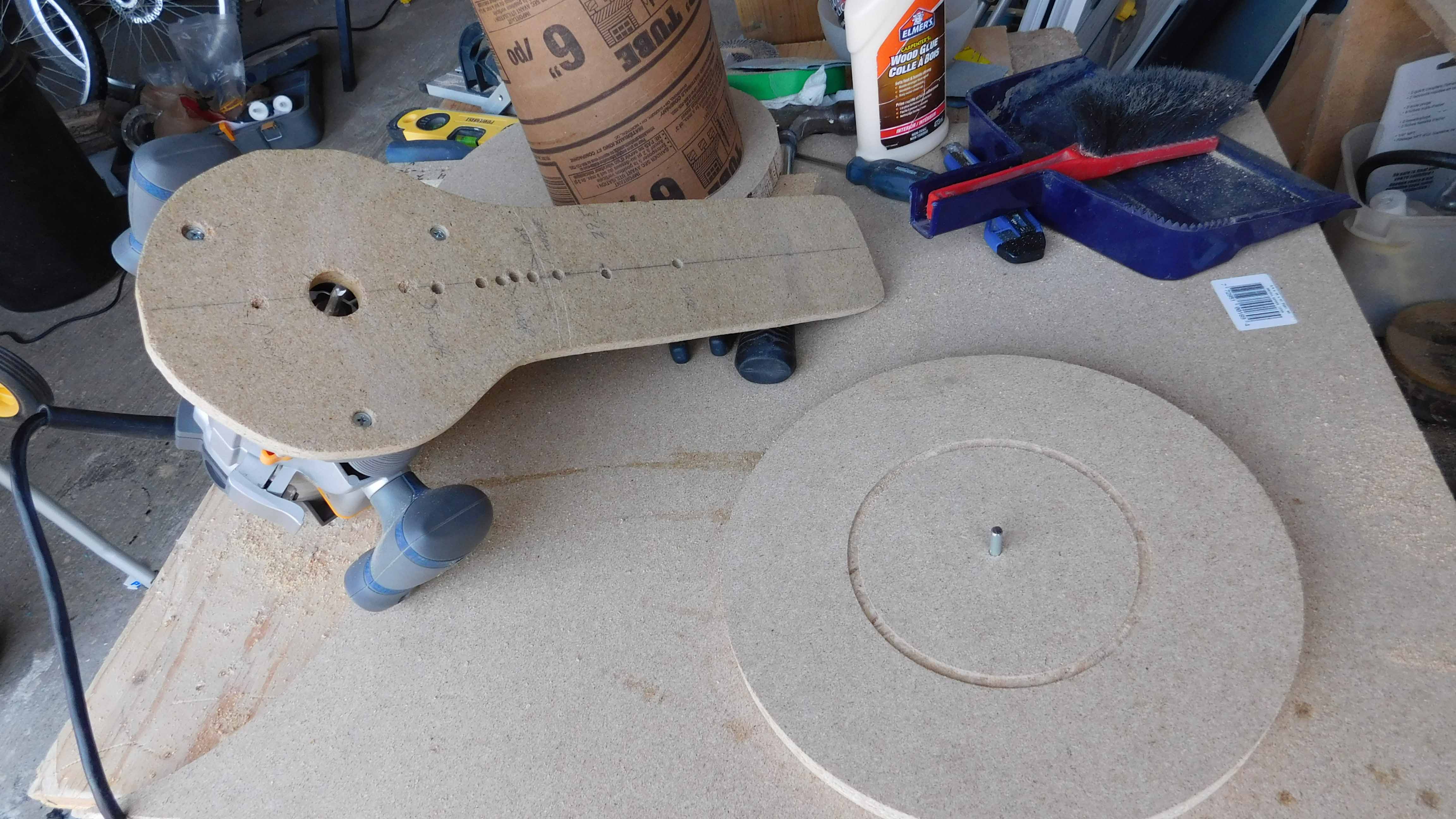

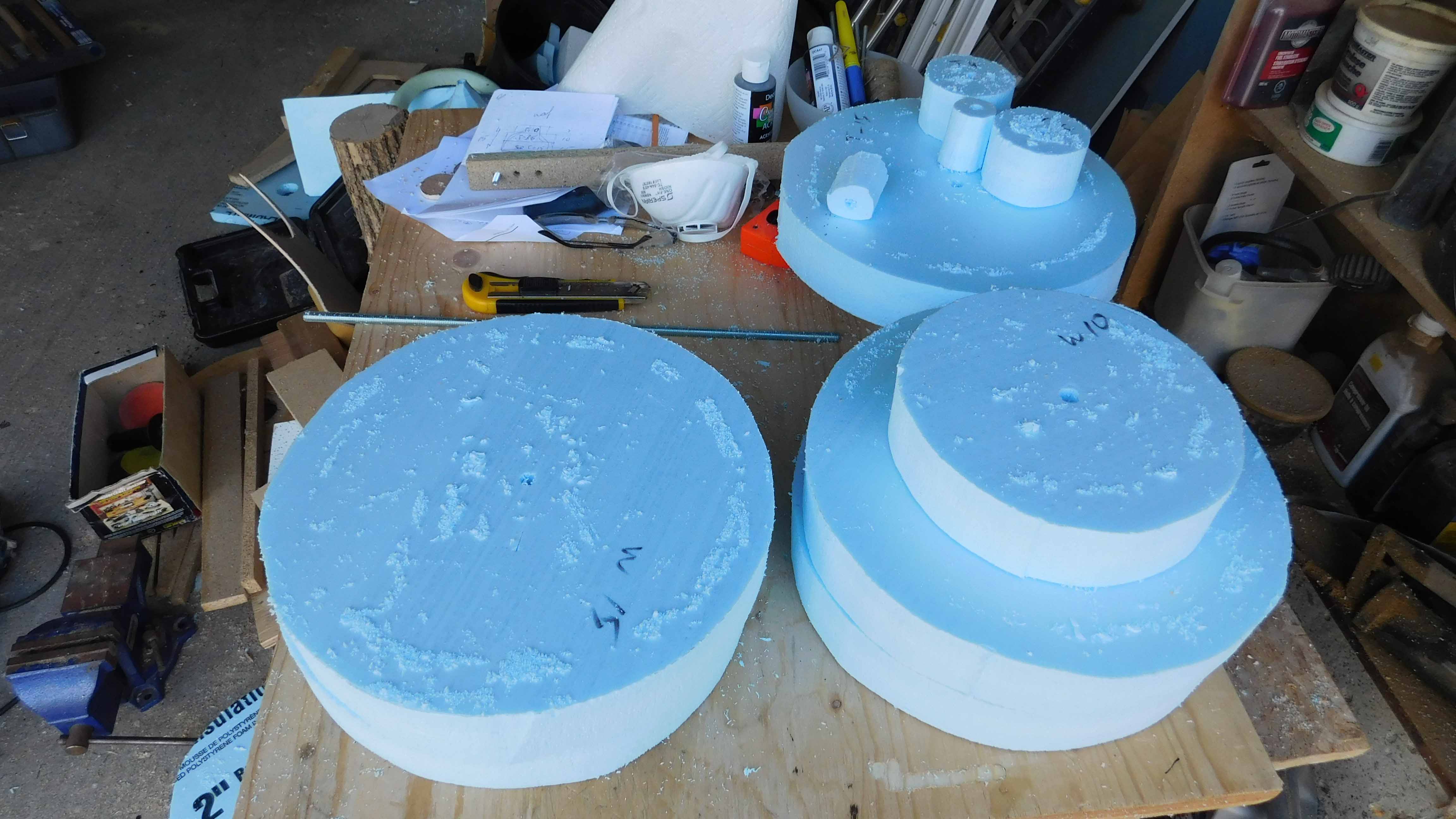

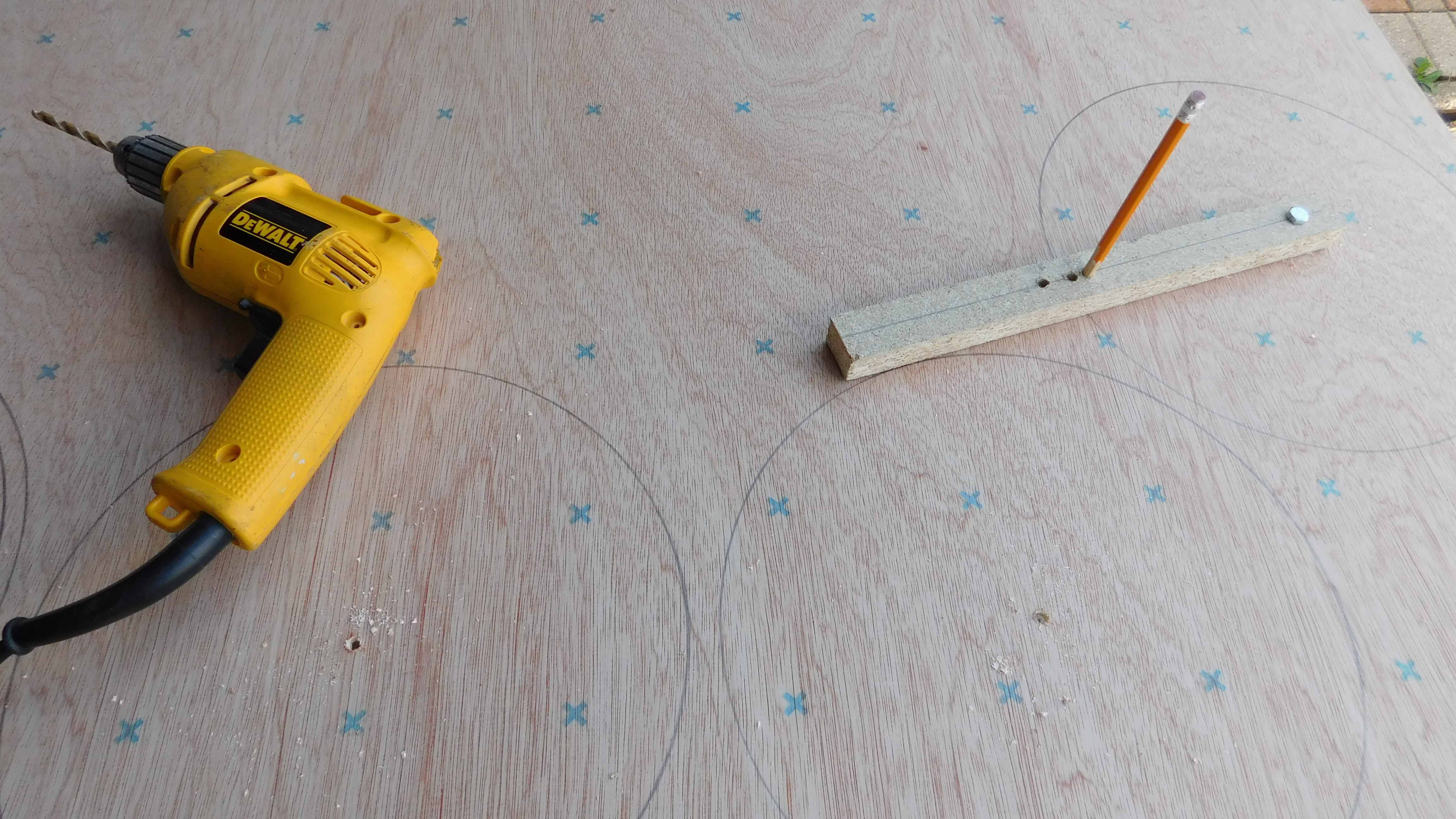

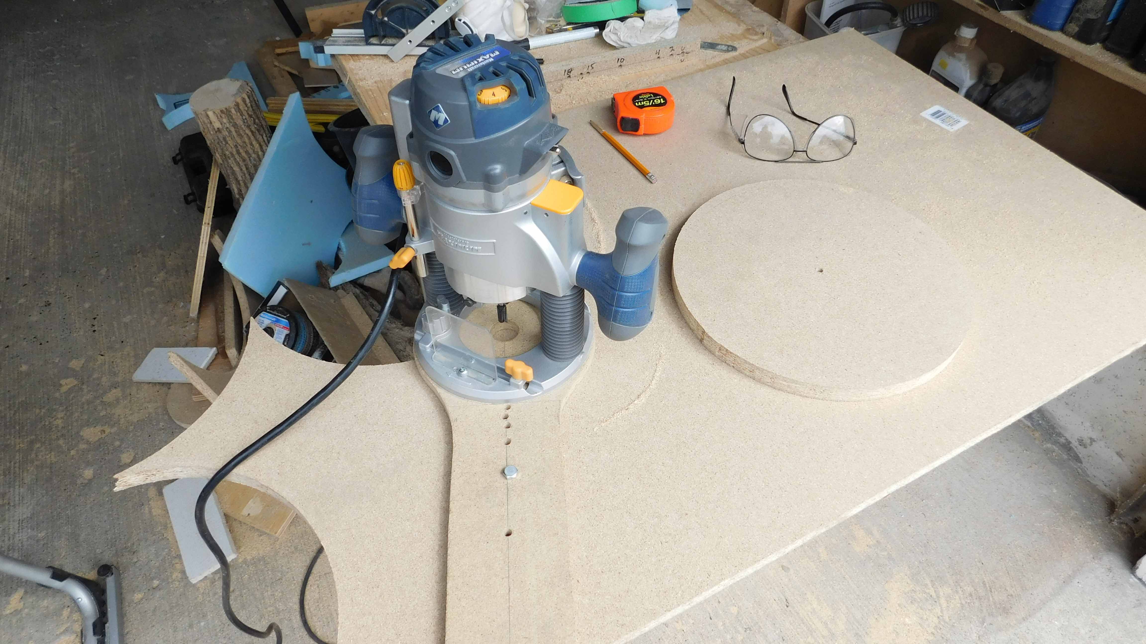

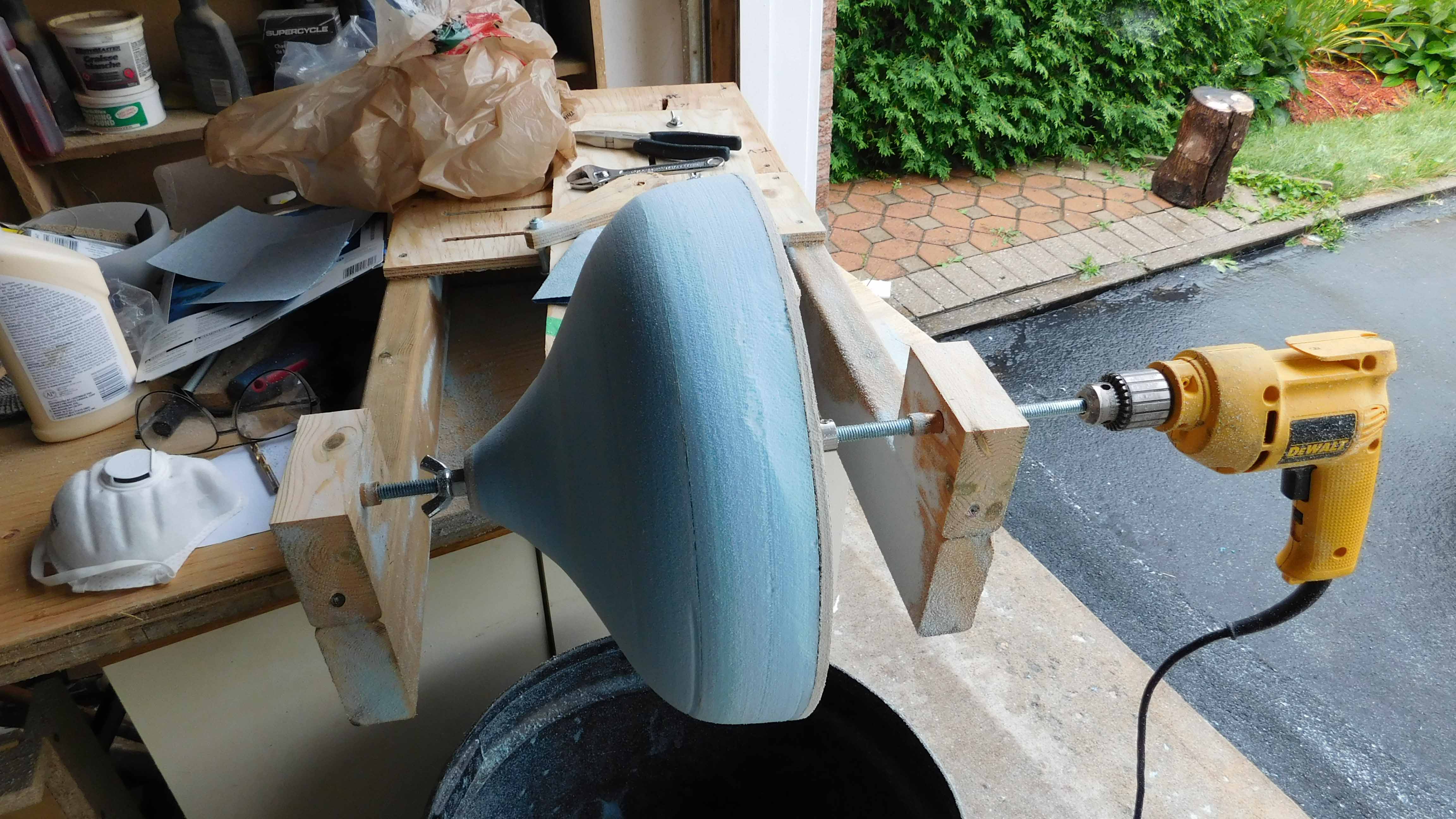

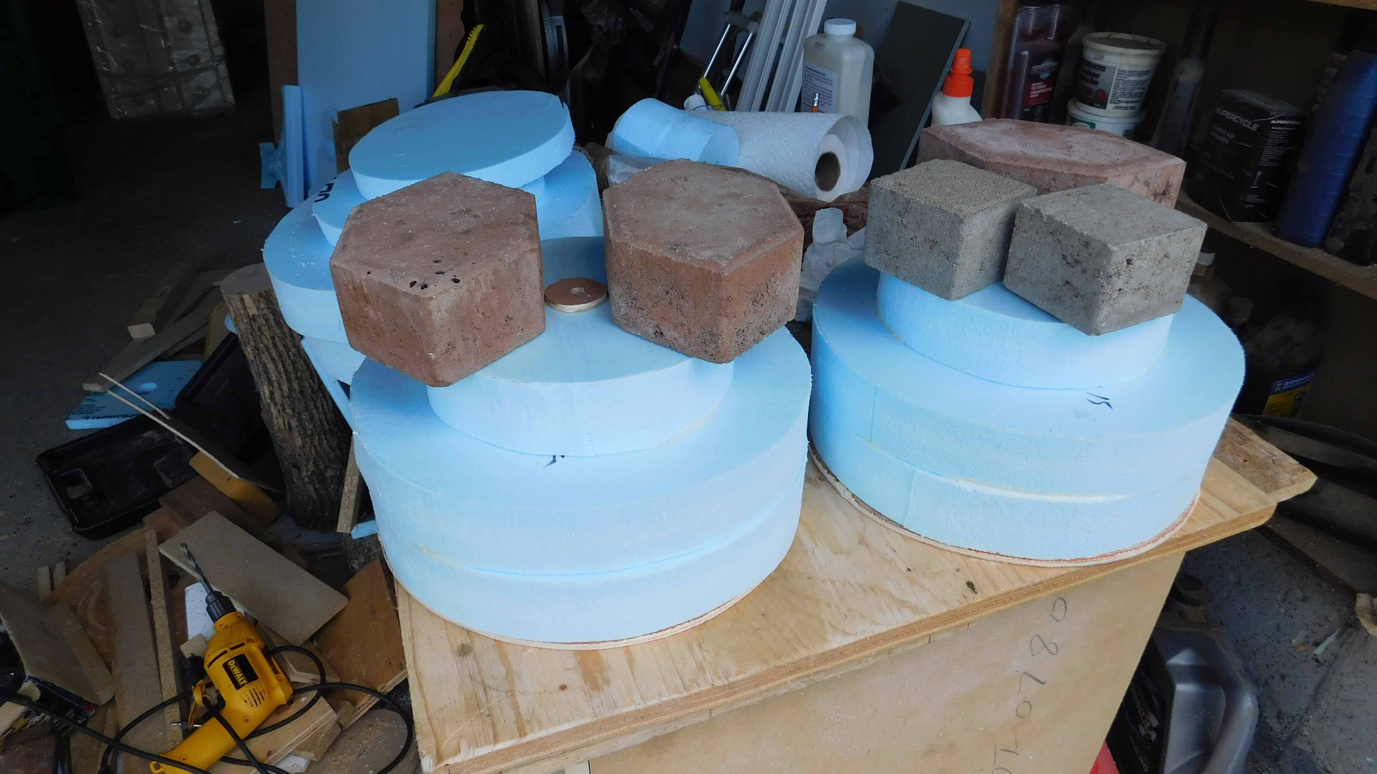

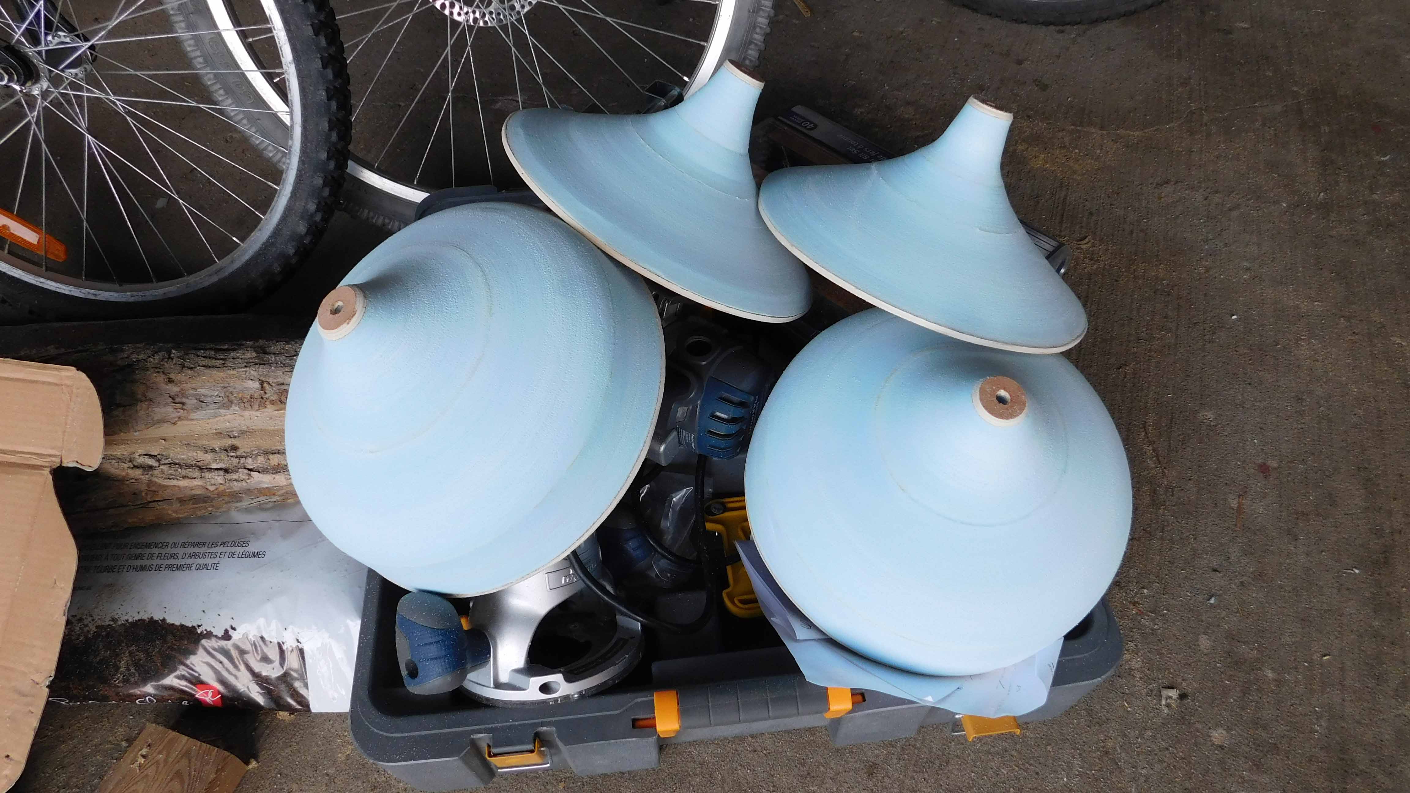

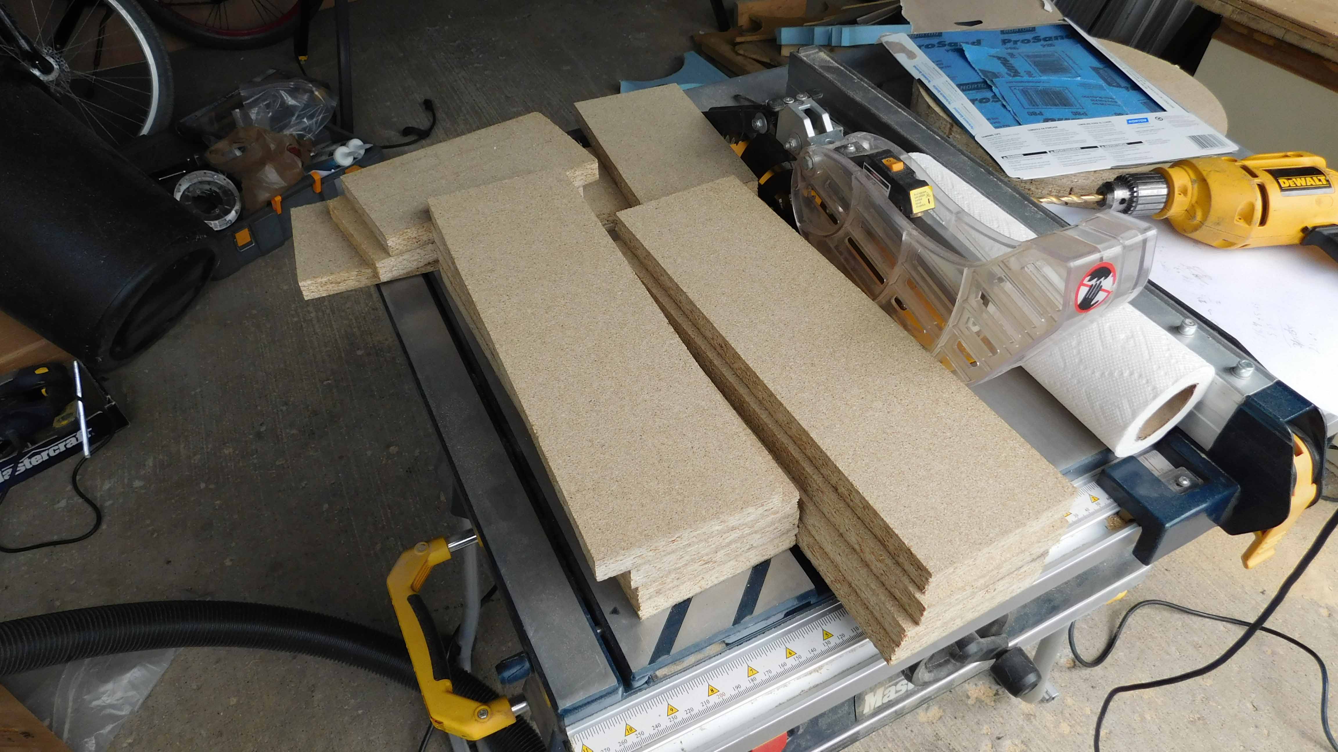

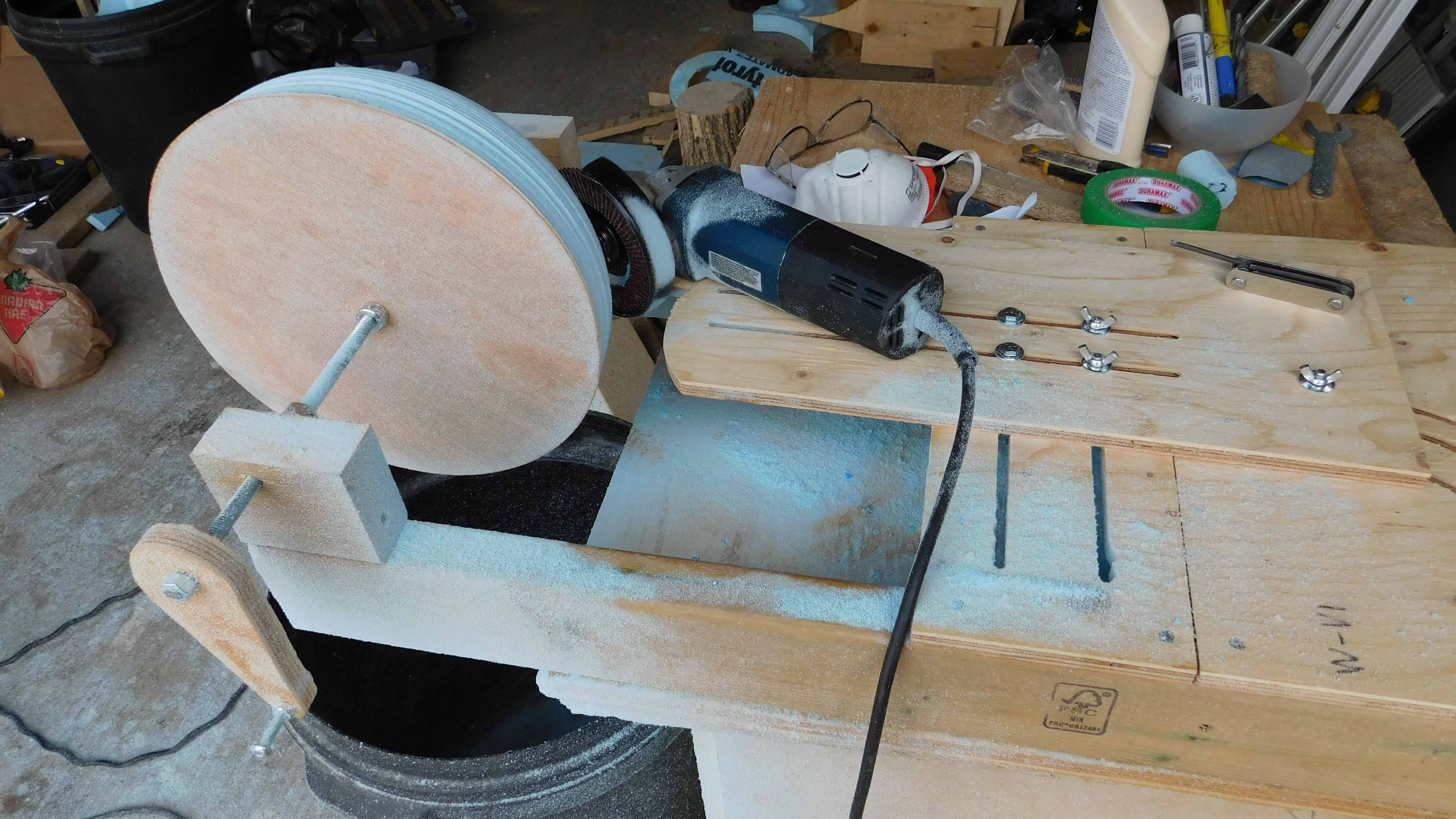

Omni V5 - construction - cones
These are some construction pics for V5. Probably the hardest construction detail is making the cone shapes. It can be done in 3D printing or fiberglass molds but there is another easier means. Generating the profile can be done in an excel spreadsheet and cut into a ply sheet as a "slot" . Its fairly easy to make a curve tracing fixture, that will allow a grinder to follow the profile slot to initially bulk machine polystyrene foam. The fixture can then be reused with a variable speed hand drill to spin the workpiece like a wood lathe to sand smooth the surface. These are common hand tools on hand, and the fixture is scrap wood with $20 of bushings, bolts and collars. The foam+sureply backing is about $6 per cone. The tips and final painting will be added later.

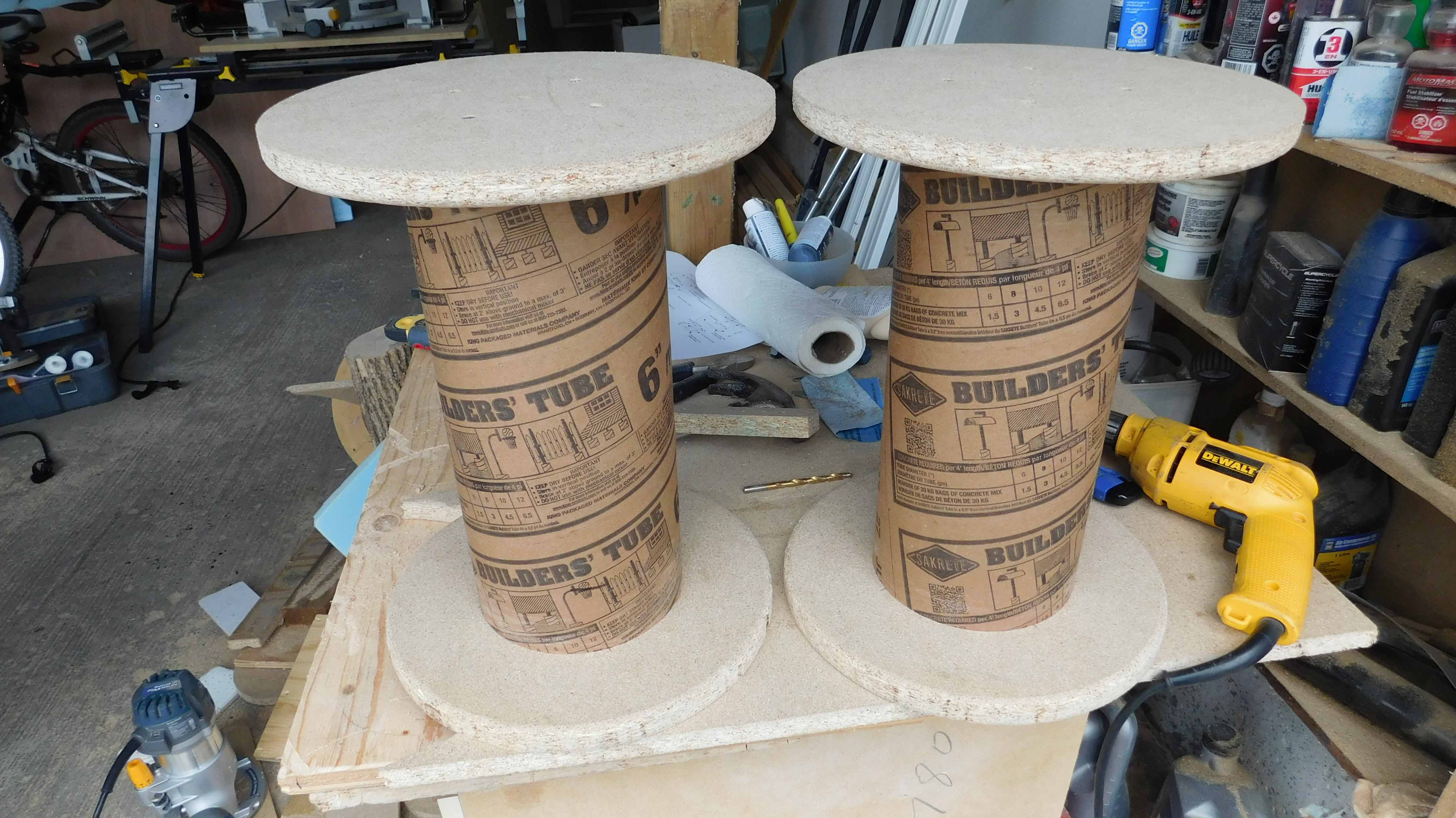

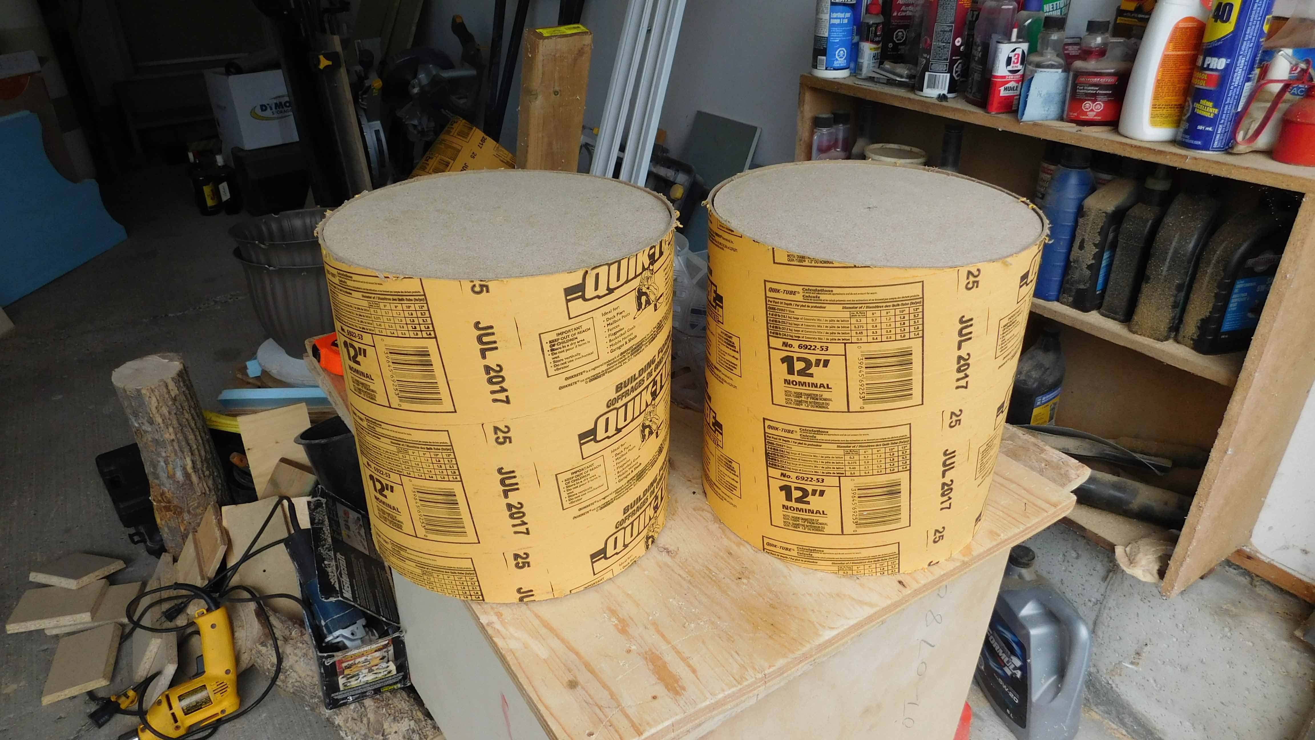

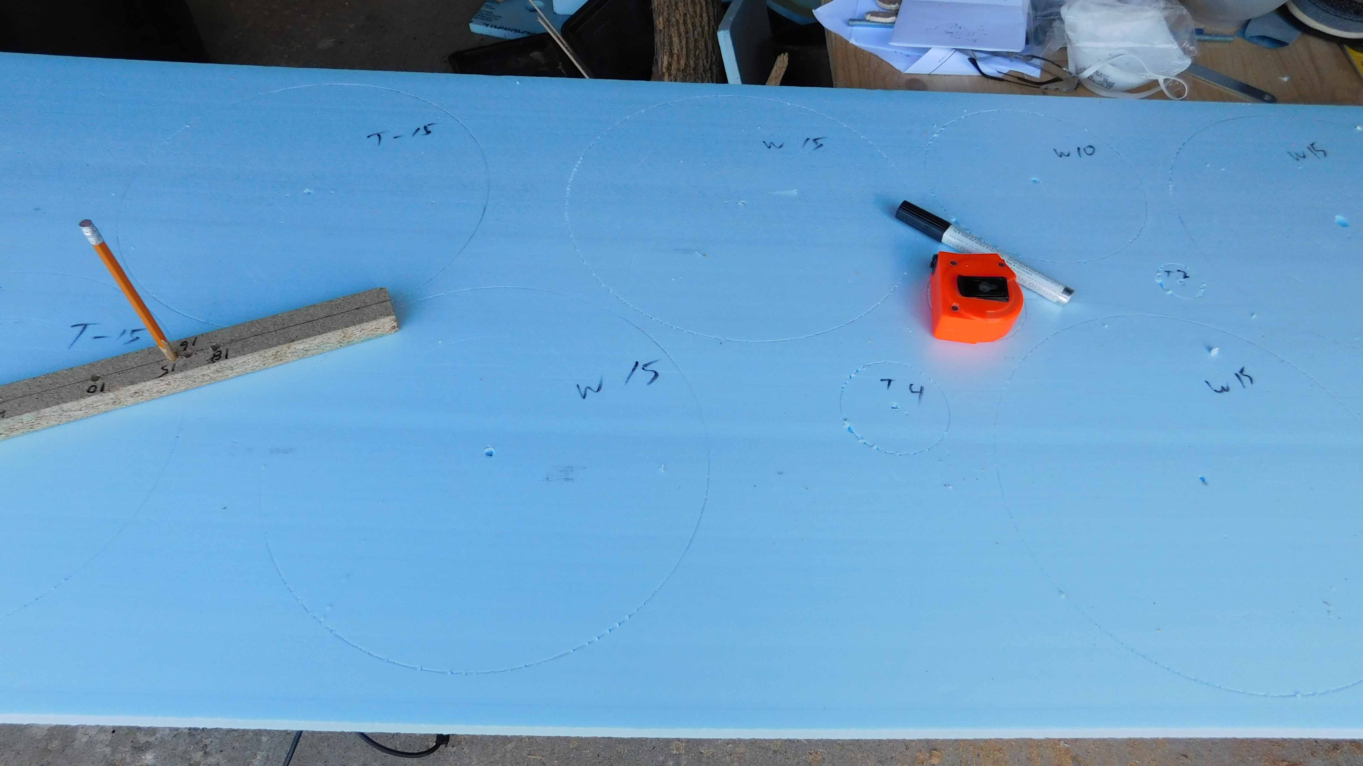

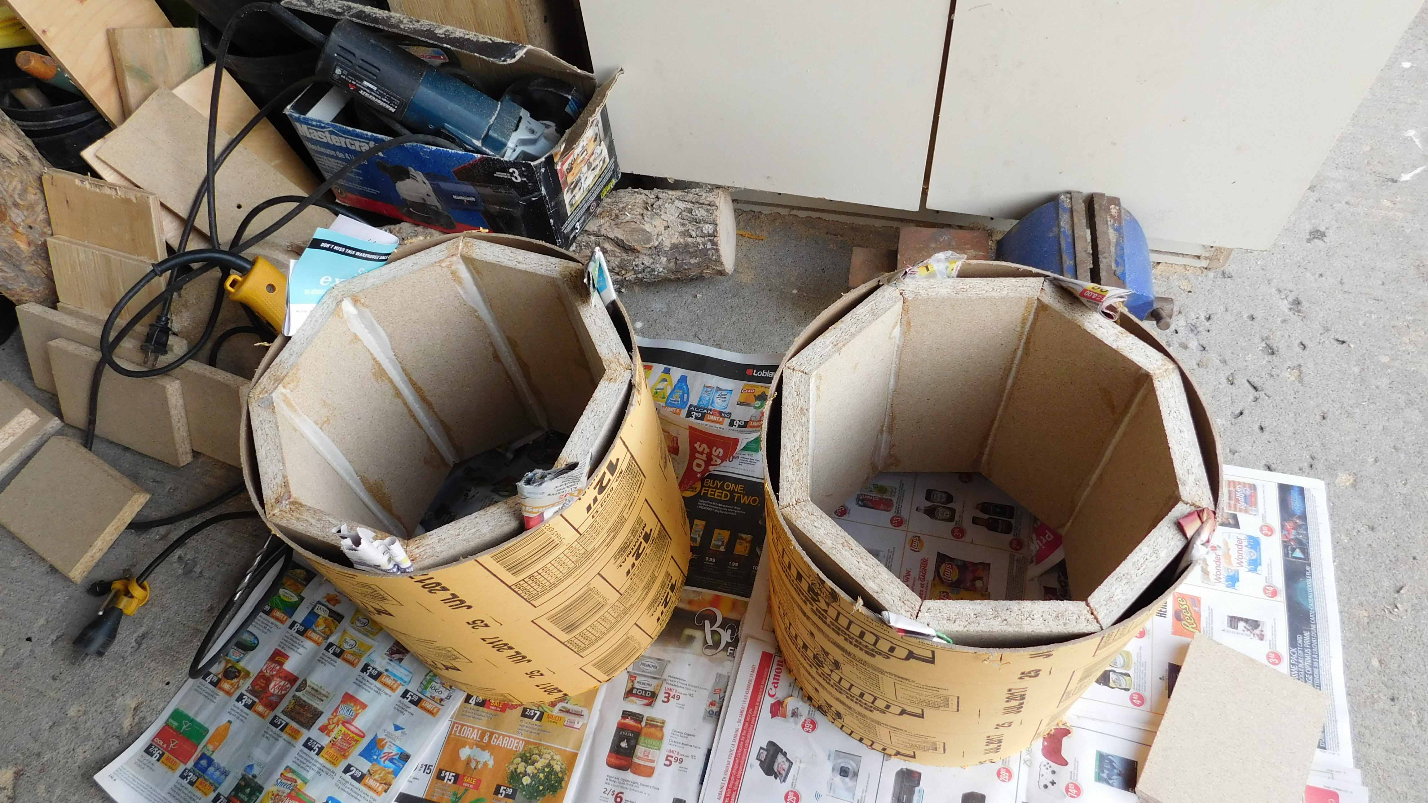

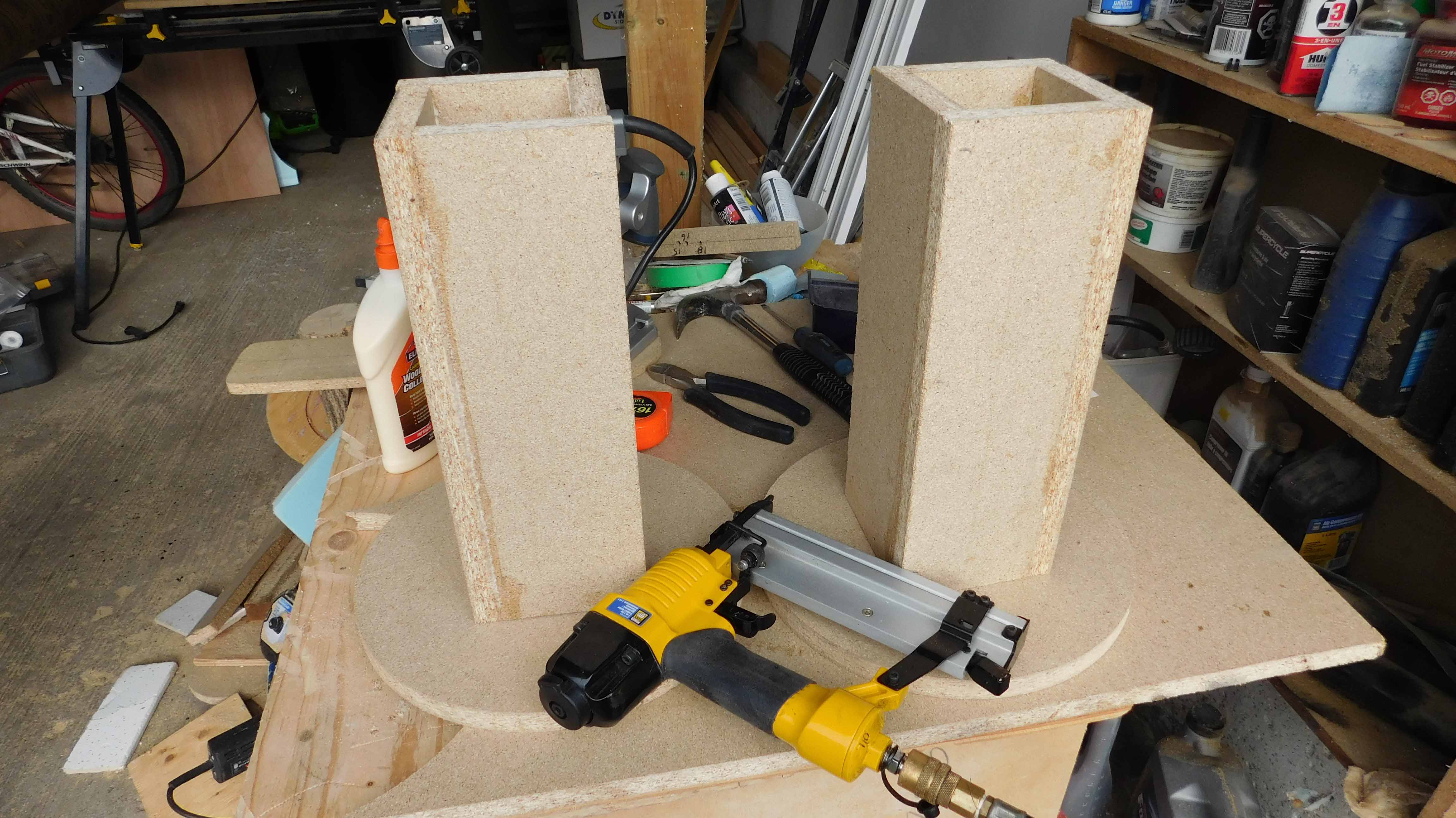

Omni V5 - construction - stands
The theme is polar symmetry. Stands are required for these speakers to decouple from the floor. The discs are cut using a router and scrap wood router circle guide. The post structure is 2mm particle board glued and stapled. The post long edges are mitered to just fit inside a 6" concrete former tube. The end disks have a 3mm deep channel to hold the tube in place, and in slight compression. The discs have 1/2" rounded edges just for aesthetics. It sounds fairly dead, but I may add sand if I suspect a problem later. I also like concrete fill but that may be too heavy. Finishing (black paint or birch veneer) will come later as will addition of carpet spikes and cork/rubber antislip pads.

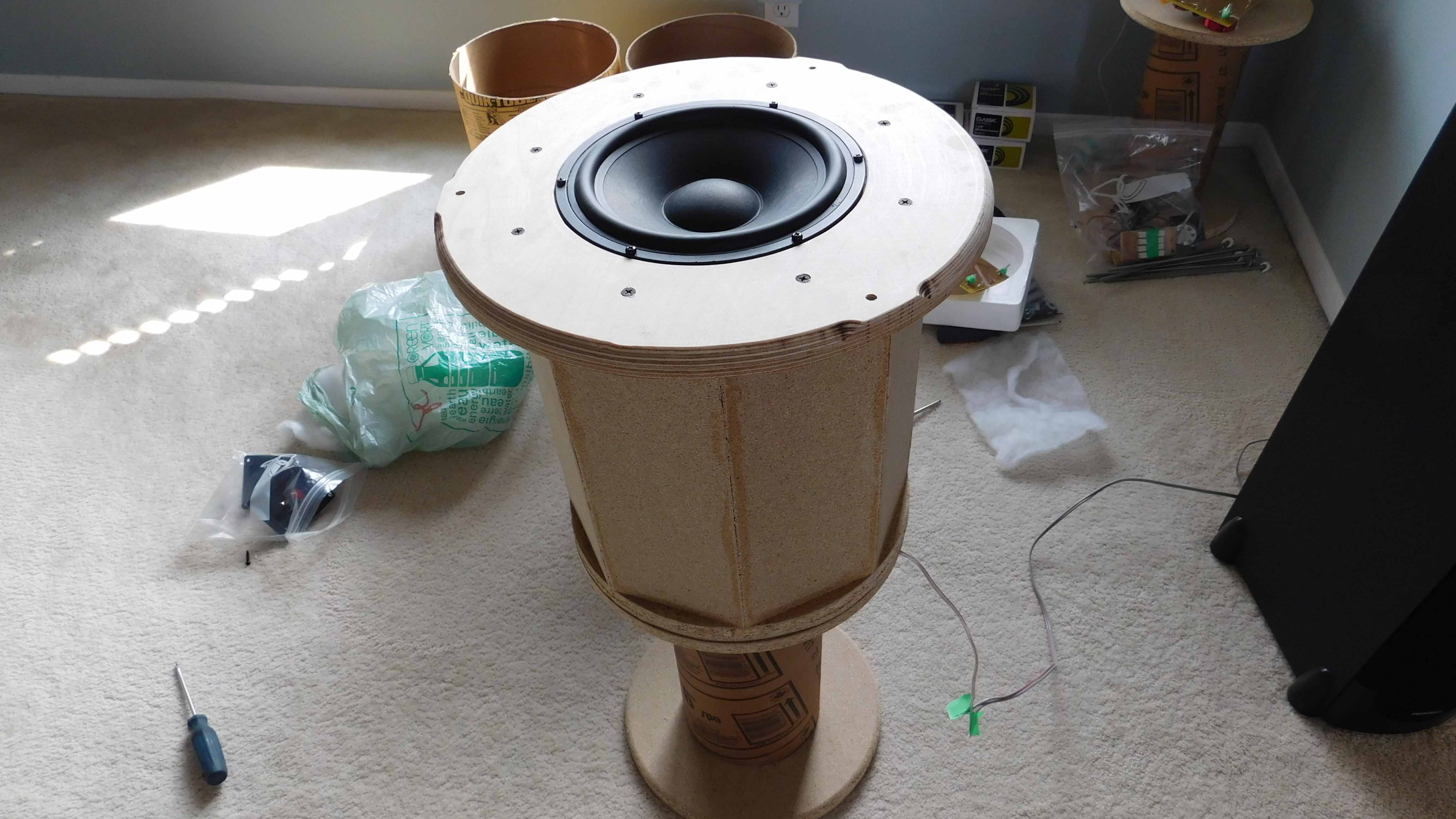

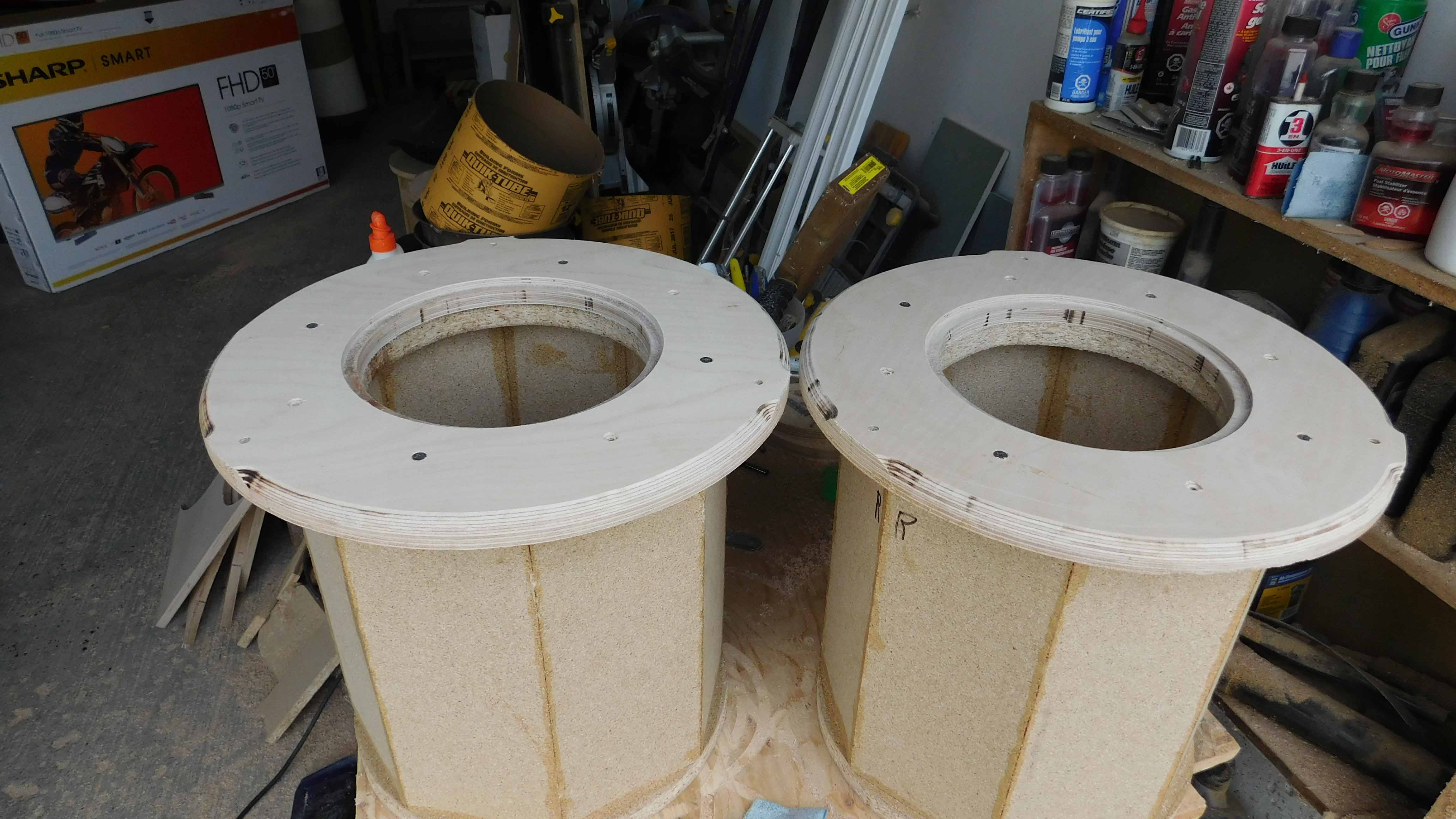

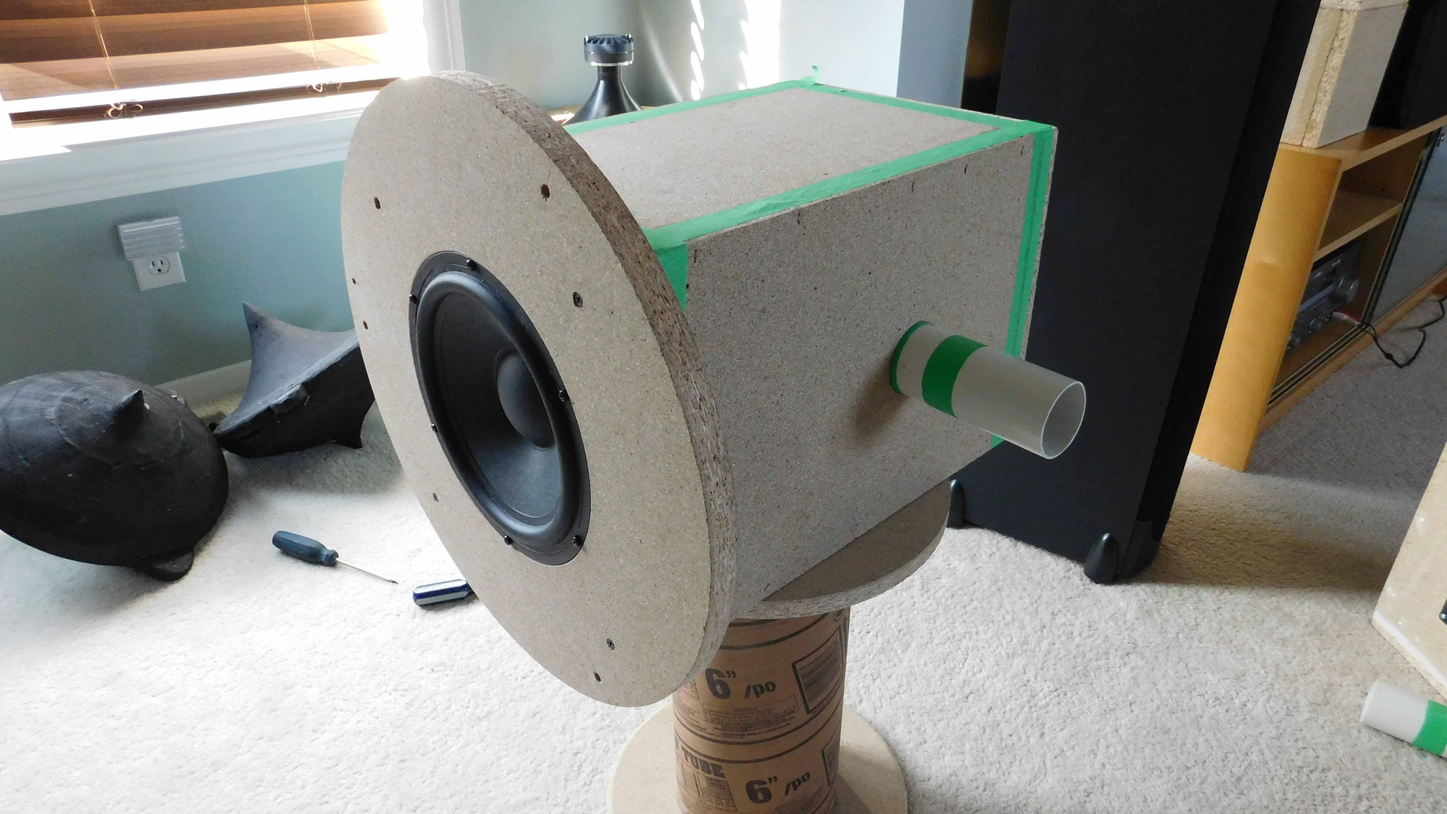

Omni V5 - construction - Woofer Chamber

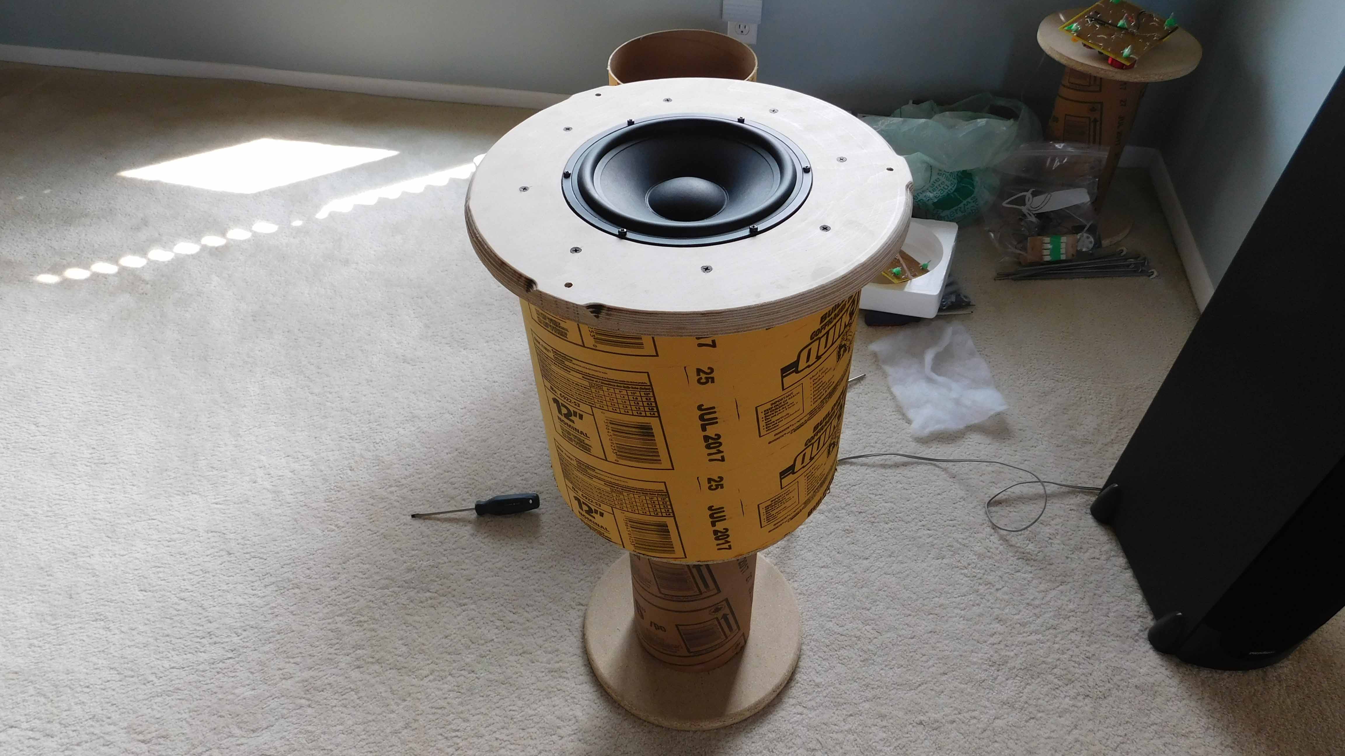

This is a 16L chamber for a BR design. I have a few experiments left to do on the older V4 box w.r.t the port design for V5. The more sides, the more cylindrical it would be, but I stopped at 8 sides. With the top and bottom on, it is very dead sounding. The short panel dimensions make it stiffer and any parallel surfaces are small. The "skin" will make it a perfect cylinder w.r.t external boundary effects. The small cylinder-octagon gaps will be filled with polyester fill forming a damping layer around a stiff core. The cylinder will be finished in birch veneer or painted black (still deciding).
This is as far as I got because I burned the brushes out of my router. New ones are in transit, and I should be back up and running in a couple of days

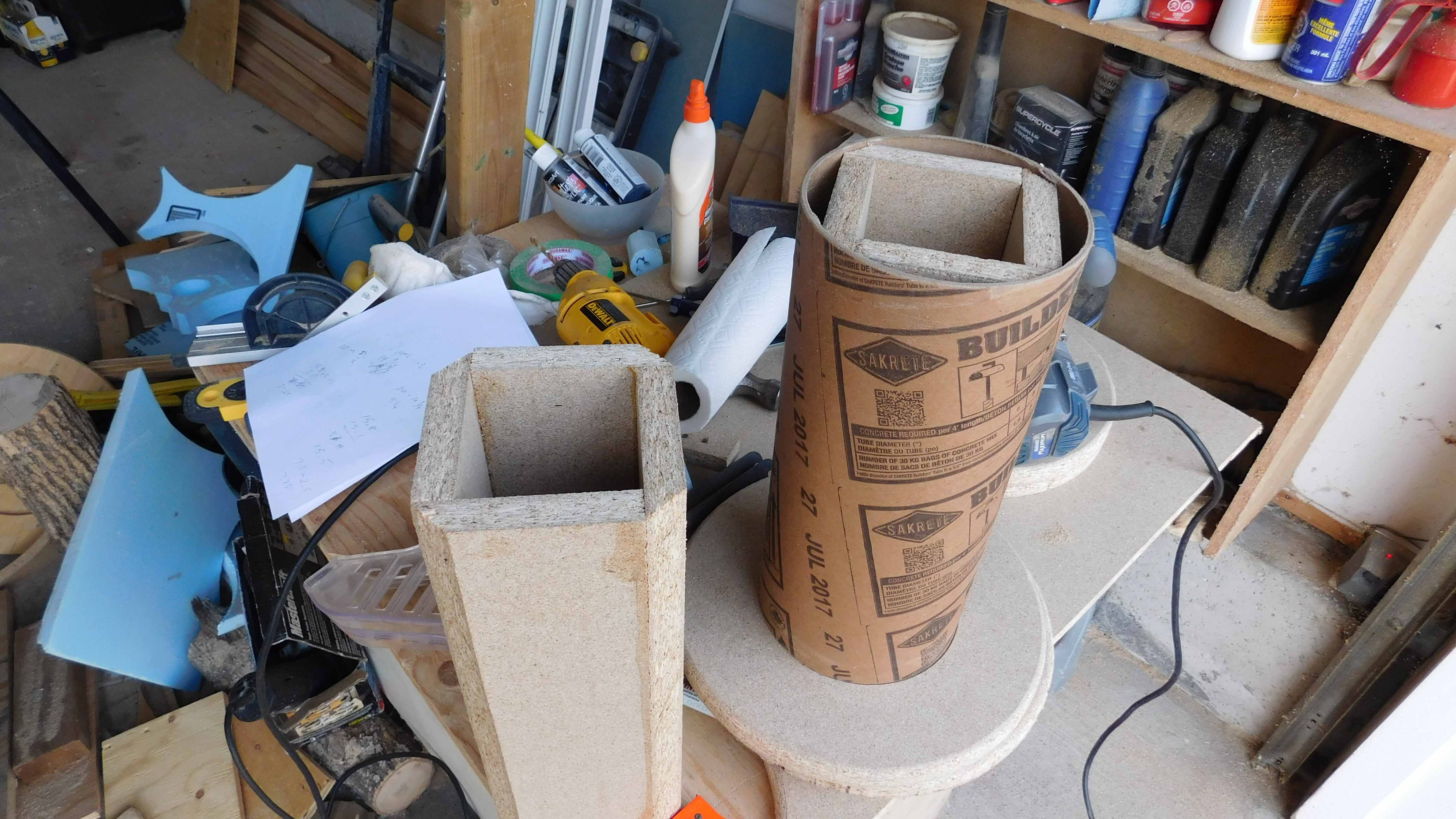

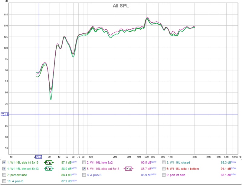

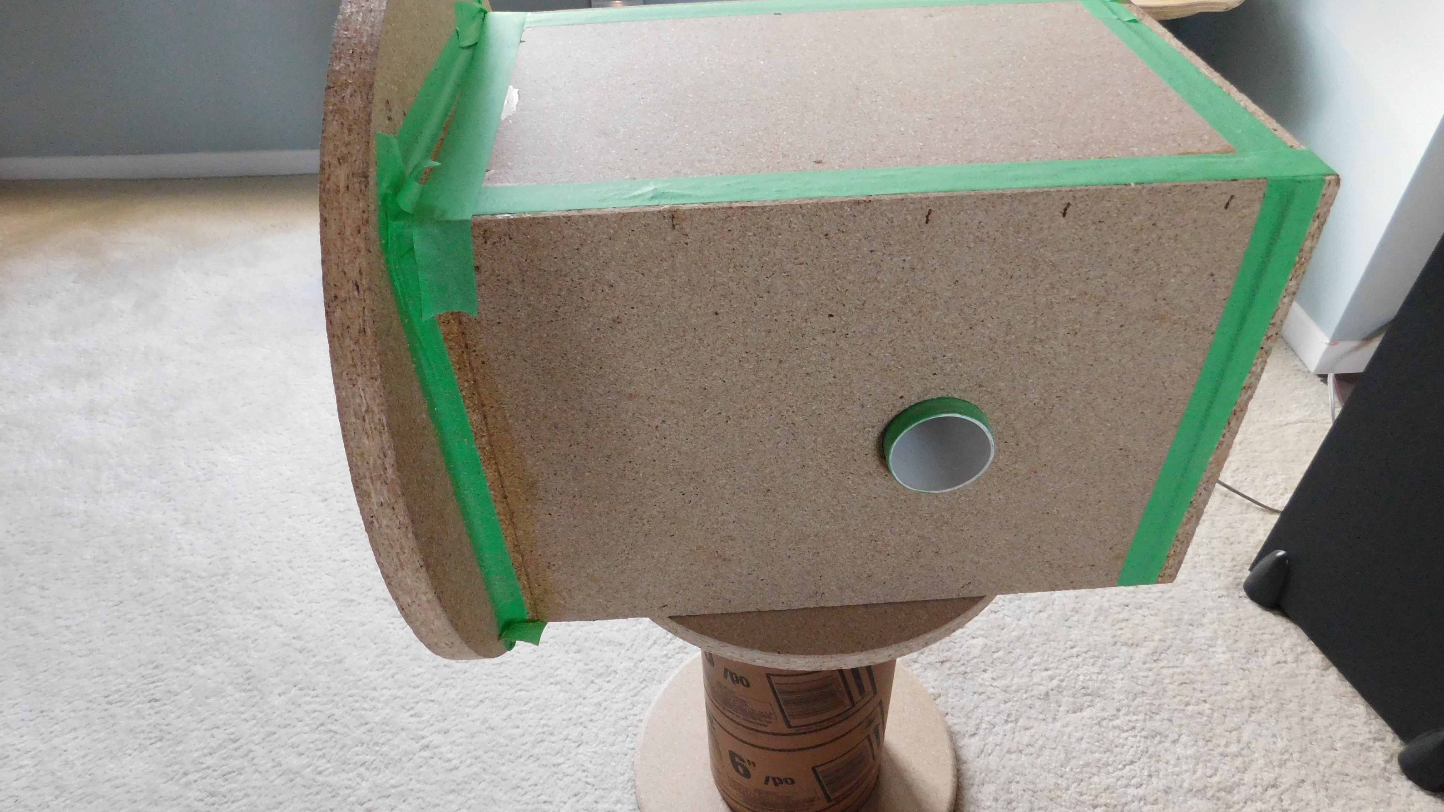

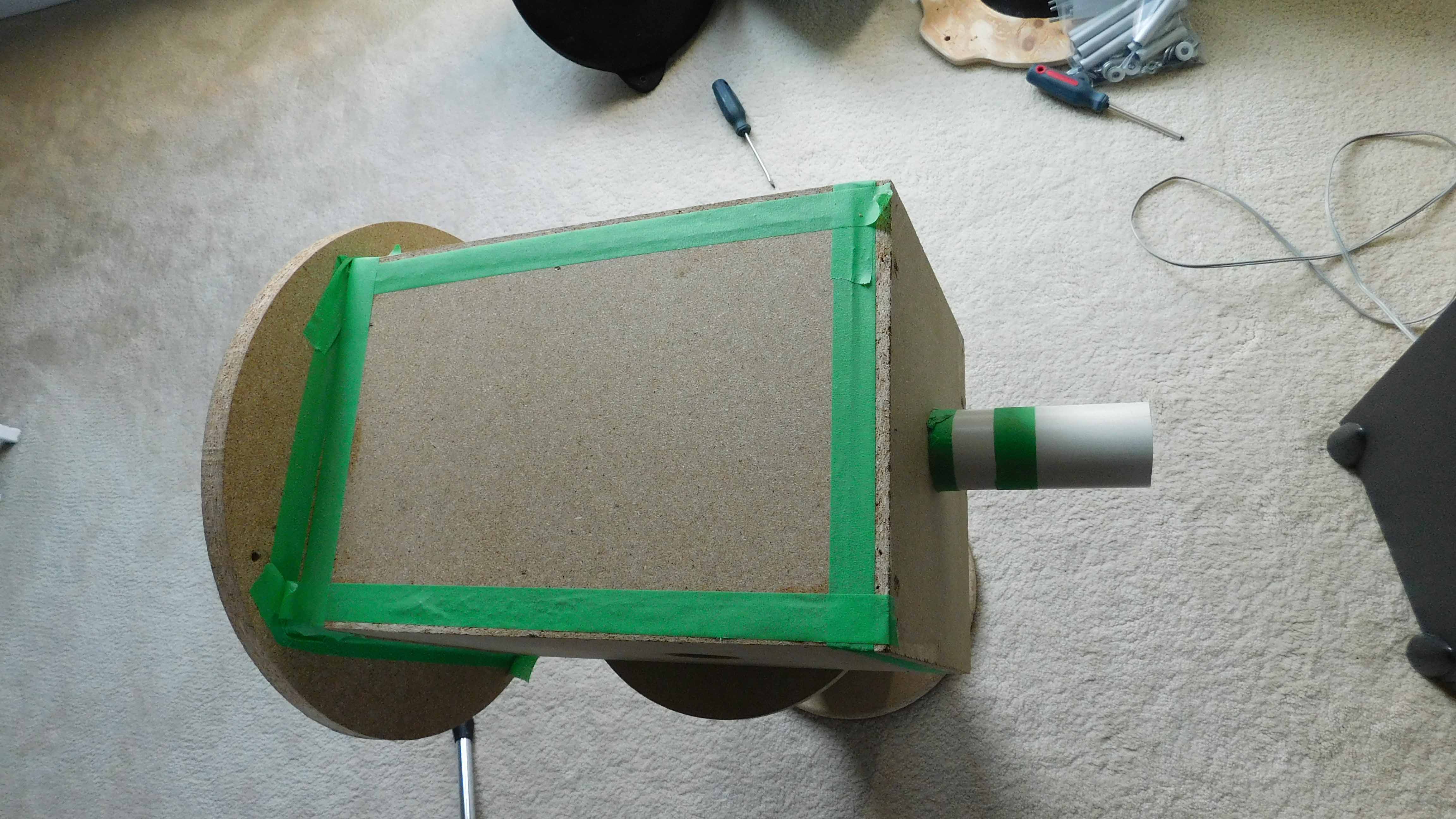

Omni V5 - construction - port position
This question always comes up, "where is the best location for the port". So I took a V4 chamber, removed the XO, removed all poly fill, and tested 20-2000Hz using REW. I tried the tuning pipe inside, pipe protruding outside, pipe on the side, and pipe on the bottom. Pipe on the bottom starts to look like MLTL and for these configurations HornResp indicates the same performance. The green tape is residue from a leak test, there are none (detectable).
I've posted pics of the port positions and tuning pipe, plus the graphs. The pipe is the same diameter (5x13cm) in all cases. It seems the port position does not matter for these tested locations. The V5 would look cleaner with a radial port on the bottom to avoid pipe holes on the chamber side. Looks like that will work.
I am planning to use a sub XO @ 80Hz so technically there is no reason. However with a bottom port I can try both ported and sealed using a 16L chamber. It's easy to cover /cap the internal bottom hole and see what sound I prefer. I did test the V4 closed and it has lower distortion than ported and it rolls off earlier as expected.

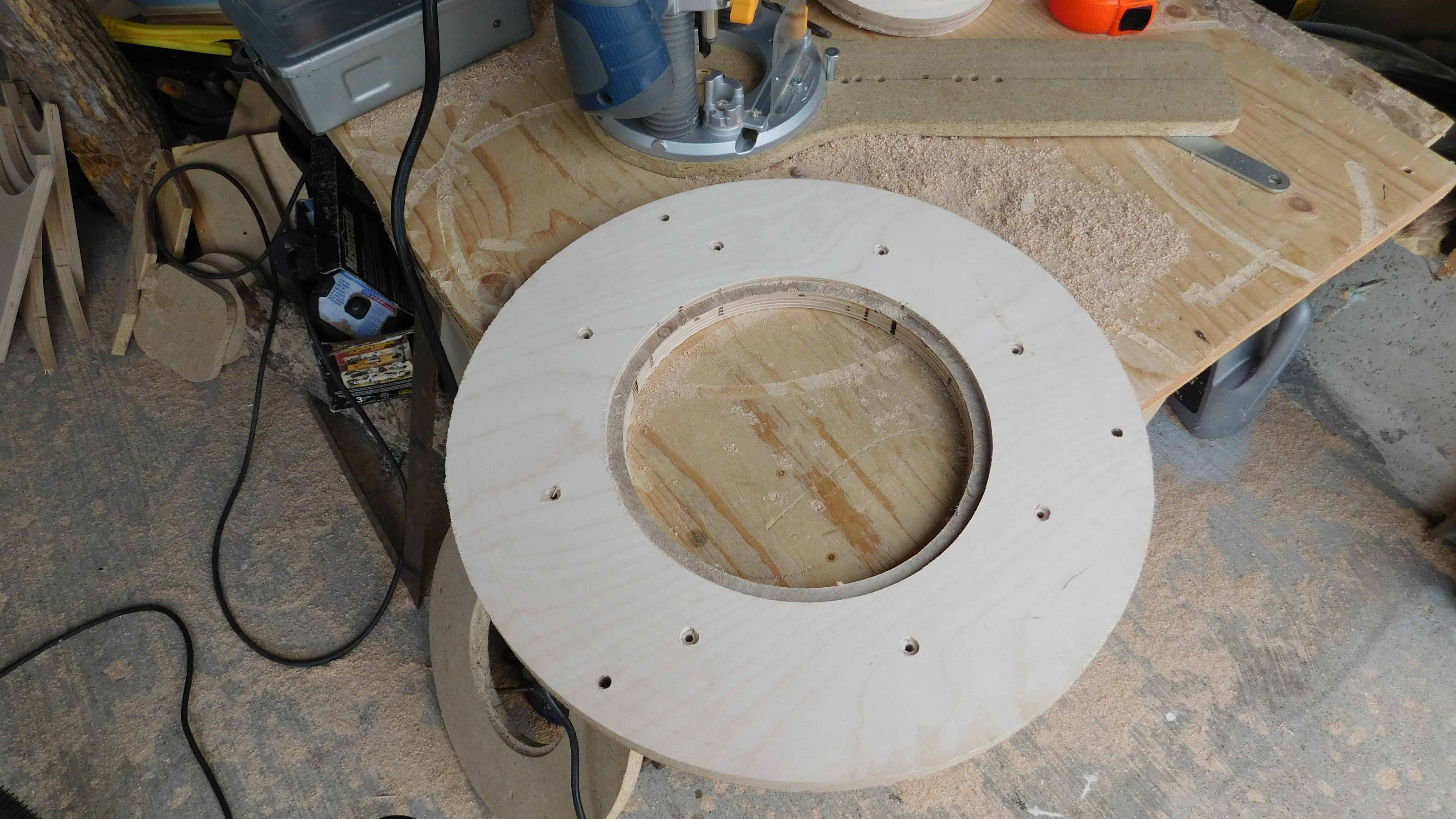

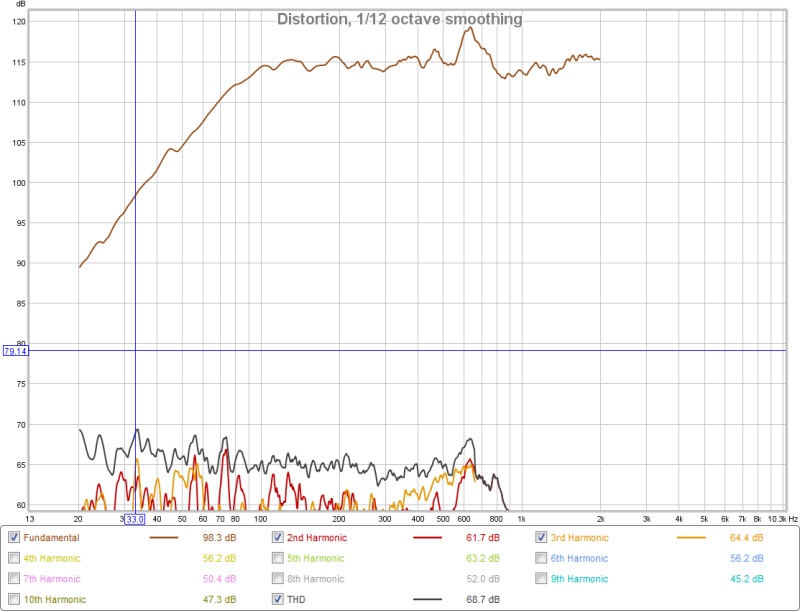

OmniV5 - Construction - Woofer Baffle + Test
Next is the woofer baffle plate. Its smaller than the V4 (36cm vs 40cm) and is designed as two parts to increase edge radius. Only the upper portion is in the pics. There are multiple angles and holes to be drilled so another template is created from sureply to make it easier to transfer the exact locations to each workpiece. The assembled structure is very dead sounding when its tapped.
The woofer chamber was tested with 1/2 loose poly filled chamber, no XO, as a sealed 16L chamber. The roll off starts at 100Hz as expected and drops in a predictable manner (2nd order, 12db / octave). It has none of the boominess that the BR or ABC designs had. I think I'll keep it like this to see how it behaves as a system. I can easily had a bottom port before finishing if I change my mind.
The +3db peak at 630Hz is due to the distance behind the woofer (27cm) which at 1/2 lambda away puts it at (344 / (0.27 *2))=637Hz. Measurements are nearfield at 10cm.
That response looks very nice to work with your sub. If you can get some fibreglass to use as stuffing try it out, poly is hopeless for damping resonances etc. Check the impedance response with REW and a resistor jig you will be able to see where all the cabinet based bumps are and which stuffing lowers them.
Looks like V5 won't be too far from finished soon 🙂
I agree, the response is well behaved, and would work nicely with my sub. I don't need these sections while I'm working on the upper half of the speaker. I'll play around with the combined responses to see how smooth the sub transition is.
Given that the internal reflection is specific at 630Hz, it might be better to EQ in passives or s/w. I'm not sure I can get filling to be that specific. I've never used the REW impedance measurement, I'll look into it.
Probably need another week for the upper sections and I'll have a functioning V5 ,without the paint or veneer. I prefer to build and verify before spending any effort on the cosmetics.
As the peak corresponds with the size of pipe it's sounds like a pipe resonance. You can EQ it but if you can stop it at the source that has to be better.
Try some fibreglass it is very good at damping the rear wave and cabinet resonances and you will need much less of it to have a positive effect. Poly stuffing is good for increasing the apparent volume of the enclosure but it does almost nothing for resonances unless you really pack it in. Felt works very well too.

- OmniDirectional - work in progress
