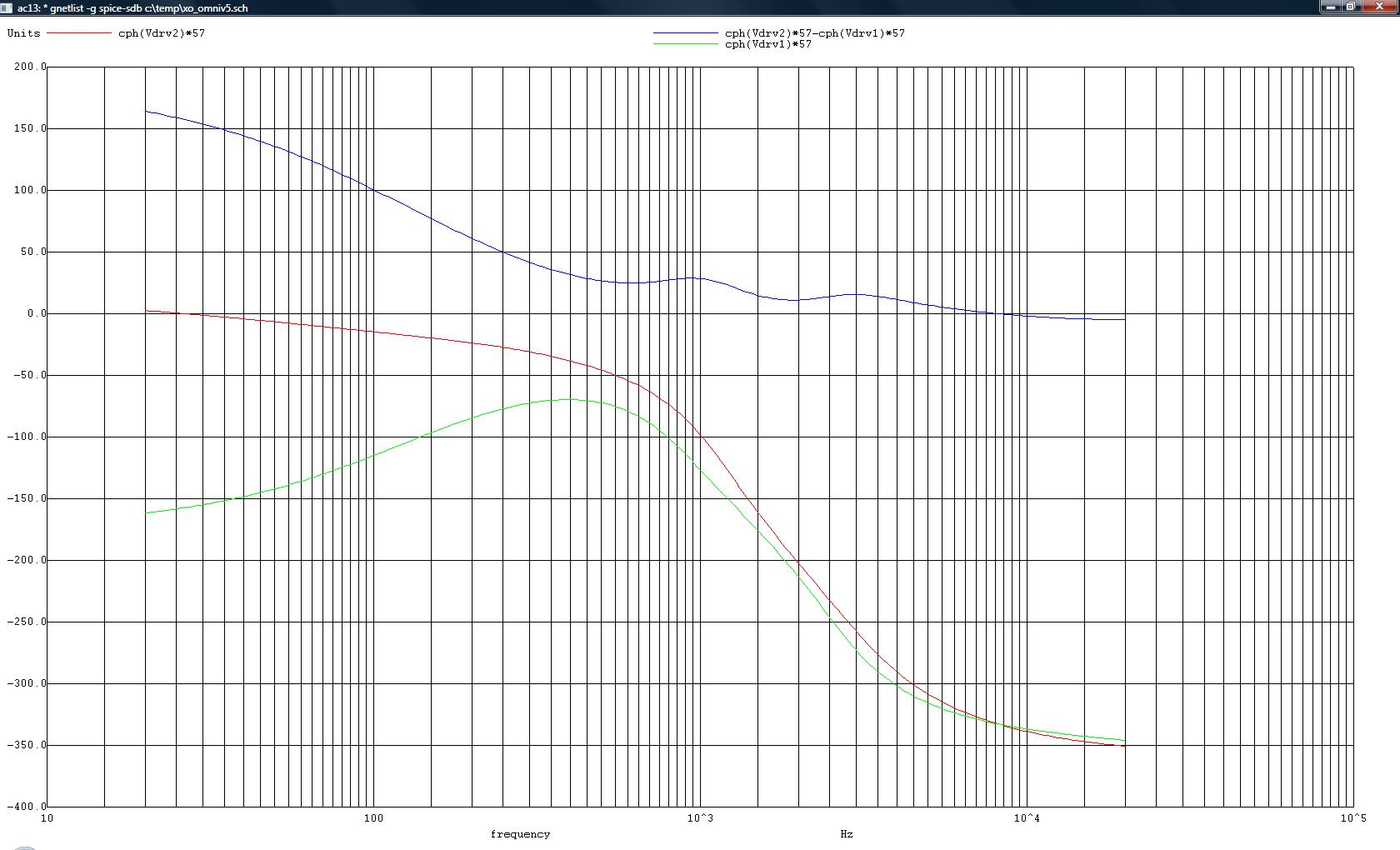

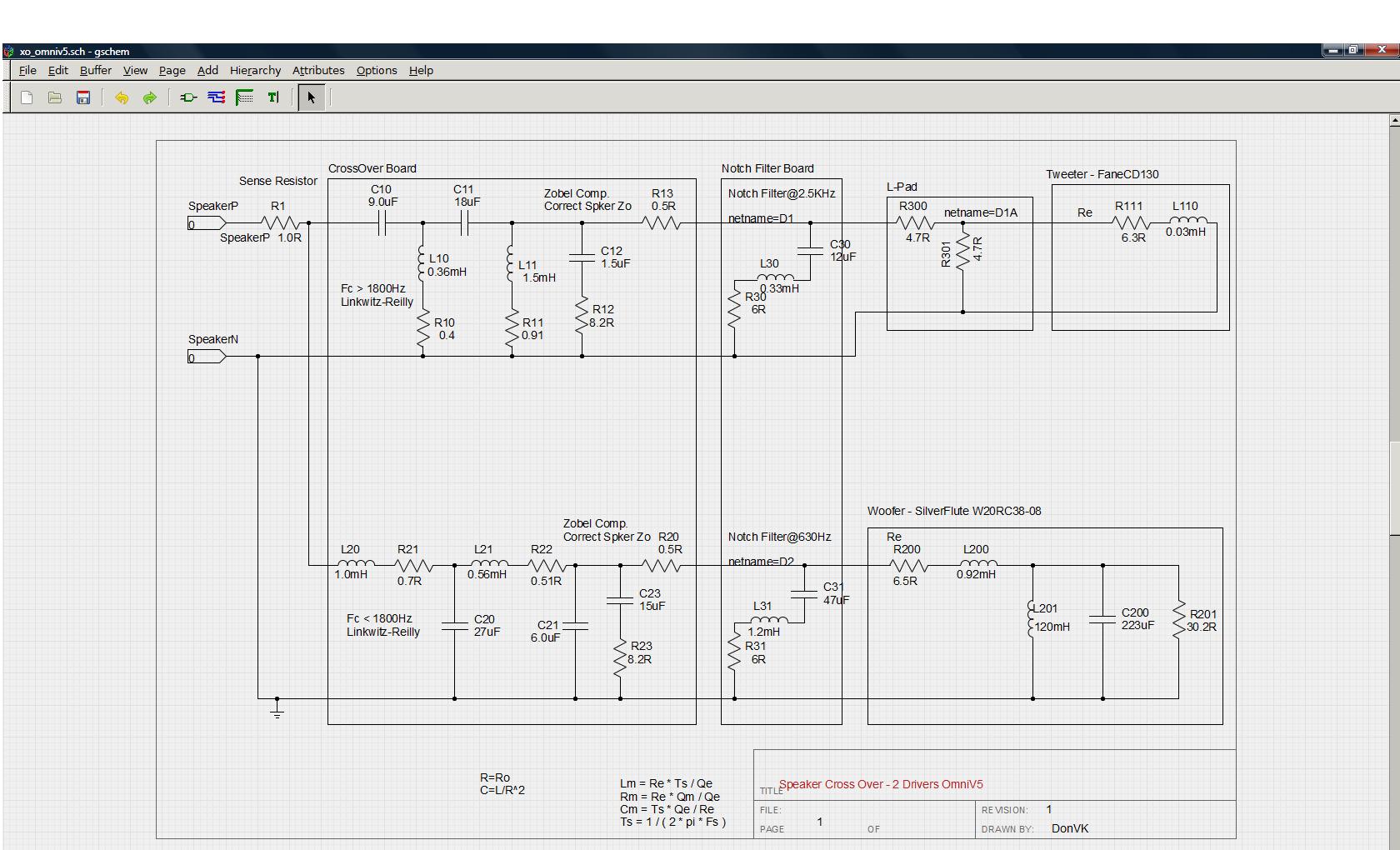

The pics below are from Gschem and NGspice that I use for schematic capture and simulation. The design is a 2 way LR4 @1800 Z=6 with zobels and notch filters. The HF L-pad is just shown as 2 resistors. Note the ngspice plot uses 20 lines/decade (not 10 lines/dec) when the plot gets big so its [1K, 1.5K, 2K, 2.5K....etc] for the freq verticals.
The LR4 electrical performance has a few bumps (freq, phase, time) from the notch filters but the are required to cancel some acoustic issues. The overall behaviour is the same with or without them. The notches flatten the response enough to be used as is with an amp or with mild midband (3-7KHz) correction. It allows me to easily use them with my RPI3 project.
Schematic is pic #1, nothing tricky there.

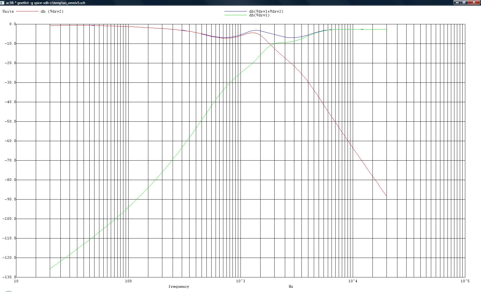

Graph#2 is a bode plot, shows the XO@1.8KHz, and a few bumps from the notches. Again looks like it should.
The phase in Graph#3 is worth looking at. A 4th order low pass has +360deg shift and a 4th order high pass has -360deg shift. Every time we shift m*360deg we come back to 0, going 1 rotation around the unit circle. This puts the woofer and tweeter in phase again. However, they are 2 cycles apart in time, but still in phase in frequency. That time shift (2 cycles) is hard to see in the phase curves because its generally removed. The graph#3 shows the two signals tracking in phase as they should be. This is an LR4 feature.

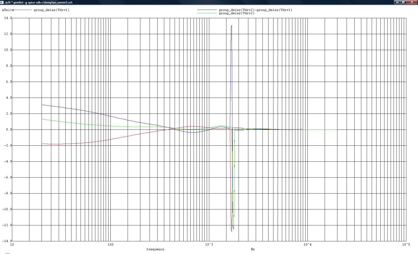

Group delay in Graph#4 show the the difference is time delay which converges over frequency and becomes an expected constant. But notice the delays start in different polarities that converged to zero difference. This is an LR4 feature.

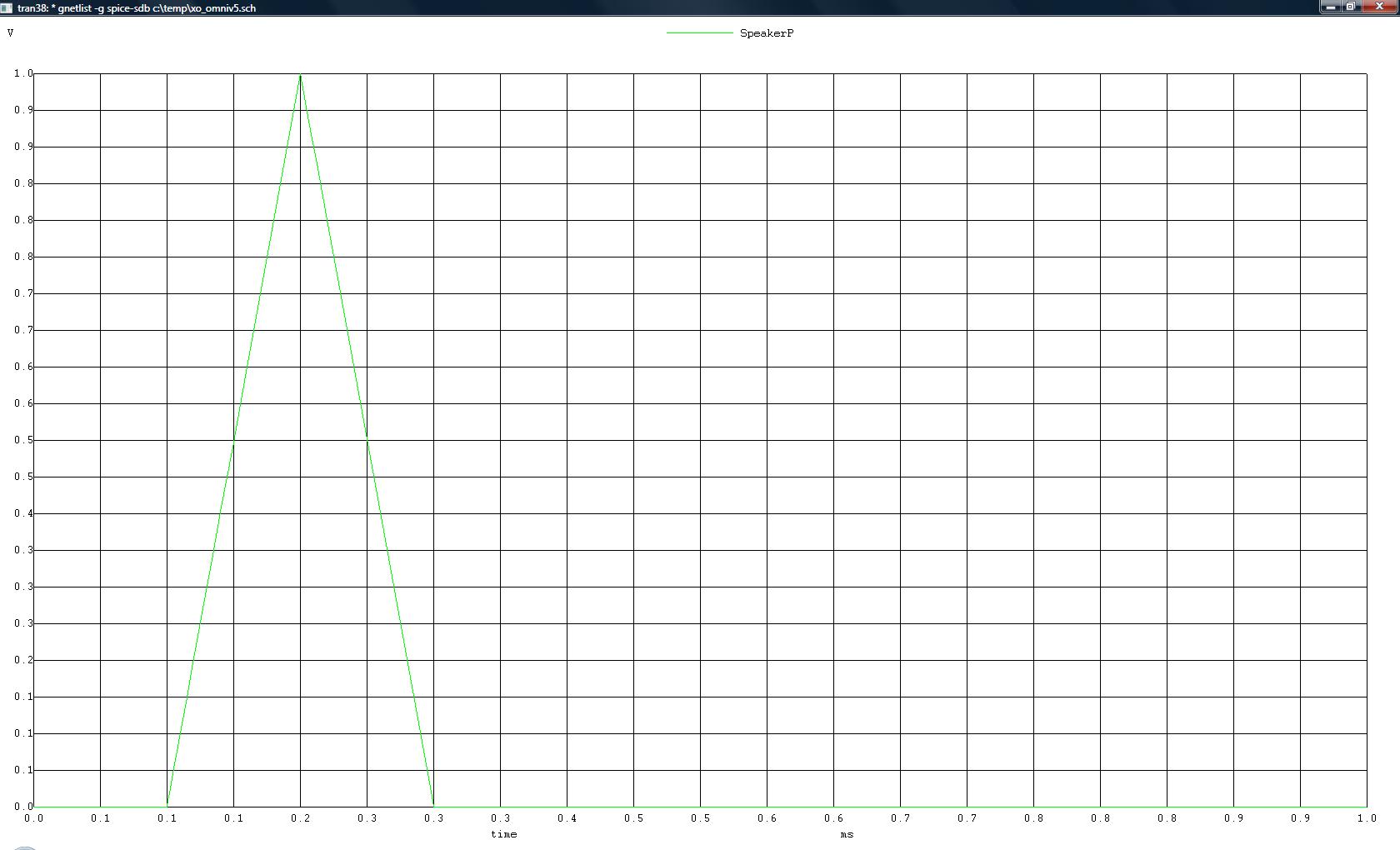

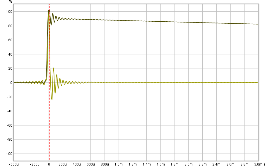

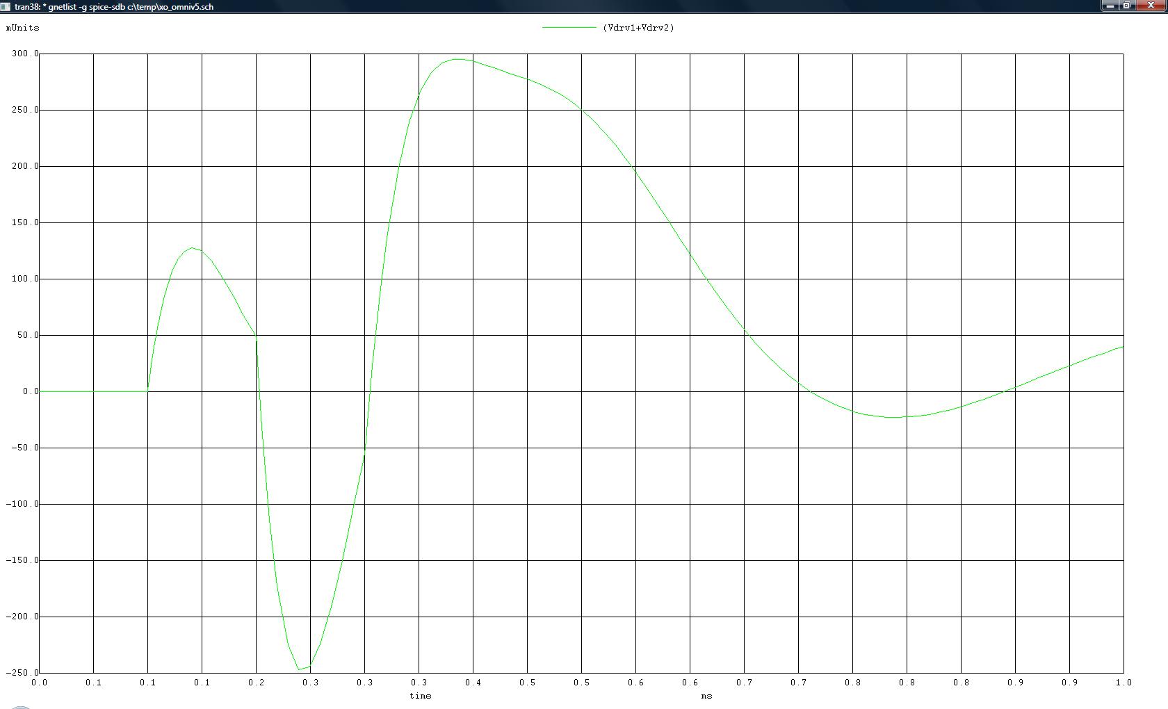

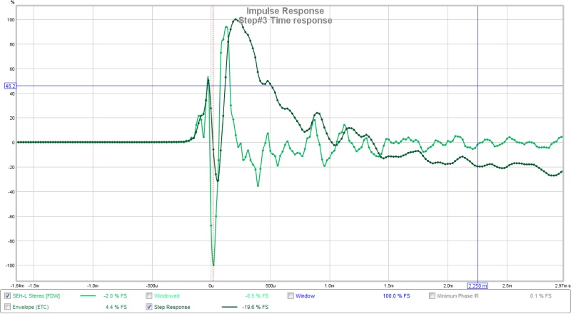

The impulse response is where the weirdness was seen and what started this investigation. Its also seem in the simulation. I've also seen it other 3rd party measurements. So it should be expected.

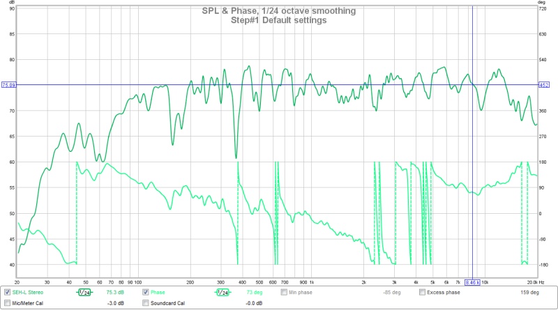

Step#1, take a near field measurement using the defaults settings. Graph#1 shows the results. Lots of phase wrap, and first clue that some settings need fixing. The speaker should be min phase, and all the wraps indicate something else is going on.

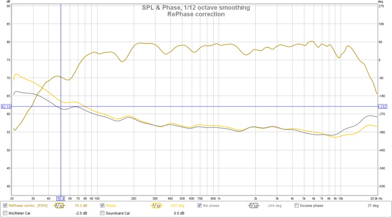

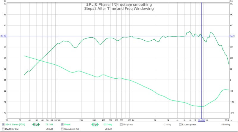

Step#2, remove the room acoustic effects. Using the [IR Window] set the LeftWindow=10ms, RightWindow=20ms, FrequencyWindow=4 and apply. Then using the [Controls] select [Unwrap Phase] button and then use [+/-360] buttons to shift the phase curve to where you would like it. Graph#2 shows the result that is close to what we want. We should see a 0 to-360deg phase curve from our Spice sim, but instead we see +180deg to -180deg curve. There is still a total 360 phase shift but its offset, and that's OK. I think its because the acoustic timing reference has centered "0deg" around its alignment tone.

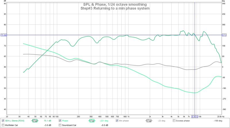

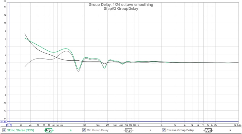

Step#3, generate min phase curve using [Controls] then [Est IR Delay] followed by [Gen Min Phase]. Enable the min phase curve display and possibly use [+/-360] to shift the measured phase and min phase curves together. A speaker should be a min phase system. We can see from Graph#3 curve comparison, that there is some excess phase. Can that be heard and is it making our time response (Grpah#4) weird.? The excess phase is small (time wise) and does not show in the GroupDelay Graph#5 .

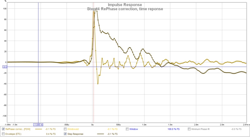

Step#4, I removed some of the excess phase but did not try to make the whole phase curve zero. The amplitude response was flattened using EQ APO 31 band eq. I exported the above measurement from REW as text. Then imported the measurement into RePhase and adjusted only the phase a little. I added phase correction of +90deg over the 2KHz-10KHz band only. The RePhase correction IR was added to the EQ APO convolution engine. The results are in graphs #6 and #7. Looks more like an ideal IR and SR. The REW min phase curve recalculated shows no excess phase now.
I still don't know where the phase difference is coming from but there is no more excess phase and the IR and SR look more normal. Adding +90deg in a limited freq band can be done with analog filters as well.

.....A speaker should be a min phase system. We can see from Graph#3 curve comparison, that there is some excess phase. Can that be heard and is it making our time response (Grpah#4) weird.?.....
.....I still don't know where the phase difference is coming from but there is no more excess phase and the IR and SR look more normal.....

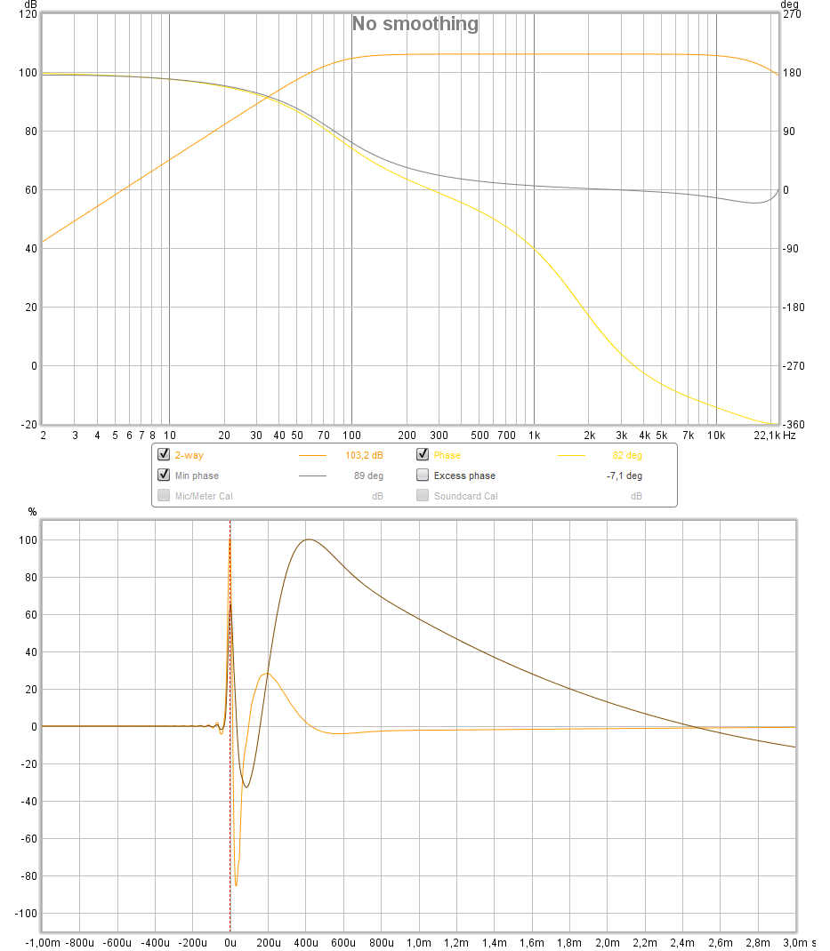

Good piece of work there and think things starts to look close to acceptable, no worry a speaker should track as system minimum phase when its having a physical minimum phase XO point in there because that will add 360º excess phase because REW calculate minimum phase upon amplitude response and don't know anything about its a sum of two pass bands, when single drivers pass band is swept then absolute measured phase should look close to "Generate minimum phase" or if XO filter is linear phase as you tried fix into Rephase 🙂.

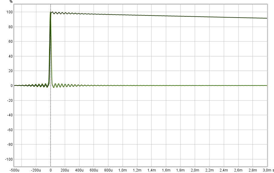

Below is some synthetic examples showing absolute phase for pass band and REW's calculated minimum phase:
First is one full ranger doing the job, good point look for there is phase lags about 90º at 80Hz as it should and absolute phase and REW's calculated minimum phase tracks close.
Second is same pass band but with LR 4th order 1800Hz XO point, good point look for there is phase is advanced about -180º at 1800Hz as it should and REW calculate 360º of excess phase for this example compared amplitude response.
Third is same as second using "Estimate IR Delay" inside a 22.050Hz domain which looks push phase bend upwards just as yours did 🙂.
Thanks for posting the comparison graphs. It's satisfying to see other results in line with what I'm seeing in my measurements.
I'm assuming you used a RePhase template to generate your curves. Is that correct?
Could you explain "inside a 22.05Hz domain" ? I'm not familiar with that.
He means mimicking the bandpass behaviour of your ADC / DAC's reconstruction filter.
By limiting the upper band using a similar filter that a DAC would use to avoid aliasing.
22.05K for a 44.1K sample rate playback / measurement.
Byrtt does it in rephase by creating the filter and outputting to an impulse to import into REW, I'm sure hell be along with his recipe, from memory something like a 14th order filter at 22.05K.

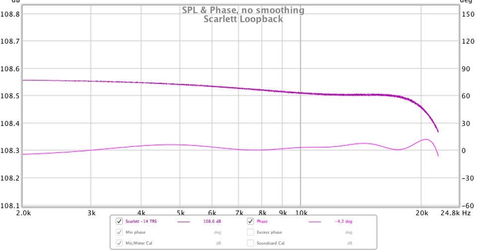

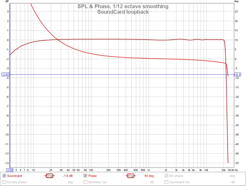

My soundcard on loopback looks pretty good when I zoom in. It clearly has some sort of ac coupling. The phase at high freq is minimal.
A small fixture for isolation / attenuation / level clamping is easy and inexpensive for me to make. That way it won't matter what kind of amp I attach or how they connected the power supplies or output stages. Inherently safe.

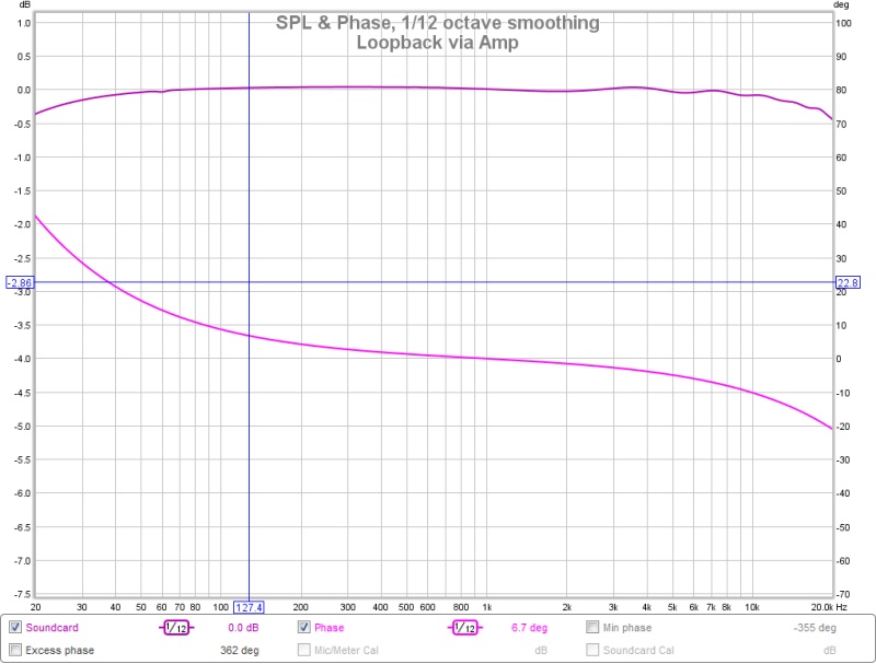

Soundcard loop back from RXV659

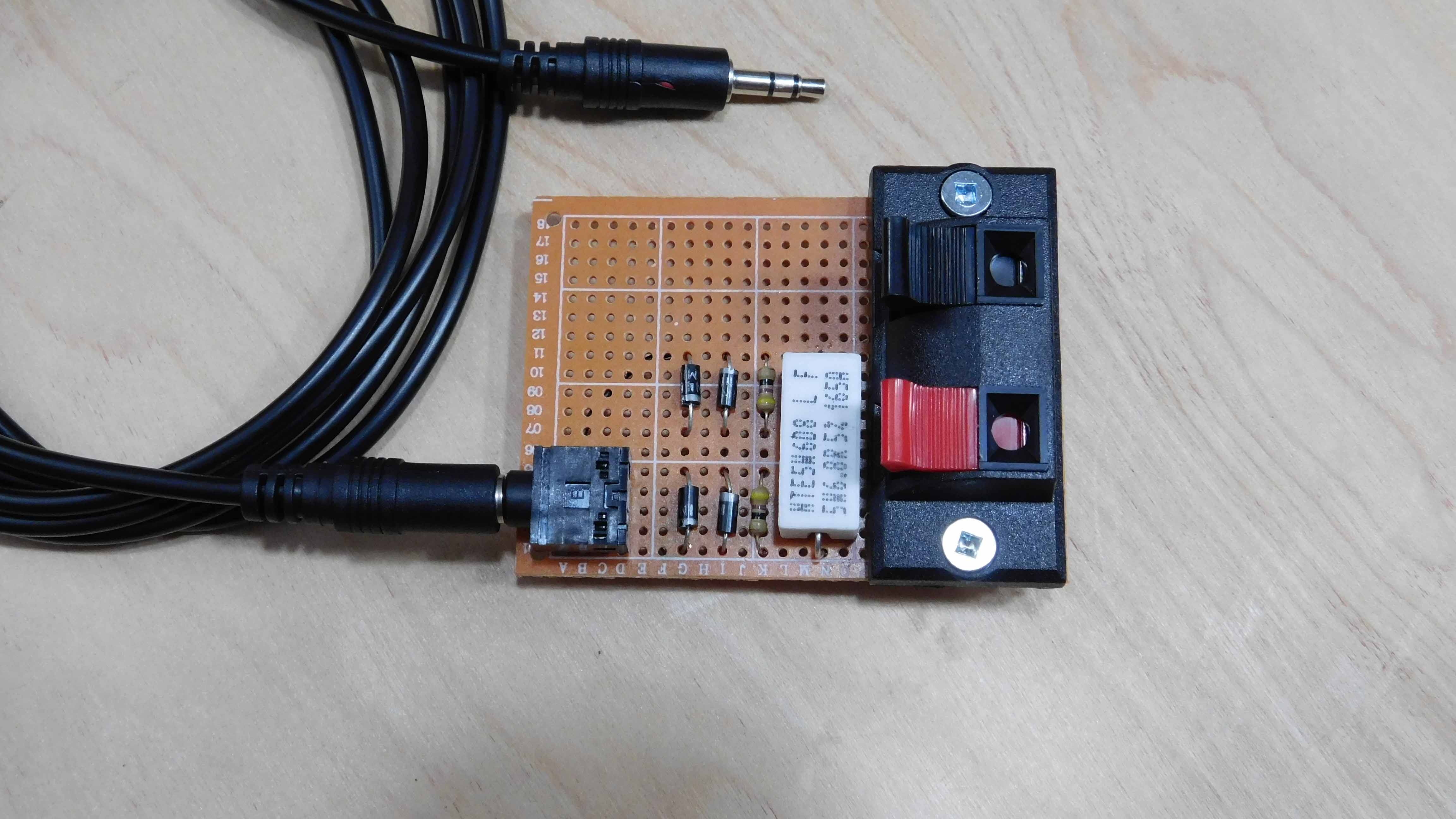

So I made a small fixture so that I could safely loopback the amplifier to the line_in of the sound card. It has 6.8R load for the amp, then balanced 47R resistors to the line_in. The line_in is clamped using 2 sets of diodes (1N4001) so that it can never exceed +/-1.4Vpk.
The results are in pic#2. The path is PC -> S/PDIF -> RXV659 -> Line_in. Looks fine to me.

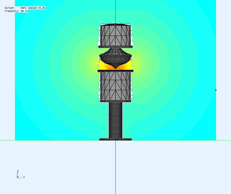

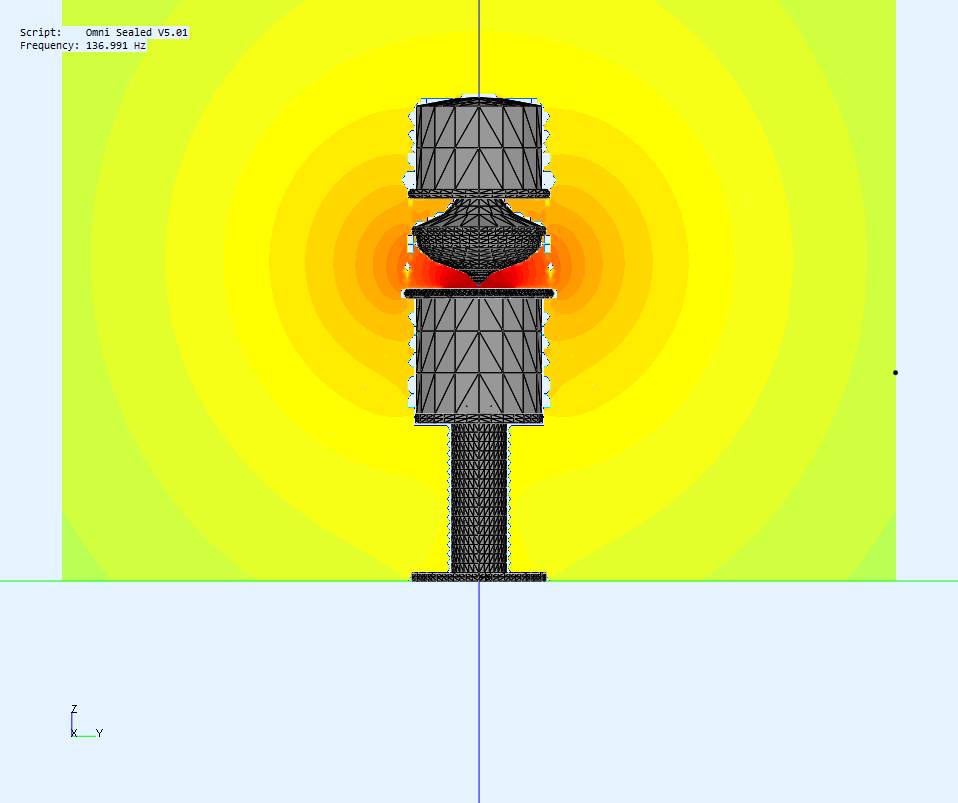

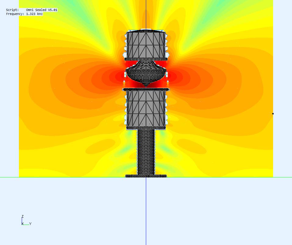

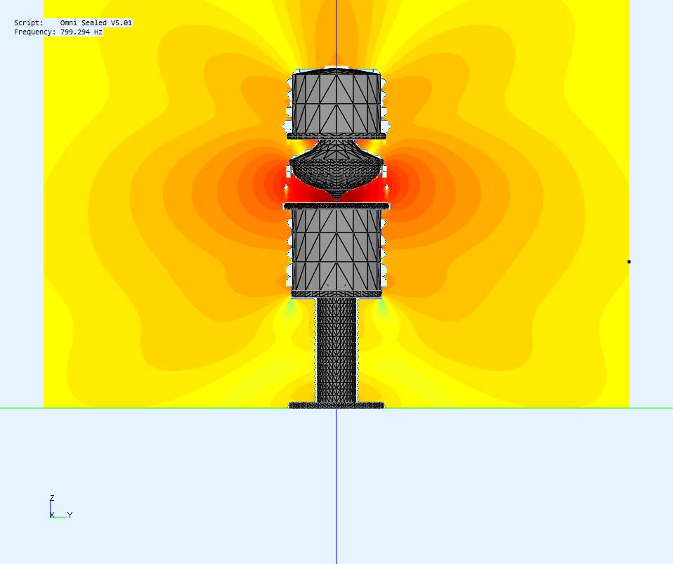

Updating ABEC model
I updated my ABEC model using the new parts that make it a cylinder. It could be a little smoother on the cone surfaces. I'm going to try improve the model and observations technique from ABEC to reflect what I've actually measured.

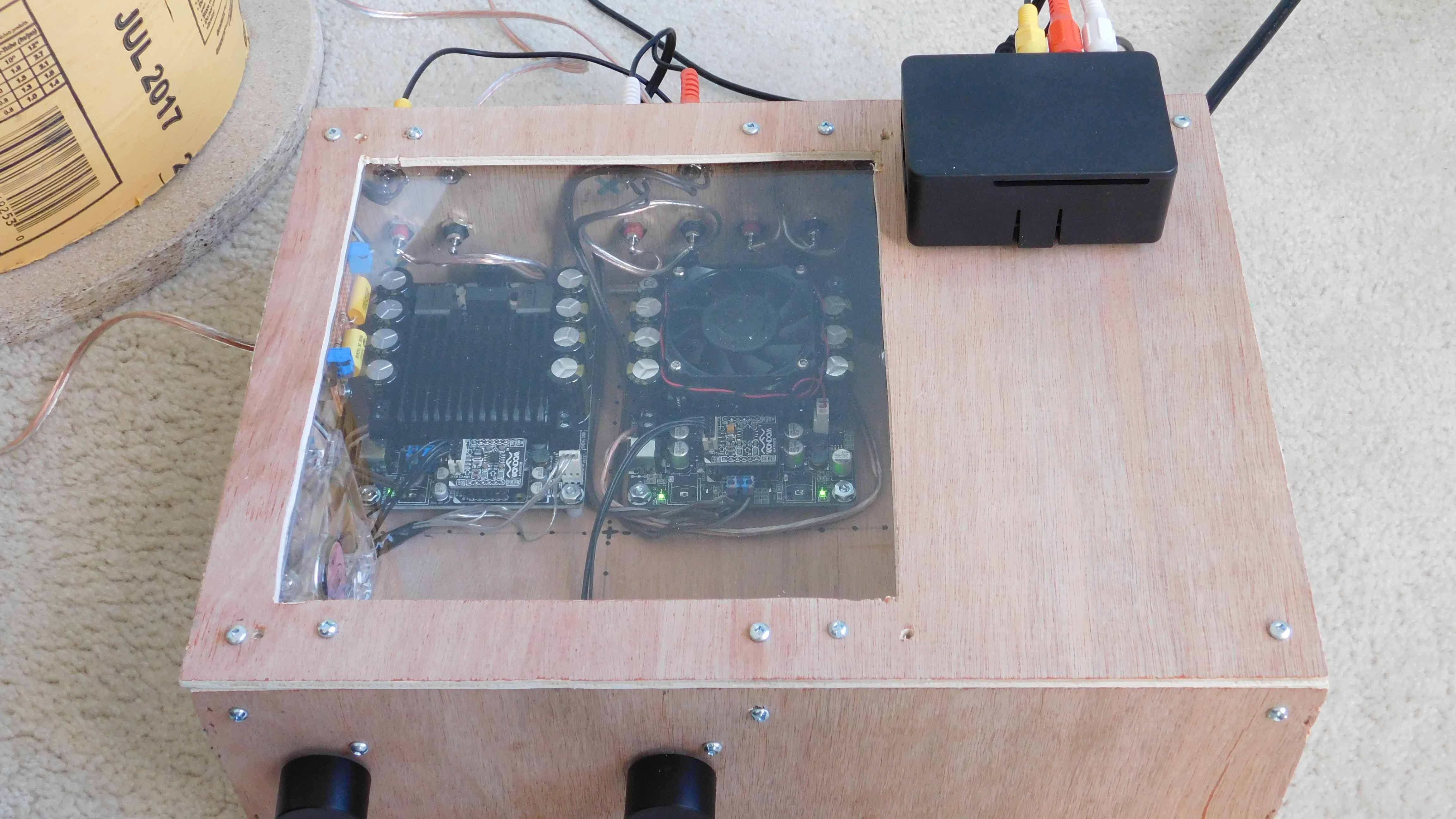

Adding more pieces...

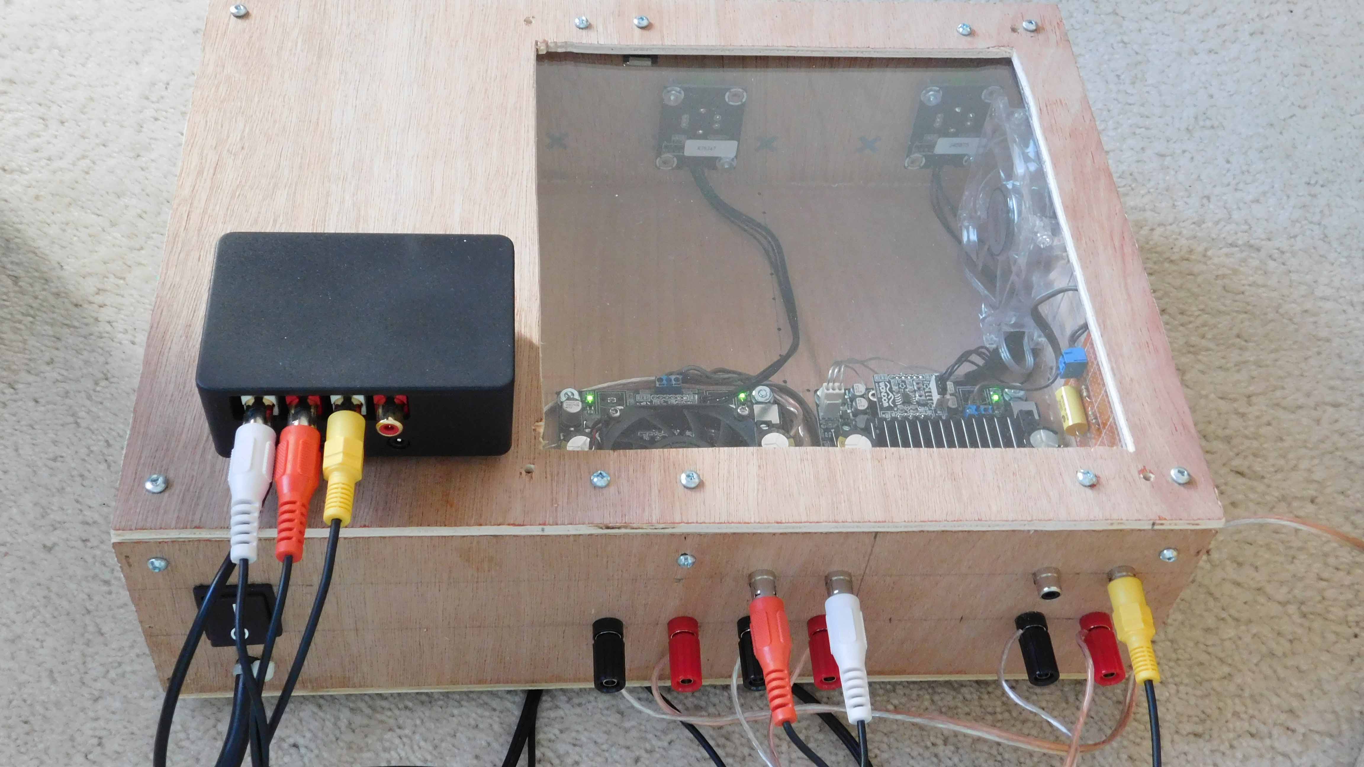

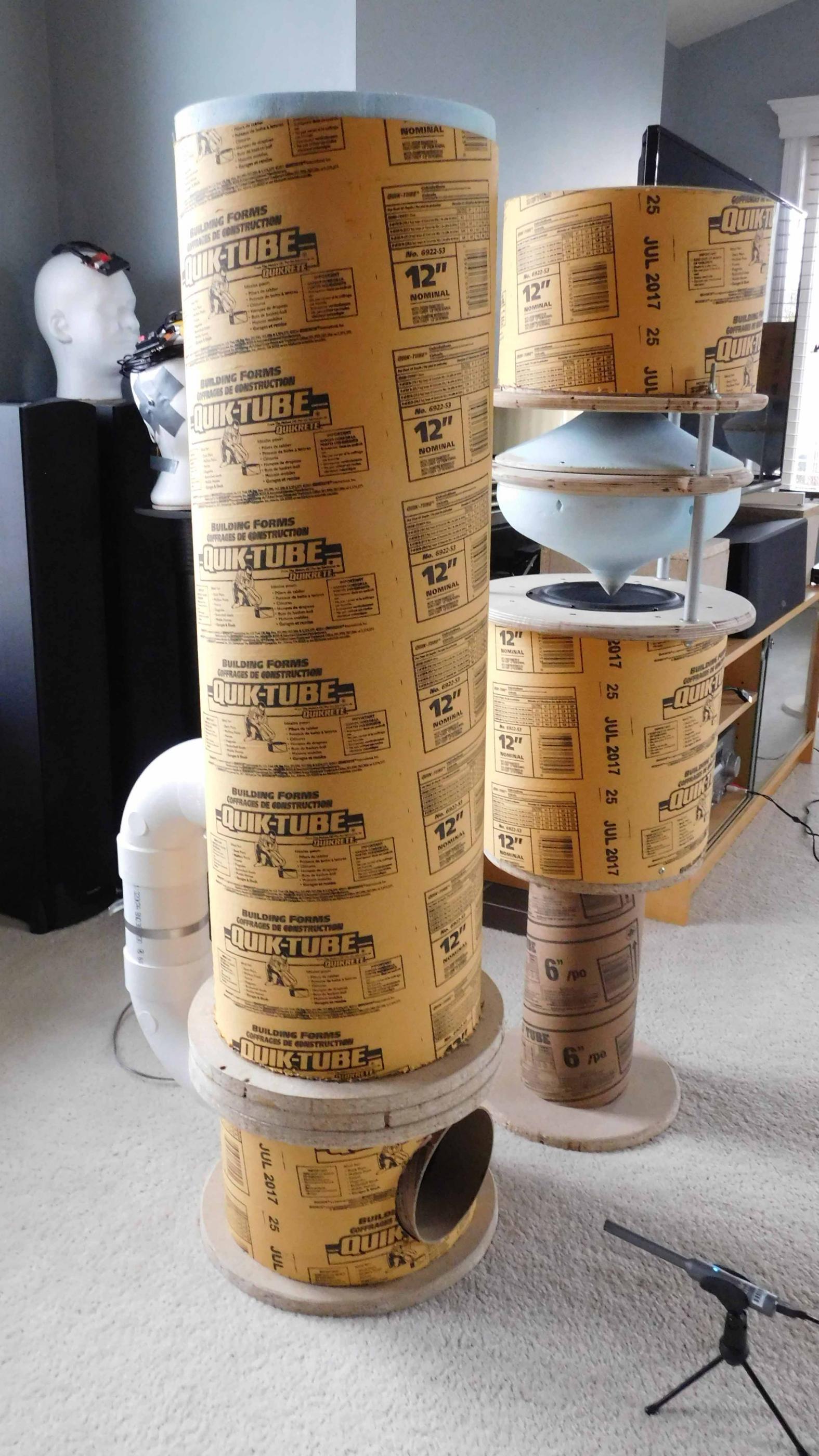

I have not changed the omni's in a while as I've been busy building other pieces for this system. So I thought I'd update this thread with the associated support pieces.
Playback is from a headless media player (Volumio2) built using an RPI3B + Piano2.1. The setup has 4 DAC outputs with built in nano-DSP that allow a subwoofer output to be generated along with R+L. At Raspberry Pi with Piano2.1 DAC DSP and Volumio2
I've left the Omni 8" woofers in a sealed 16L chamber but it doesn't go low enough (FR) for my liking. It turns out that I really like 2 subs to even the bass in the room. The second sub is a series tuned BP6 cylinder using a 12" subwoofer styled to "look like" the Omni's . At SonoTube and SewerPipe BP6 Subwoofer
I also wanted a separate amp for the above. I've shyed away from class D amps before so I thought this is a good time to try them out. Both are from Sure Electronics, the sub amp is 1x200w and the Omni LR amp is 2x200w. I use a 36VDc supply that's dialed down to 32VDC (better regulation) that yields 110W to the sub and 55W to each LR. More than enough for me. Everything is boxed in a sureply case with a plexiglass viewing window.
I'm currently trying to transfer the convolution filters developed on my PC to the RPI which can run BruteFir or some other convolution engine. Linux audio is a strange animal 🙂
I like this style. 🙂
The simulated geometry appears to be axisymmetric. You could take advantage of this and run a 2D axisymmetric simulation to reduce calculation time.
