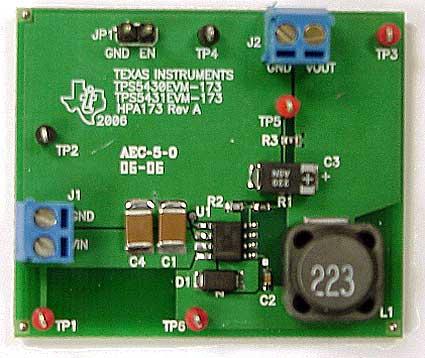

A TPS5430 EVM of the inverting config is mentioned, but I couldn't find it.
This appnote mentions an email you could write to request one...
http://focus.ti.com/lit/an/slva257a/slva257a.pdf

Edit: I think I found it... Not going to say the price out loud.
http://focus.ti.com/docs/toolsw/folders/print/tps5430buckboost.html

If you invert, could buckboost? Like a filament is really gonna care inverted DC...
I suppose that if you had +10 volts and you needed 20 volts you could use an inverter to make -10 volts from the +10 volts and then wire the 20 volt load between the +10 volts and the -10 volts. Up until recently the inverter devices were only capable of light loads. Some recent chips can put out amps, so this is possible. I am not sure about the efficiency of high current inversion though. (I read the app note and it looks like about 85%)
